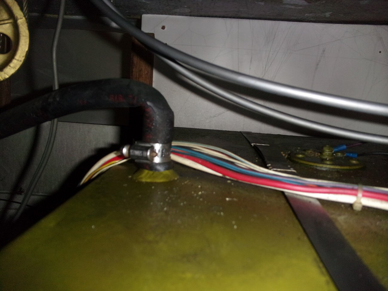

your loss of power could be due to a collapsed/plugged fuel tank vent hose, insects like to build nests at the vent or see my photo,,I found that these boats that sit in boatyards for years, will heat up so much the hoses collapse,
