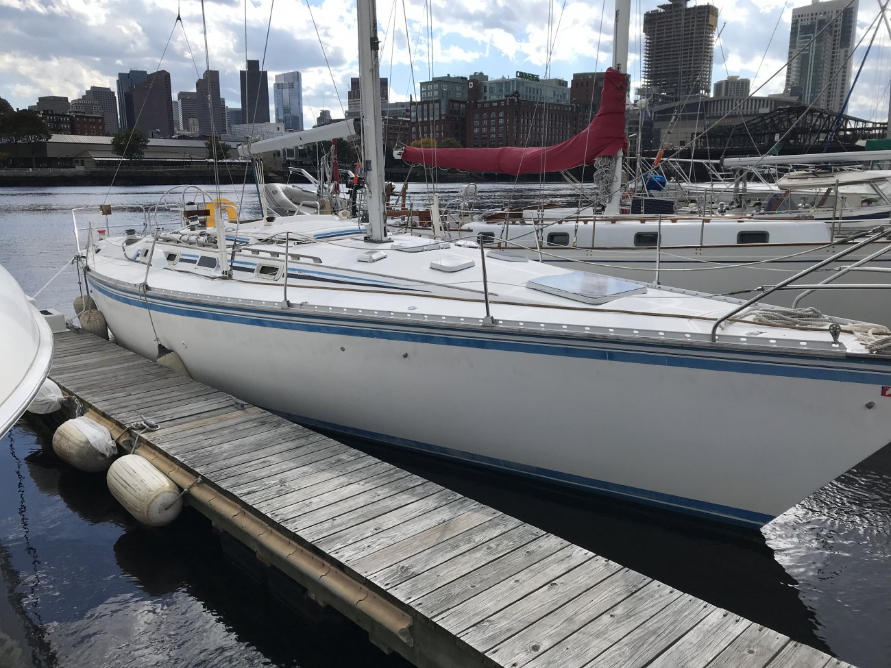

So here I am nearly a year later. I've got me a 1985 Hunter 40! She's suffered from a fair amount of neglect, sadly. At least two years abandoned at a yard, and lots of, shall we say, incomplete repairs from the previous decade. But the inspector gave her a conditionally clean bill of health. (more on that later) And my two old-salt uncles agreed the price was good and the boat was sound.
And now I live aboard! I've got my slip in Charlestown, and I'm past the point where it's all academic and I'm reading everything and I'm at the point where the issues are now real and present.

Welcome ! Congrats ! That is a good old boat, big sister to the 34 ..there is some great stuff posted by forum member, B757Captain, as he restores his H-40..

I admire your spirit. I like the lines of the boat that you chose.
