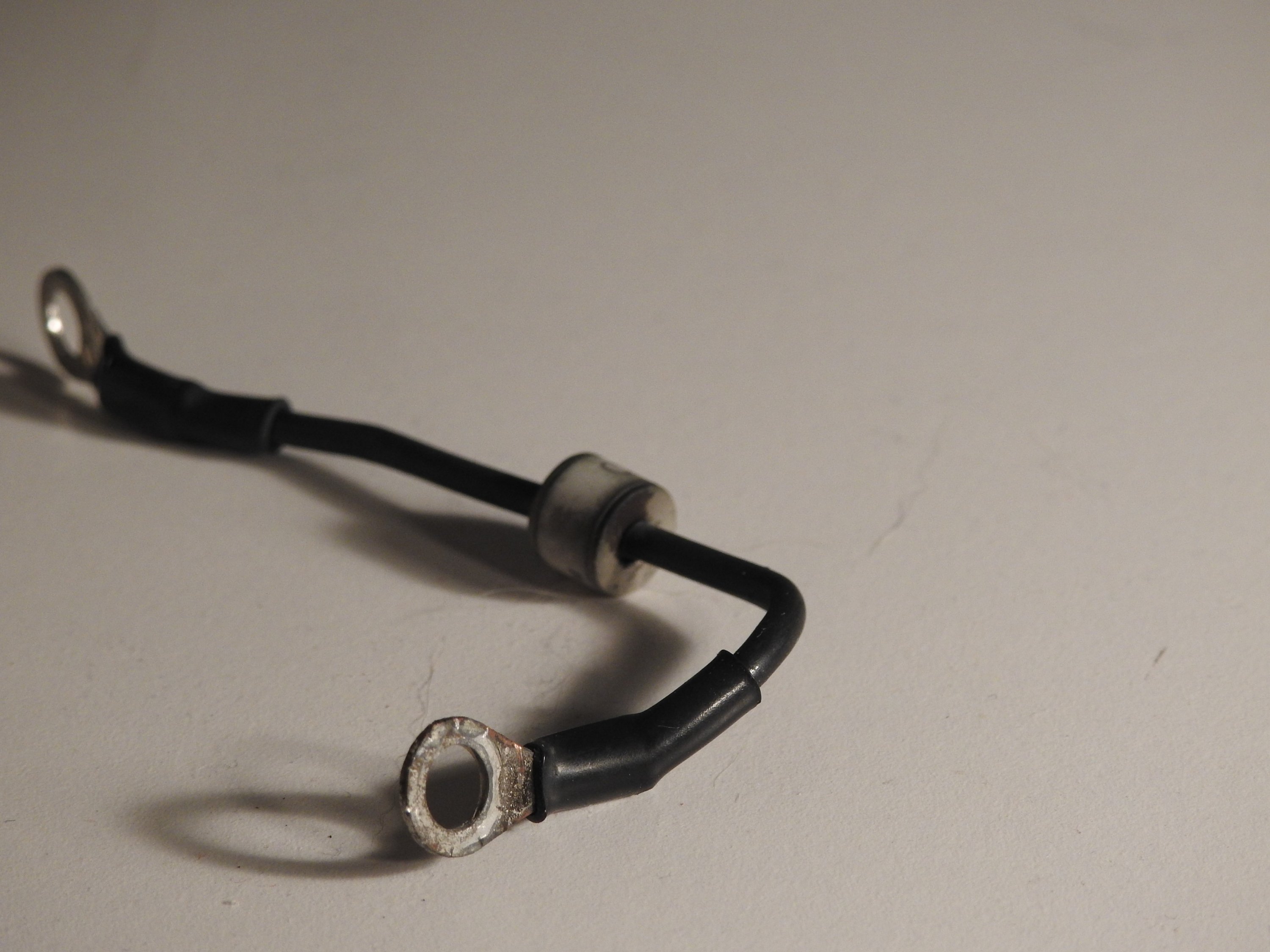

You da' man MS! That shows exactly how mine is wired. Is it possible that the surge arrestor is going bad and tripping my GFCI? I am in the process of ordering a leakage clamp tester but still looking, hoping for something else being the culprit.
Could I disconnect that component for a while to see if the tripping stops?
I've not seen one go bad but you can try disconnecting it temporarily. Do you have a galvanic isolator?
I do not. I read your article, but I wasn't sure it would make a difference in my case. I will disconnect the surge arrester and see if it helps.

I went out to the boat tonight, The pedestal GFCI was tripped again. I removed the surge arrestor from behind the main AC breaker and powered it back up. Left it for 2 hours while I helped a guy haul his boat out on the crane. So far it hasn't tripped, but it can be hours or days before it does. Here is a pic of the component. It looks like there might be evidence of heat, he says, wishing it were true.

Justin. No knowledge of the part, but 2 cents... It is supposed to be a diode. So electricity goes one way. Can you check it with a meter?
May 20, 2016
3,015
John - I think it is a form of MOV (metal oxide varistor) - not a diode... they are two back to back diodes with couple hundred volts breakdown voltages
24,805
Ok. How can he check that the MOV is functioning or a toss?

I would like to replace it regardless if I could locate the part identified in the diagram.

If that part were bad, you would be blowing the GFCI on the hard.. But I understand that never happens.
It goes between green (earth ground) and white (neutral) and the voltage between these two nodes is never very high (or should never be very high anyhow).
Since that part normally does not see any voltage bias, you could simply measure the resistance on the two leads using an ohm meter. Measure it one way.. then swap the leads and measure it again. FYI, if that part was ever overstressed, the failed part could look like a low impedance and then would cause a problem. But as mentioned, it would cause a problem on the hard if that GFCI (and green earth hookup) was working correctly.
FYI, lets say that at very worse case, you get 3 volts RMS between those two wires (green and white). To get 5 ma, the resistance would have to be less than 600 ohms. My guess is that if you measrure the resistance, you will see maybe 1000 times that value (guess.. but I think it would be WAY higher..).
Speaking off the top of my head (which can be dangerous), I believe that an MOV is basically an open circuit until you reach a certain voltage across the two leads, then it suddenly conducts with a very low resistance. Their most common purpose is to eat up unexpected voltage spikes in power supply circuits for sensitive equipment. They are usually round & flat. They often show two small rods on the flat surfaces. They are often, but not always blue or green.
I would think that the best way to test them would be by attaching them to a variable voltage power supply that has a current limiting feature & watching the ammeter for a sudden spike. A homebrew test might be to apply various voltages with a small amperage fast-blow fuse in series. When the fuse pops, you found the trip voltage.
A zener diode has the same function as I just described above, except that when it conducts, it only conducts in one direction. They are commonly used to bleed off excess amperage from unregulated charging systems in older British motorcycles. Higher voltage versions are used in other power control circuits. A zener diode often looks like a regular diode. Unless you look up the part number that is written on the side of the barrel, you don't know if you have a zener or not.
The MOV needs to be out of the circuit to perform these tests. The same is normally true when testing diodes.

In case anyone might be following my GFCI tripping problem; Removing the surge arrestor did not make any difference. The GFCI still trips randomly. Every time I go out to the boat it is tripped.
