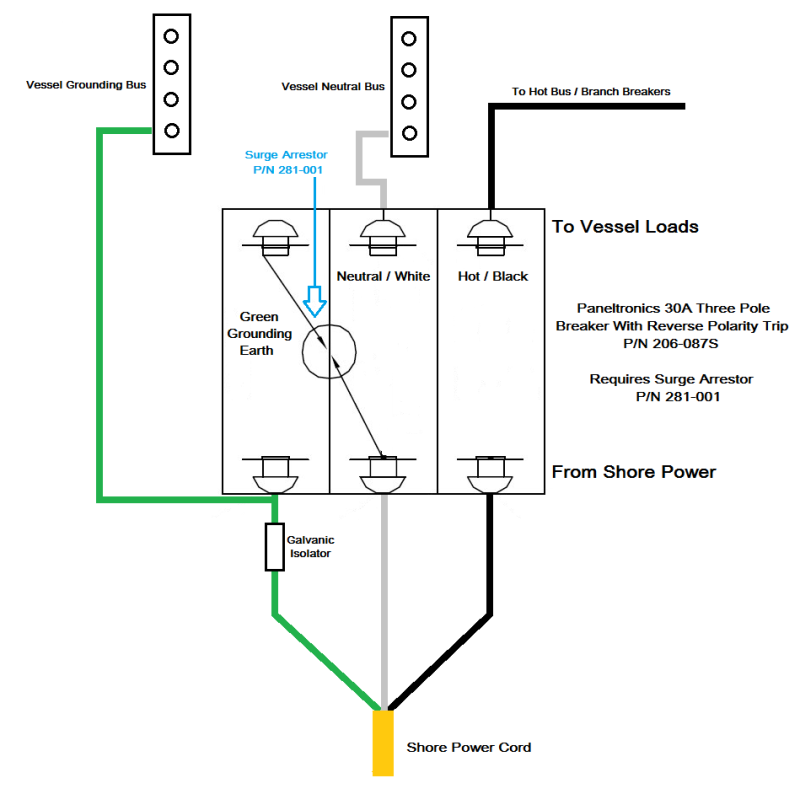

This maybe a Mainsail question. I wanted to sketch my AC Main power switch but maybe I can describe it well enough to ask what this discreet component is for:
It's a 3PST main switch/breaker. When engaged, one pole supplies power (black wire) to the load and is distributed to other switches. Okay. The second pole connects neutral (white) to the neutral buss. So far so good.
Here's the kicker: the ground (green) input wire is tied directly to the ground buss. Then there is a lead from the ground buss to the input side of the 3rd switch pole. Then the contact side of the earth switch pole is connected to the input side of the neutral line via a diode(?) of some sort where the white wire is connected . So when you engage the AC switch, neutral supply, neutral buss, and earth buss are all connected (indirectly?) through this component.
My electronics days are an ancient memory. Why would neutral and ground be tied together electronically, not mechanically? Is it a safety measure of some sort? If this component has failed, is this why my pedestal GFCI fails? What could this component be? A zener? It's hard to read installed, but I think is has "CG751..."
Does any of this make sense? I think I could take this component out of the system and everything would still work.
Feb 6, 1998
11,759
These three pole reverse polarity trip breakers are very often miswired..
Jul 7, 2004
8,534
Hunter 30T Cheney, KS
You da' man MS! That shows exactly how mine is wired. Is it possible that the surge arrestor is going bad and tripping my GFCI? I am in the process of ordering a leakage clamp tester but still looking, hoping for something else being the culprit.
Could I disconnect that component for a while to see if the tripping stops?
