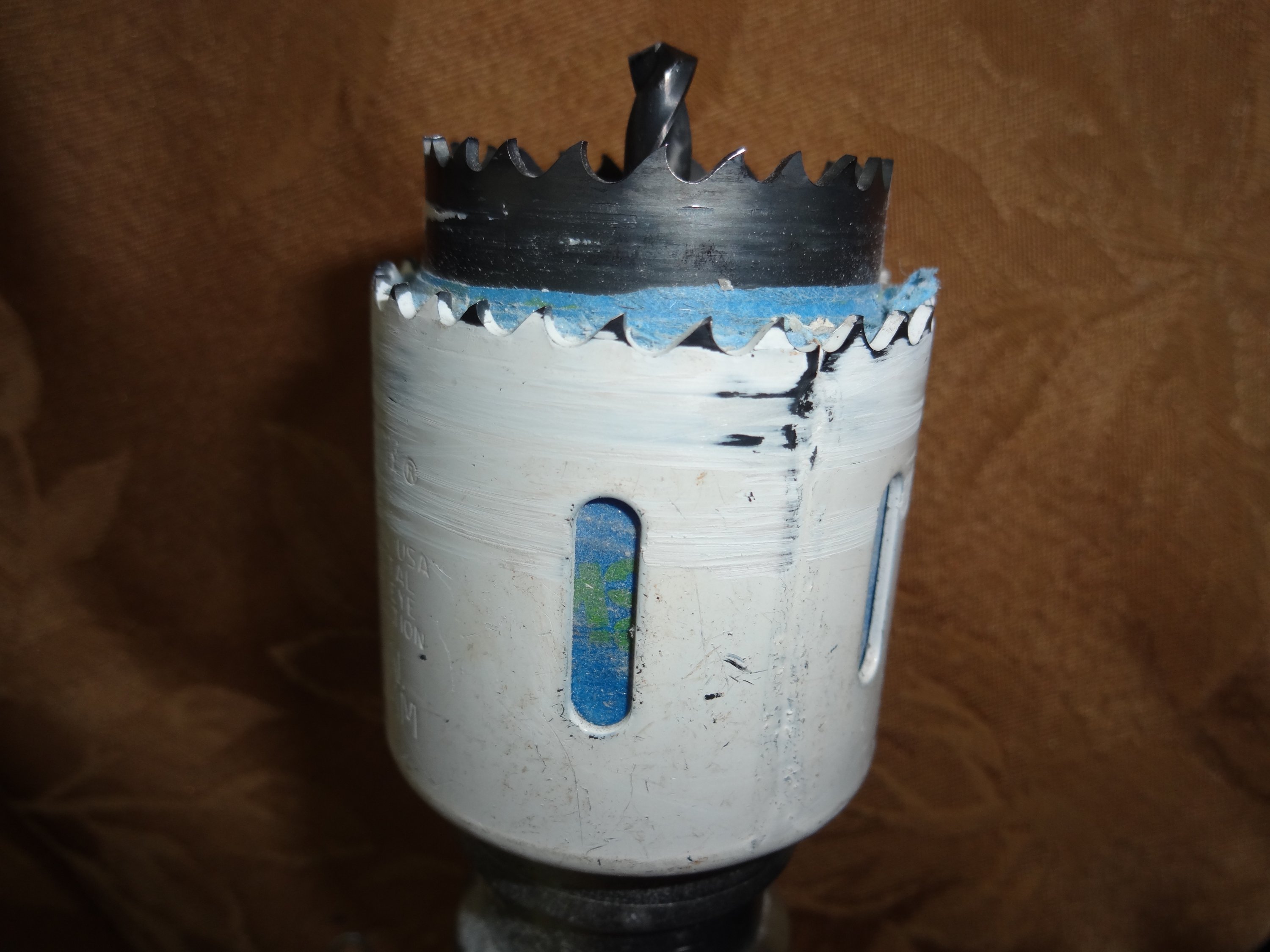

Got the 2" hole for the new speed log drilled this morning. I used Woody's suggestion of using the original hole's 1 1/2" saw stuck inside the new, larger one, to help center it over the existing hole. I wrapped the smaller one with painter's tape to help keep it centered. Worked very nicely.
