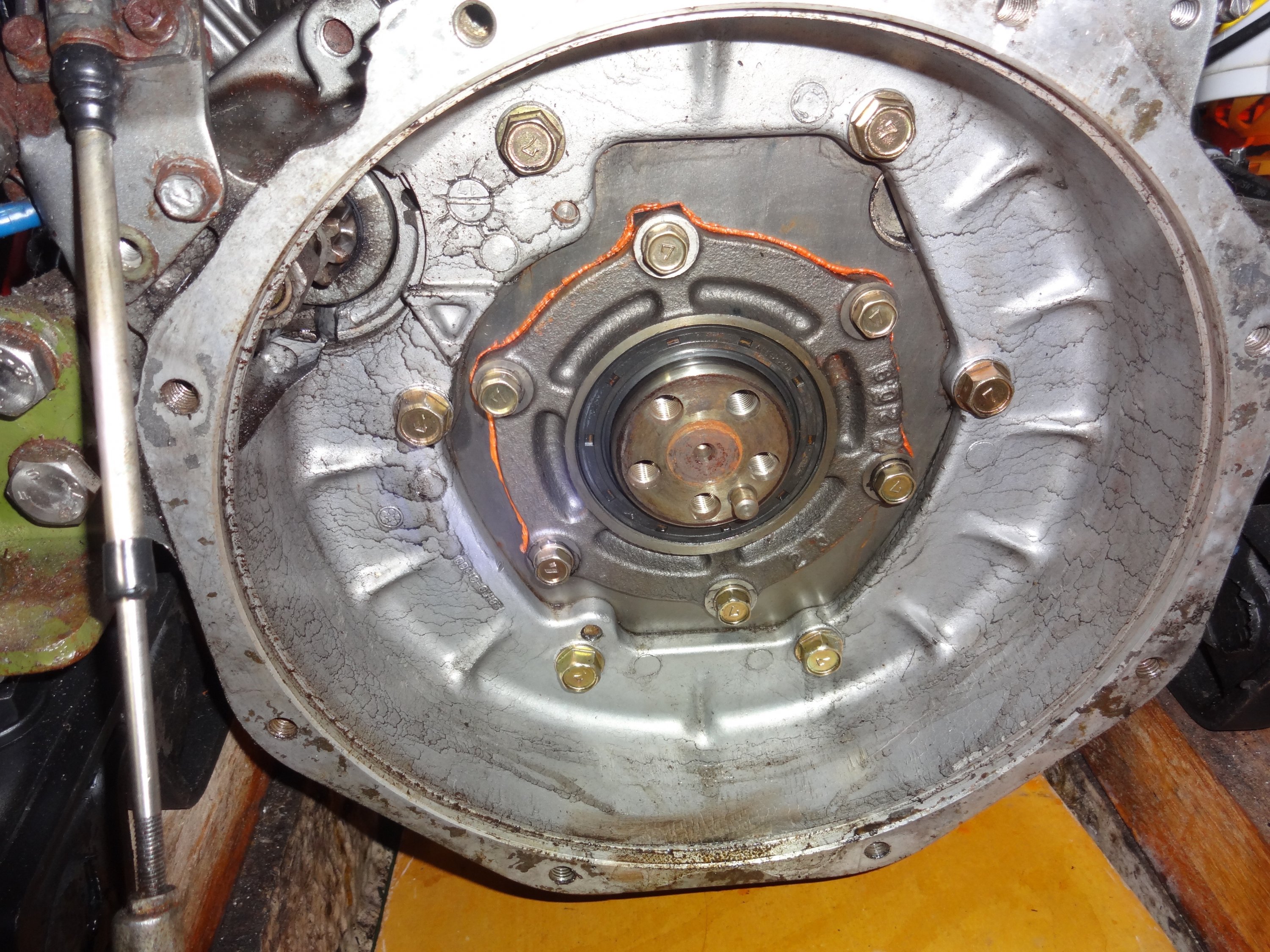

Bugbitten Looking at the back of the engine, it looks like some oil may have been leaking from under the carrier bolt at the three o'clock position in the picture? That seal and bearing carrier has an o-ring seal that may be leaking. The leak-looking stain goes down from the carrier bolt at 3 O'clock to the housing attach bolt at 5 O'clock..?? I agree, seals on transmission and rear crank look to not be leaking.. If you decide to pull the carrier to replace the o-ring, do go on and replace the crank seal.. If it was not leaking enough oil to make a tablespoonful puddle in the bilge after a day or so, I would be tempted to not mess with it at all.

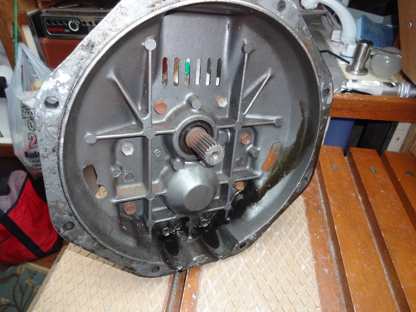

I don't think it's the transmission seal. I'll upload the picture again of the front of transmission. The lack of oil around the seal was what lead me to think the rear main seal was the culprit. The oil was collected at the bottom of the transmission's bell housing; it is also off to the side a bit in the picture because I leaned it over when I first pulled it out.

Pretty sure, like you said, that it is not the trans seal.. that oil looks to be all engine oil and I don't see any evidence of weeping in the transmission.. I do see some evidence of weeping from that rear bearing and seal carrier casting.. I see red RTV sealant all around the carrier except between the bolts at 3 and 5 o'clock positions.. and that looks to be where the weeping is.

The picture above is of the forward end of the transmission. The bulge at 6 o'clock, I believe, is for the output shaft. We think that's engine oil accumulated in the bottom of the bell housing, but aren't sure where it originated. There's a picture of the mating end of the engine at the bottom of the previous page. I'll go get some more pics tomorrow of the engine, around the main bearing seal. There's some thought that there may be a bit of seepage around one of the bolts for the bearing carrier, but it doesn't look like enough to me. I'm replacing the transmission, so if it's the source of the leak, there's no problem (other than I'd like to know so I could pass the info to whoever buys the old transmission from me, should that happen).

Took more pictures of the back of the engine. There is no oil on the lip just below the bearing retainer, which is where I would think it would accumulate first, if one of the bearing retainer bolts was the culprit for the leak. Unlike the transmission, there seemed to be no real pooling of oil, nor was any of residue you see fresh. What oil there is seems to have largely originated around the starter, for what that's worth. The flywheel and damper were oil free, so I'm tempted to put it back together - with the new transmission and damper - and not worry about it. Actually, I think I have a new starter in the bowels of the parts pyramid. Maybe I'll slap that on.

Couple of observations, Bug.. Note that the engine is tipped down in the mounted position.. I would not expect oil to accumulate on the lower lip where the carrier is.. it would run off .. Look at the lip carefully and you can see that the bottommost lip is cleaner than the right side (in the picture) higher lip, and note the housing right below the lower carrier lip; it is cleaner than the rest of the housing.. detergent oil will clean stuff it is weeping over. It does look suspiciously like oil might be coming in the starter opening also.. could it be coming in from a drool/weep/leak in that oil line and/or banjo connection on the back of the cylinder head? (couldn't see it well enough in first picture)

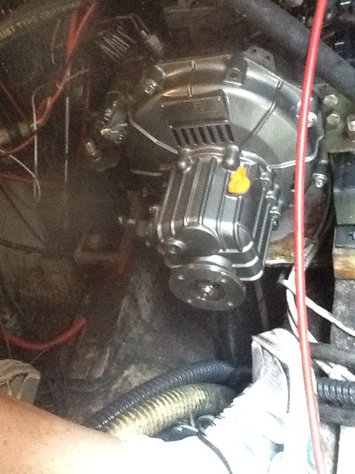

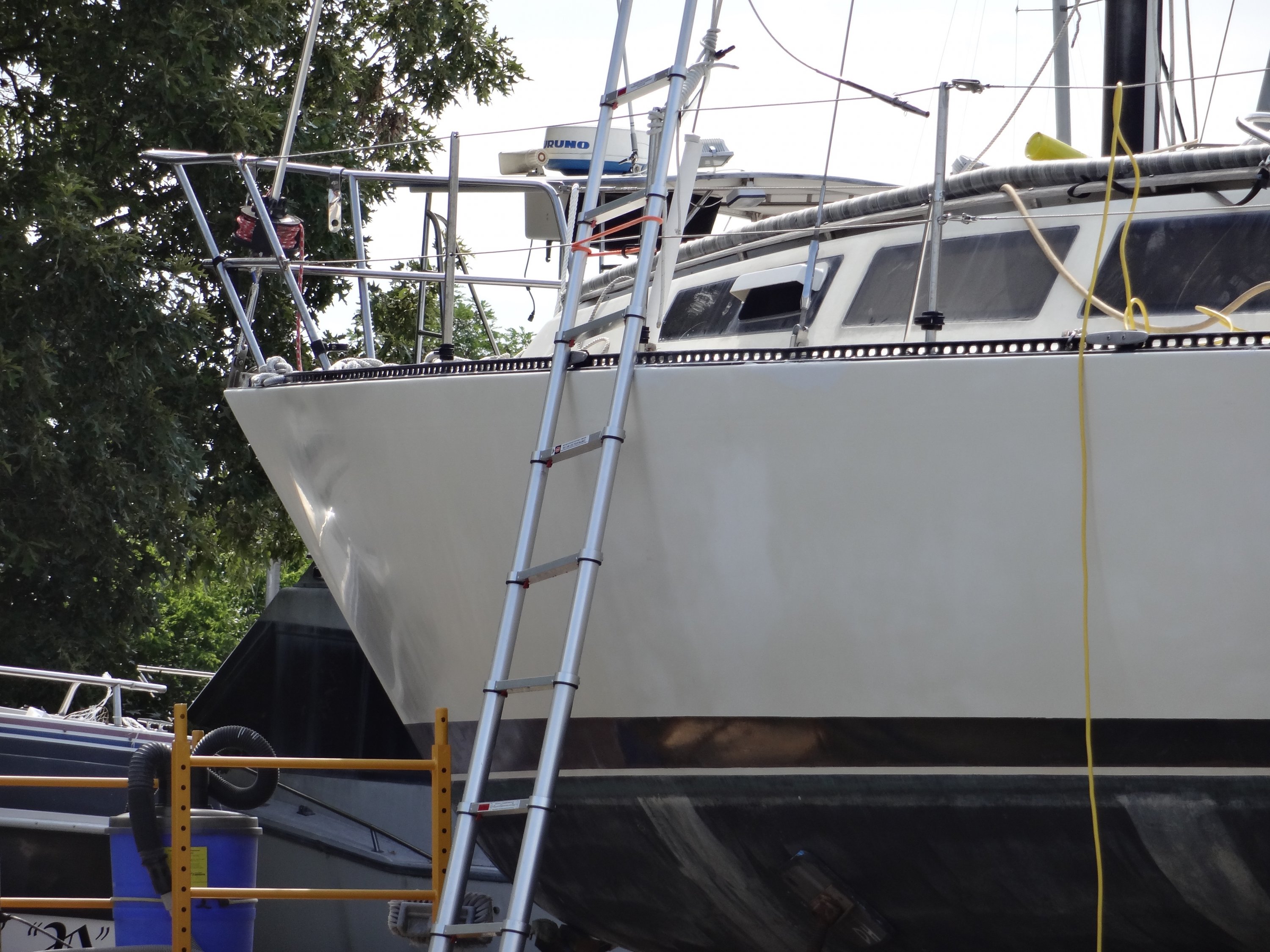

I got the new main seal installed on the engine and bolted on the new transmission. It looks very pretty. The new shaft and coupler arrived, and my mech is starting to install that. I'm still sanding the topsides, eventually wet sanding with 320 before compounding and polishing. I'll a attach a snap of a small area near the bow that has been compounded, but not polished. Looks pretty good! Haven't gotten back to touching up the gel coat, but should do that next week.
We found considerable rot around the port stay's chainplate, so my brother, who is more of a woodworker, has been tackling that. It's about ready for the replacement piece. The starboard one has a bit of rot, too, but far less. Two more to inspect, once those two are done.
Still have to sand and paint the bottom and install the new speed log. Then she'll be about ready to get back in the water. Once there, there's still the mast and rigging to attend to, but I'll try to get in a couple of sails before addressing those.

if trans fluid is the color of used motor oil something is seriously wrong with it. Take trans off the leak list unless of course you use motor oil in trans.
