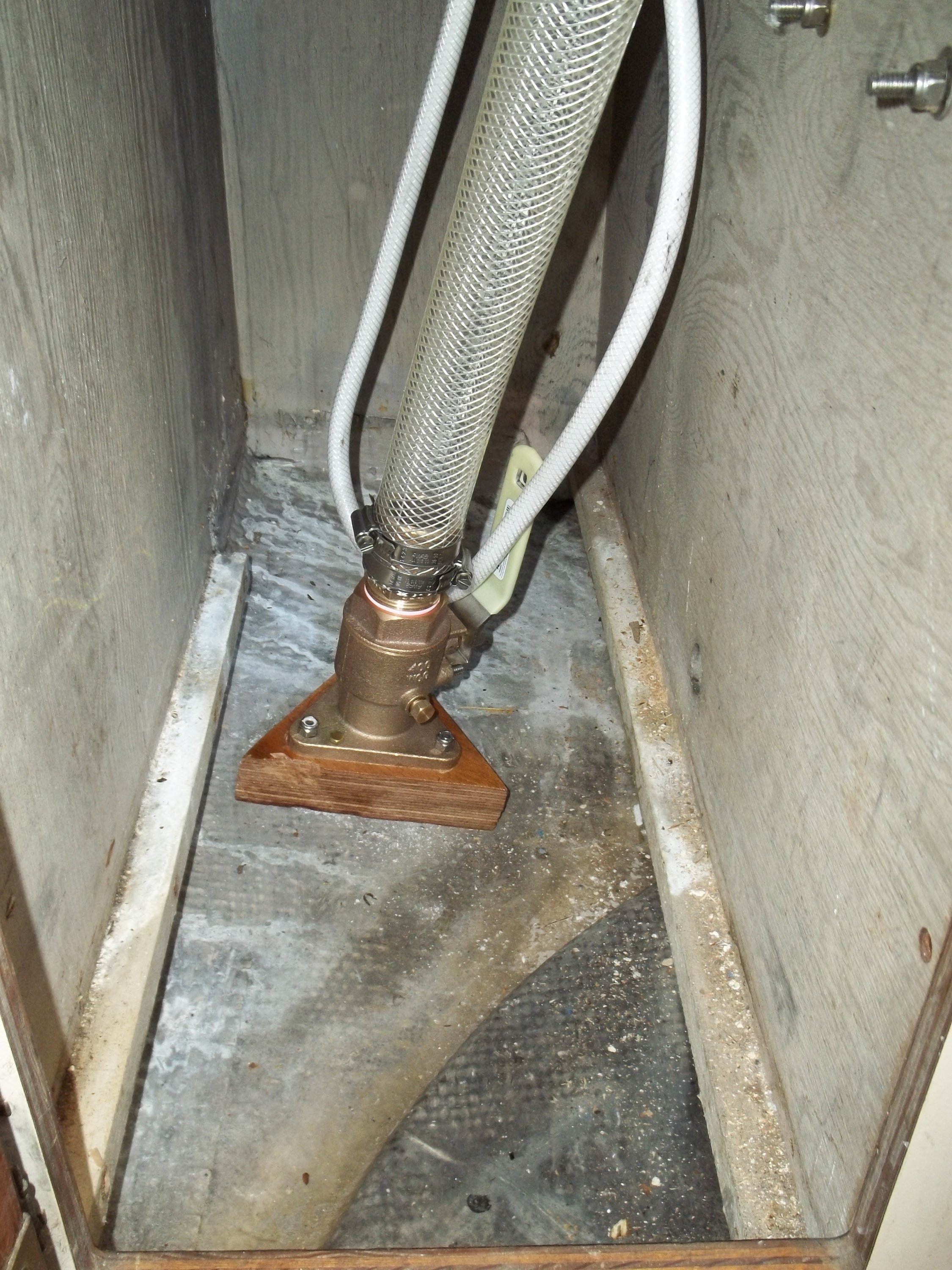

I did get the parts for the new, larger sea cock and thru hull for the galley sink drain ordered. I suppose I should keep that at just below the waterline, although it would seem like it would drain better and stay clearer if it were just above it.
it will drain just fine in the original position assuming yours is below the galley sink next to the keel or there abouts

The current drain for the galley sink is just below the waterline, not down near the keel. The hose goes through the rear of the cabinet, along the bulkhead, and to a seacock accessible in the large cockpit compartment on the starboard side. There are two seacocks there - the other being for the original bilge pump, which is rather perversely mounted underneath that compartment. I gave up on that pump and have the current ones exiting out through the transom.

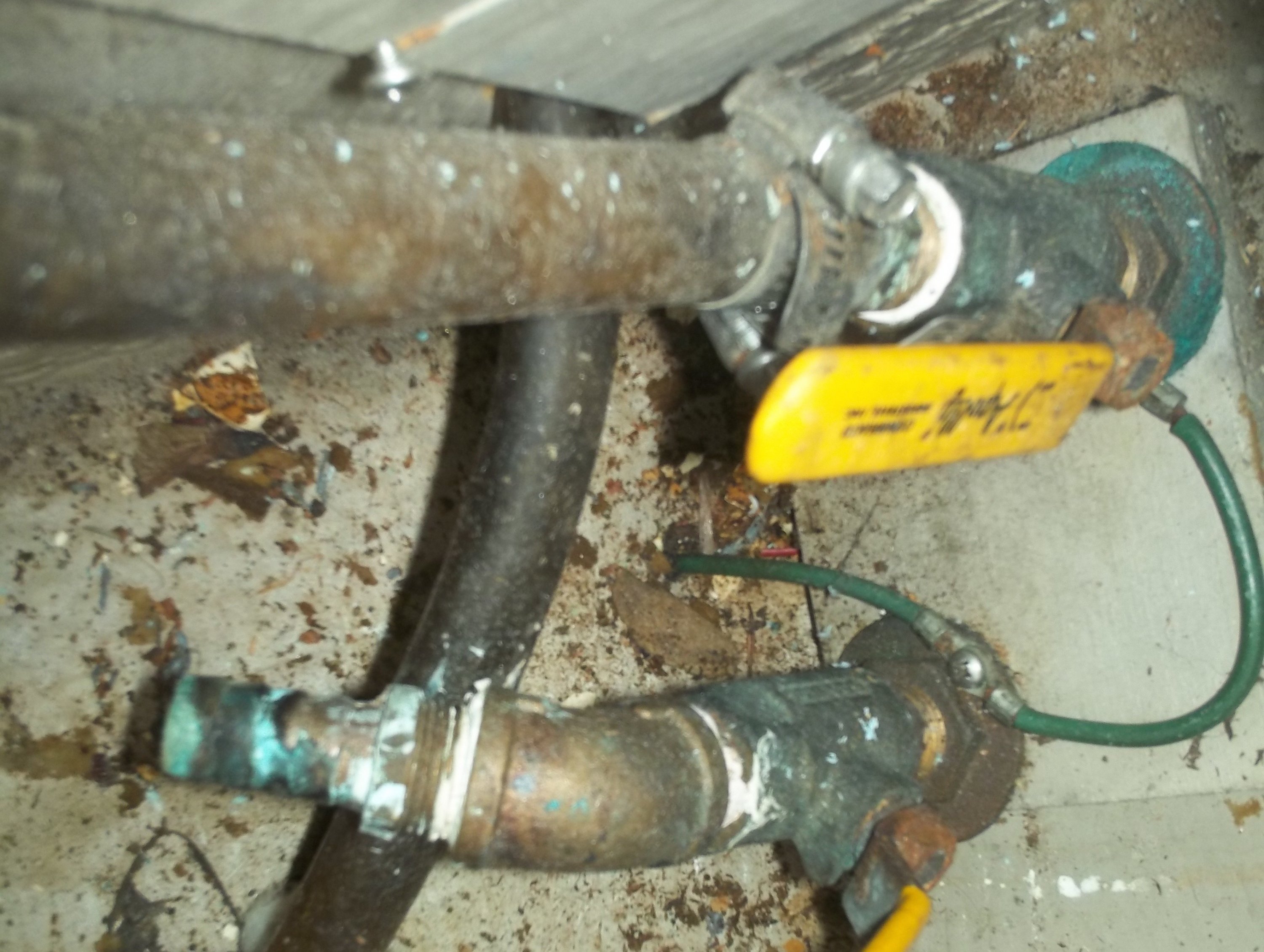

in about that location i have the sea water pick up for the engine and the sea water pick up for the air conditioner and my galley sink drain is in the cabinet below the sink in the back are you going to up grade those valves in the pick ...they look like 1/2 inch
My HVAC seacock is under the starboard settee, just ahead of the galley. It wasn't used for anything up to that point. That one's 3/4 inch. My sea water pick up is in the engine compartment, a bit aft and to port of the transmission. I wouldn't mind moving it as there's no sea strainer on it (I have a nice Groco unit on the parts pyramid for that purpose) and it's a tough spot to fit one. Moving it to where the original bilge pump exited would make it a lot easier to install and service the strainer, so I may well do that. I have a bronze seacock and thru-hull coming for the new galley drain. The 1 1/4" version came with a barb for a 1 1/2" hose, which is what I'm using, so I ordered that. Having it drain down toward the keel rather than over toward the waterline would sure make it work better, I should think. I think both those in the pics are, as you say, 1/2", which is why the old bilge pump and the galley sink drain didn't work for crap.

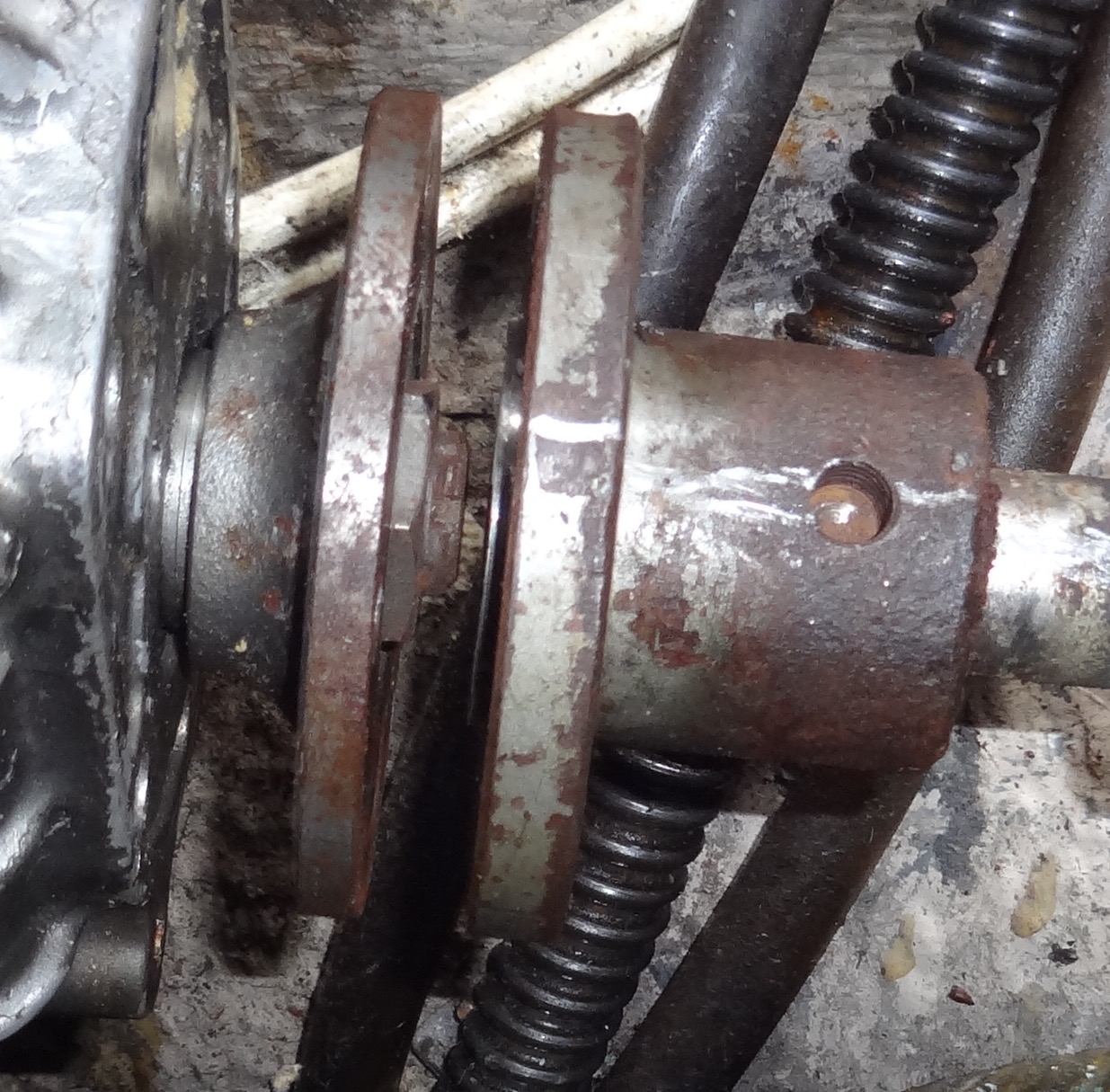

Friend Teddy and I got the old engine mounts out and the new ones in. I'll attach a shot of the current alignment, which, as has been pointed out, will change when the boat is in the water. So far, though, so good. The shaft comes out of the log toward the bottom - rather than centered - but I doubt I'll want to re-engineer that. The old mounts look fine, so I may clean them up and put them on the classifieds, with a full explanation of their condition. I replaced them primarily because they're of unknown age, and because my otherwise seemingly sage surveyor said they weren't Yanmar.

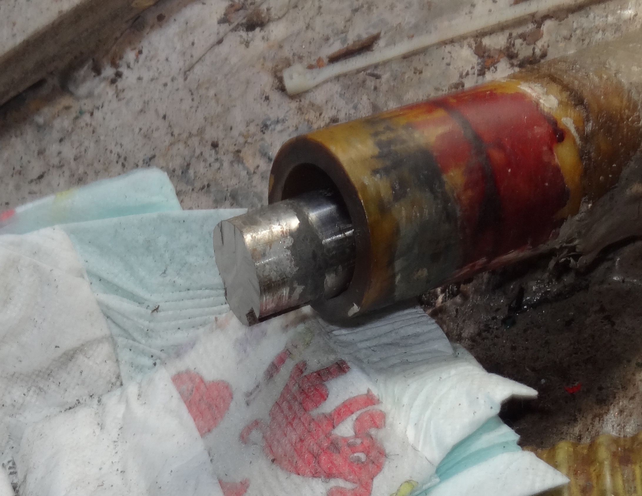

Finally got the prop shaft out. I used an angle grinder and cut it just aft of the coupling flange. I had to pound and pound on the prop to get the shaft to budge. It probably took about an hour to get it out of the hull. Once it was free of that, it slid out through the strut without much resistance. The shaft was not centered between the strut and the shaft log, entering the log high, up against the underside of the hull, and exiting low, against the lip of the log (so, to be centered in the log, the prop end of the shaft would need to be lower than where it's being held in the strut). There was enough tension on it that it was difficult to rotate as well as extract (when the boat first came out of the water, the prop/shaft was much easier to rotate, which may just have been due to water still being in the stuffing box). I'd be worried about there being a major alignment issue, except for the fact that there seemed to be no unusual wear on the fiberglass log. Had there been much on-going misalignment, I should think there would be considerable wear from the friction.
So, this leaves me hoping that it's tweaked due to being on stands. Unfortunately, that won't help much when it comes to getting the new shaft back in place without a ton of pounding and even more swearing. Seems like most of the weight is being born by the keel, so maybe the alignment issue isn't due to being on the hard. I'll attach a couple of shots that I'm hoping will clarify where it's entering and exiting off axis.

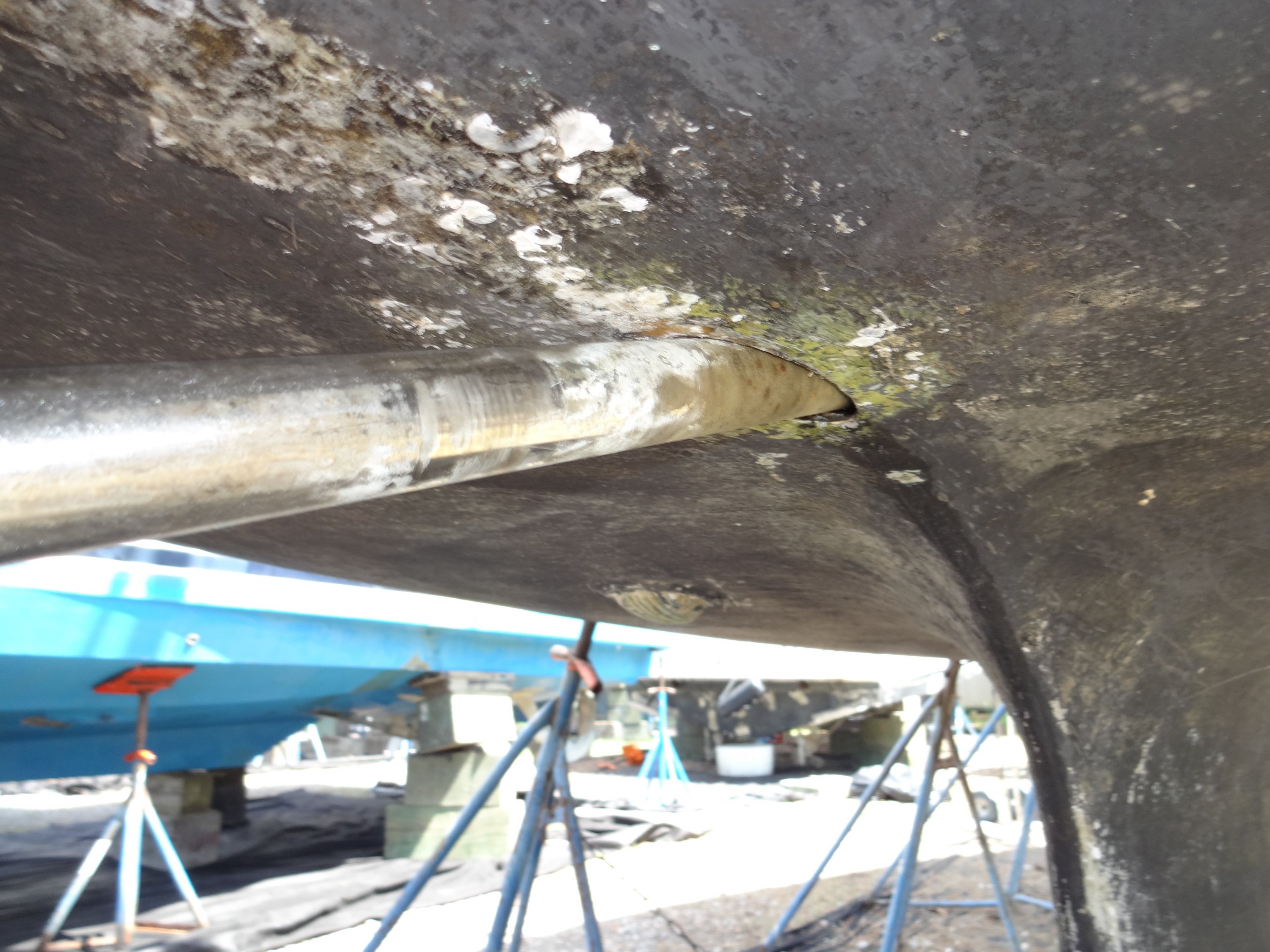

Had the yard owner and a top mechanic look at my alignment situation. They took one look at the wear patterns on the cutless bearing and knew there was an issue. The mech says the strut has to come out, so he can align it properly to the shaft log. We decided the bolts for the strut come through the hull under the fuel tank, and that I should empty it, loosen the straps and remove some fittings, and slide it forward to gain access. Does that sound right? I might as well have the tank cleaned and inspected while I'm at it. It's the original aluminum one. No leaks thus far.
look in your stuffing box and see if it is worn or oblong in the hole that will tell you volumes.....i had to reset my stern tube when i put the 2gm20f in in order to get the proper angle on the engine
i had to get a new strut due to the one i had was shot because if not being protected from electrolysis...the company that made it is algonac and they made the original and still have the pattern but will not sell direct you have to have a marine dealer purchase it for you ...try to get your yard to do that for a 10% markup handling fee it will come with a new cutlass bearing install
