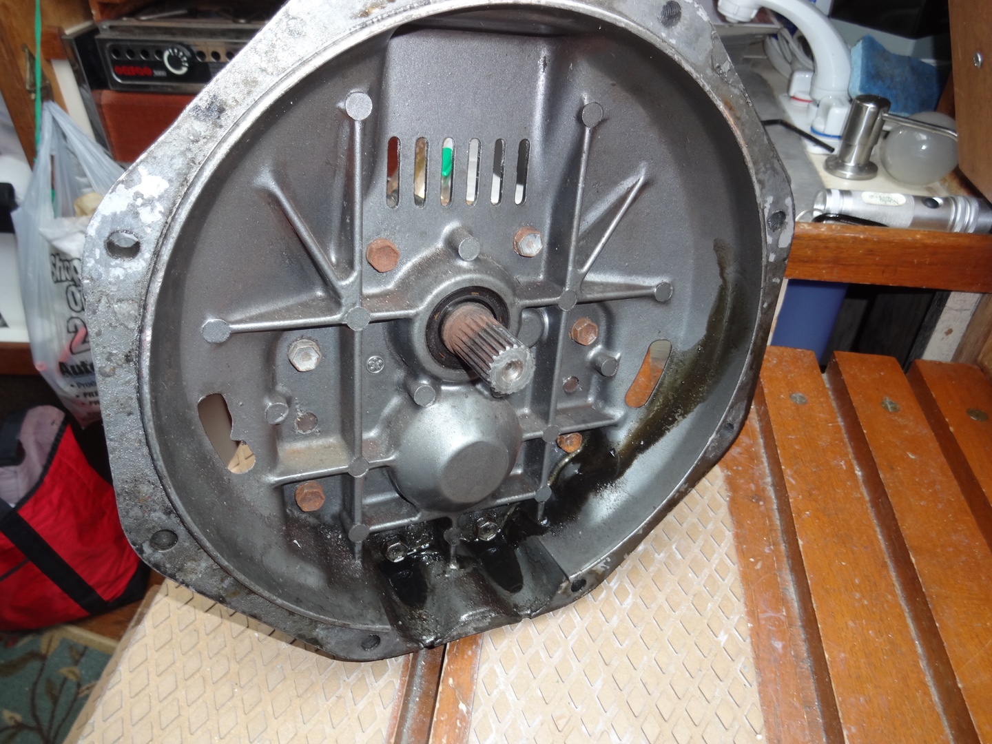

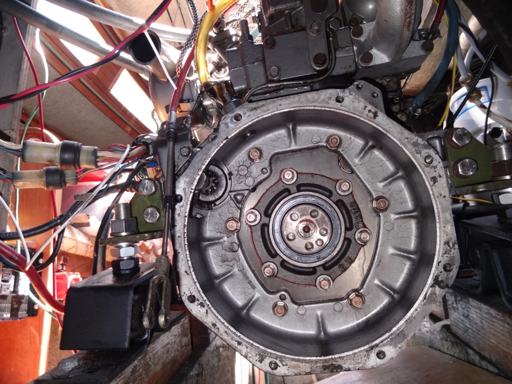

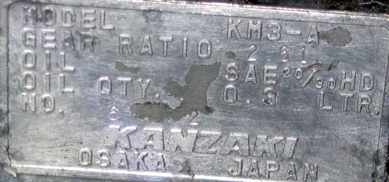

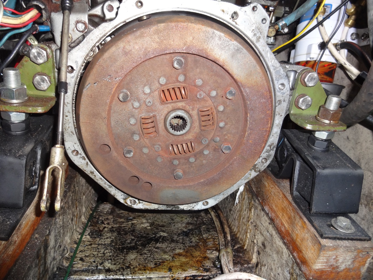

I think I'll do the same - reuse the toggles. That'll save enough to put a downpayment on the new transmission I'm considering! As you know, the engine is not original. It's the usual 2GM20F, but has a Kanzaki KM3A transmission, which usually comes with the 3 cylinder Yanmar. It has shabby, flaking grey paint that suggests to me a rattle-can rebuild. It's not been particularly decisive going into gear the last six months or so, although a fluid change did seem to help a little. Anyhow, since my wife probably will never allow me to buy another boat, I don't mind throwing way too much money at this one. So, for about $1700 I can have a shiny new KM2P tranny (I don't think they make the KM2A anymore). This complicates the prop shaft situation, since I believe the overall length of the transmissions is different, with the 3A I currently have being longer. My manual shows the 3A's overall length at 300mm, but doesn't show the 2A's (let alone the 2P's) dimensions. Well, it does show the 2A's, less the bell housing.
Any thoughts on putting in a KM2P?
Thanks.
John "she'll be back in the water by August, only I don't know what year" Livingston
