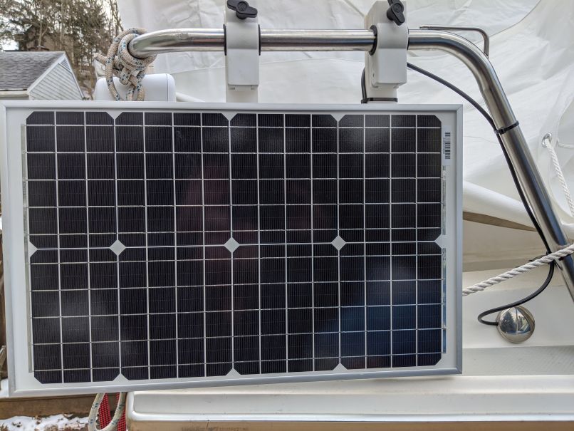

Got the panel and Victron installed despite the cold.

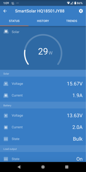

Ran the wire through the coaming with a cable clam to the battery compartment where I put the controller. I was concerned that I was seeing nothing but voltage from the panel until I found that the reading in the app is amperage being sent to the battery by the charger, not the true output of the panel. If it's in float mode it will usually be zero.
Hopefully warm enough to tackle the inside wiring soon.
The 30watt panel tucks nicely in the pushpit for trailer travel.

Added the second panel today and I am getting about 50 watts right now out of two 30W panels so I should be making more energy than I am using during the day and have plenty in the battery to go over night. It might struggle a little more when charging phone and ipad but there are plenty of alternatives there.

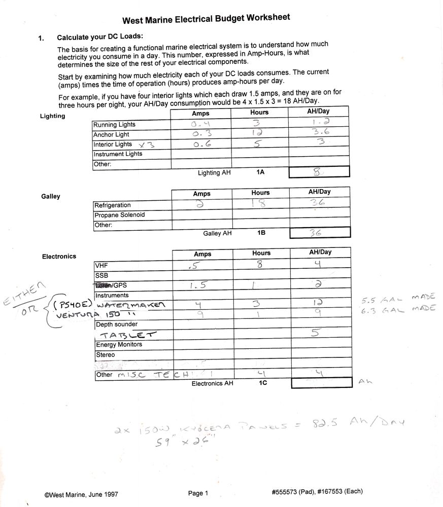

Haha, "spreadsheet" ... good use of quotation marks. ;) Here is a scan of my cave drawings. I was actually wrong about the 82Ah; that's the projected solar output. My consumption guesstimate is only about 71Ah/day, depending on which watermaker I decide on. (The Ventura 150 makes more water with fewer Ah than the PS40E, but costs a lot more.) And folks have told me that my estimate for the fridge (ENGEL PLATINUM MT35F-U1) may be low, despite the manufacturer's claims.

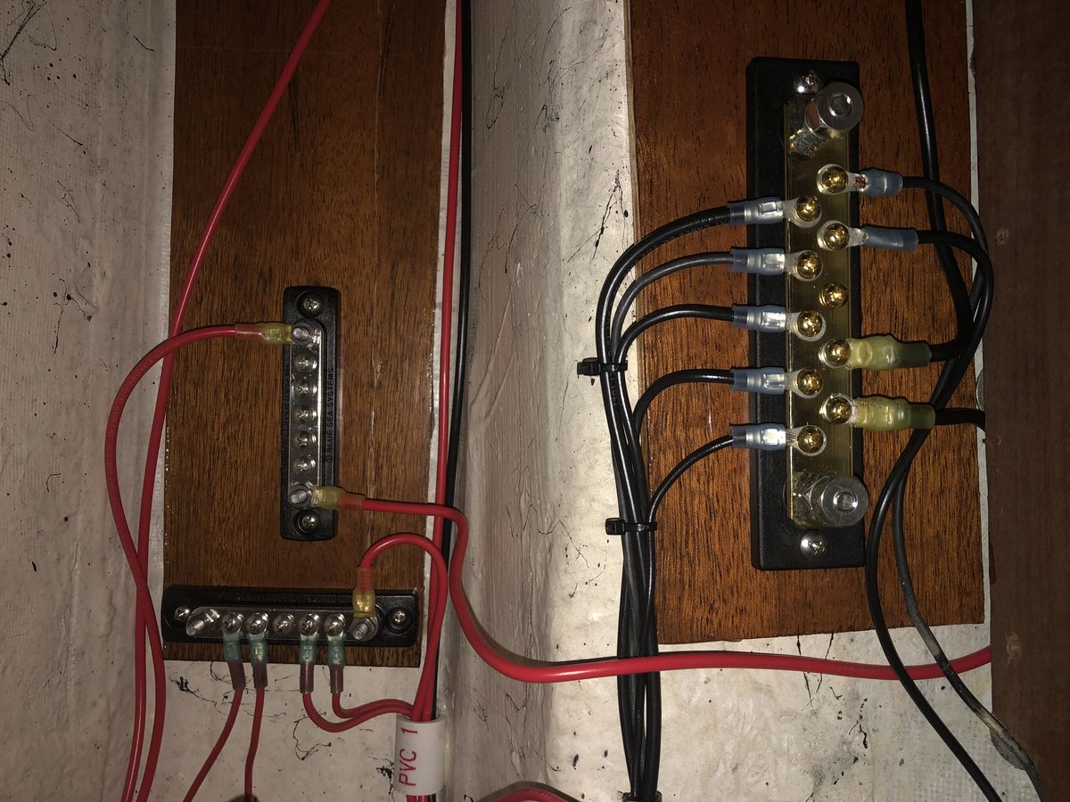

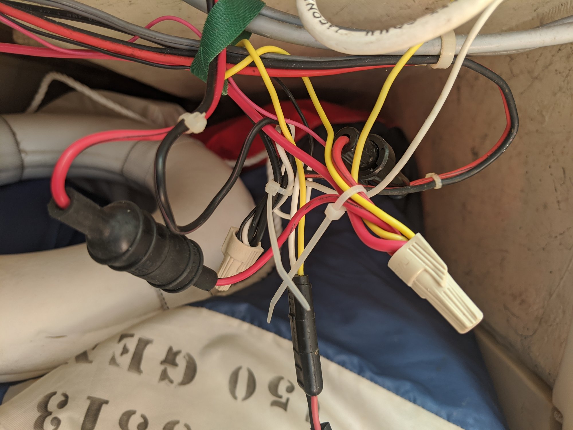

Pulling apart the electrical add-on wiring it turns out that a previous owner used a couple large wire nuts in place of bus bars. I ordered one of these doodads to organize things to mount behind the existing switch panel.
Is epoxying a wooden mounting platform to the rough fiberglass a good solution or will that likely fail?
I would rather not run a screw or drill bit through to the finished side and I have a piece of scrap teak I can use.
The ugly truth
View attachment 175877View attachment 175877
I’d love to see a refrigerator which uses only 2a/h for only 18 hours. Typically, I think it may be more like 5amps cycling 50% over 24 hrs/d = 60 amps/d. Please assign patent rights to me for yours.
Don, you have misinterpreted his spreadsheet. He stated that the current is 2 amps, and therefore after 18 hours it would have used 36 ampere-hrs (not a/hr which is amps per hour and means something else entirely).
That aside, your prediction of 60 ampere hours per day matches to my experience for a 3 cubic foot fridge, albeit in San Francisco Bay where it is currently 68 degrees.
There was nothing to misinterpret there - “I’d love to see a refrigerator which uses 2amps per hour for 18 hours”.
The only reason I highlight the issue is that it accounts for most of the power used so it’s important to highlight.
