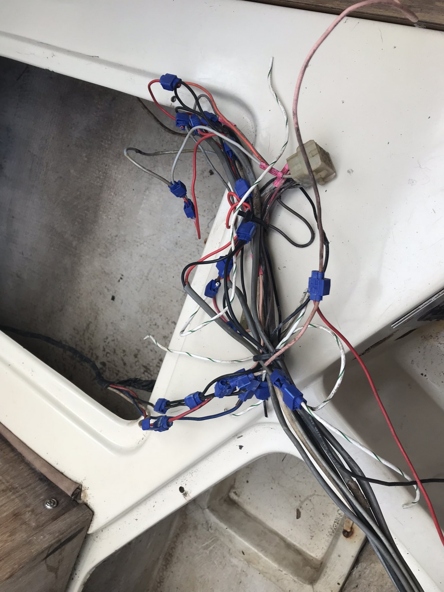

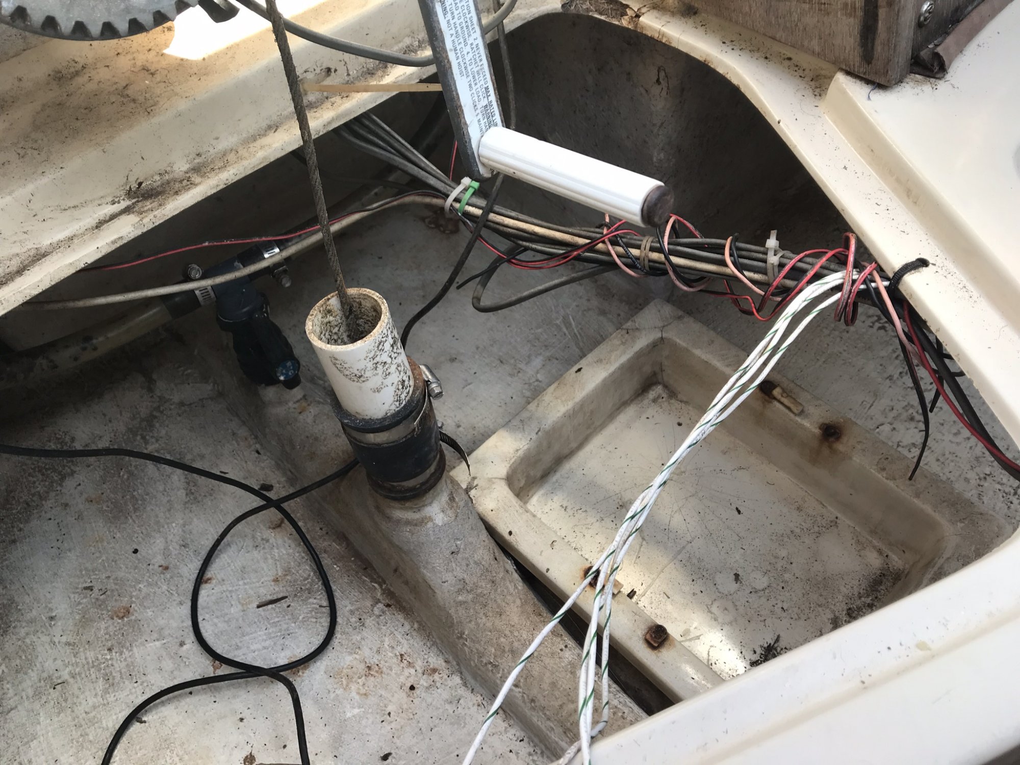

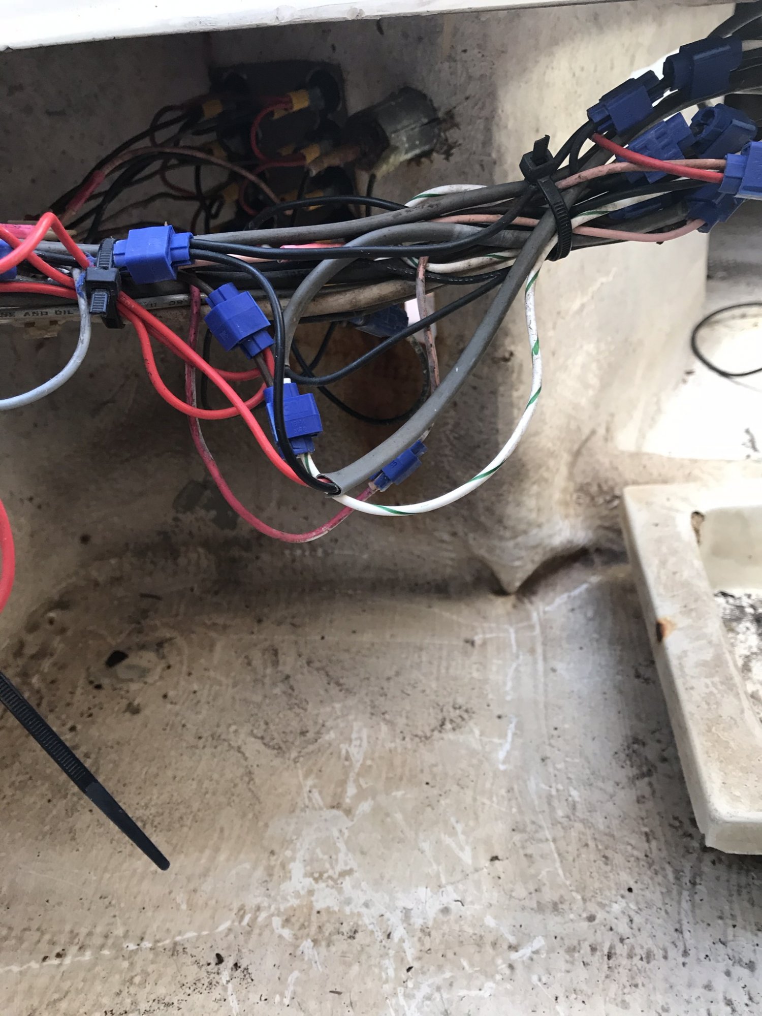

The boat is moth balled for winter now but I plan on redoing much of the electrical in early spring and I should be able to borrow a quality ammeter like a Fluke or something from work and check everything individually. A PO added Radio, VHF, Depth sounder, etc and wired everything with a dizzying array of zip ties and wire nuts to the main circuit so I can't isolate anything with switching but the lights. I plan to move the VHF to the accessory switch and add switches for FM radio and whatever else.

LOL! I feel your pain. I pulled a basketball-sized wad of EXTRA wire out of Daydream, just cleaning it up so I could see what was what.
Since you have a new design ... here's what I did to create a little room for a realistic amount of wiring. I took the first pic of the bus bars lying on my back, head aft, just a couple inches aft of the panel. The solar controller is also on the starboard side, down where the jolly green giant's feet would be.
