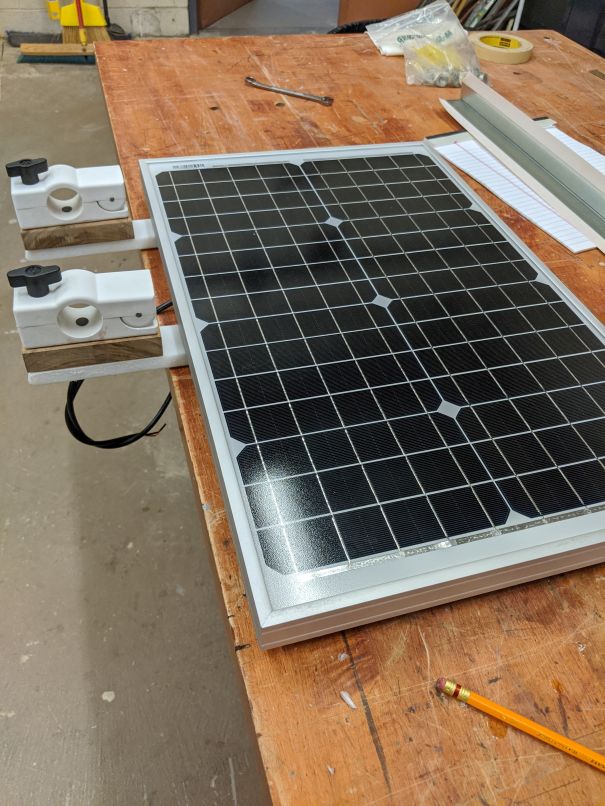

Baby steps during these cold wet months...
Made the panel mount out of a cheap plastic cutting board, some teak and the Sea Dog clamps. Hoping the wood offset will allow for folding it over flat inboard for trailering.
Sep 30, 2013
3,649
The clamps *may* have difficulty holding the panel level, they way the panel is offset outboard a couple inches. At a 45 degree angle it's no problem, but dead level requires a lot of grip. We have to really tighten our clamps 100% to hold the panels level, and that's with the inboard edge of our panels being slightly inboard of the rail. Your panel will have more leverage.
You could always add a third clamp if the panels have a tendency to "sag". But you needn't worry about trailering, I promise the panel will not flap.
Either way, nice work! You will love the result.:thumbup:
Hmm, ya think some grip tape on the rail would help?

If you add a fold out leg on the bottom of the panel that attaches lower to the pushpit at like a 45 degree angle, the panel will never droop.
