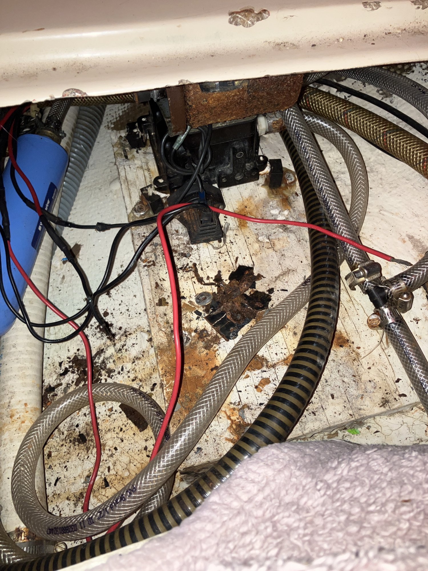

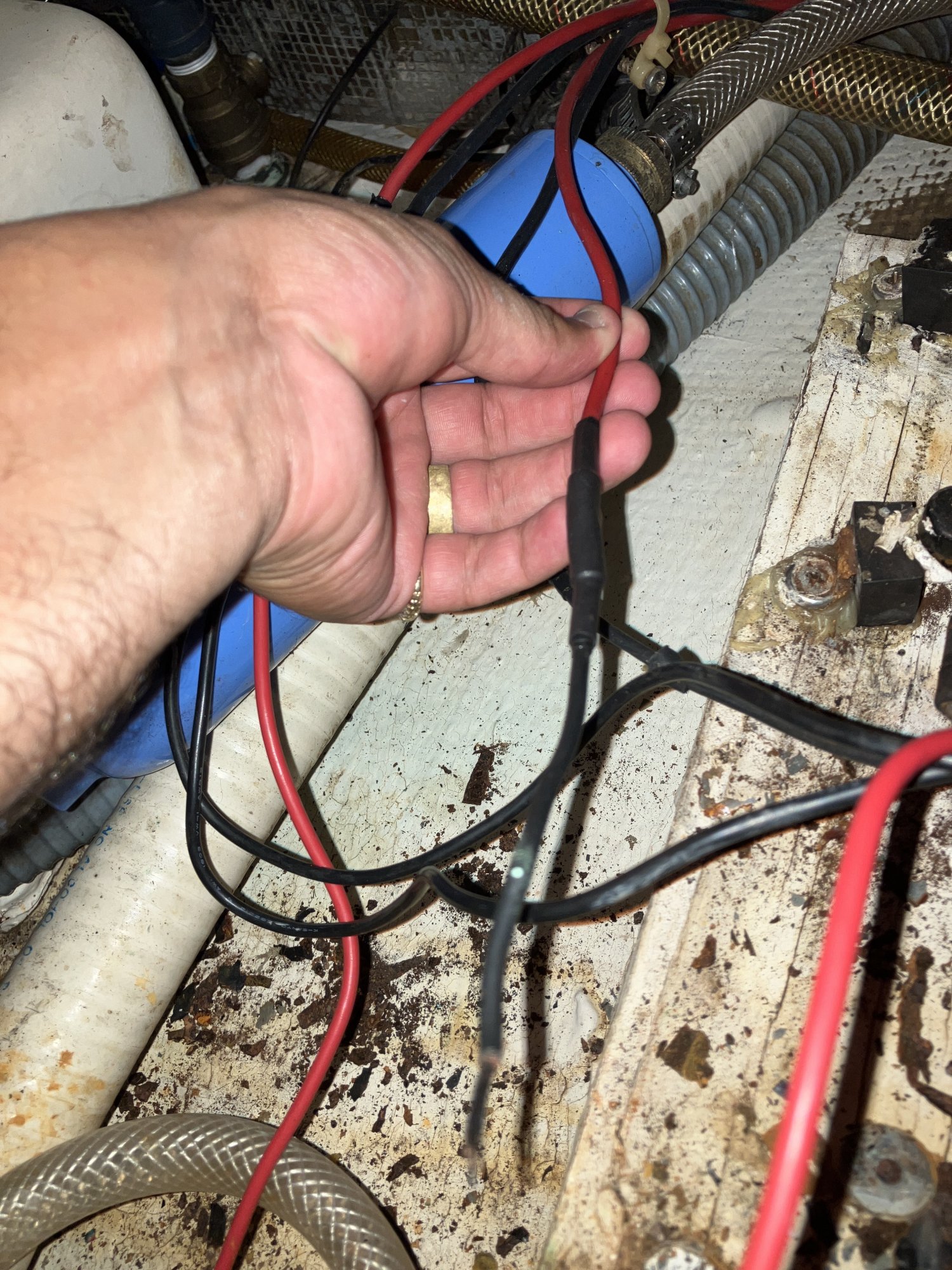

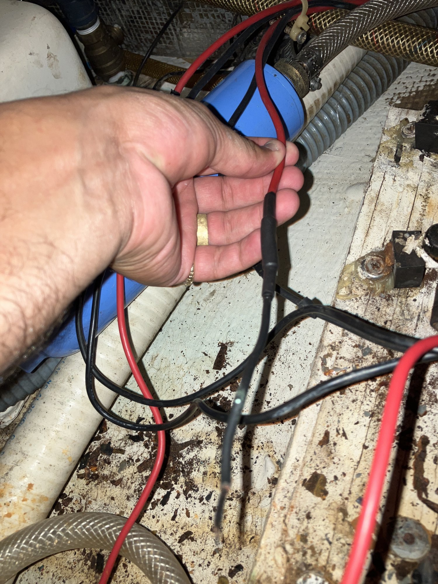

The first picture is the hot red wire. The black wire that it is spliced to is what is maybe 10 gauge, that was on the old piston bilge pump. I was thinking of removing that old black wire that is spliced to the red one and splicing the new long wire I need buy to run to the bilge pump directly to that red wire.

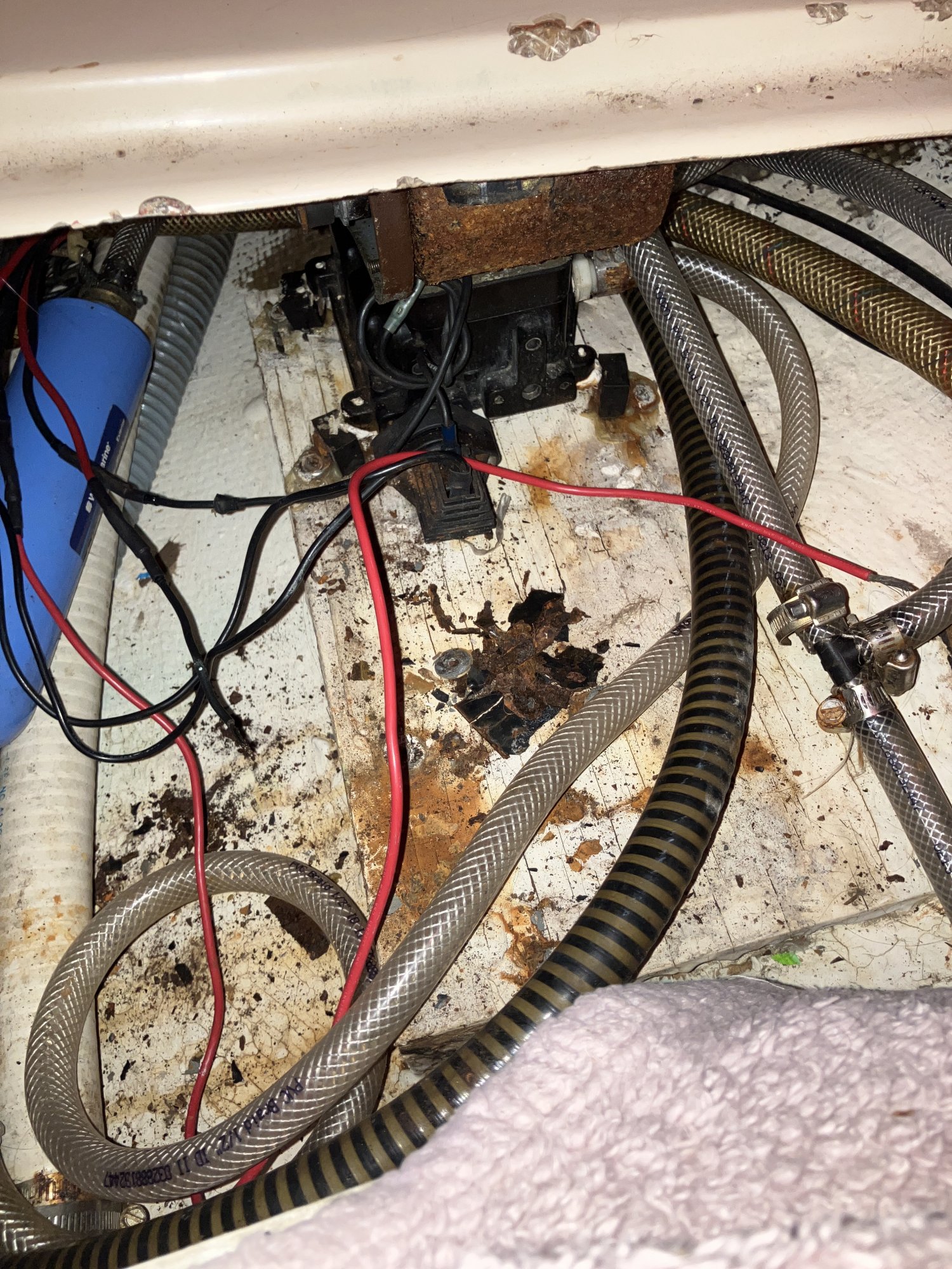

Second photo is where the original Bilge was. That long red wire you see is actually the ground wire, why is it red, who knows.

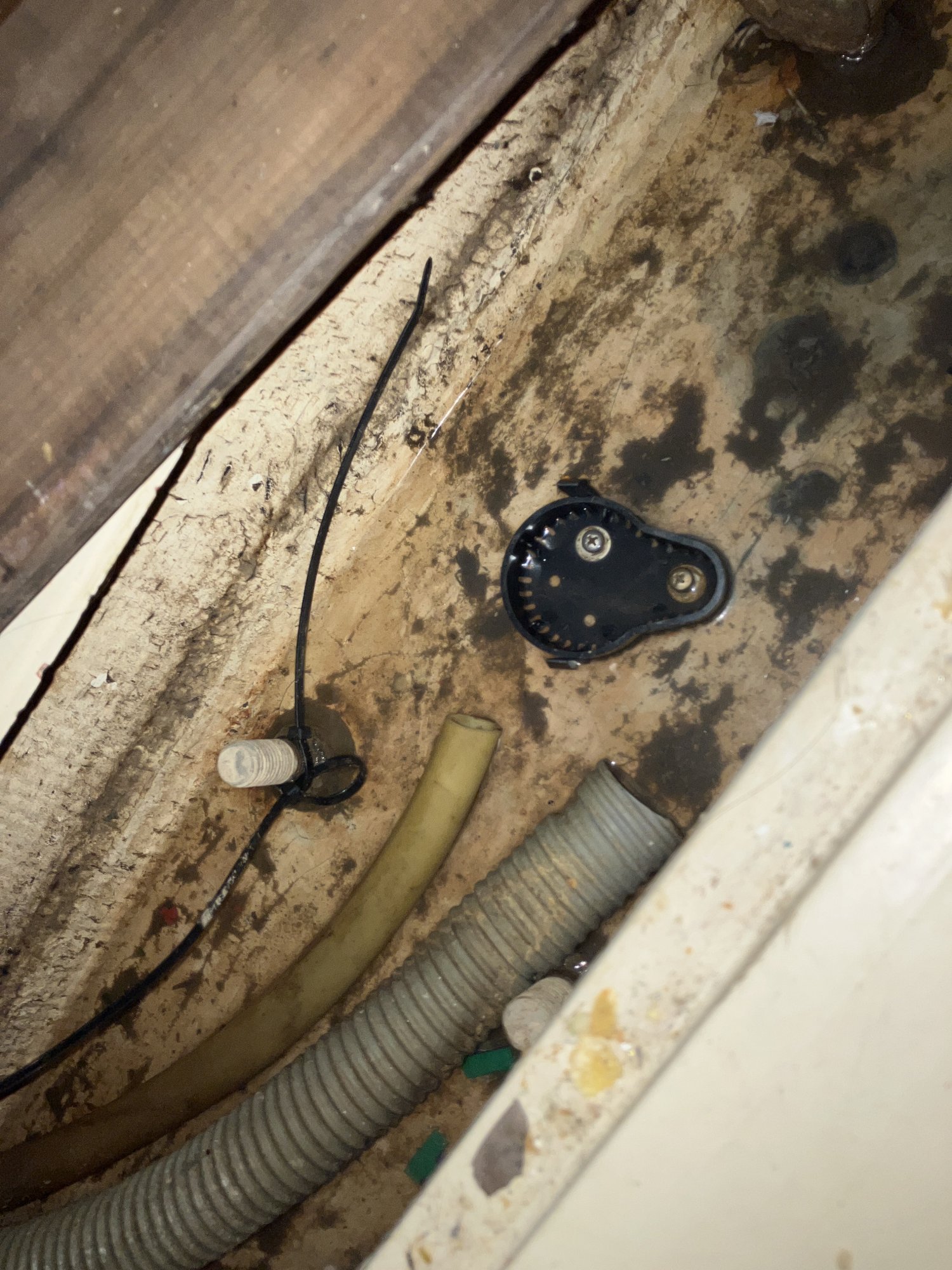

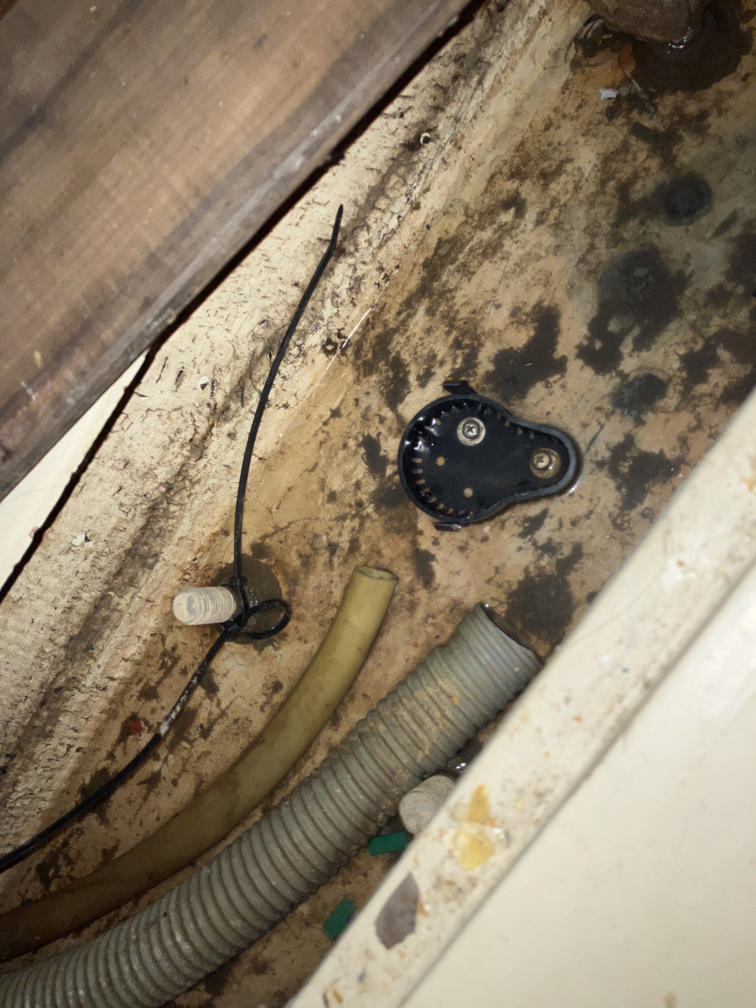

Last photo is where the new bilge pump will be. Partially mounted.

That old black wire spliced to a red wire seems like bad news. Joining red to black invites confusion and accidental short circuits down the road. It also looks like the black might have a chafe mark on it, so discarding it would be good.

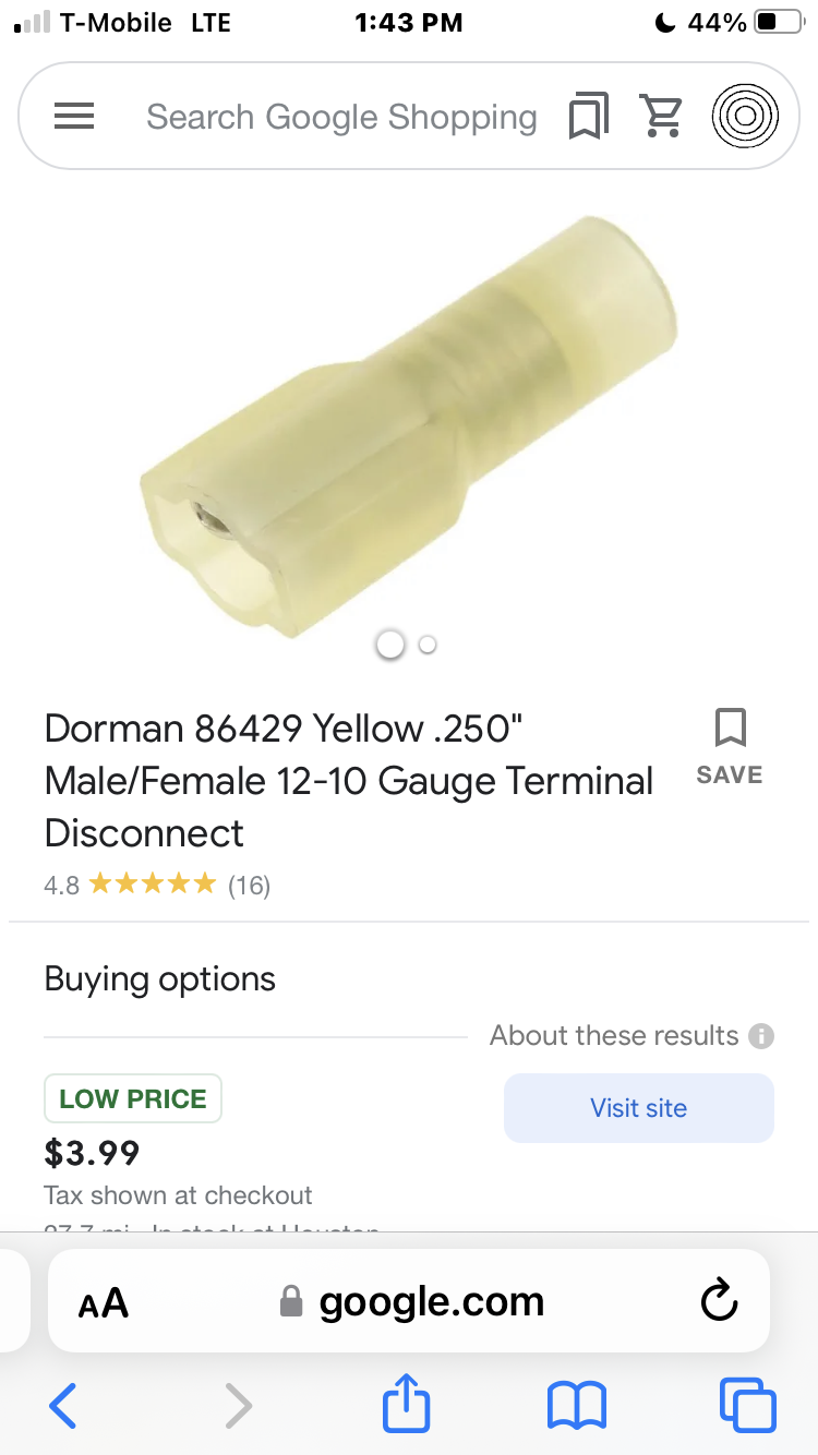

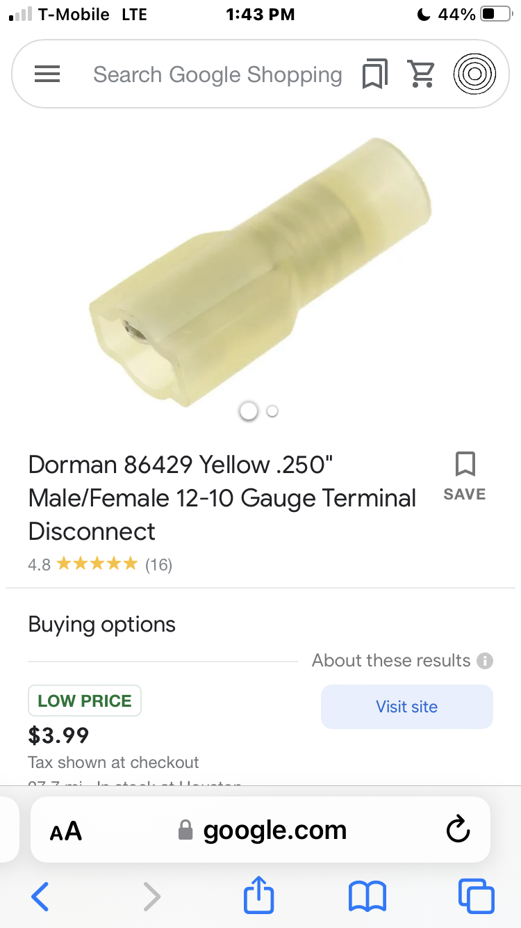

Also, I still don’t really know what the answer was. Was the see through single butt connector, sealing it with marine sealant, and a shrink wrap on top of it all the most effective way to splice 10 and 16 AWG wires?

The quick disconnects dlochner recommended would work. That way you don’t need to worry about finding the right size step down. Just find the quick disconnects for 12 and 16 gauge and make sure they snap together.

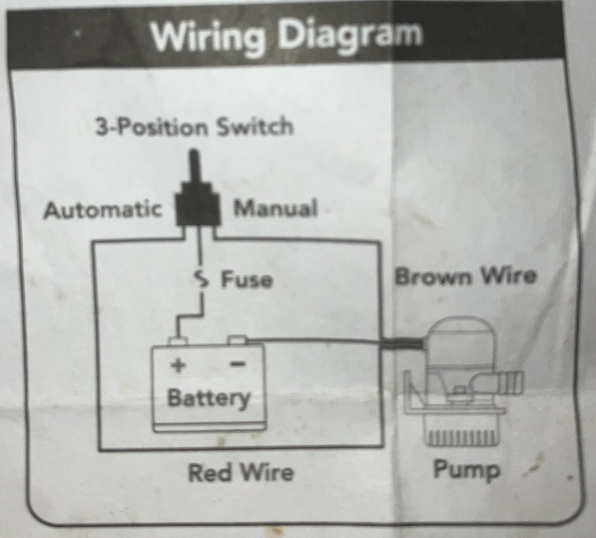

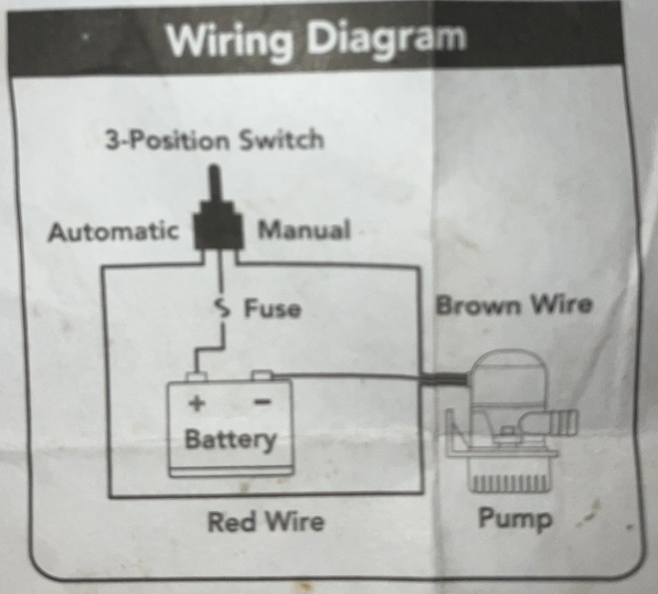

Not to overwhelm you @SailingFree44, but I see that the current 2022 wiring diagram for the Marine Raider 800 Gph Automatic Bilge Pump shows a wiring diagram as such:
This drawing is not the best as it does no allow for a manual test with a three way switch.

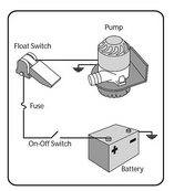

The old wiring diagram you show in your post #6:
....................... does not show a float switch. I also don't see a float switch in your photos of post #24 unless it's located elsewhere. Maybe a float switch is just "understood" but it won't work without one.
Does your new installation include a float switch ?

All good, no float switch, it is an automatic. Has a little ball in there.

Just crimp it down I’m assuming.
That's the way. I would suggest applying GLUED heat shrink tubing as well just over the crimp section. Also wipe a tiny dot of dieletric grease (such as Superlube) over the contact faces so they avoid corrosion over the years.

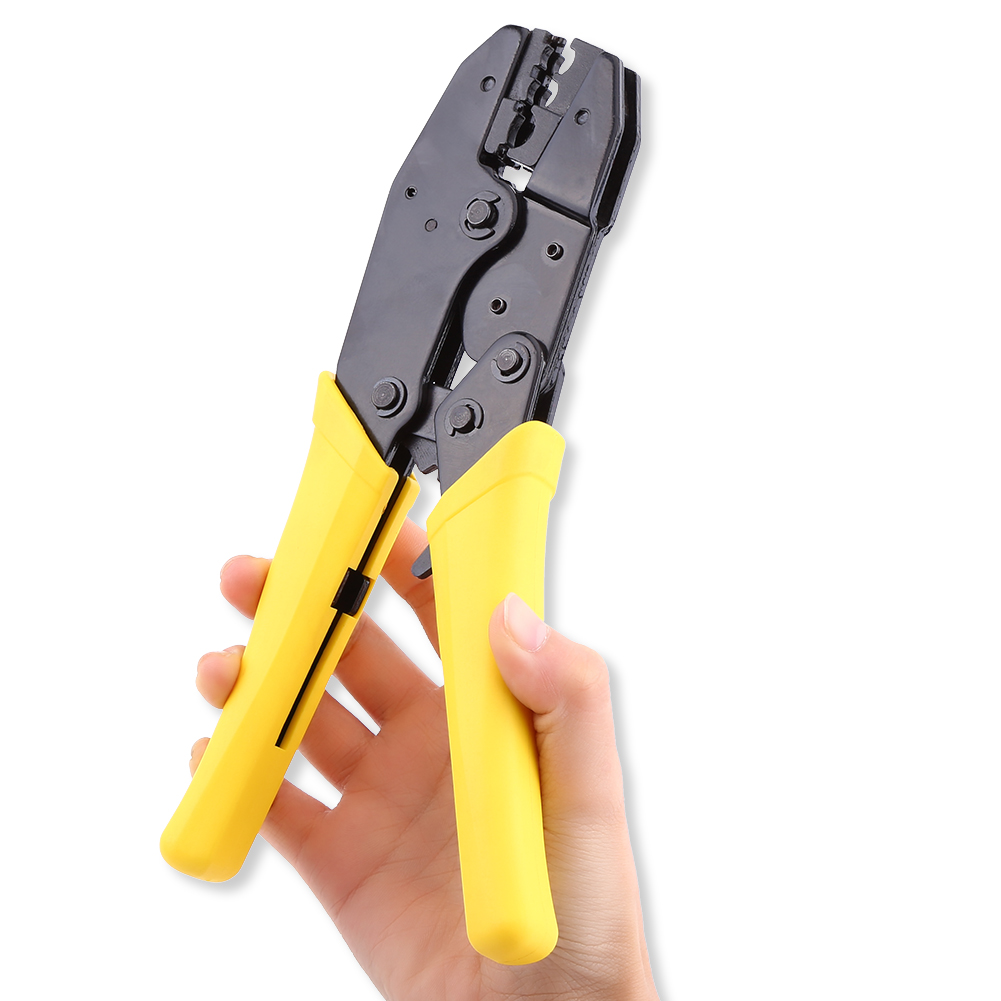

To do the job correctly, get a racheting crimper with dies for insulated terminals. The cheap hardware store crimpers sort of work, however if you are going to do a lot of wiring, the better crimpers will do a better job.
The best terminals to use are adhesive lined heat sealed terminals like these from Defender.com. Lately I have been using them. The quality is good and they are much less expensive than the Anchor terminals from West Marine.

The ratchet crimper mentioned
Looks something like this.
It has three sizes to match the 3 common sizes of crimp fittings.
