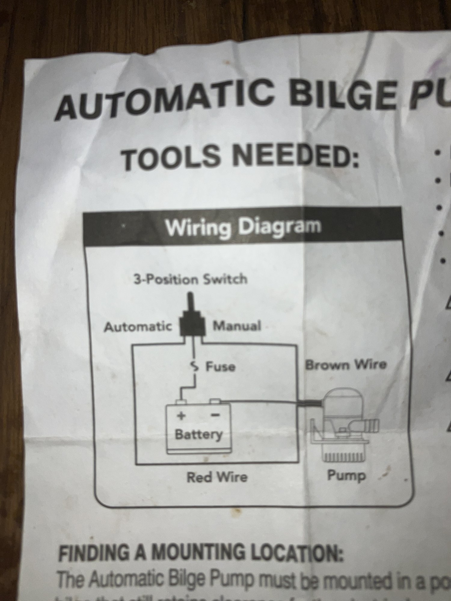

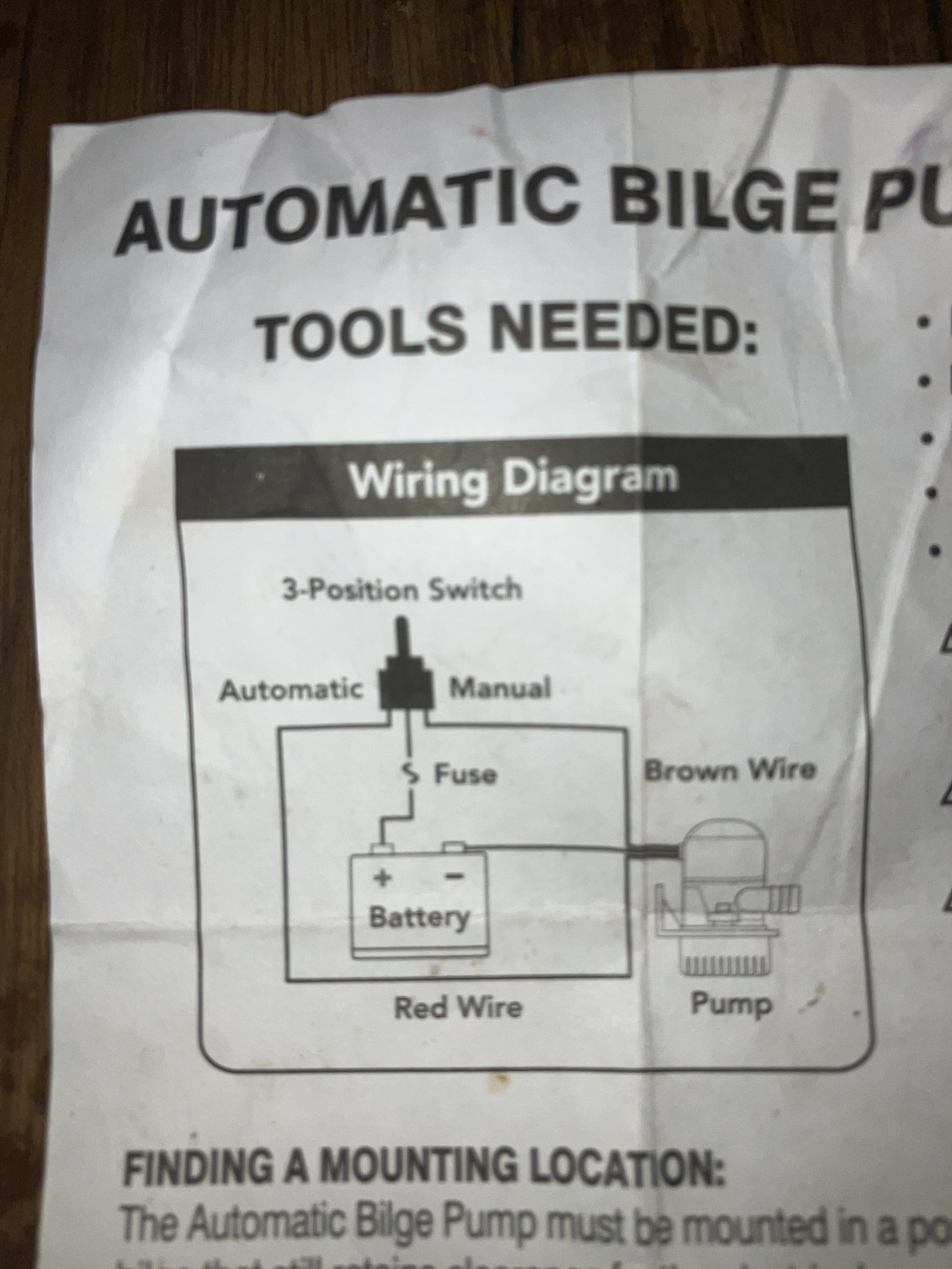

The pump name:
Marine Raider 800 Gph Automatic Bilge Pump.
Cool, that sounds like a plan, both wires with the see through single connector then marine sealant, and maybe it’s over kill, shrink wrap on top it all, to seal the deal perhaps?
And out of curiosity, the difference of 10 to 16 does it matter? Could that overload the pump or breaker? Trying to understand the electrical side a bit more, it is interesting, just complex.
My switch is just a two way. I bypassed the brown manual wire, leaving only the red n black.

Since the PO did things you "don't understand" first thing is to make sure how the power gets to the bilge pump. In my boat, and most that I know of, the bilge pump is wired such that it is powered, even with the DC main off (ie directly from the battery with a fuse in line). It frequently has what looks like a "breaker" but is actually a switch that allows you to run the pump while you hold it in the run position and it spring returns so that the pump will come on when the sensor detects water in the bilge. Just my 2 cents.

The original Bilge pump ran like that. Wether the batteries switch is on all or not, the pump will run, any which way. I like that and I hope after I wire it, it remains like that.
I see, that would be the 16 gauge line I believe. Does that mean I use a 20 amp fuse?
I think it’s odd as well to have these different shaped wires.
That’s why I am being extra cautious. I don’t want to damage anything.

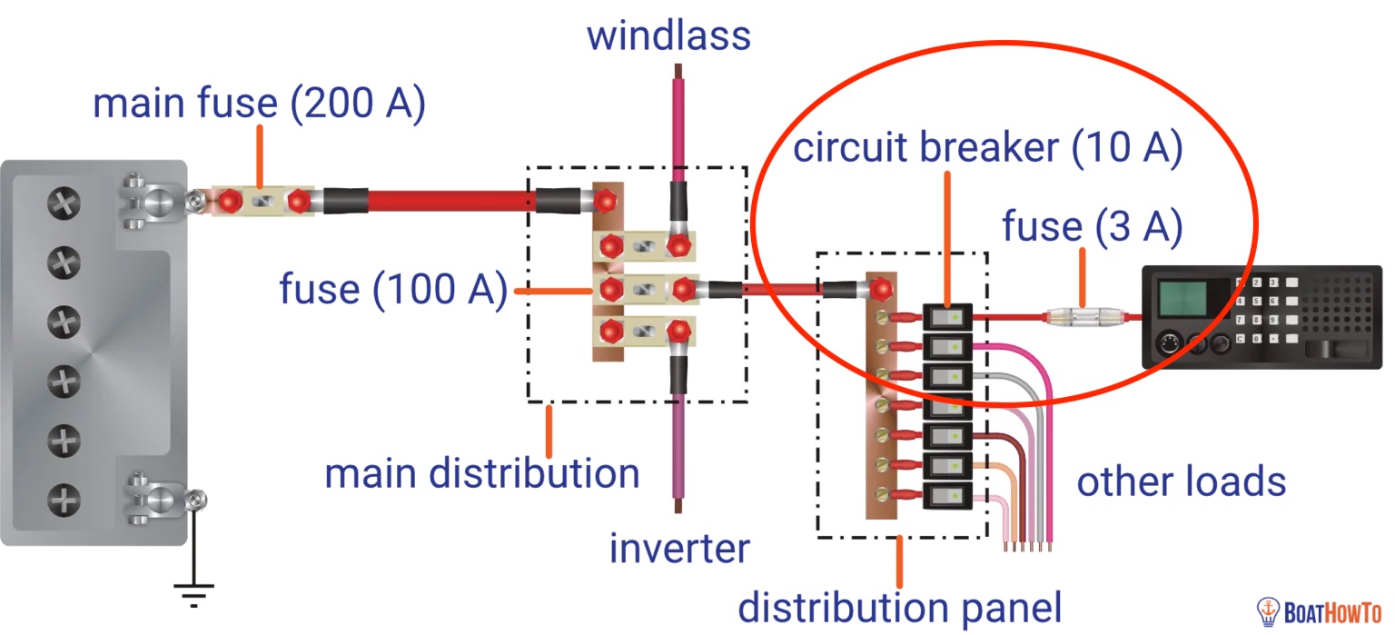

I'm not sure, Dave, we are in agreement or not. I think perhaps not, on a small point. Circuit breakers typically protect the wiring from the CB to the load. If you load has smaller wires, a fuse at the feed to the load will protect the smaller wires and load. So, you can have both a CB and fuse in the same circuit.
See this excellent article:
Fuses & Circuit Breakers: Overcurrent Protection (OCP) on Boats - Nigel Calder

13,967
Really, did you read the whole post? Let me quote:
Fuses and circuit breakers protect the wire, not the device. Think about it, the fuse will blow if there is an over current situation on the wire. Broadly speaking overcurrent when there is a short in the wire prior to the device or when there is a failure within the device. The fuse protects the wire after the short, not before the short occurs. The fuse should be sized to protect the smallest diameter wire on the circuit.
Sometimes a larger diameter wire will feed several devices, in these cases each individual device will need circuit protection (fuse) at the point at which it connects to the larger wire, typically a terminal block or fuse block.
Emphasis added.
