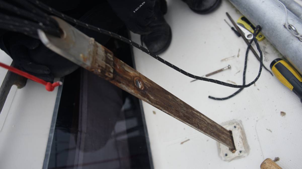

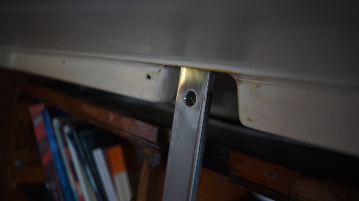

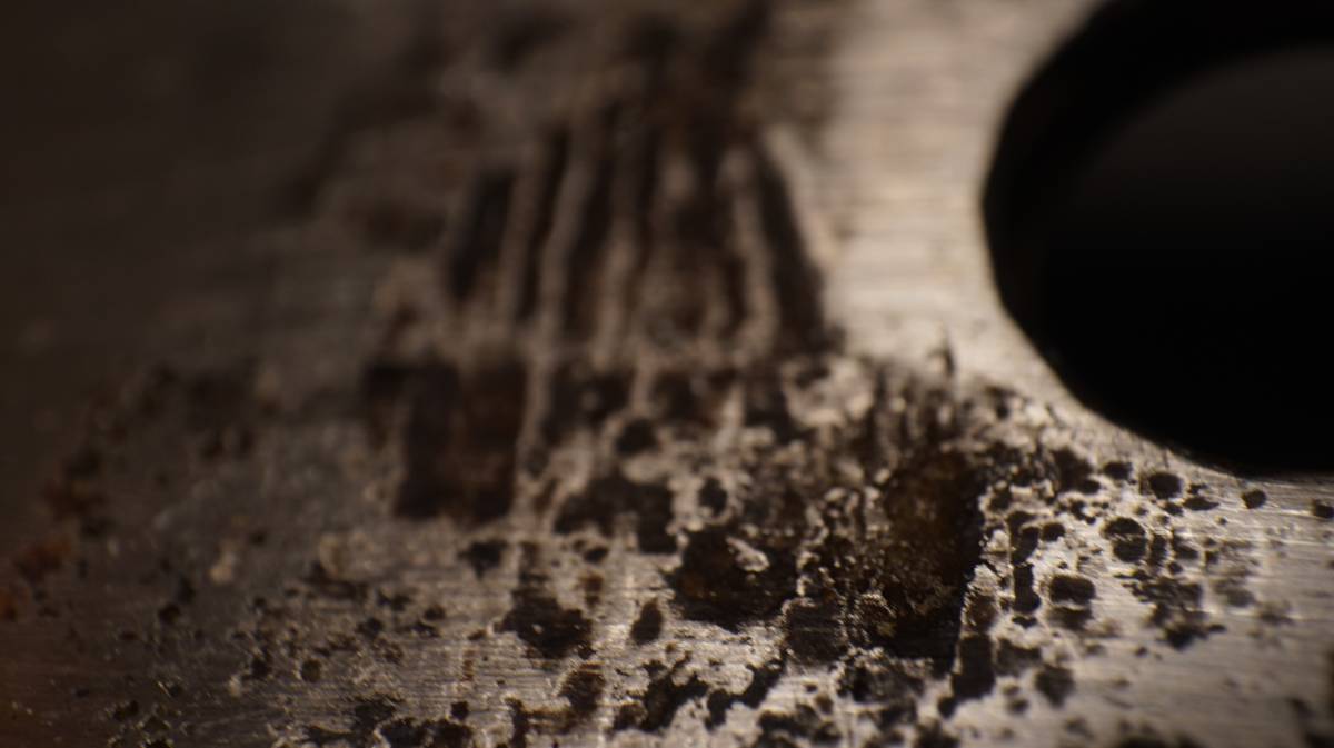

Am currently pulling the chainplates off my boat(tall rig, engine in the back). Found some pit corrosion in all of them, and one of them had a crack (near a welding point). I'm waiting for replacements at the moment. I was wondering if anyone here has had trouble with the glassed SS anchors that the chainplates are bolted to? Have you ever found pit corrosion or fissures on yours? It would be silly to replace the chainplates only to have the bottom anchors fail.

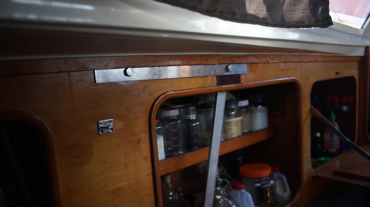

Since my chainplates had some wear, I wonder if the 'anchor' that is bonded to the hull has suffered the same. Although, because it's not technically removable(glassed in) it makes it difficult to inspect, esp the area into which the chainplates slide into (that sort of deep 'U'), it's to narrow to fit anything XD...

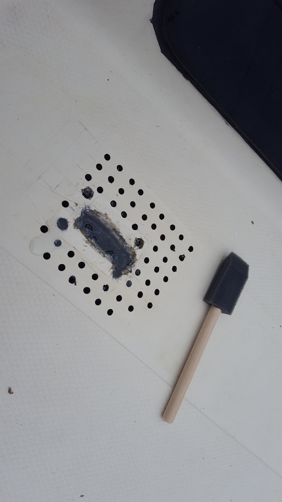

Unfortunately removing the chainplates also revealed some mulchy marine plywood core around the edge of the hole... it ought to have been sealed/glassed in out of the factory...

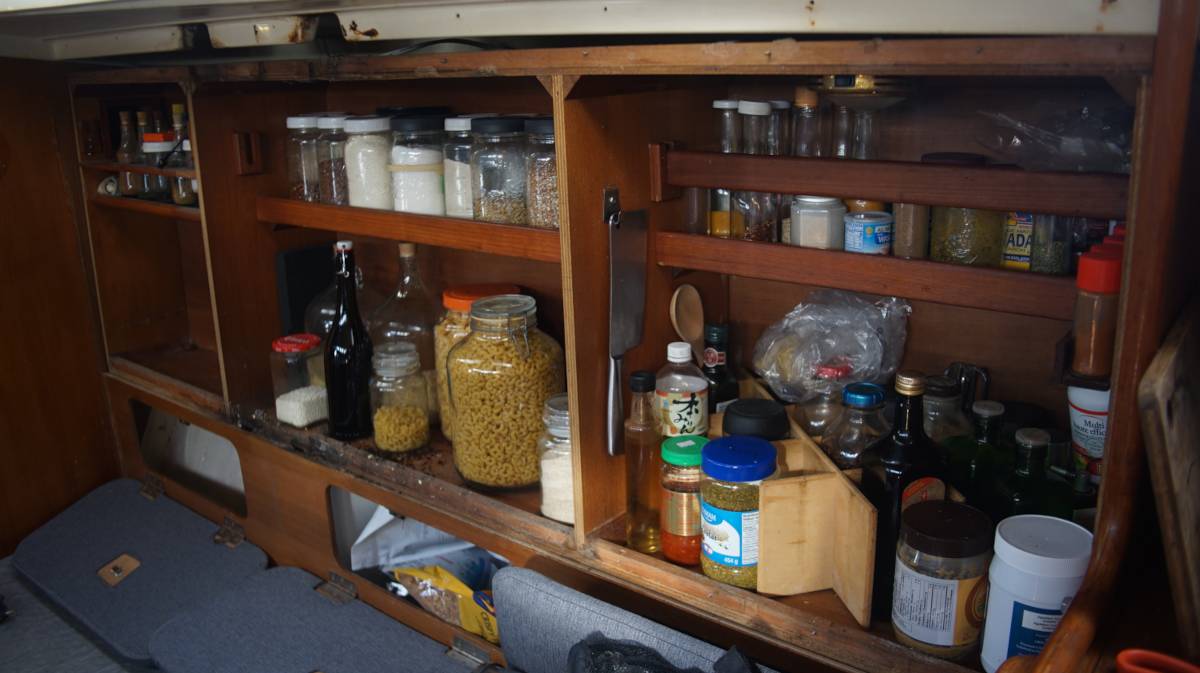

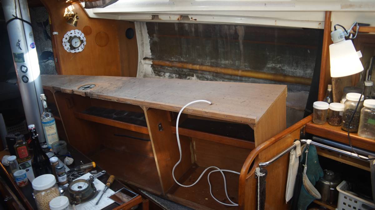

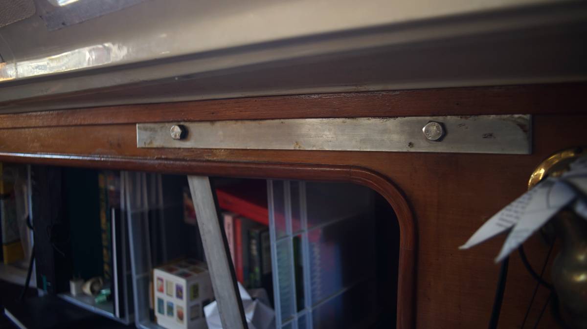

Side note: Removing the chainplates also permitted us to remove the whole starboard side cabinet! After many years of hard sailing the front panel had mostly detached from the back... some of the screws were bent. All of the boat's wiring was replaced last winter but some of the integral wire conduits were jammed with old wiring(we couldn't reuse them), with the cabinet off we were able to get the thick wire braids out and free the conduit
.. it's ready to be new wires now!
