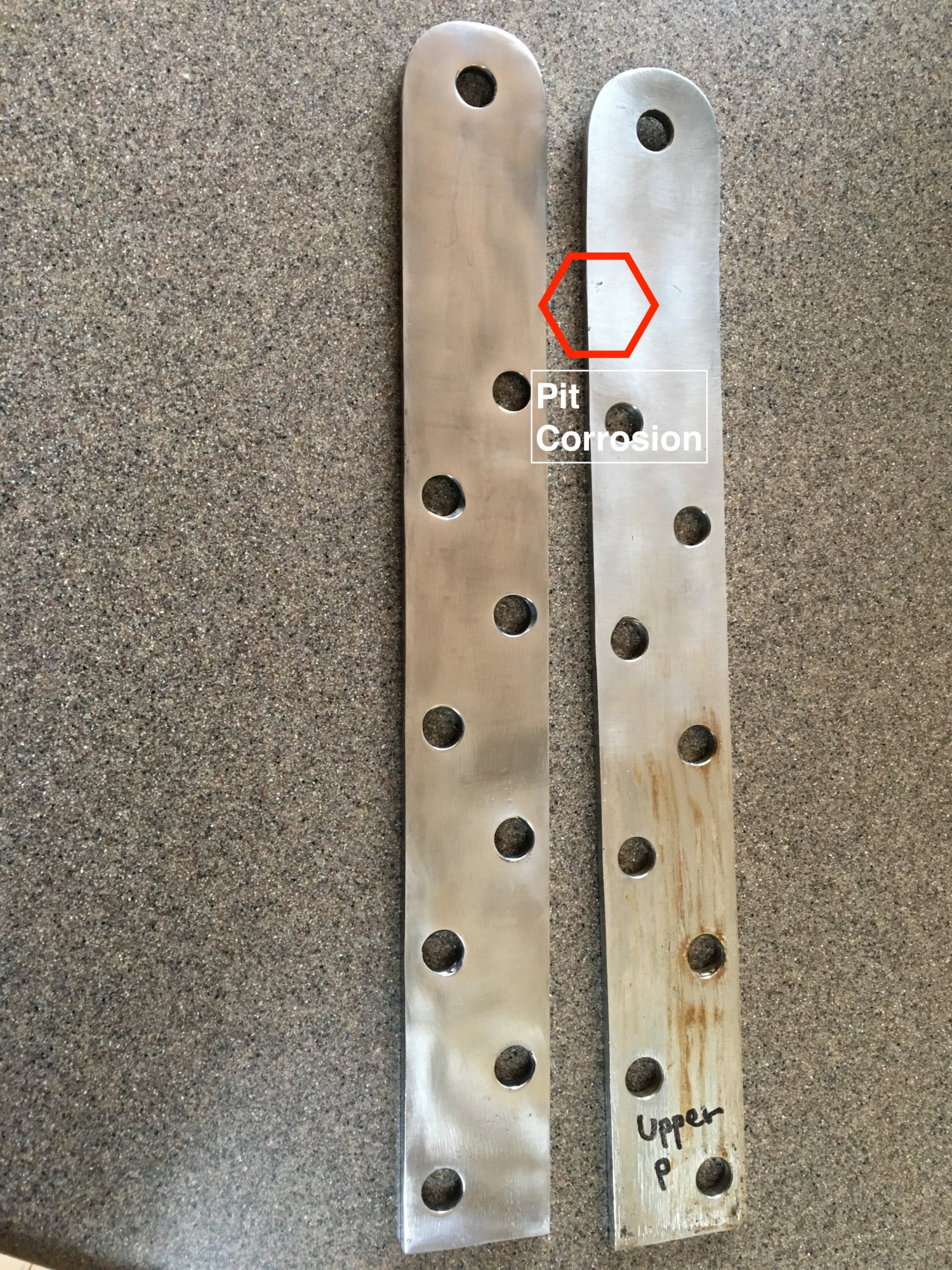

Mike. Such Corrosion is not unusual on oder boats. It would be great if you could share some pictures of your chainplates. Might help other sailors with this issue.
Here is what one of mine looked like. I polished the pit out and then pacified the metal before reinstall.
I used Butyl on the reinstall. No leaks.

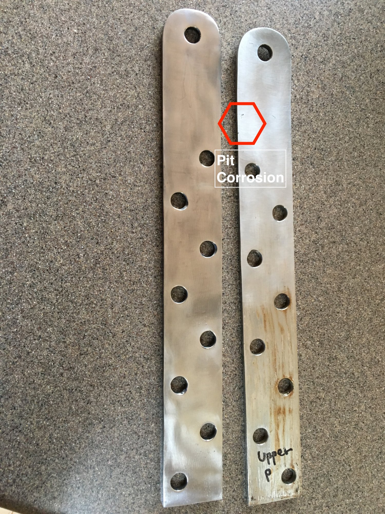

Chainplates: I was told that the corrosion can work its way inside the steel.

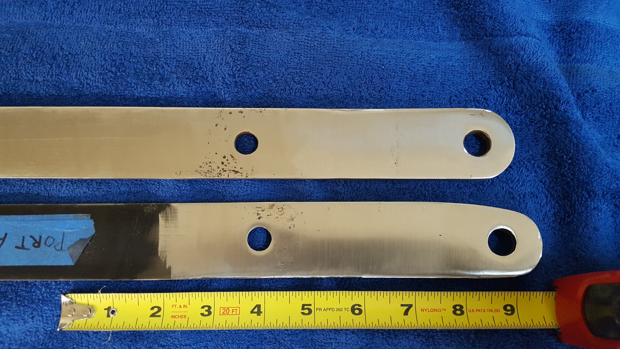

There was also some minor deformation of the holes. And more corrosion.
24,872
Good image of pit corrosion. When it looks like that it might be a surface blemish or it could be rotten inside like a termite had hollowed out the interior of the steel.
