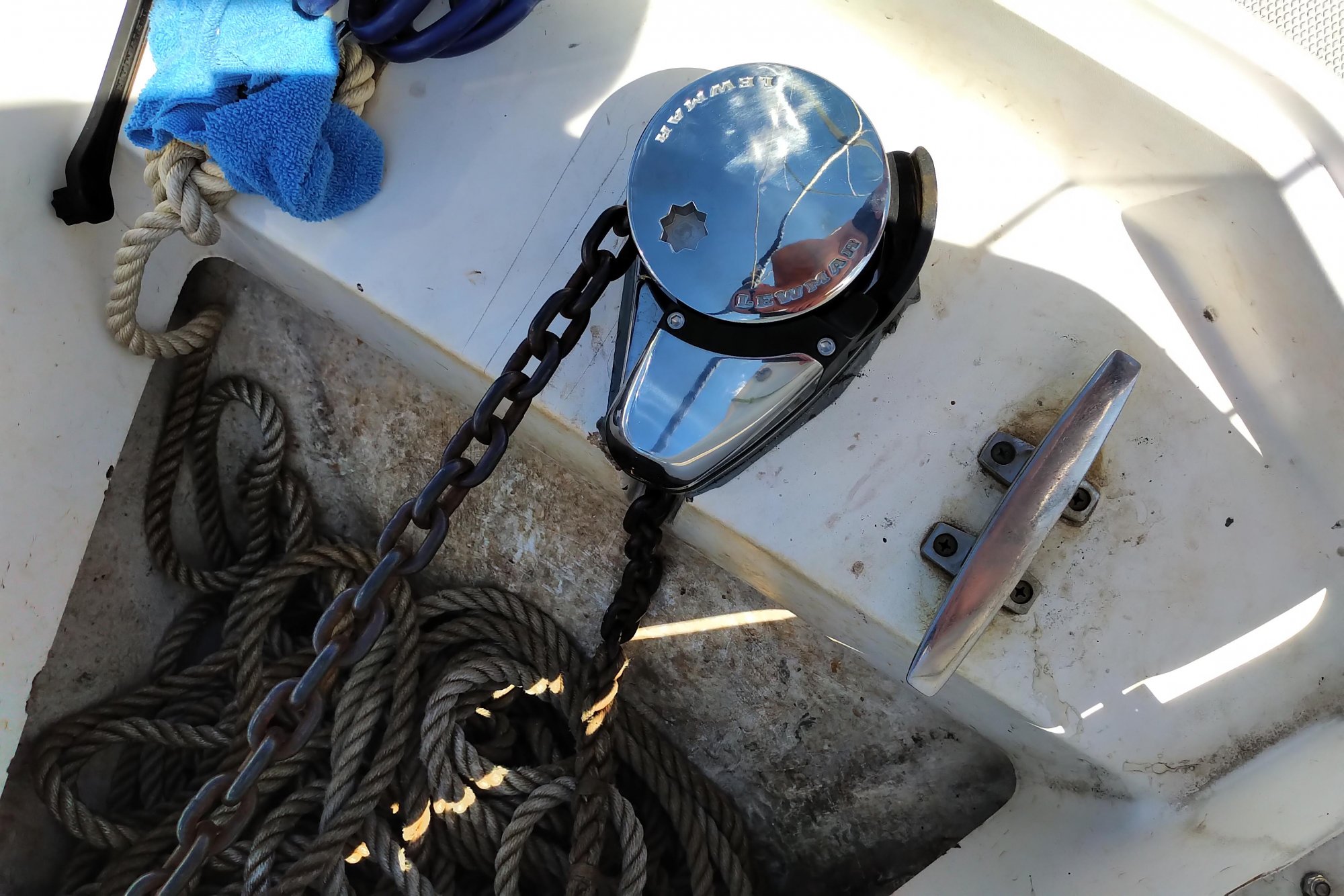

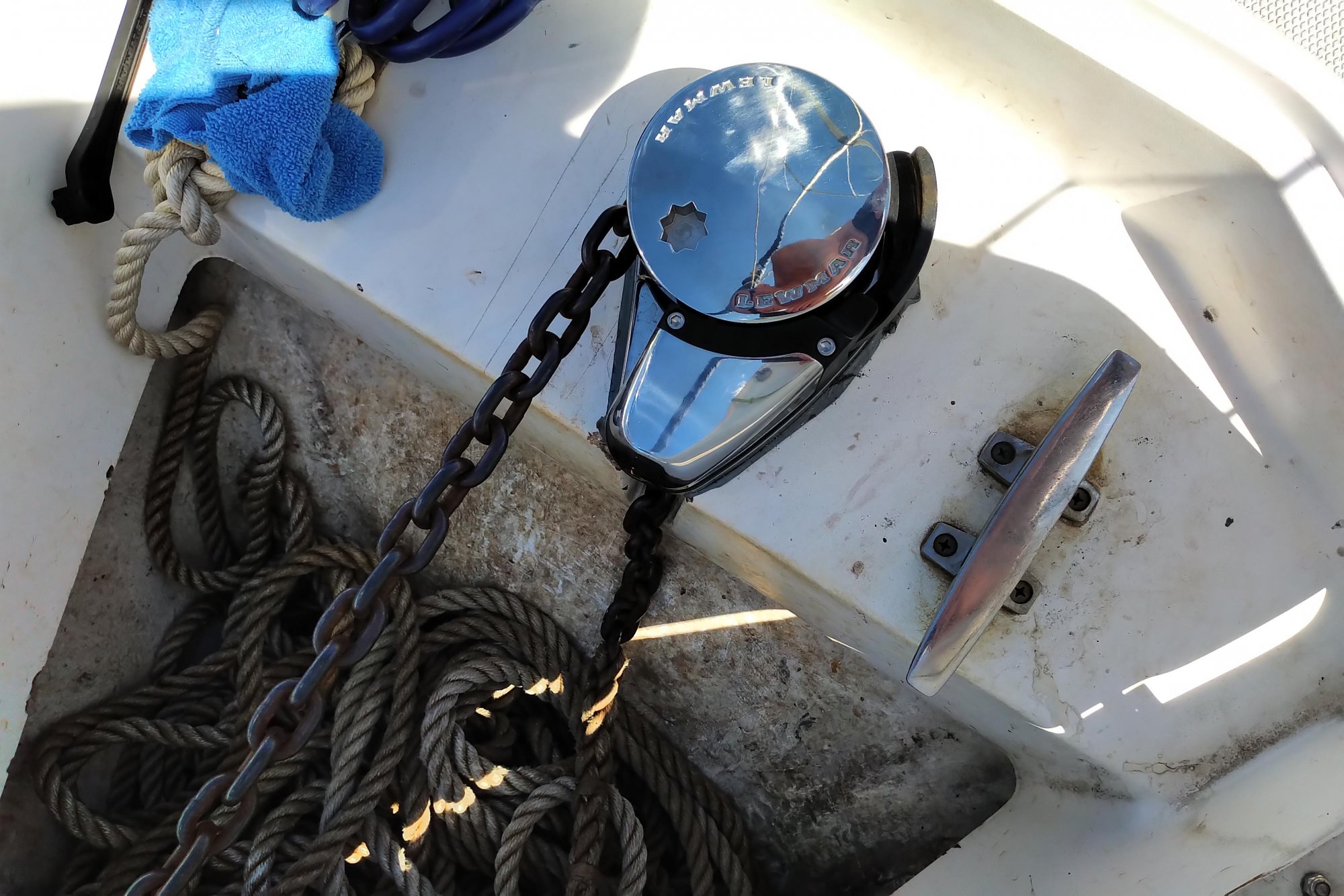

Do you have any pictures of your set up? Got mine installed and it jams and the gypsy stops spinning ut the motor and cap keep going. Even with tension off all together it stops turning.
Aug 22, 2018
59
Hunter 33 Prinyers Cove, PE County, ON

Scott B could it be that the splice may need some attention. Not all splices are created equal. I know that I have had to pull a splice or cut a splice out and redo to get it to lay down correctly. Sometimes in a hurry the splice is not properly tapered. So it comes out looking like the Hunchback of Notre Dame. Redoing the splice with a proper taper may just solve the issue.
The splice is paretially visible in my pic above. I beieve it was done correctly and taperes, it's just thicker due to the splice itself.
24,673
Yes I noticed that there is a bit of a shoulder and that the splice was whipped.
Check out this video link. It may help.

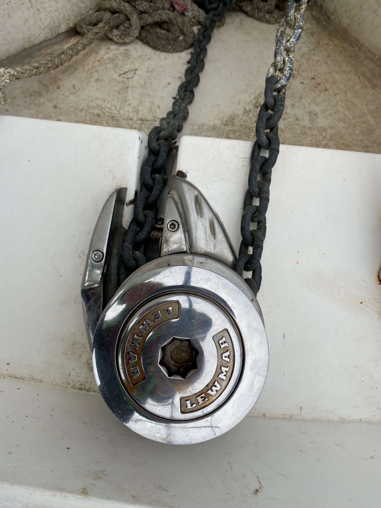

Can anyone identify this windlass on our Hunter 33, 2008? Lewmar seems to think it’s a V2/V3 but the base doesn’t match with the parts diagram. Someone here mentioned a Hunter / Lewmar base?
Our windlass also jams if the chain is not manually fed into the chain locker - not the best design if you ask me.

@woofetc Can you take a picture of the motor on the inside of the boat? It would help in identifying the windlass. You could find the serial and model number on the motor.
Looking at the top (the Gypsy) it has the looks of a few years ago. I note that the chain has been wearing on the front guard plate of the windlass (the 2 grooves between the chains). Perhaps a previous owner did not secure the chain to a cleat and just left the windlass to hold the boat in position. Or they used the windlass to drag the boat over to where the anchor was set. The chain coming up and over the bow roller is not at the correct angle and it drags across the guard plate.
This could be a factor in why the windlass jams.
