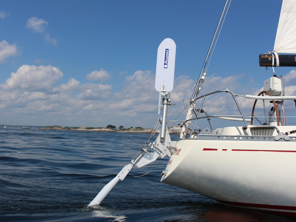

You have a lovely comical style of writing Yes I understand they need an eye kept on them. I have the chance of a sailormat which the bloke had said would require no lines, only the wheel locked fore and aft. I can only find Sailomat on YouTube with ropes to the wheel I would really love to hear from and see pictures from a person with one mounted on their passage 42. Is your yacht a passage 42? Scallywagger
11,712
CAL 35 Cruiser Portland OR, moored EVERETT WA
No. I have a Cal35C. Most vane sites have a gallery of pictures that help with install issues. As an observation the install is about location. Setting the structure on the strong points of the boats transom. The monitor and Aries need to be on the mid line of the boat. The Hydrovane indicates it can be installed off midline. The transoms of boats are stronger near the edges of the hull then in the middle. So my monitor has braces that are designed for each boat.
Looks like the images on the Sailomat has a line running to the cockpit.
Not sure why. This link might help.

Scallywagger, I think there are lines running to the wheel or tiller In the cockpit. They may be fewer or smaller but the report suggests the lines transfers the power from the unit to the boats steering.
I read the following about their 700 model.
“The energy required to move the wheel or tiller is thus extracted from the waterflow by the servo blade.​
Several different line circuits can be used with the SAILOMAT 700. In contrast to previous systems, the two pull-pull lines from the pendulum body are initially running upwards from two unique 'wing' lever arms attached to the pendulum. This permits simpler block positioning, and keeps the transom or walk-thru region more accessible and clean from 'line-clutter' often seen with other systems.“​
The lines have to run somewhere.

Yes, I see the lines. The Sailomat in Spain for sale £2200 which includes the post, the gentleman said I would not require lines to the wheel which, in a centre cockpit Passage 42 is a long way from the transom. Look, I can only thank you for all your information as its a learning curve for me, I've never used wind vane. 400 miles + crossing the North Sea is fine on autopilot but, the wind vane is the way forward for thousands of miles I'm sure you'll agree. Ill keep on with my research and, I will buy one. Hopefully someone joins the chat with a Passage 42 and photos of a vane fitted.
