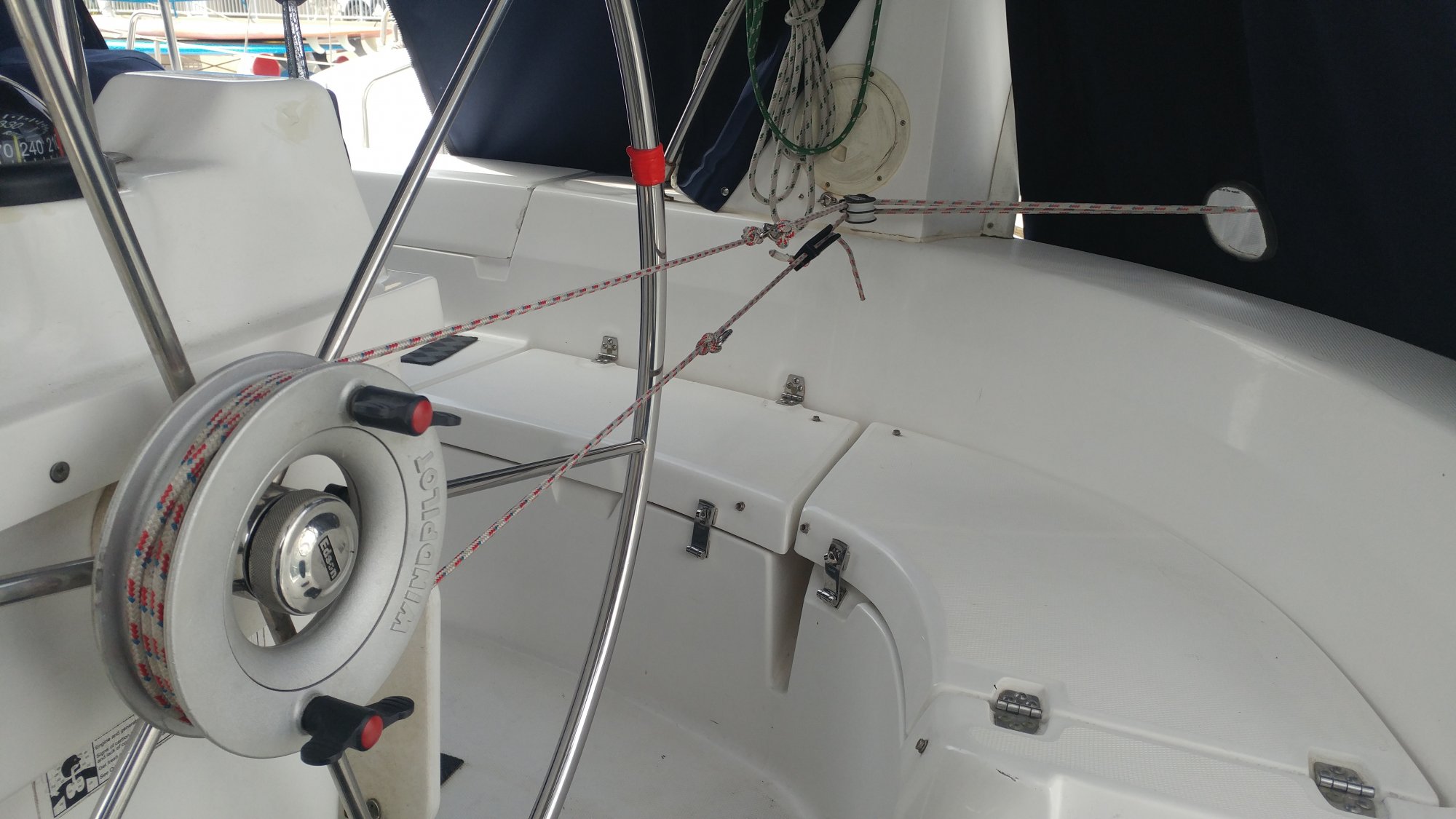

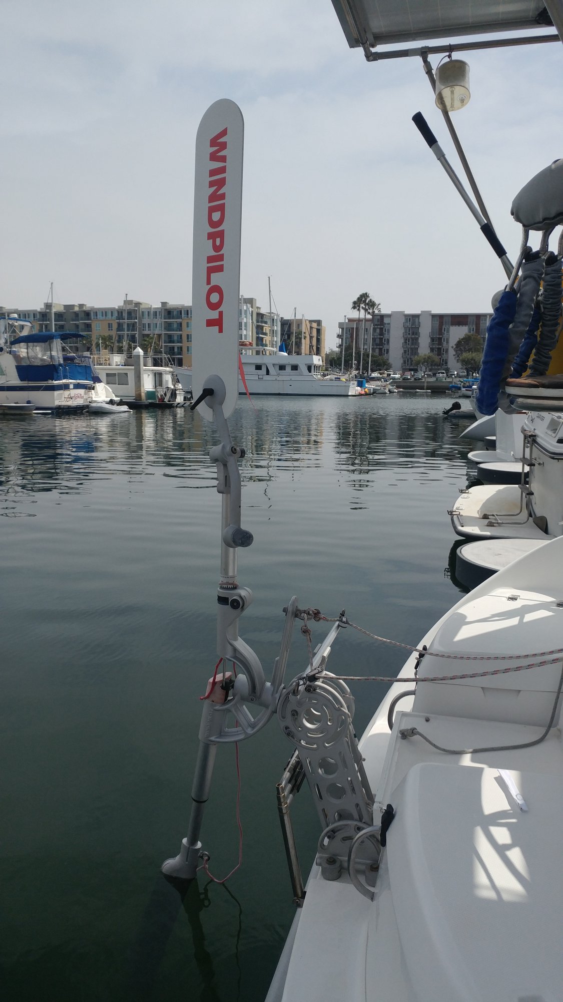

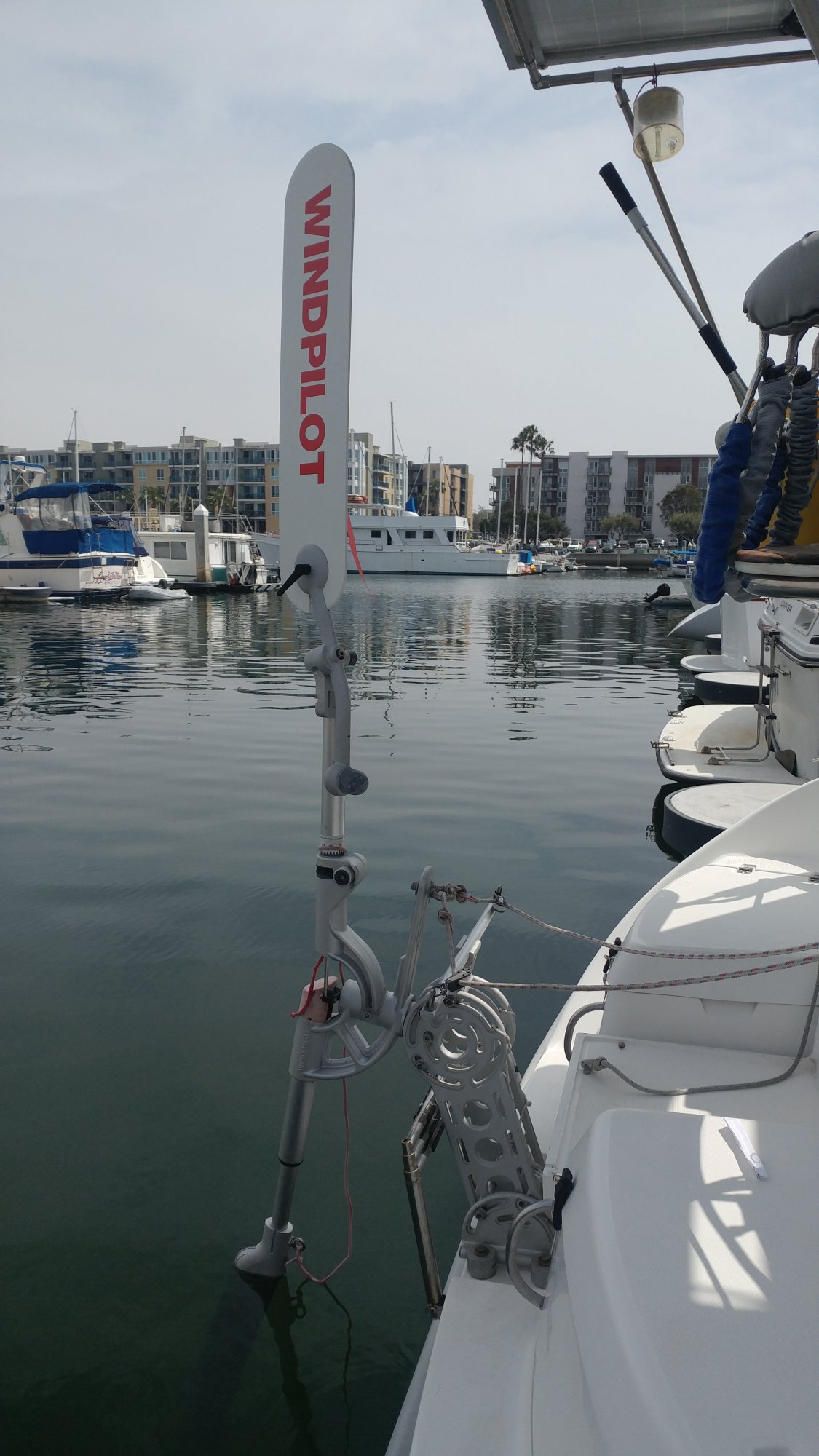

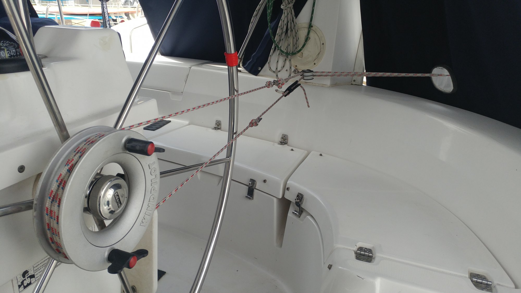

Sailomat did make the 3040 model (no lines to wheel)which had its auxiliary rudder driven by a servo pendulum. Production stopped many years ago, getting parts/ a complete used unit that fits may be difficult. Not sure they sell new units at all right now.
A Windpilot Pacific plus uses the same auxilluary rudder system and is still in production.
I use a regular Pacific model, lines go to my wheel, really simple and straightforward. Our transom should be very close. It would work on your boat.
Feb 21, 2014
137
Hunter Passage 42 St Andrews Scotland
Hel
Hello. Yes that would work and, there is one on ebay UK used only several times £2850. I would like to try and get one without the strings but, that may be the only option, rope to the wheel. I'm getting there
