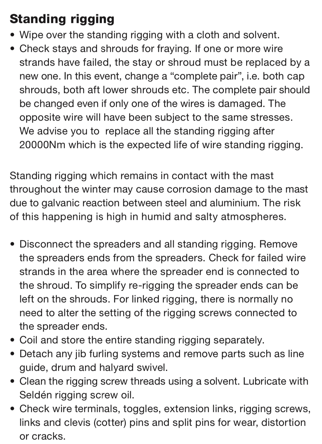

I’m sure that this Selden guide
has been referenced before but there is one section that has altered my thinking about off season mast storage
I have never considered the impact of having the stainless wire rigging being in contact with my aluminum mast. I’m not positive but I recall seeing many masts on racks at marinas with rigging still attached so I’m not sure how much of a risk this is.
