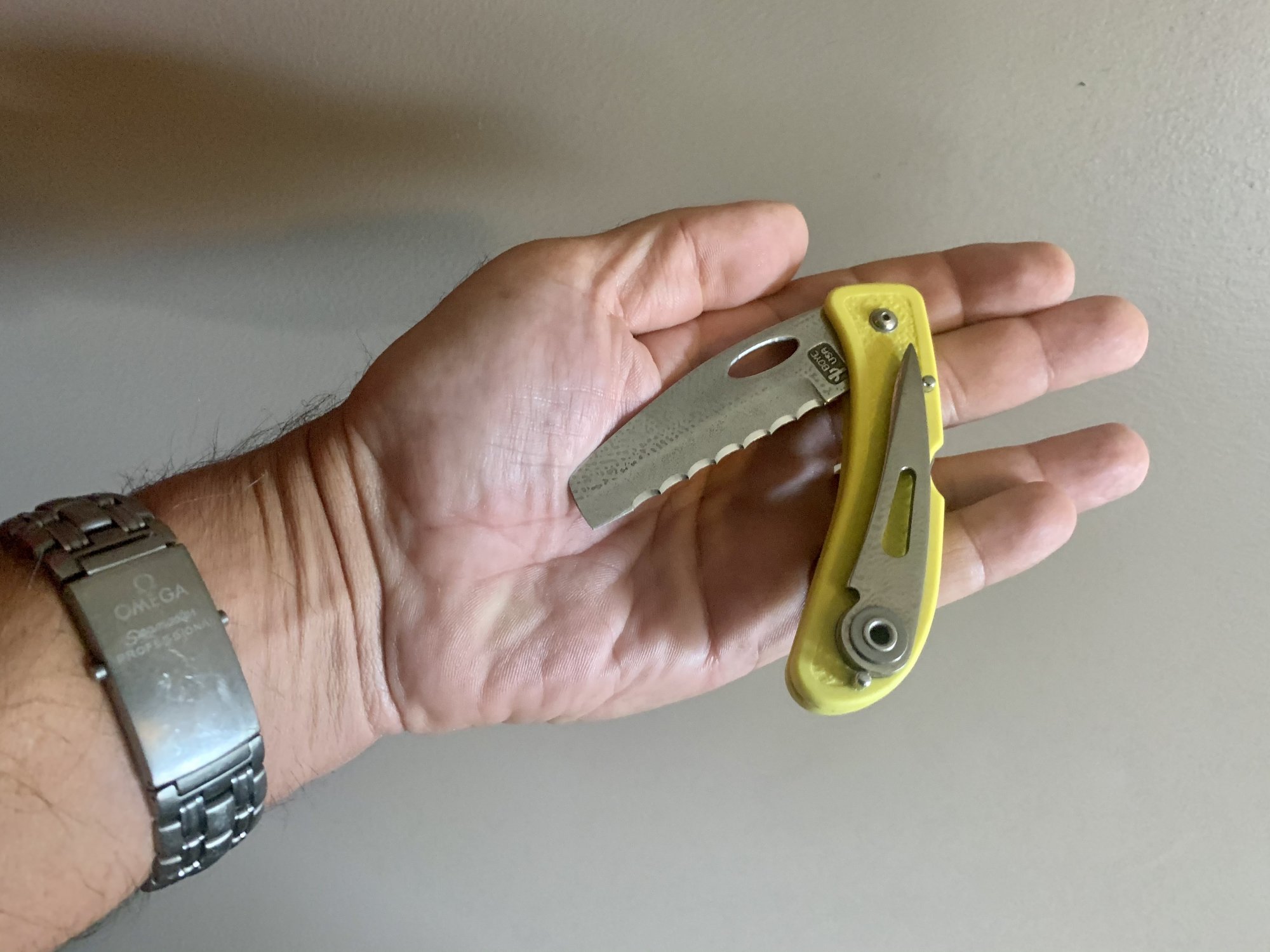

That’s why you always used blunt tipped knives on boats. Every crewmember carries one, and we have two secured on the boat. One of the tiller, and one on the boom vang - you can see it here taped to the bottom of the strut.
