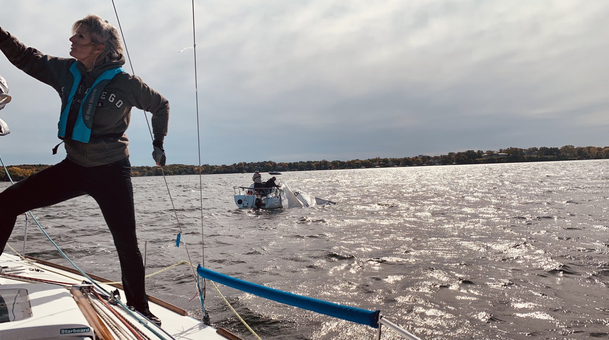

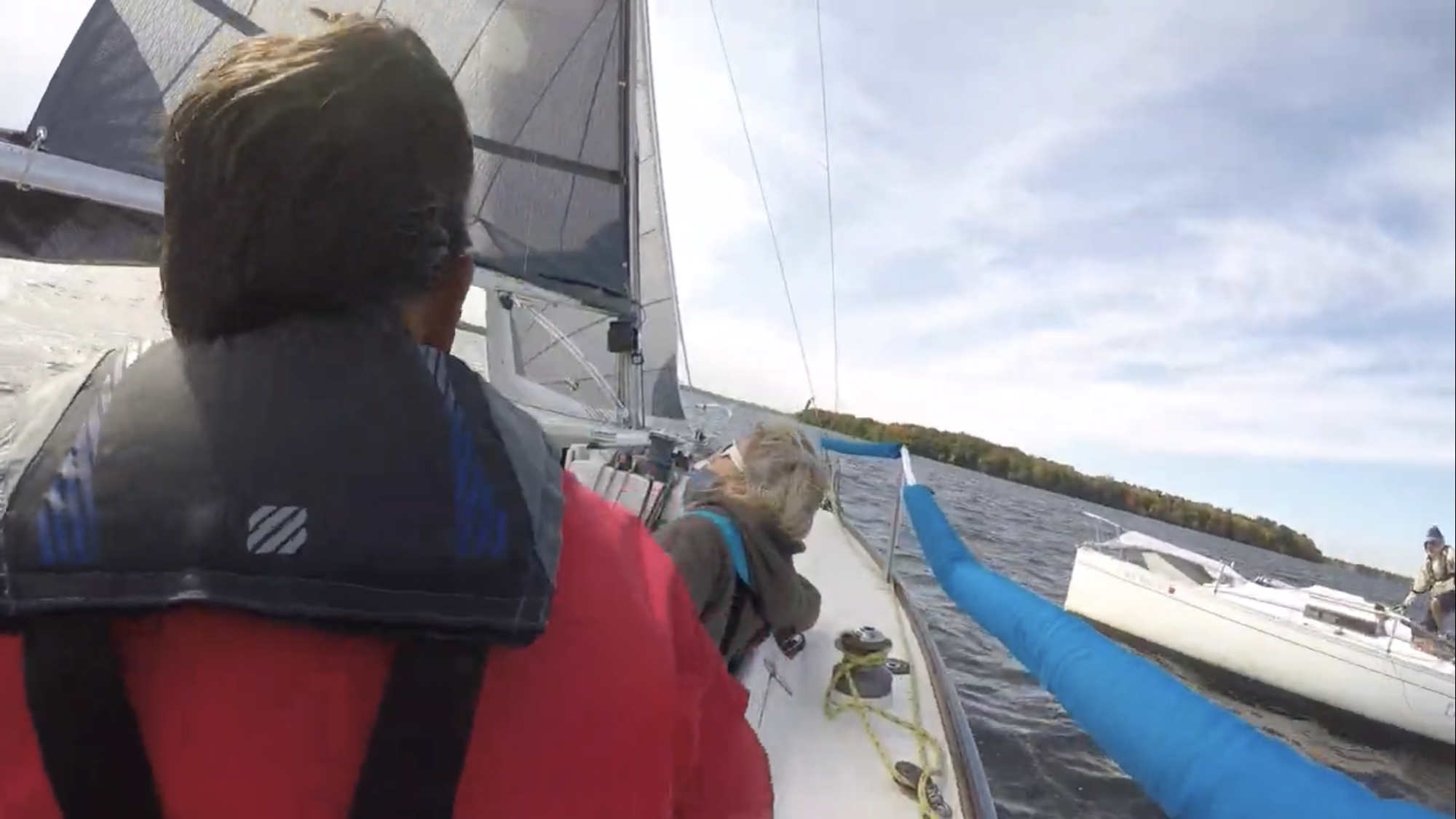

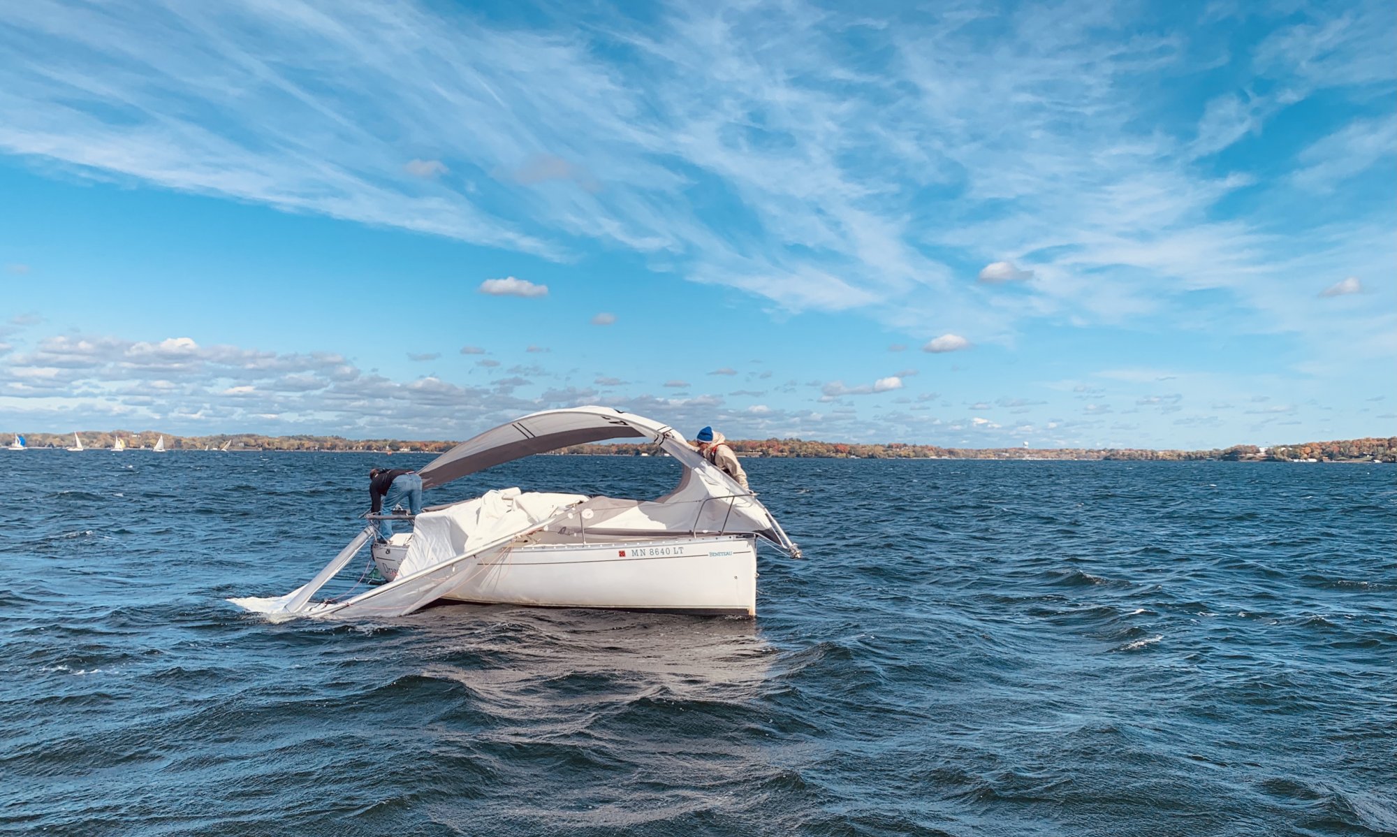

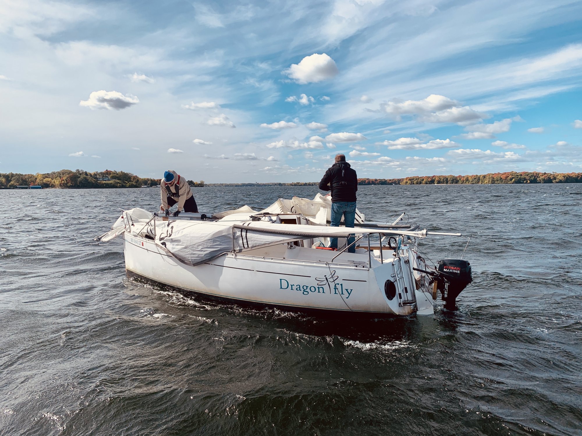

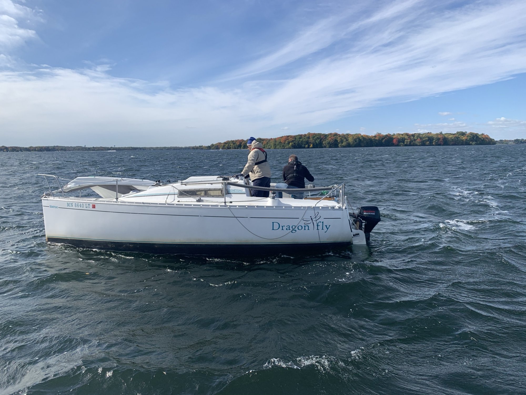

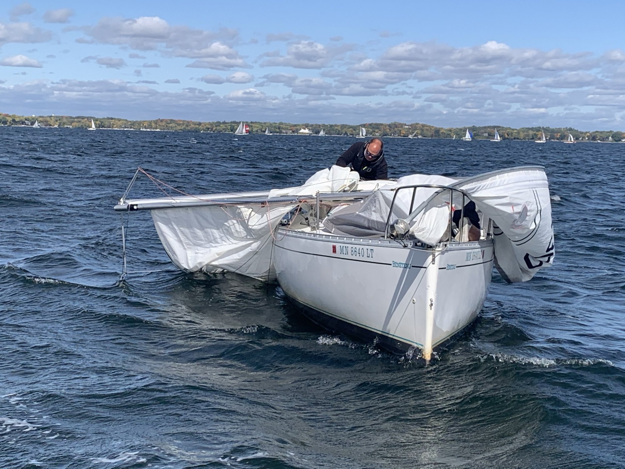

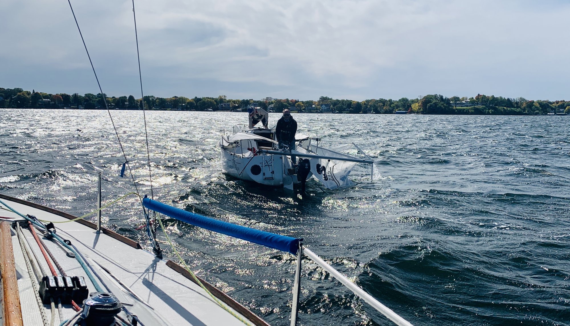

My initial thoughts when I started pondering this was what are the priorities after I confirmed that no one was hurt. My instincts would be to try to salvage as much as I could while keeping the risk factor of injury or boat damage low.
My first choice I think would be to deploy the anchor, either it touches down or creates enough drag that the bow might come into the wind. This would create a somewhat safer platform to work on. Maybe this is wrong headed?? :)
If I felt the “carnage” might create a sinking risk I would figure out how to cut it loose. (I’m going to put some hacksaw blades in my safety bag :) )
I don’t think I would risk going into the water in any circumstance as there would be a bunch of things to get tangled in.
If I went the salvage route I might try to attach some extra life jackets to the mast and/or boom to reduce the chances of them filling with water.
In the photos above it looks like they started at the bow as the forestay - furler was still attached and worked on getting the headsail out first, that would also likely let them get the jib sheets aboard and away from the prop. You could then make use of those sheets to help secure the “load”.
The mainsail - mast - boom would depend a lot on whether the mast had buckled or split in two. If the mast was in one piece I would think you should try to get the bottom end aboard far enough that you could pull the mainsail off.
In the photos it looks like the mast broke so it was likely more grab a handful and start pulling, adapting the plan as things evolved :)
