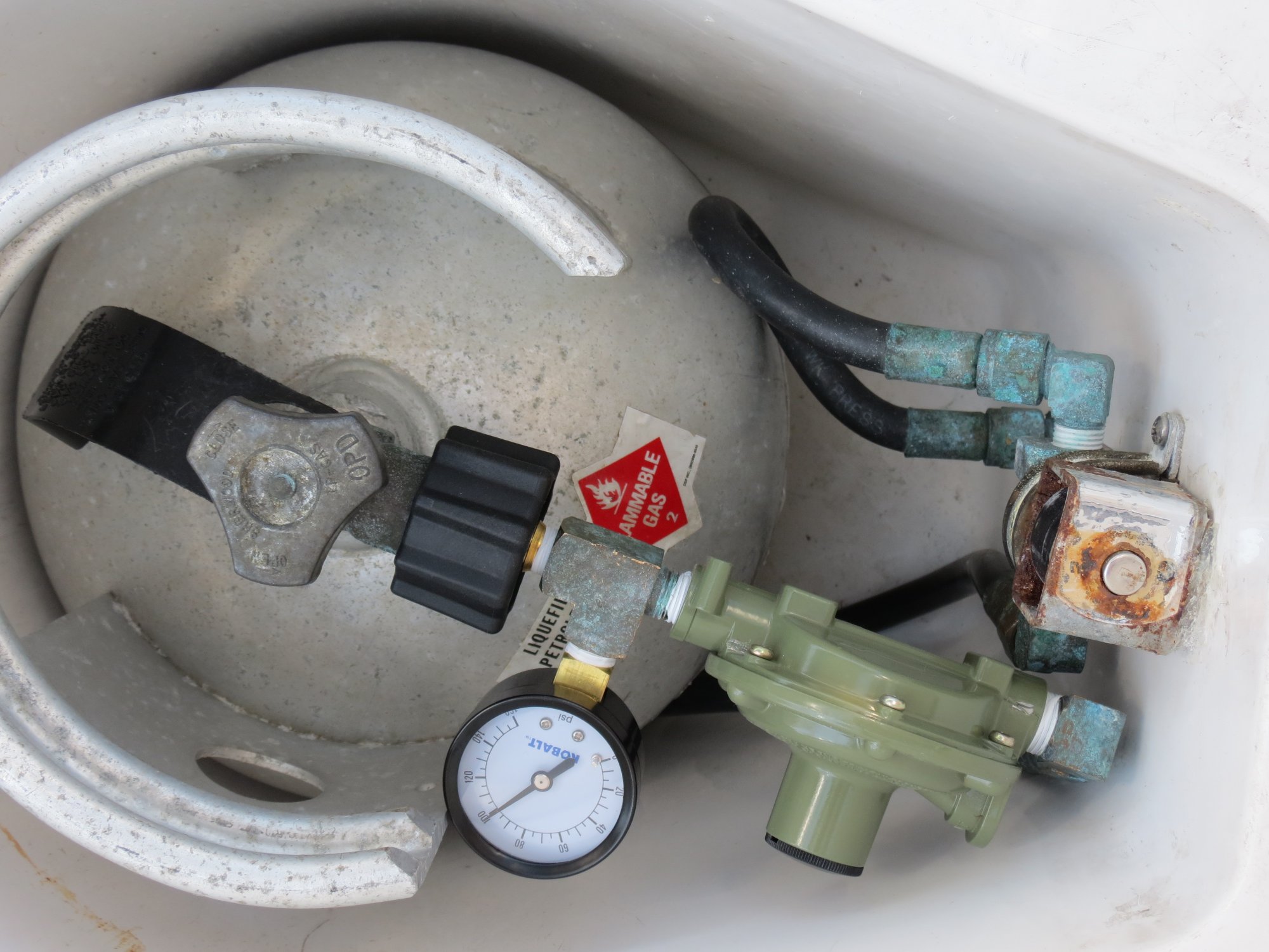

Regarding the new regulator that I have purchased, I performed a water column test per @Ralph Johnstone in post #11.

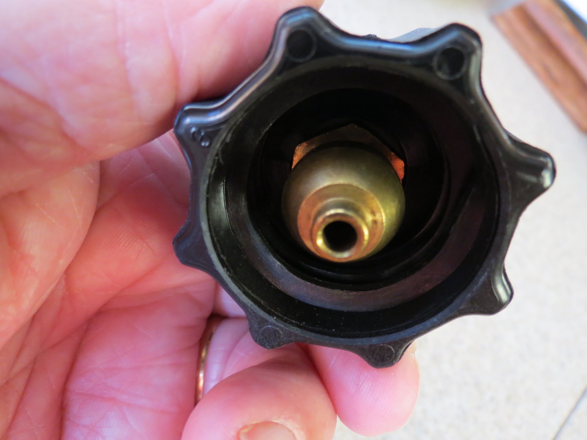

I notice in this photo that you upgraded to a hand-tighten connection to the tank.
Does that black fitting happen to have a check valve in it?
My propane setup uses a short hose between the tank and my gauge and regulator, and when I replaced my tank the last time, I cranked open the gas valve and found no pressure on my gauge. It turns out my hose has a check valve built in…and too much gas flowing through to “fill the system” caused the little ball to check and close off the propane flow. I had to close the valve on the tank, remove the hose fitting and blow the ball back into the open position, and then s-l-o-w-l-y open the valve.

Good idea @Tally Ho . Yes the black QCC tank connector has some kind of check valve in it. But I believe that the check valve stops gas that is in the system down-stream from leaking out when a tank is changed. But maybe it works both ways and will also stop excessive gas flow. I have read where some regulators have a device to stop excessive flow. The specs on the new regulator that I have do not mention this feature- So I'm guessing that it is not present on this regulator. But it might be in the QCC connector itself. I will check with the company that manufactured it.
And I will open the valve slowly to see if that makes a difference.
Thanks for the idea.
I think the check valve is to stop the tank from emptying all of the propane should there be a “blow out” somewhere down stream from the tank.
Greg

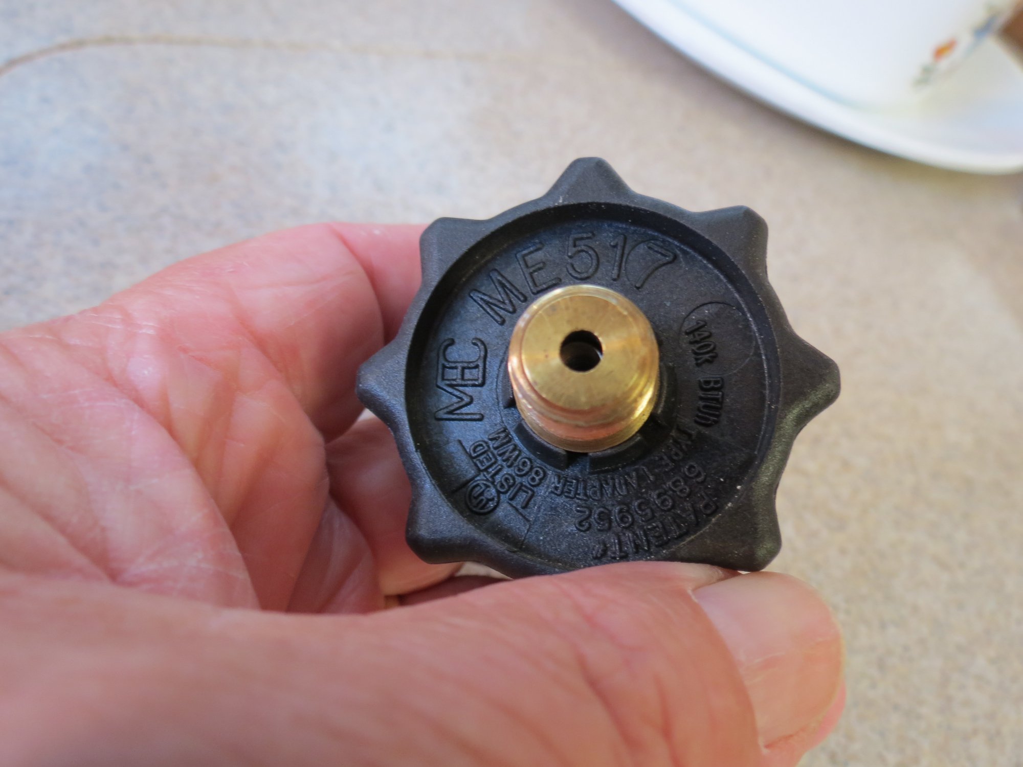

So I know that there is "something" in the QCC connector, and I believed that it was just a back-flow preventer for when the tank is disconnected. However, the manufacturer had additional info as follows:
"The Marshall Excelsior (Model ME517) 1-5/16" Female Acme x 1/4" MNPT Quick Closing Coupling Connector - Black is a Type 1 connector that has a built in excess flow feature and a positive shutoff that will not allow gas to flow until the connector is fully engaged. In case of a fire, the built-in thermal protection melts allowing the nipple to disengage from the tank connection and stop the flow of propane. These QCC connectors also provide a positive back check seal at disconnect to eliminate the propane in the hose from being released into the atmosphere."
So this "excess flow" check feature is likely the explanation of a 0 psi reading on my gauge when I opened the tank valve. But in order for this excess flow check to be activated, it requires an inrush of gas to the system. That, coupled with the propane alarm inside the cabin still suggests some kind of leak inside.

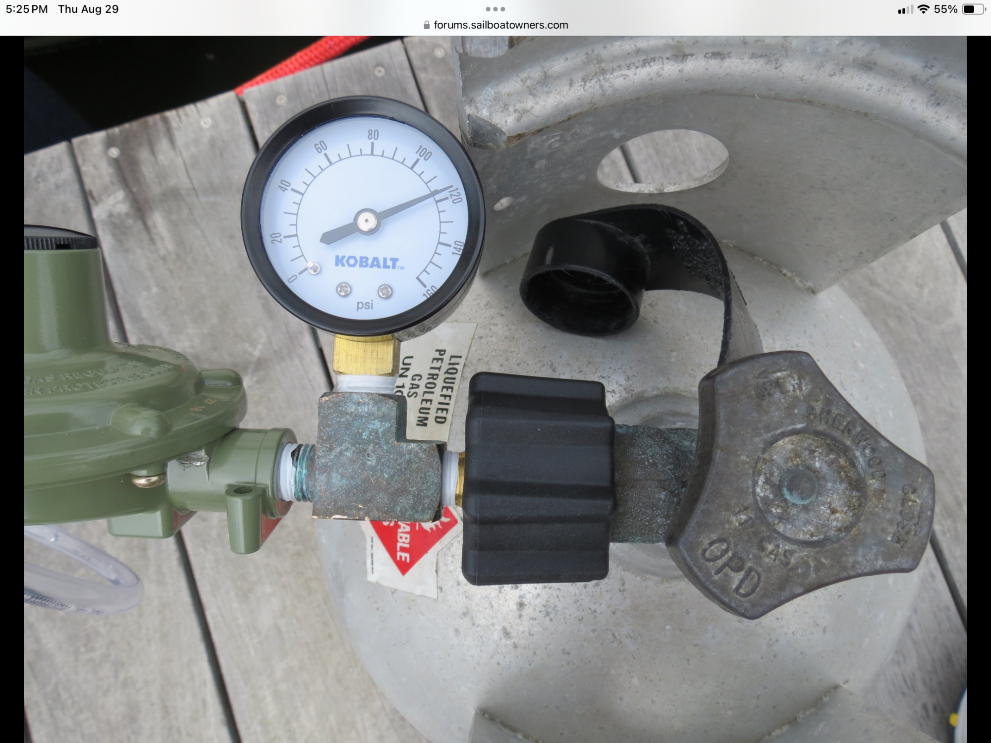

Hi Ralph,
Good luck with the project today. Not to load you up with more tasks, but I'm wondering if you couldn't snap a quick picture of this connector, and maybe one of the broader layout inside the propane box. I'm having a hard time visualizing where that connector lies in the system.

@American_Mainsail - Here you go with the pix you requested.

Now back to my parts search. This doesn't look promising so far.
