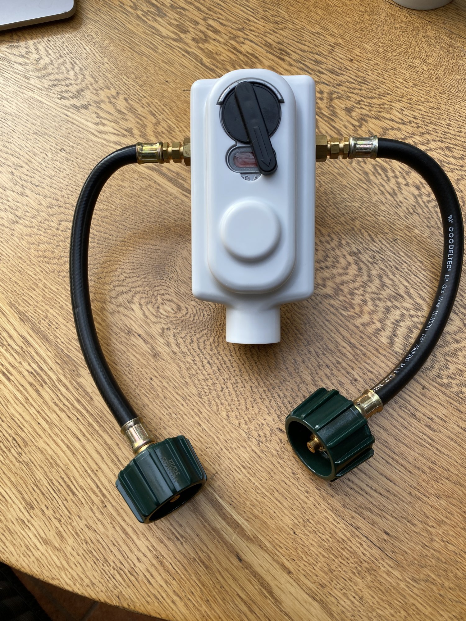

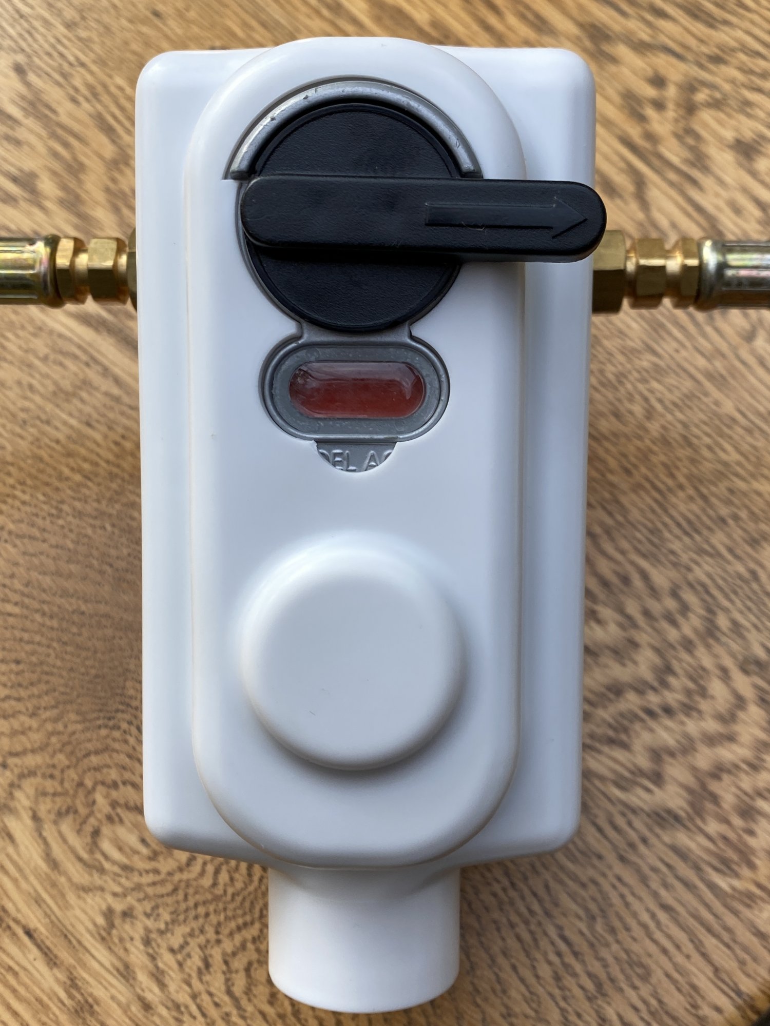

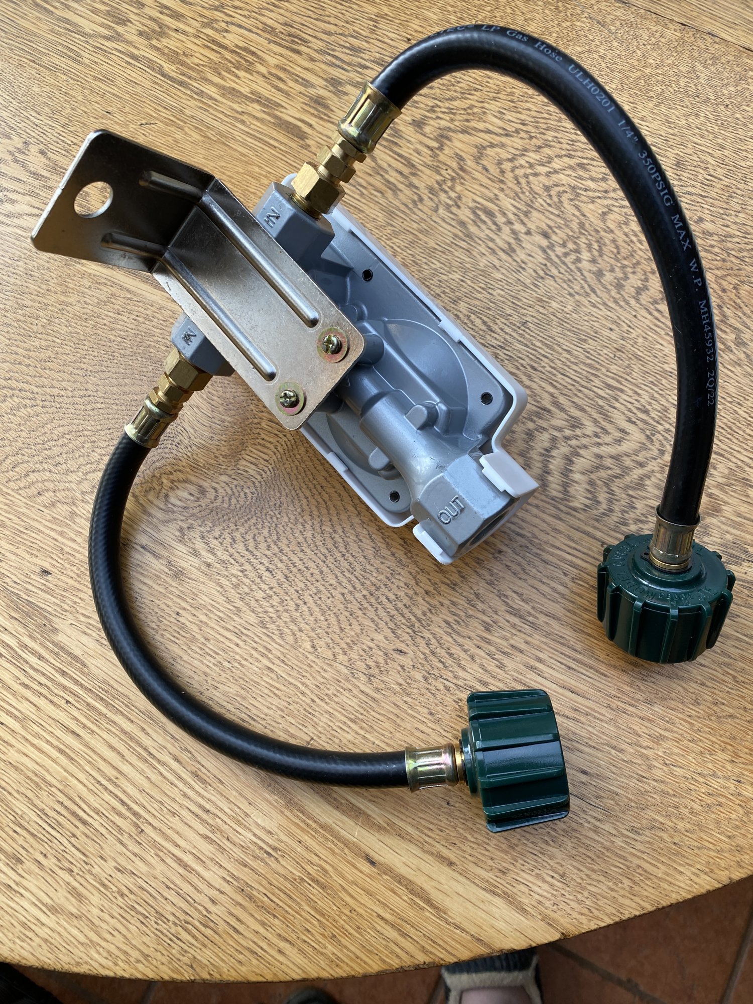

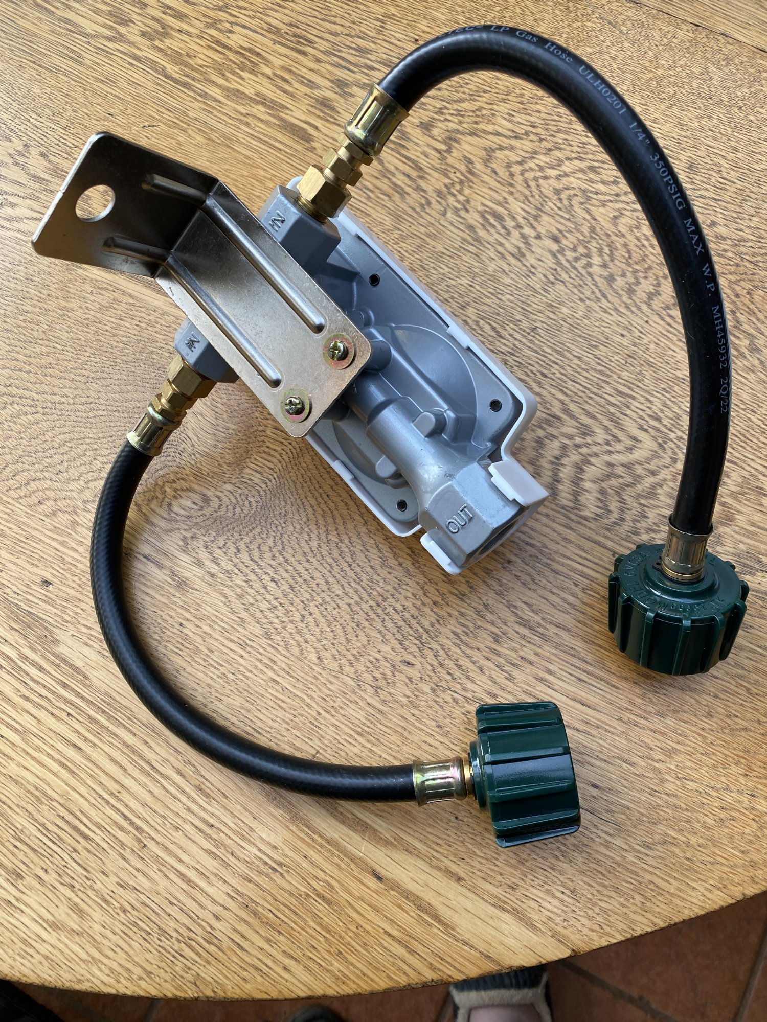

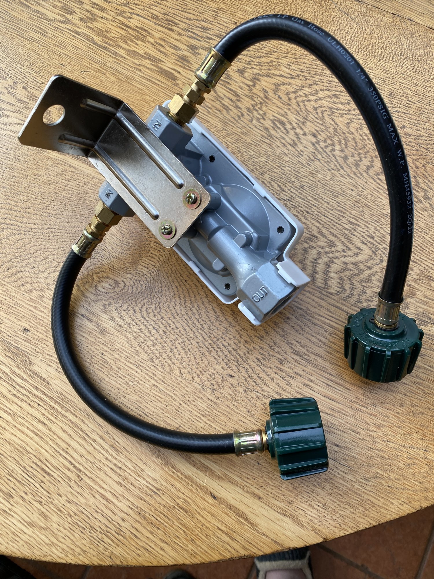

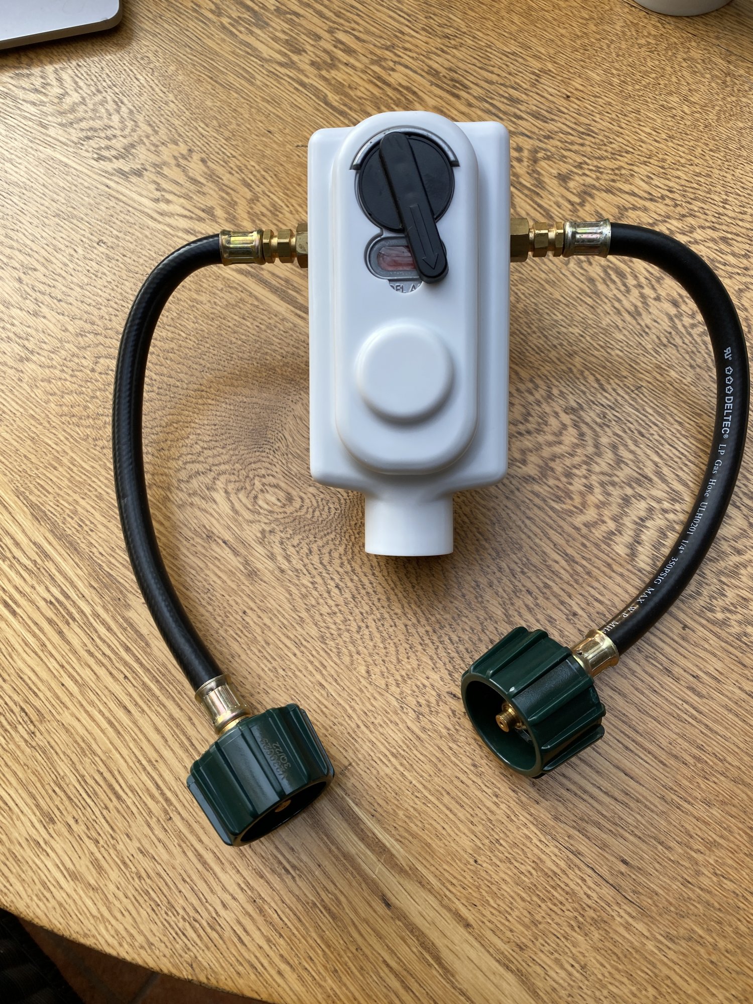

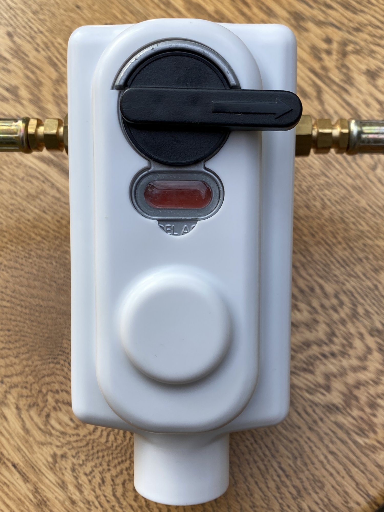

I found this 2-stage Propane regulator. $37 seemed too good to be true. I just received the unit.
It weighs about 2.5 lbs. It feels substantial and well finished. Automatic switchover is possible with dual tanks. The regulator has a tank-empty indicator. It meets the 11"-12" (280mm +_ 50)H2O outlet pressure demand.
I'll let you know my hook-up experience.

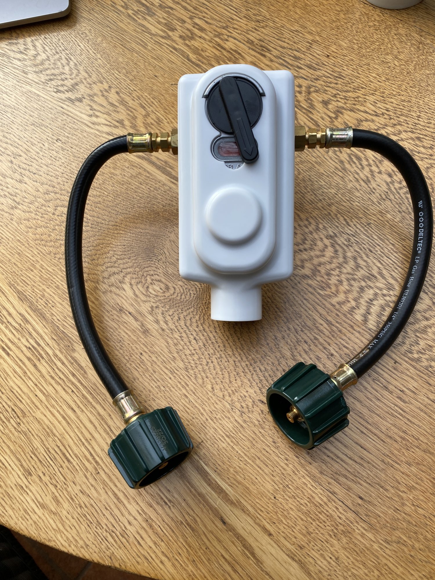

Back to GAS...

Looks good if you have two tanks. I only have room for one 10# tank.

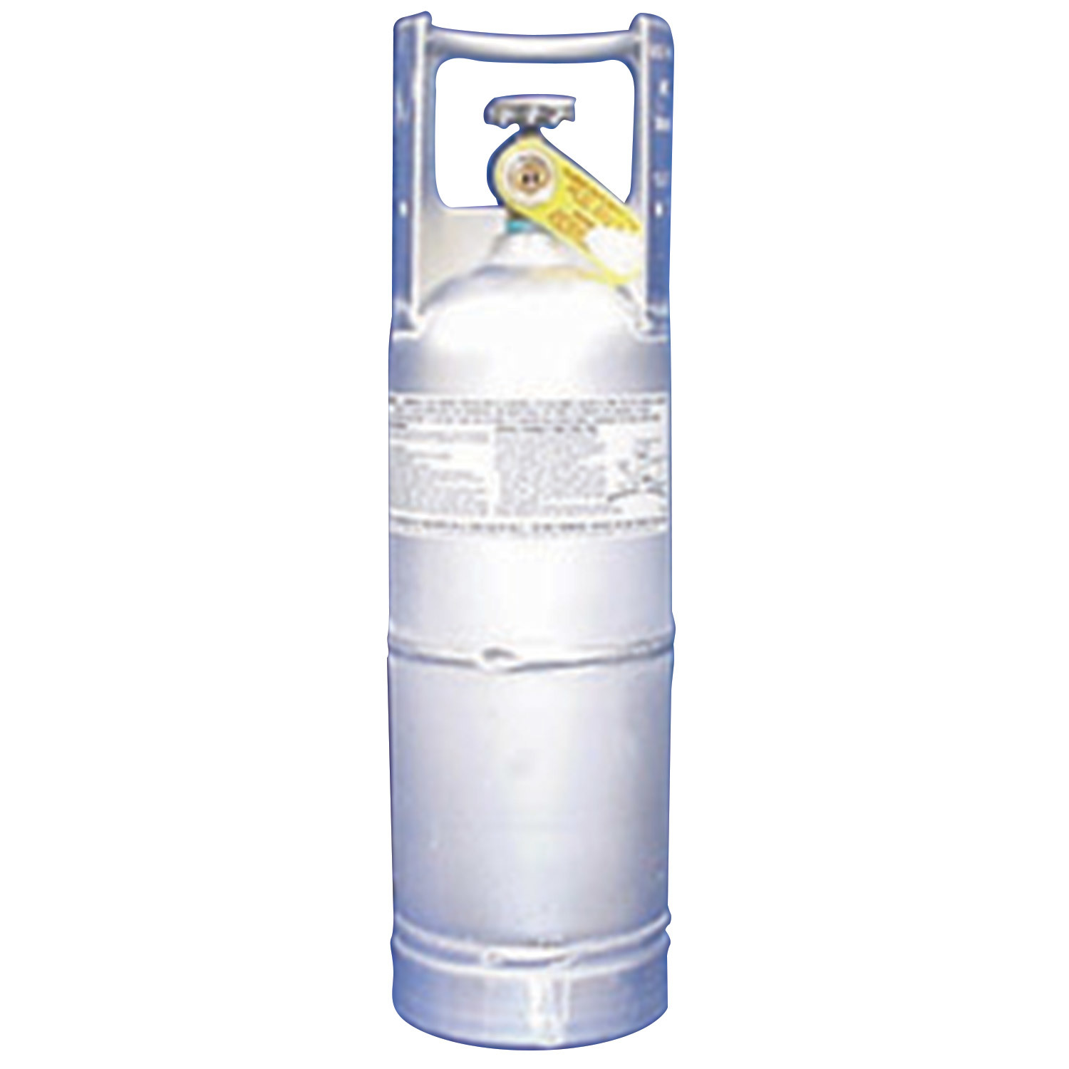

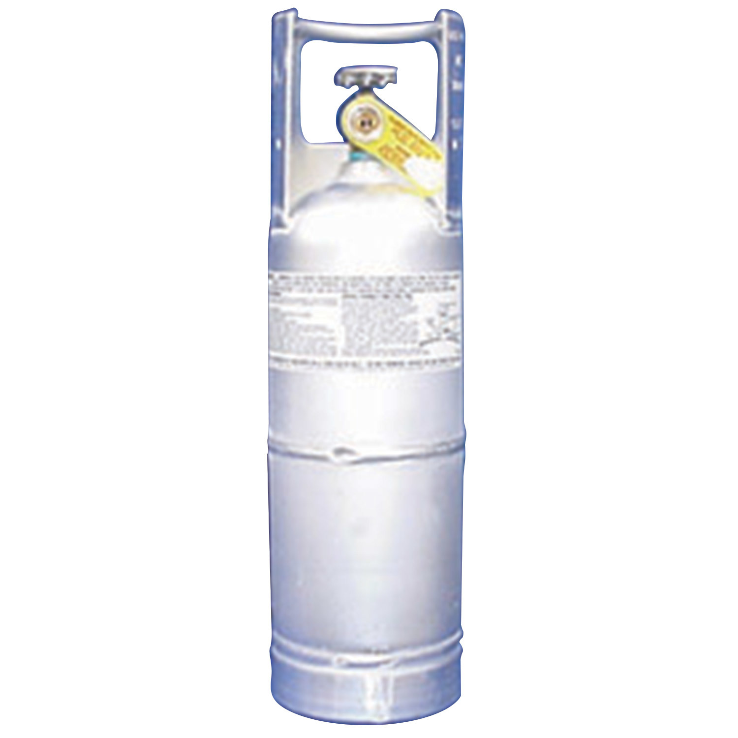

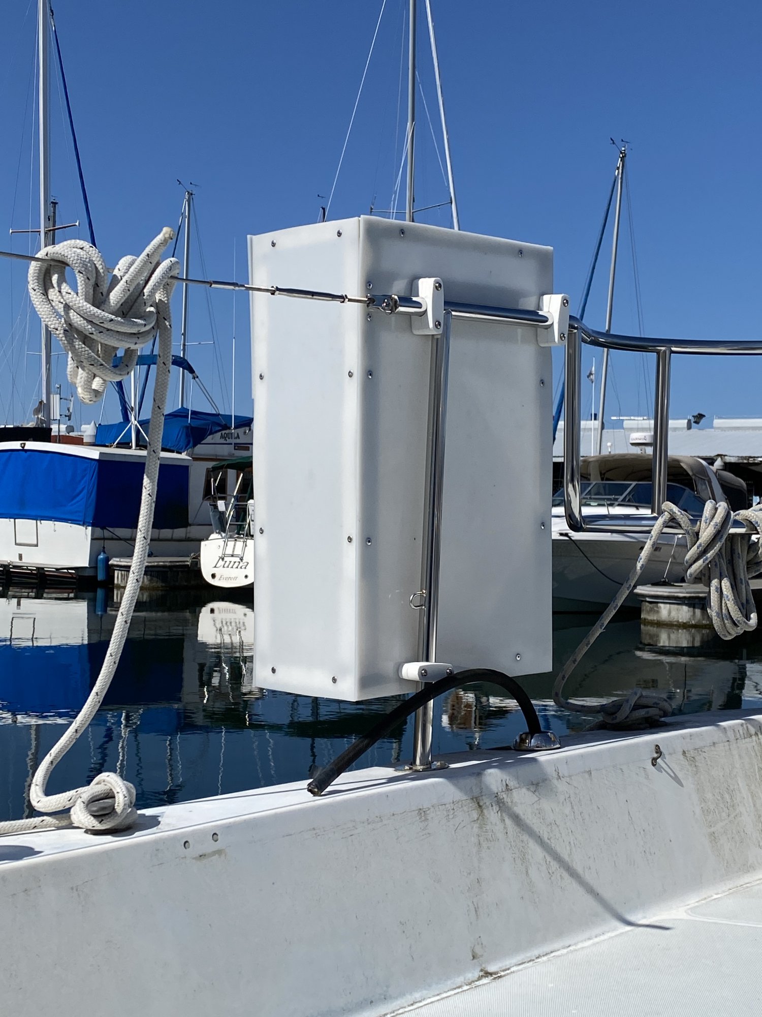

Prior to my 2017 altercation with a helm less fishing boat, I had two tanks attached to the stern pulpit (one on each side of the stern). I just completed the build of a box (with the help of my sailing buddy Les) to house the tanks.
It will hold two 6lb aluminum tanks.

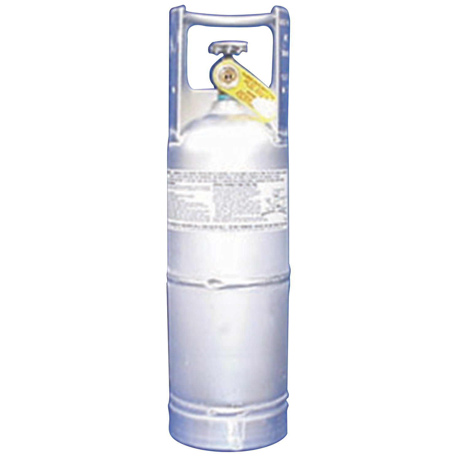

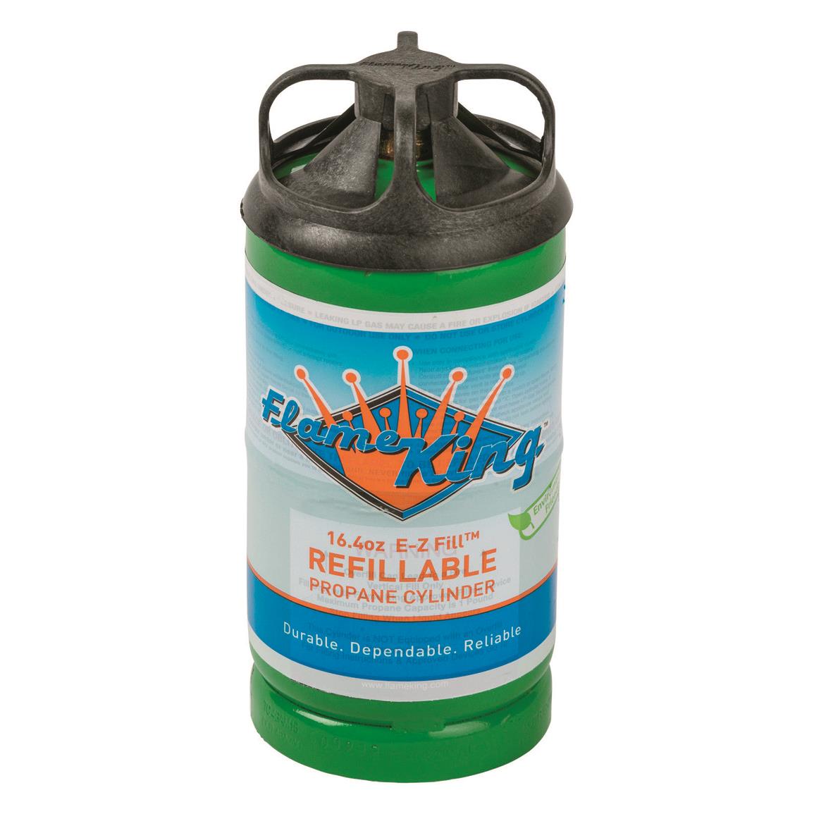

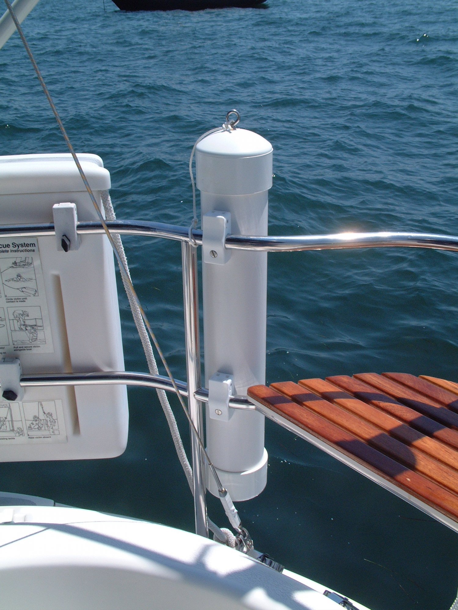

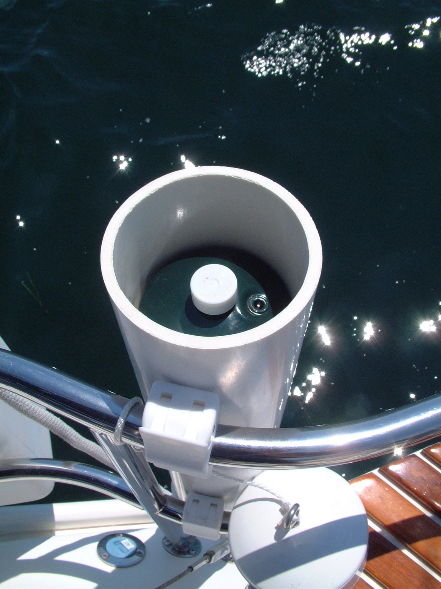

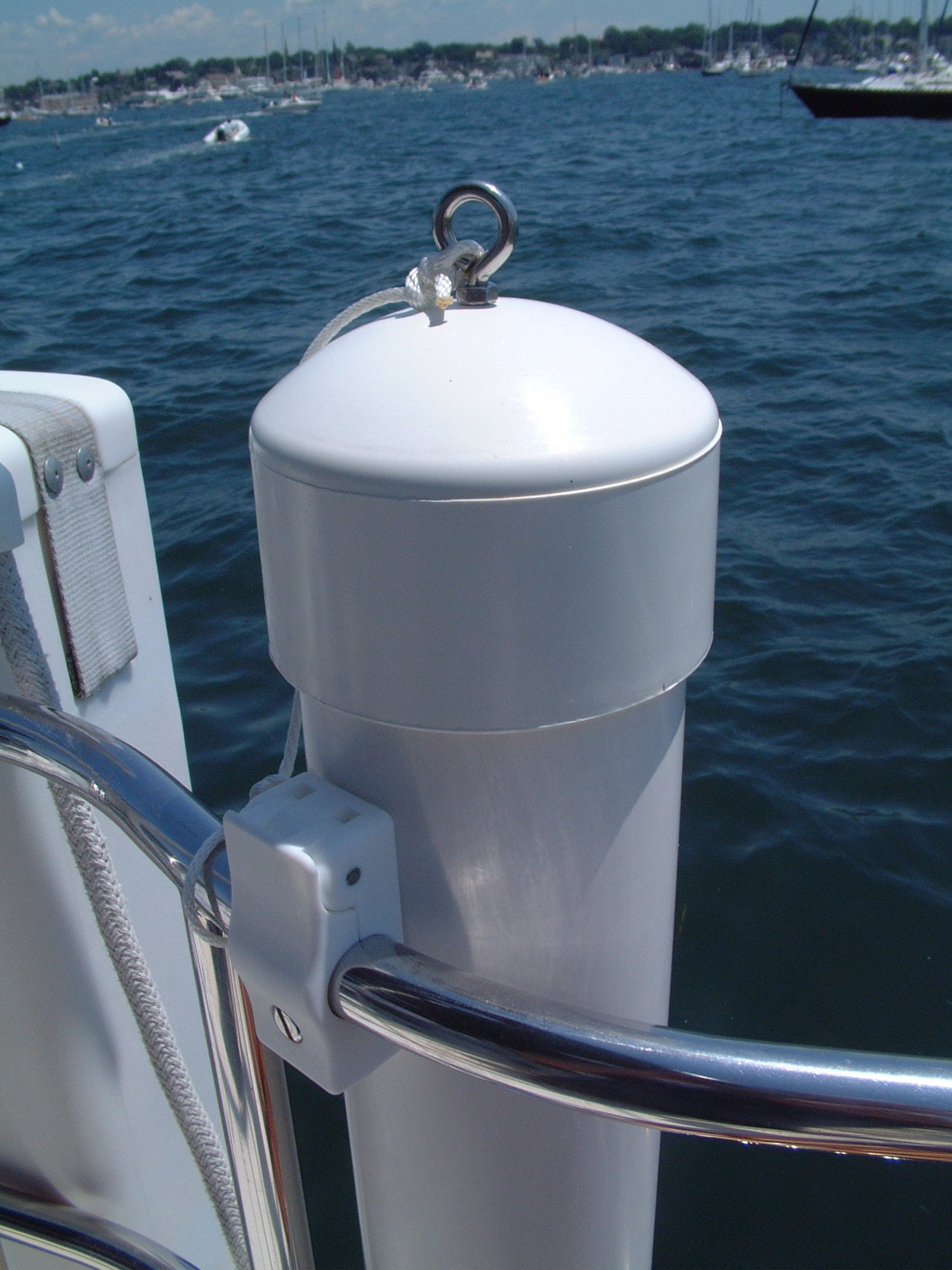

Nice custom solution. Currently I have my stern rail pretty much filled with "stuff". One of the things is a custom 4" PVC tube with a vented cap at the bottom and a sealed cap with a tether at the top. This tube was pre-cut at Home Depot and very nicely holds three 1# propane tanks for my BBQ. It attaches to my rail with commonly available hinged clamps. I use refillable 1# tanks sold by Flame King. I refill from my 20# tanks at home with a simple inexpensive adapter that I put together. Refills only cost about 60 cents each. Four refills on each tank is the break-even point over buying the disposable tanks.

I liked that tube idea when you first posted it a while back. I think I'll do the same as I finish outfitting my boat.
What adapter?

I don't have a picture of the refill adapter, so I will describe it.
Listed in order of connection:
POL or QCC tank adapter
female-female coupler
short length of brass piping
female-female elbow coupler
long length of brass piping
brass shut off ball valve
1# cylinder adapter (and coupler if needed)
All brass piping and adapters are 1/4"
The 20# source tank is turned upside down on a secure surface. It must be upside down so that liquid propane will fill the small tanks. The adapter is screwed onto the source tank with the valve and 1# adapter pointing down. Close the adapter valve and open the source tank valve. Briefly open the adapter valve to purge the air out of the adapter tubing. Attach the 1# tank to be filled. It will be in a vertical position. Open the adapter valve. Then open the bleeder port on the small tank to allow air to escape while the liquid propane flows into the tank. When liquid vapor sprays out of the bleeder port, shut the adapter valve and close the bleeder port. Done. Replace with another 1# tank and repeat.

The bottles that I am refilling are designed to be refilled. They have a dip tube that will indicate the correct fill level. I do weigh them afterward to be sure of the correct amount.
These bottles are not the 1# disposable units.

I bought one and then liked it so I bought 4 more. I keep 4 on my boat and one at home for torch use. They refill easily and they appear to be a quality tank. It has an internal dip tube attached to the vent so it's easy to stop filling when liquid propane begins to spray out of the vent. The cost about $15 each. It's nice to get a fill for 50 cents instead of paying $4-5 for a disposable.
The refill adapter is just a one-time cost of about $20. I refill my own bottles and a buddy's bottles too. He has a CO2 system so he keeps my Soda Stream bottles filled for me! Saving money and eliminating water- its a great combo!!
