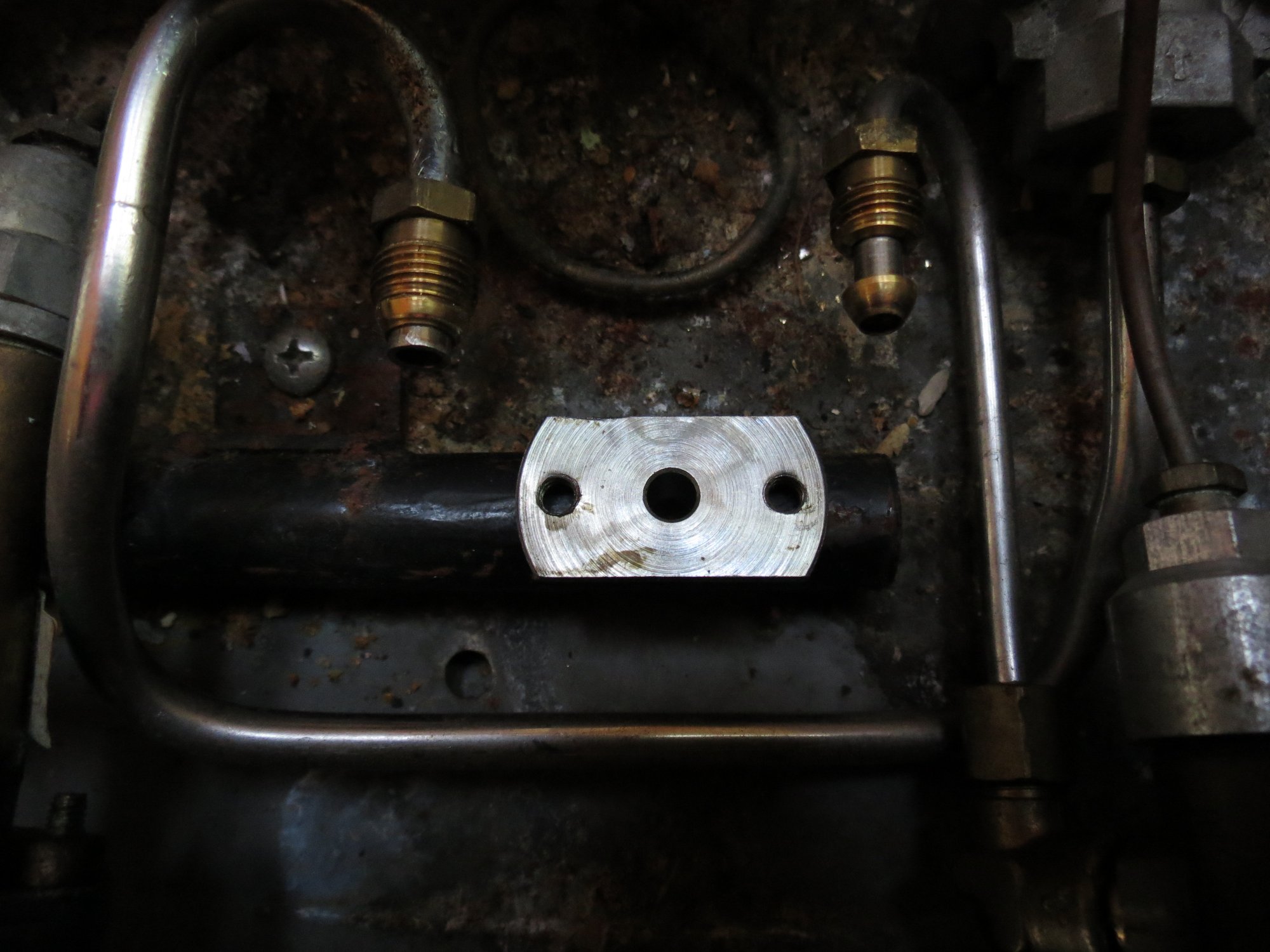

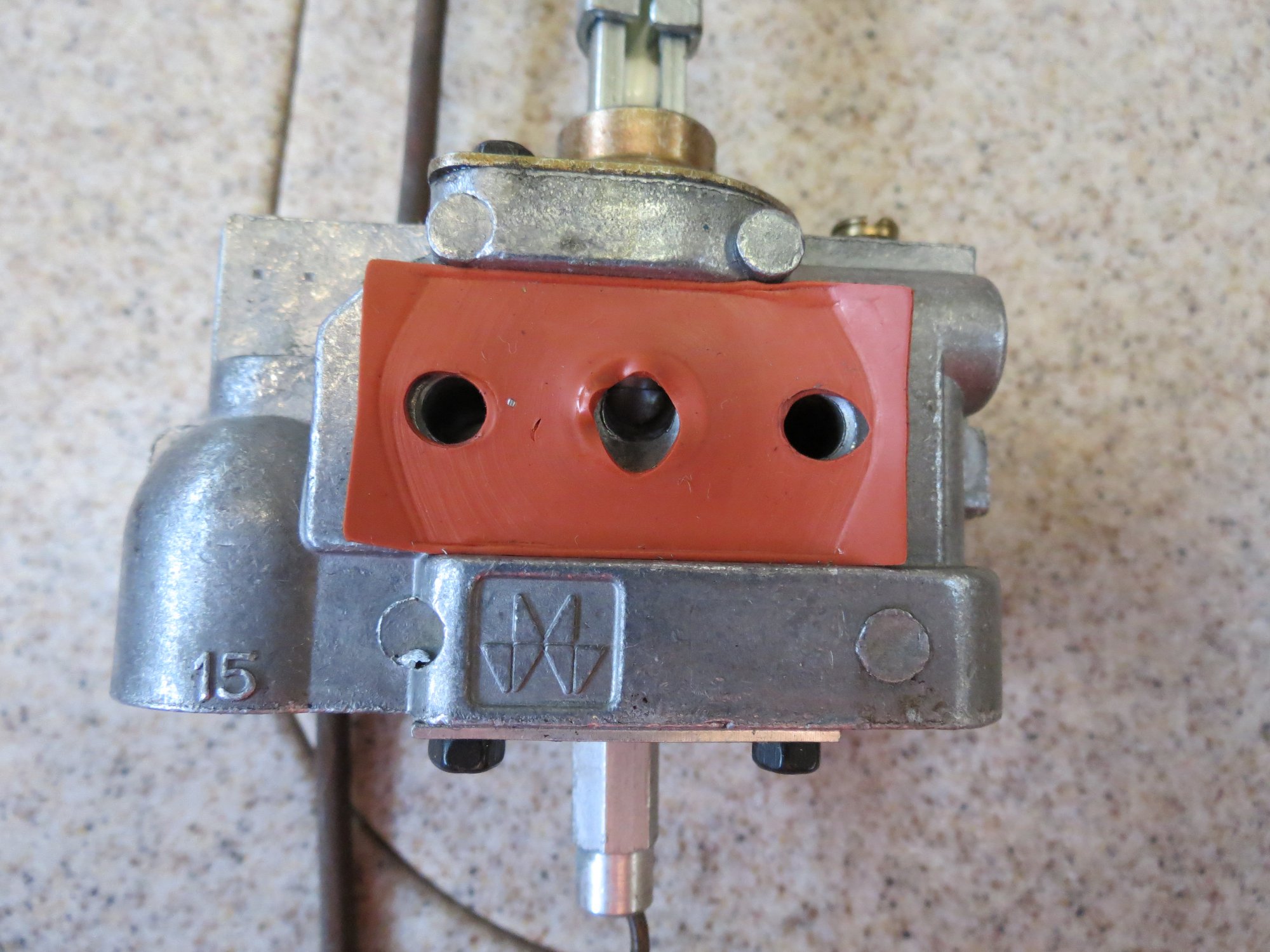

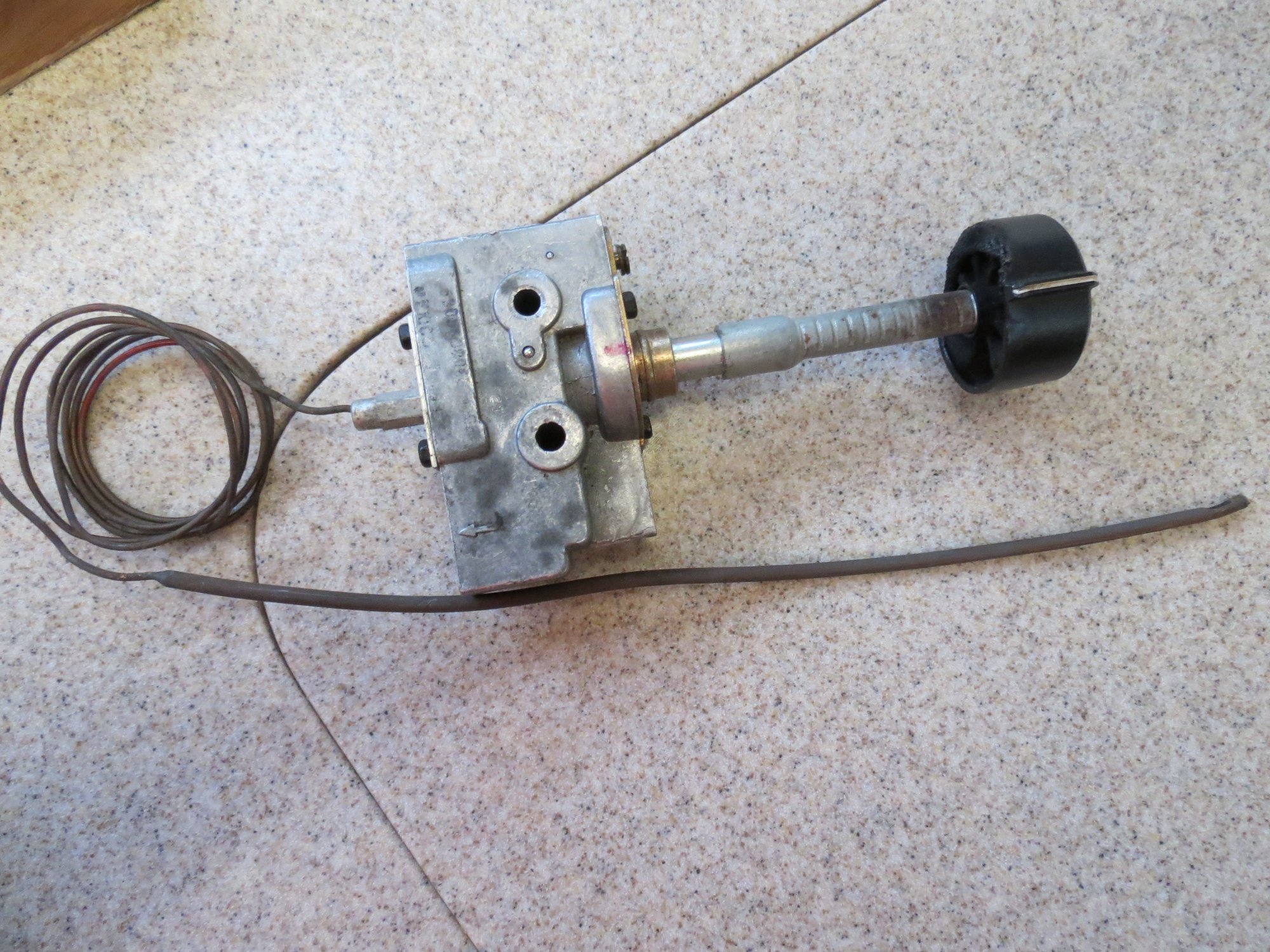

Actually everything is connected and working properly and I am down to getting a replacement oven thermostat/control. Unfortunately, I'm being told that a replacement doesn't exist except from a junkyard, and although a rebuild of my bad control *might* be possible, the time required to have that done is 16 weeks at a cost of $250-300.

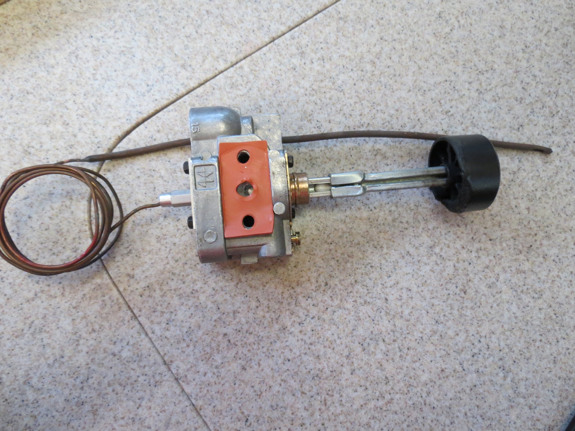

So what I have done is removed the defective control and I will now plug the gas supply that fed it. The supply is just s flat plate with a plain hole for the gas and two tapped holes to secure the control with a gasket. So tomorrow I am going to the hardware store and buy a 1/4-28 tap and a short screw with a rubber washer. I will tap the hole (already measured, near perfect tap size for 1/4-28) and then seal the hole with a screw, washer, and maybe pipe joint compound. This will allow us to use the cook-top burners for the rest of this season.
The pix below show the removed thermostat control, top and bottom, and the gas inlet mounting area on the thermostat. Also the corresponding gas supply seat with the center hole that I am going to tap and seal.

SureMarine up here in the PacificNW woods is the Seaward distributor. I called them and Todd shared that the OEM parts are pretty much gone as Seaward has been closed for a while.
He said he may have a remanufactured part. If you send him an image of the oven control and any other parts you seek, he would see if he has a replacement.

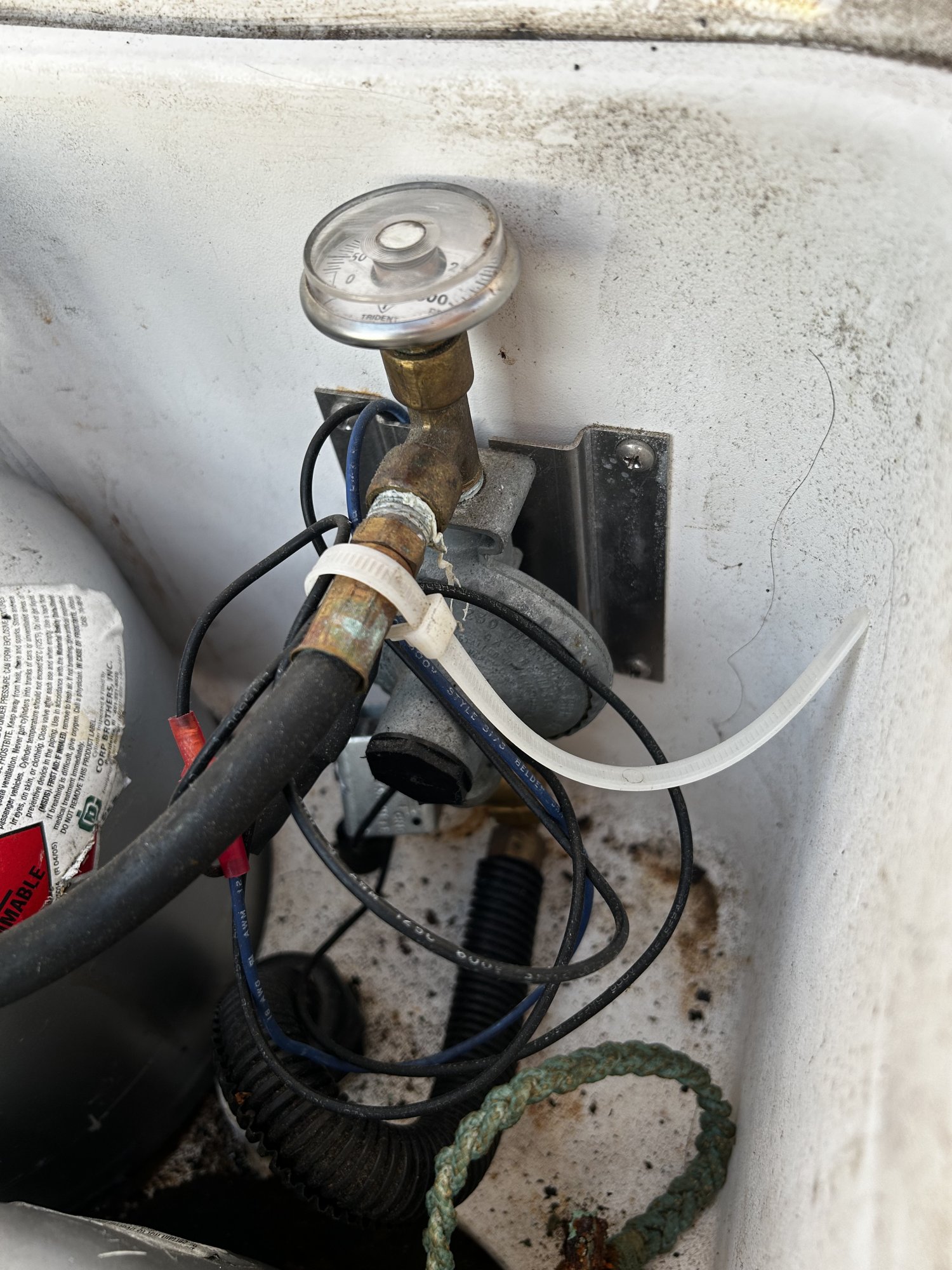

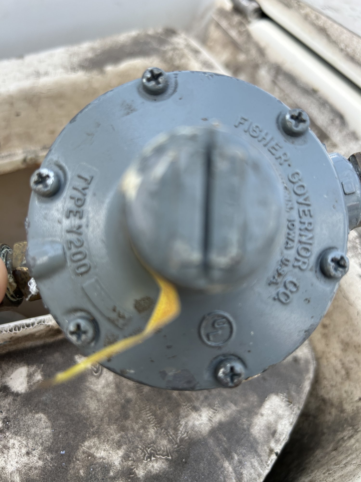

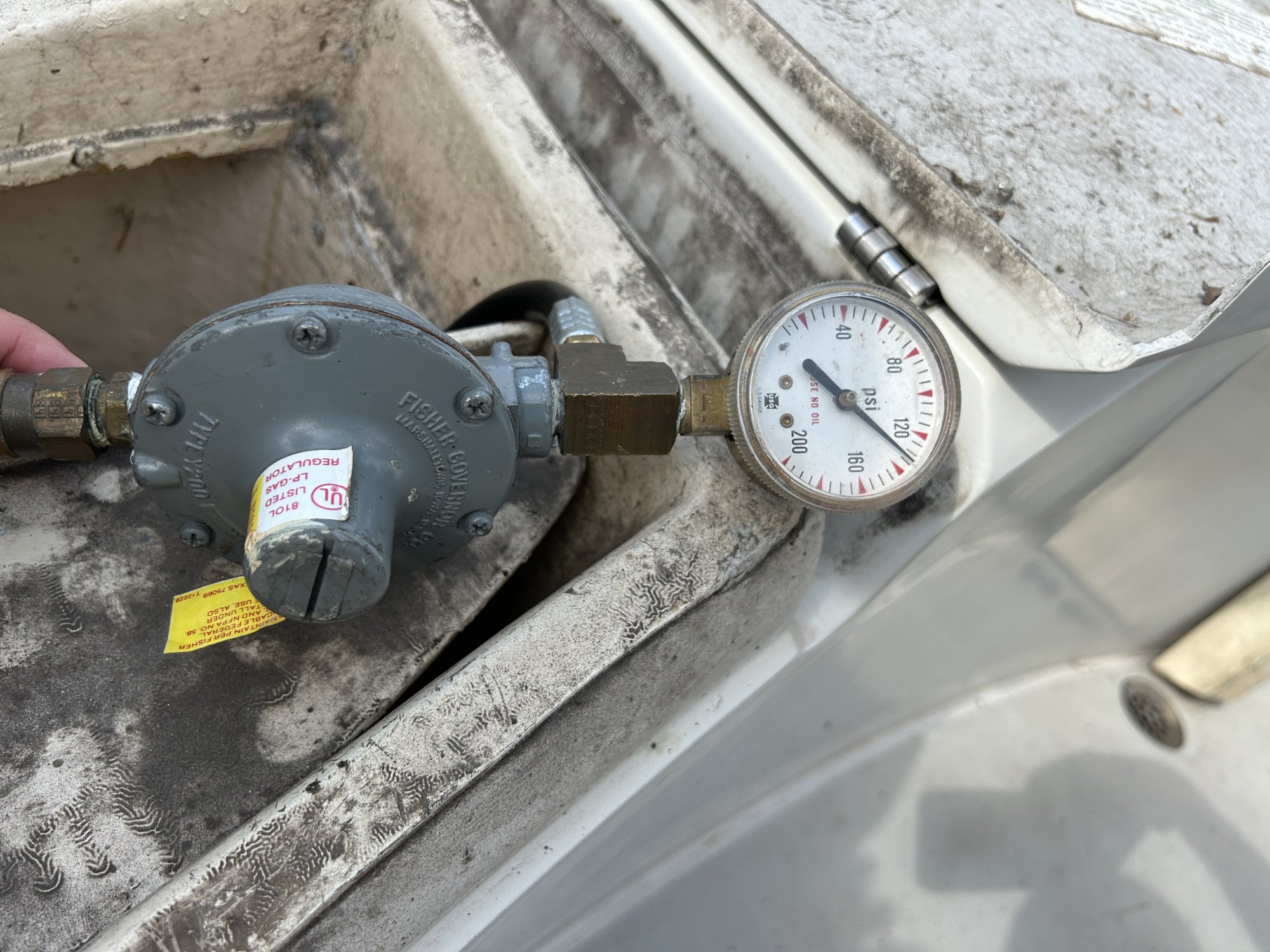

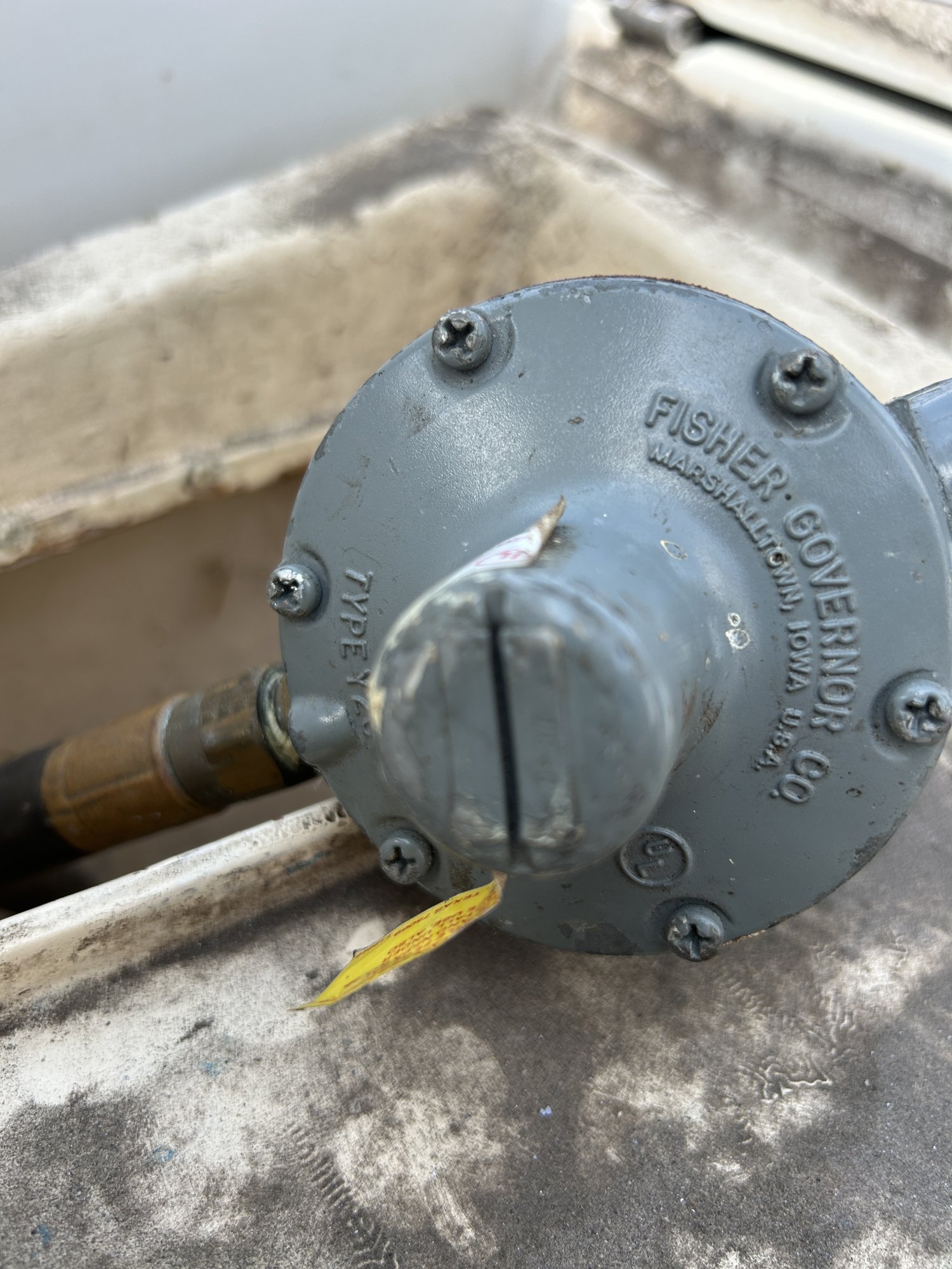

I took a few photos of my LPG tank setup today…

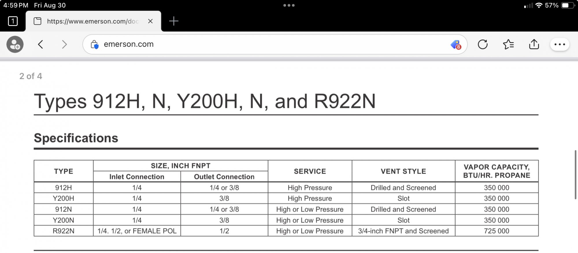

My regulator is from Fisher Governor Co. and appears to be a model Y200.
I could not find anything on the model…except this chart…which lists a Y200N or Y200H…but not a Y200…
My pressure gauge reads about 135 and it was around 80F when I took this shot. That lines up to around 26 or 27C.
And correlates pretty well with Ralph’s chart.

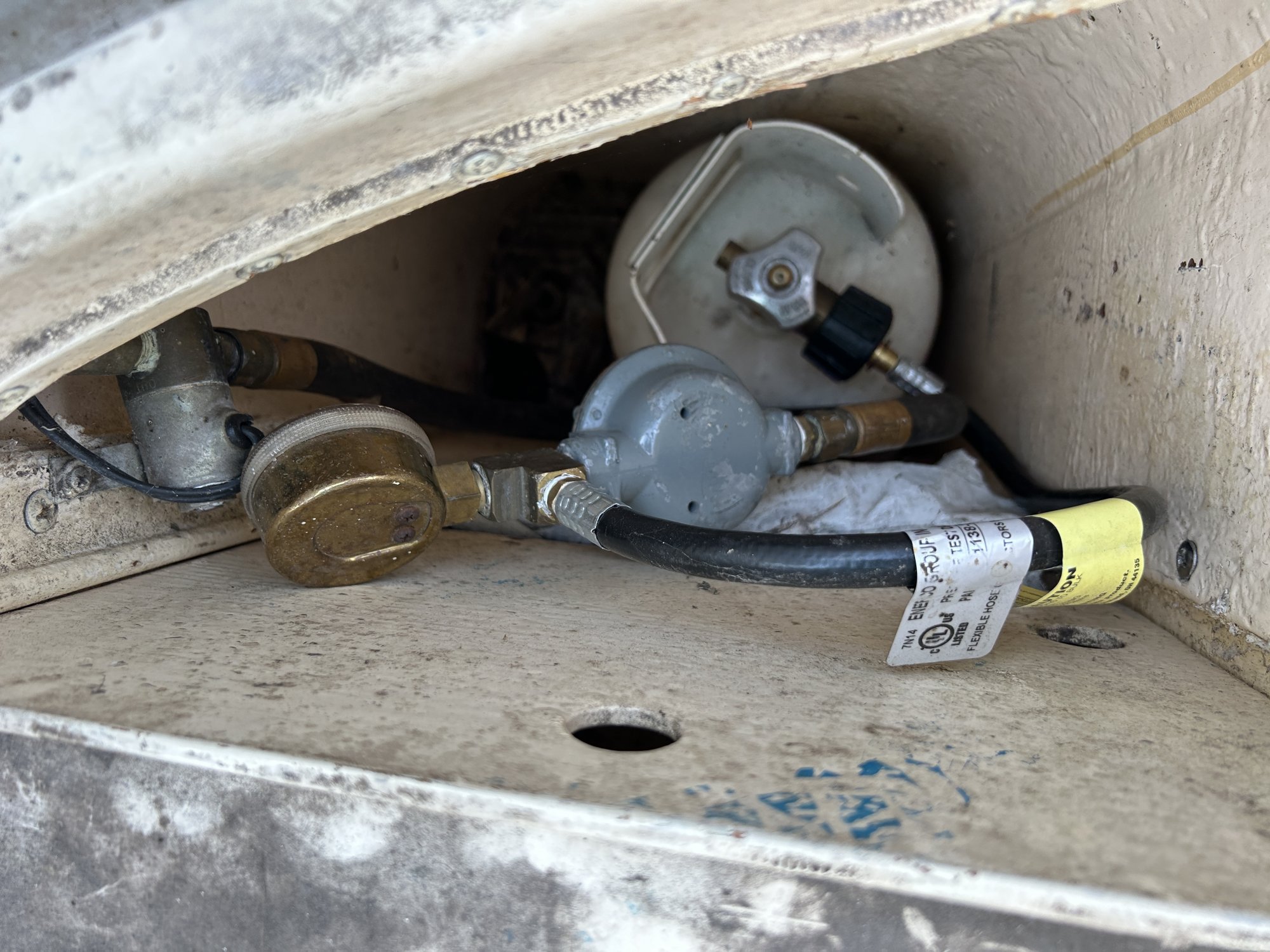

Just a shot of my LPG locker, which is VERY deep, and I just keep a 5# bottle down in there. I have replaced the little pig tail hose at least once…the last time I determined that it had a check valve in it.
One issue I have to fix eventually is a quick disconnect a PO installed that T’s off the propane line for a BBQ grill. He mounted a quick disconnect in the engine control panel in the cockpit. I replaced the old, cracked rubber hose with the quick connect male fitting, and now just connect the grill to a spare LPG tank when I want to grill. But I still need to remove that T and the line with the female quick disconnect fitting…:yikes:
I leave the tank valve open, but always have the LPG solenoid off unless I am using the stove/oven.
Always something…

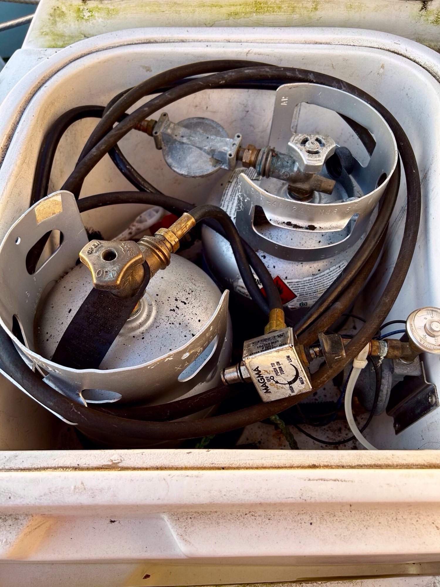

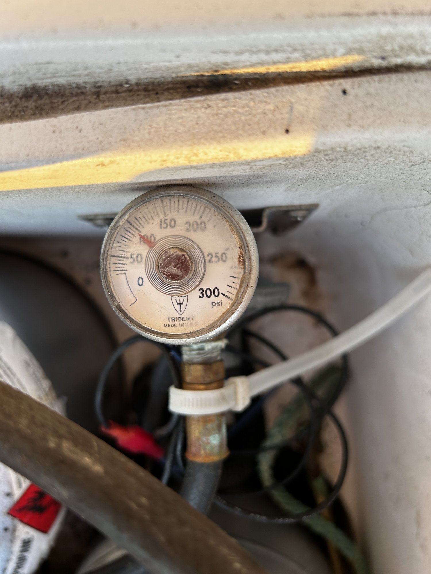

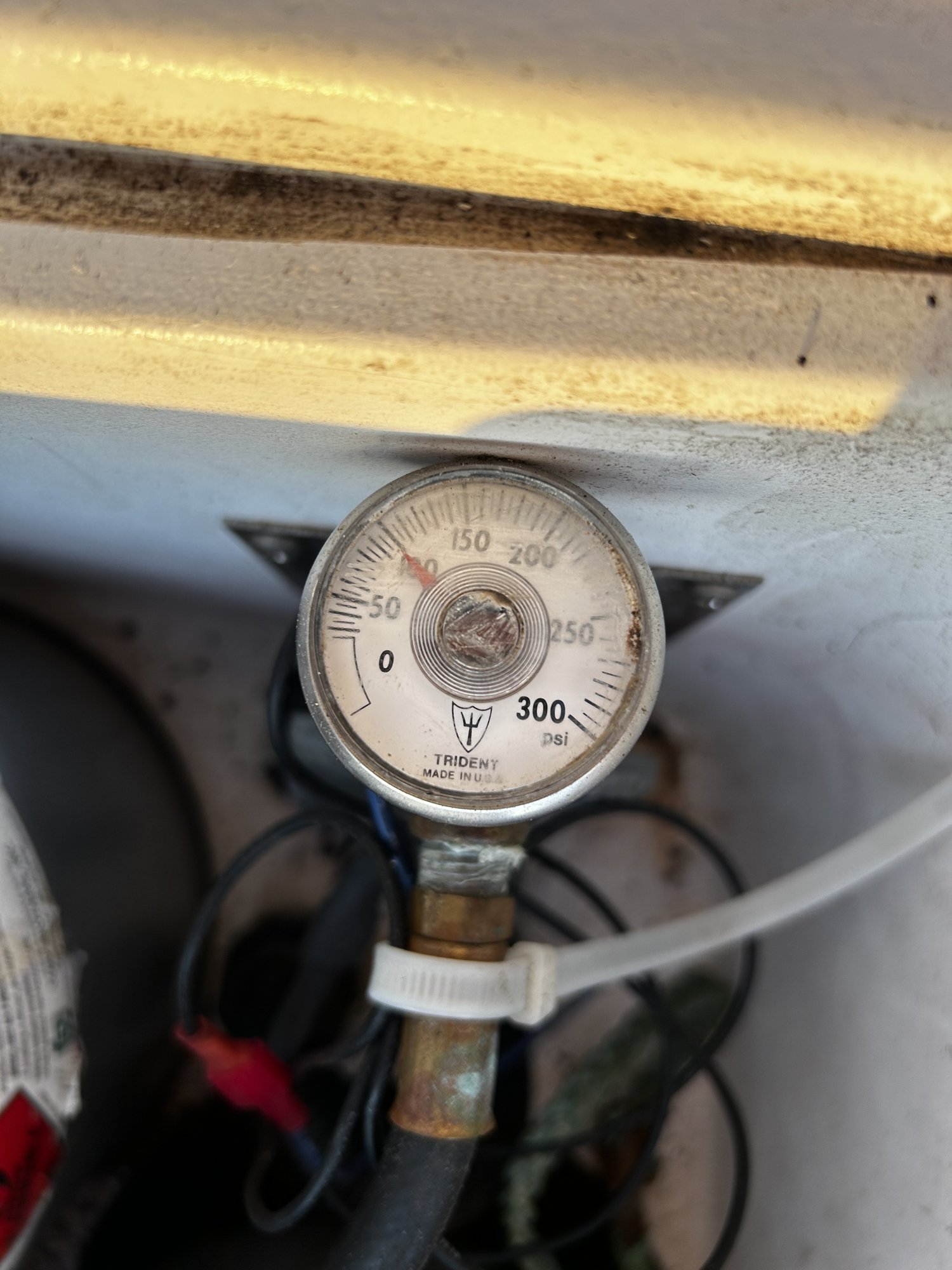

I’ve been reading your post, and know you’ve pretty much fixed your system, but I was at my boat early this morning, so I took a few photos of my 2000 340 propane locker for you to look at. Can’t hurt.
The tank at the top right of the photo supplies my Magma Grill on deck. That‘s what the long looped around hose is for.
The tank at the bottom left of the photo supplies my galley stove. That is what the pictures of the gauge show when I open the valve on the tank. This tank has about 1/4 left in it (+/-).
I also have the original manuals that came with my boat if you need or want to look at.
The Trident Gas manual has set ups, model numbers, connection fittings etc.
The Force 10 manual is pretty much for that model but is detailed as well.
Hope this helps.
Oh, and yeah….you should be shutting the valves when you leave. Good practice to be in.

I don't hold out much hope for your repairing the stat in your picture. The bulb and capilliary tube are filled with a high vapour pressure liquid, often ethyl ether. The whole controller is assembled with the bulb immersed in a dry CO2 and alcohol bath to avoid having everything push itself apart.

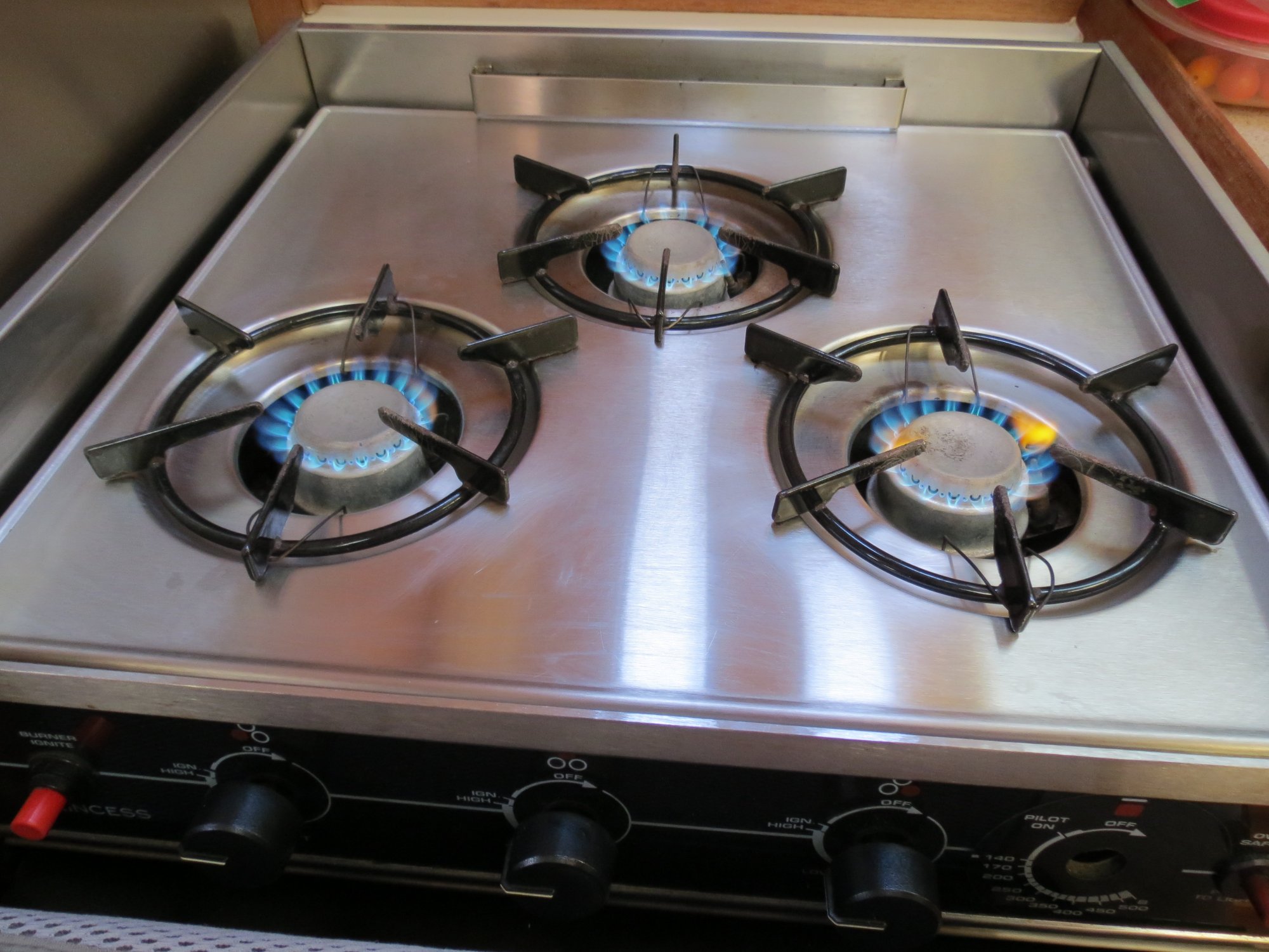

I think I see a light at the end of this tunnel. With the oven thermostat removed, I bought a tap to thread the hole in the gas plenum so that I can use a screw and sealant to plug it. Now that I have done that and tested for leaks, I lit the burners.
The three burners on the cook top are now fully functional. We have no oven, but at least we can make coffee and cook meals.
I spoke with Todd at SureMarine and I set him pictures of the control that I have. He replied within 30 minutes and told me that he has 5 re-manufactured thermostats in stock and sent me pictures of them.
Now that we are in a holiday weekend, I will contact him on Tuesday and have him send one to me. If it is absolutely identical, then the installation should be under an hour. :)

It looks like your propane locker will hold a 20# tank, but you have two smaller tanks installed. Assuming that you added the second tank, why didn't you just tee the output with a hand valve with a hose to the grill?
I use 1# tanks on my grill, but I bought the tanks from Flame King and they are designed to be re-fill-able. I refill them with a simple adapter and valve at home from a 20# tank. The advantage of this system for me is that I have the convenience of small tanks, I don't need to use the cook stove tank for the BBQ, and I don't have a safe space to carry another small tank. Plus with an adapter I can attach a 1# tank to my galley stove if I run out of propane in my main tank. Refills of the 1# tank only cost 50-60 cents.

You can’t see from my photo, but the locker has 2 circular recessed depressions in the base. Designed for 2 tanks. The larger tank would sit proud of the recesses and then the hatch cover won’t close and latch.
As it is now the hatch just clears the top of the tanks.
The grill hose is a bit too long, but not by much.
