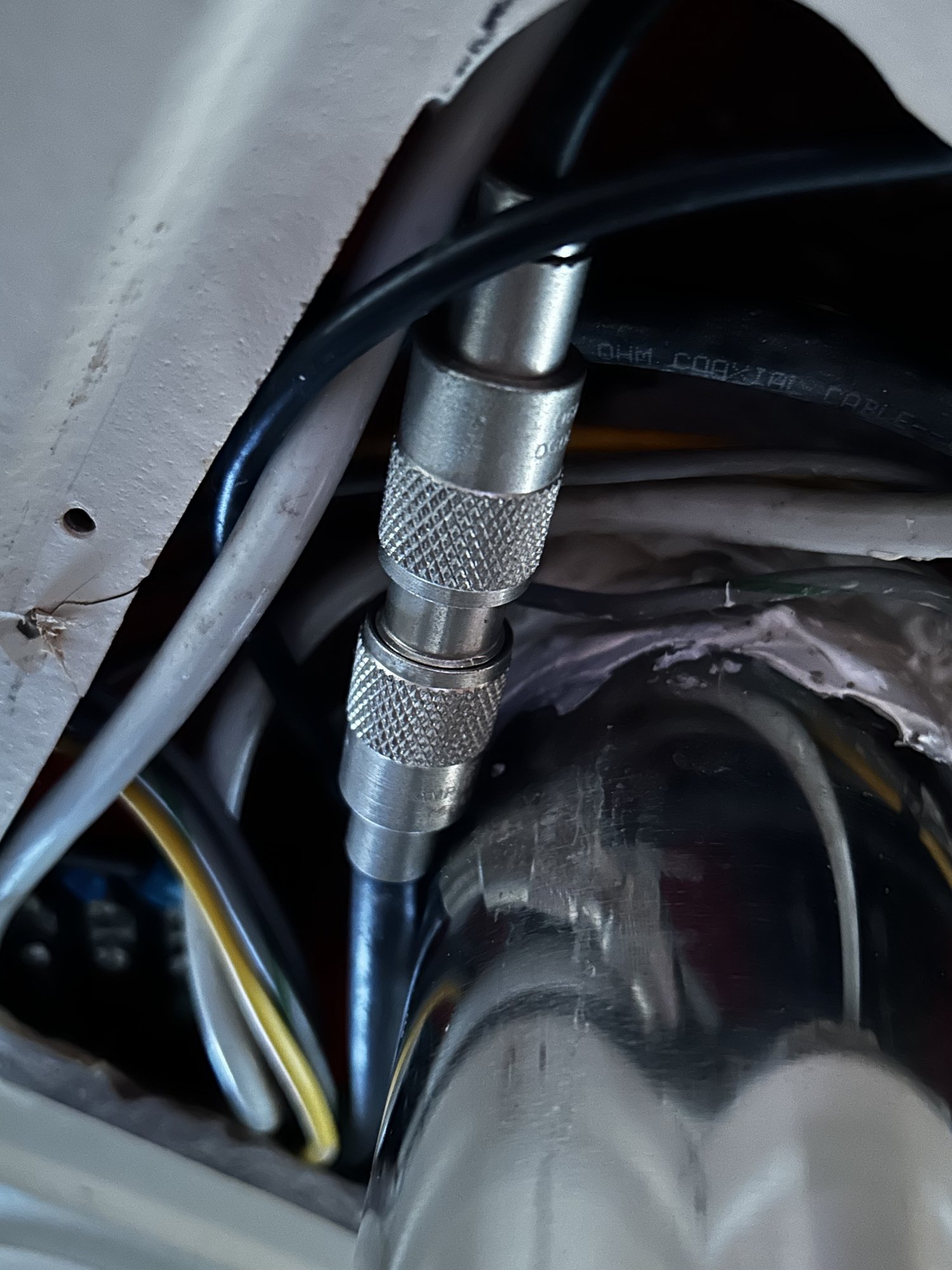

I was thinking of adding one of these at mast base.

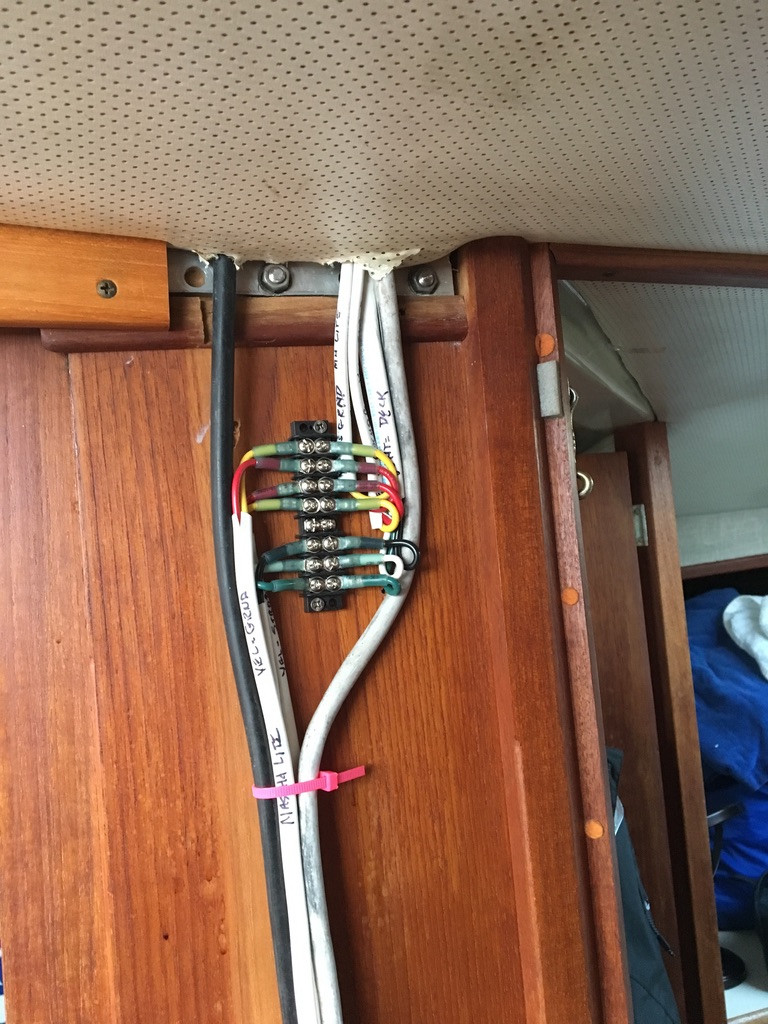

This allowed me to add wire blocks to make the electrical connections.

@Don S/V ILLusion is spot on. Properly installed Coax Connectors cause negligible loss. You need a female on one side and a male on the other, which will reduce that negligible loss by one connection.
Here is the female to use on the wire from the antenna.
Then, use a male connection from the mast base through the boat to the radio.
I prefer the soldered fittings to the screw-on ones. They feel more secure to me.
Silver PL-259 connectors

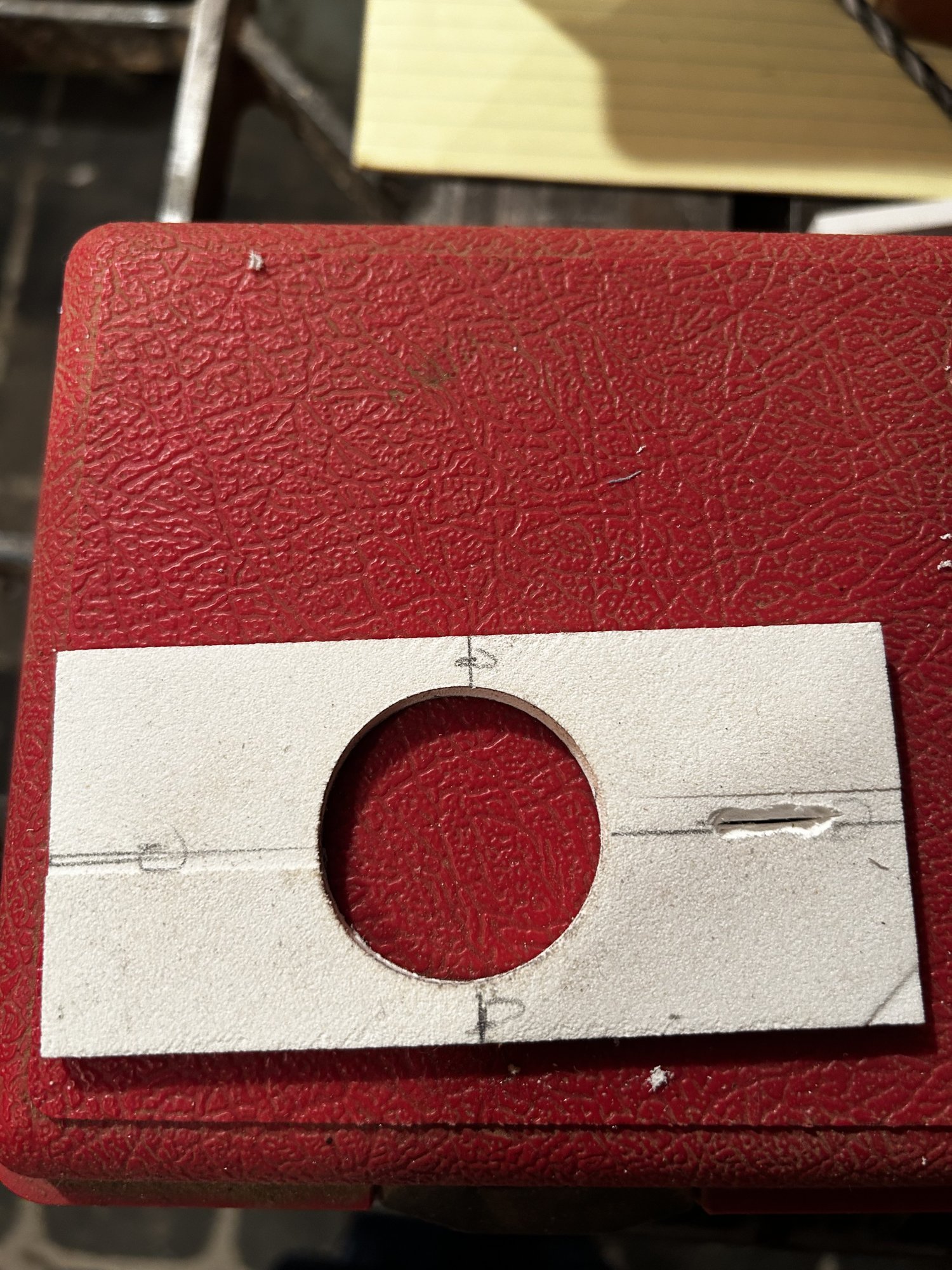

I thought a non-auger hole saw could work but after my trial run in my basement, which did not go well at all and walked across the test piece. I know that it will want to walk along the headliner as well before it bites in.

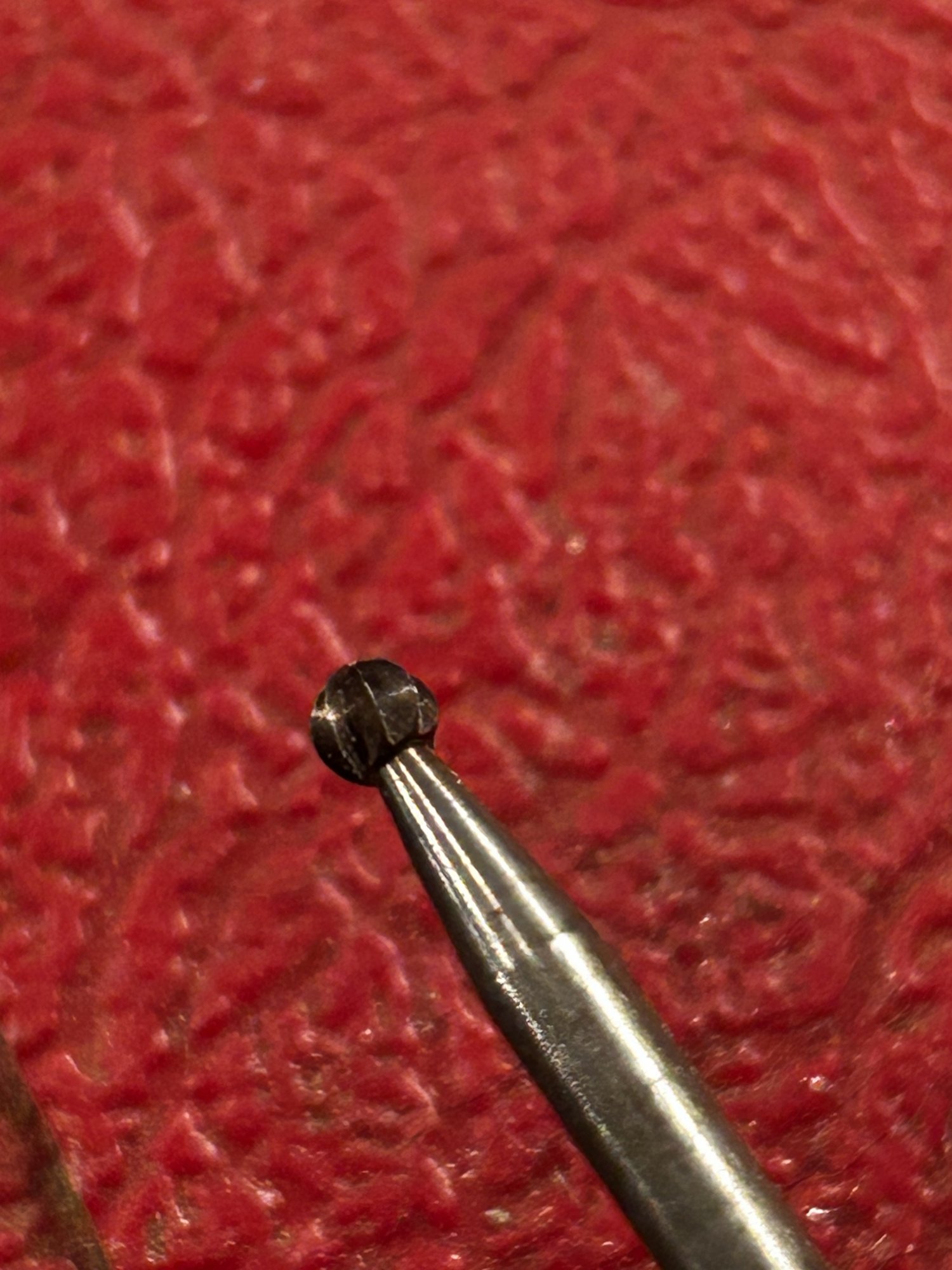

I have considered my forstner bits because they do stay in place, but the center will enter the space first and run around in there before the hole is cut. I had to put this project on pause for a while, but I still have my shop I escape to. So I made up a template and used a round head carving bit on a dremel tool.
I can control the depth of the cut and basically router out an area without breaking through into the open space above. Then carefully use an exacto knife to open up a small hole or cut. From that I think I should be able to see if there are any wires in the way before widening the hole. In theory and in my shop this works. Albeit on a softer material than my headliner. And I’ll need better bits. I will let you know though, if I go with this idea or another’s method. So keep the ideas coming.

Ha! Dremel was my second idea.
You can use a hole saw without the pilot bit. You just have to cut a hole the diameter of the hole saw into 1/2" plywood and use that as a guide for the hole saw instead. It does need to be secured (the plywood guide) with clamps or good double stick tape though so requires a good flat surface. Looks like that may not work in your case though.
24,455
An idea that may work, based on what Bad Orca provided.
Use a piece of wood (with the guide hole cut into it) that can be held in place by a helper. When you start the hole in the fiberglass, run the drill in reverse. This will allow the bit to scrape the surface without grabbing and jumping.

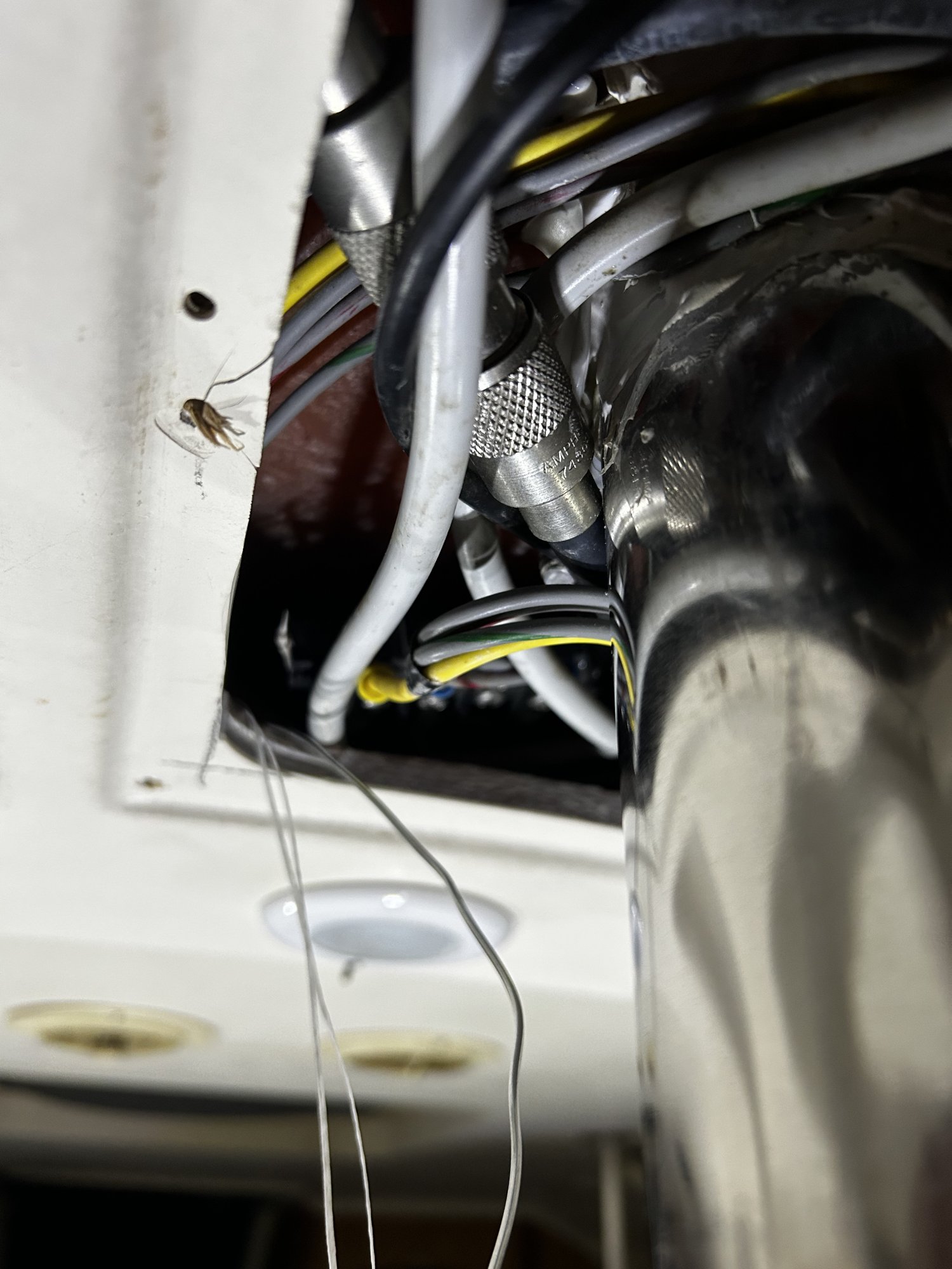

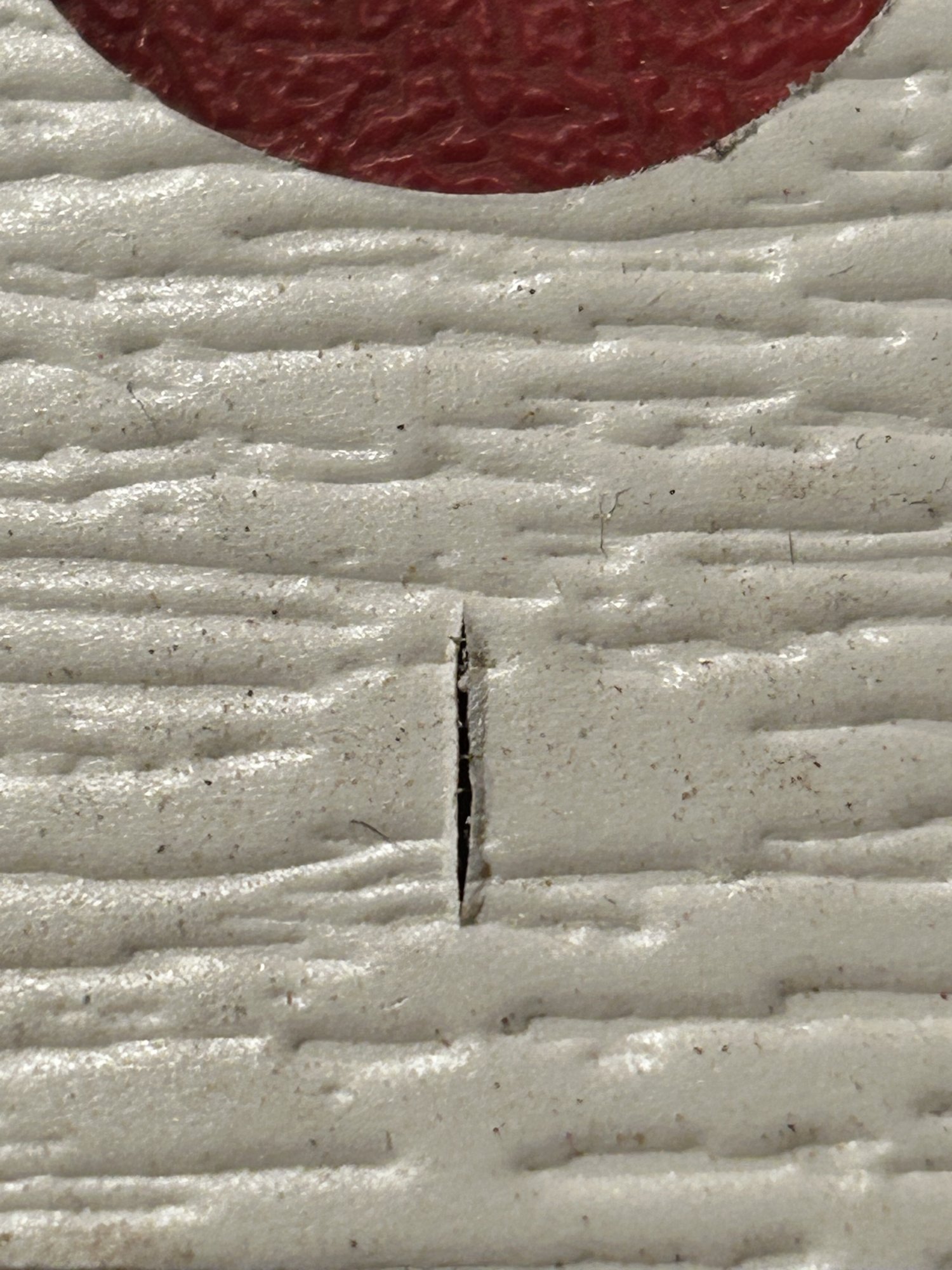

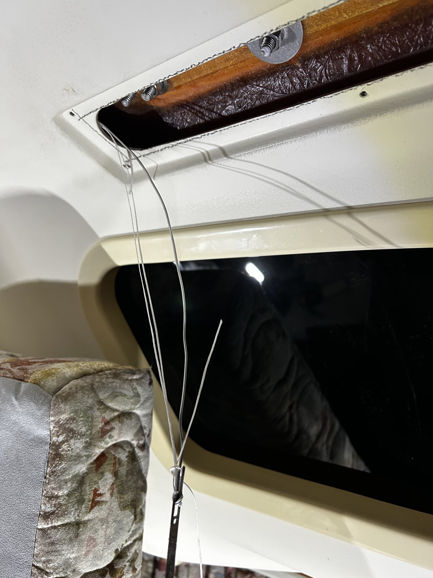

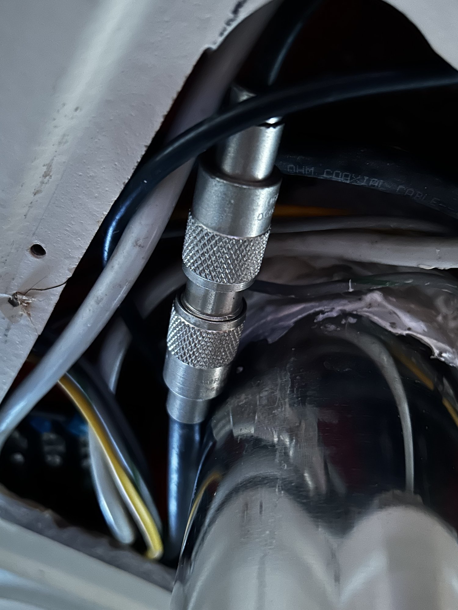

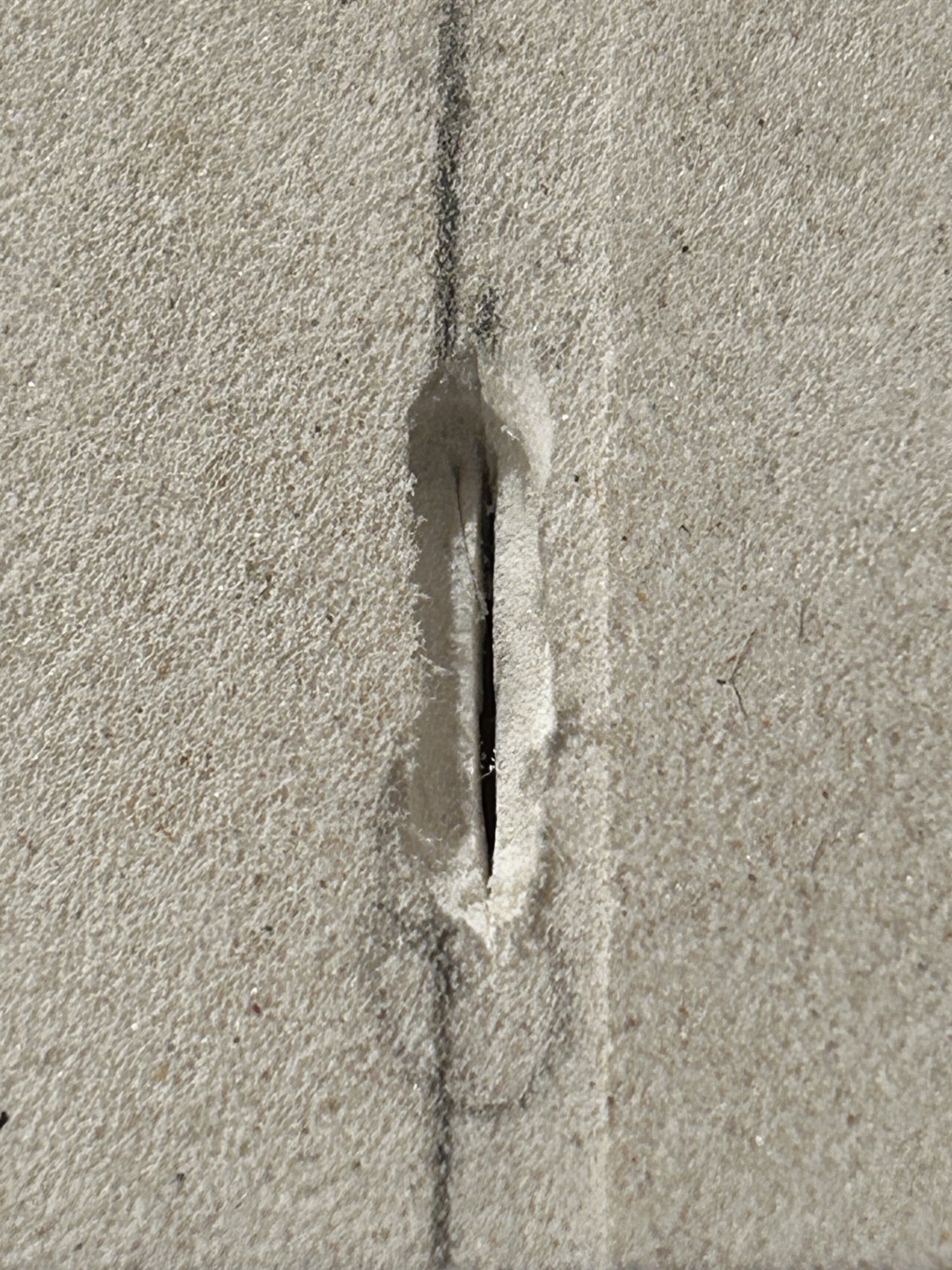

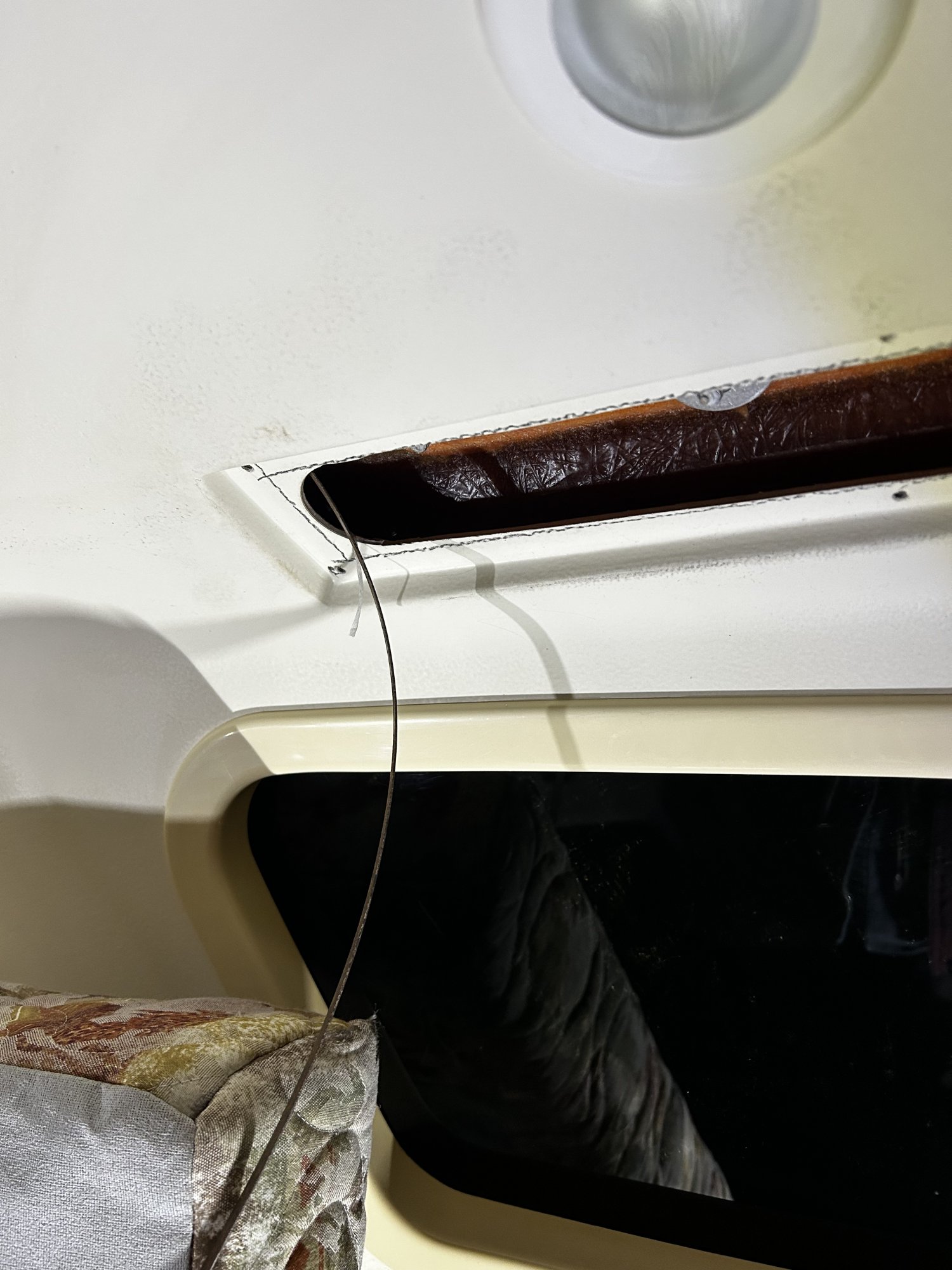

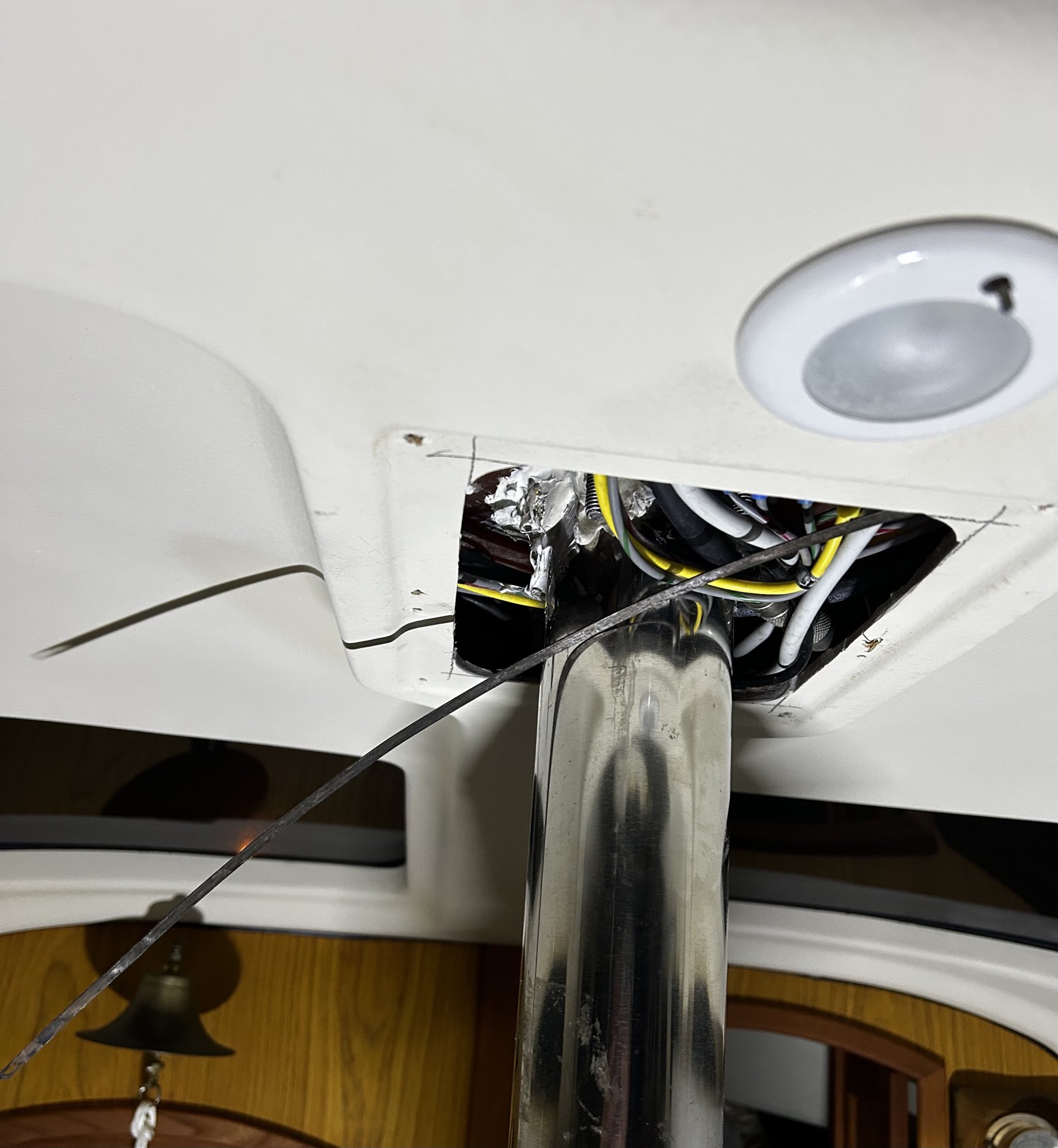

Thought you would be interested in knowing…..I got my messenger wire(s) through! After many tries, too numerous to count, I finally snaked a stiff flat cable snake into the trough and out of the mast base access in the headliner.
I was prepared this morning to cut into headliner at the midpoint area, but not really looking forward to cutting the 1/2” thick fiberglass. So I tried once again and it worked. Oh happy days!
Now I have 4 separate messenger lines in place and just hanging there. 1 stiff wire line, 1 flexible wire line and 2 separate waxed twine lines. Not taking any chances here.
From what I can feel as I pull the lines back and forth there should be enough space to get the LMR400 Ultra Flex coax through the trough. There is no doubt it has to be ultra flex to get this job completed.
While I had to pause the job, due to a death in the family, I made a molding piece to hold the coax along the wall and down into the hanging closet below. Helped me both mentally and aesthetically.
Now I’ll order my coax and connectors.

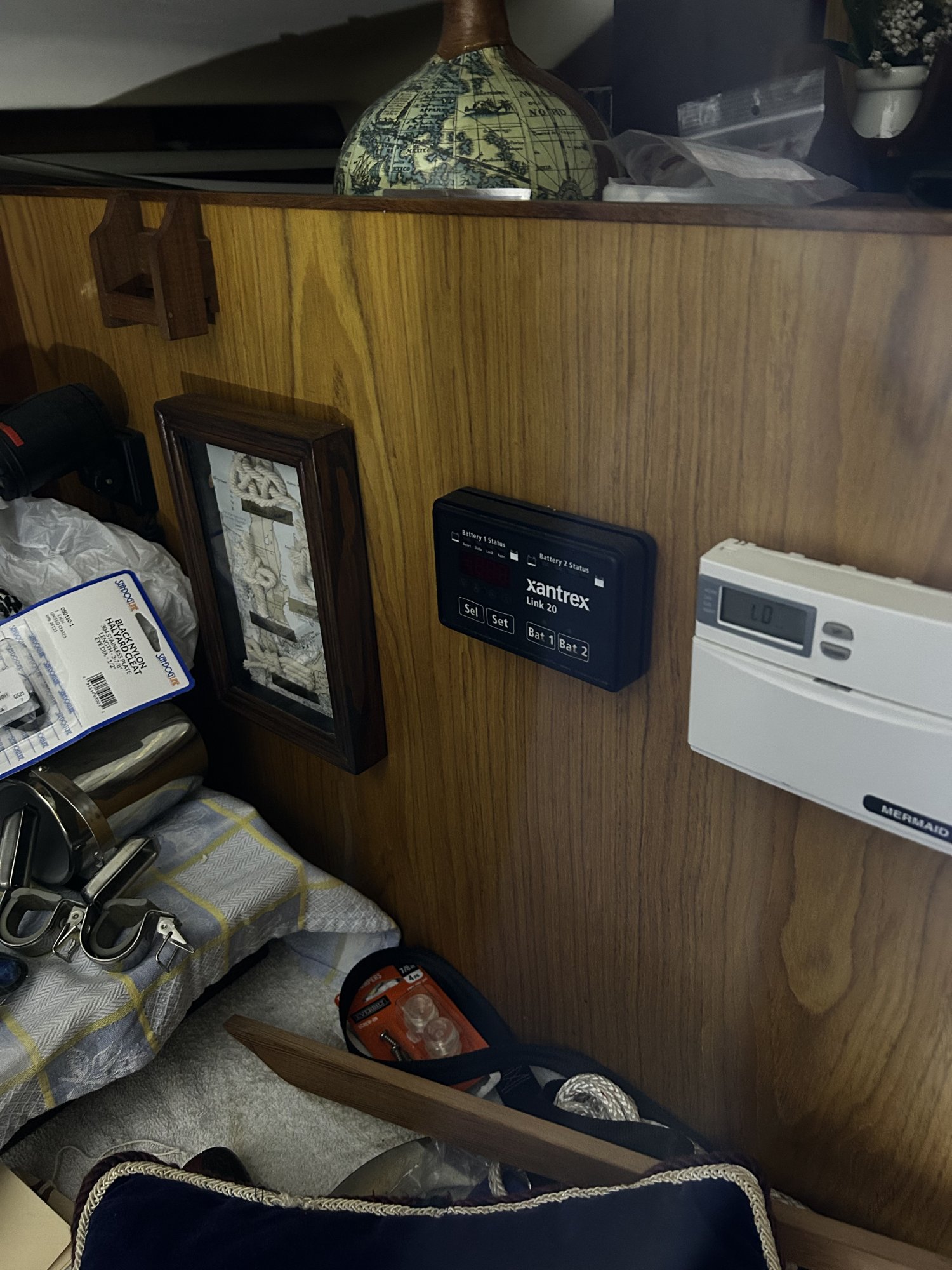

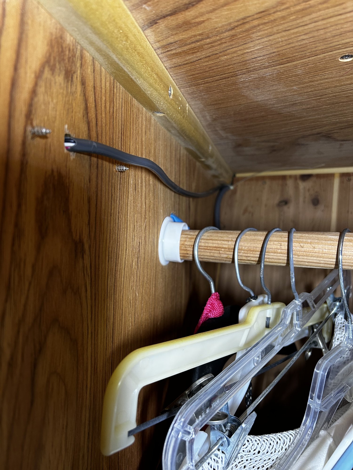

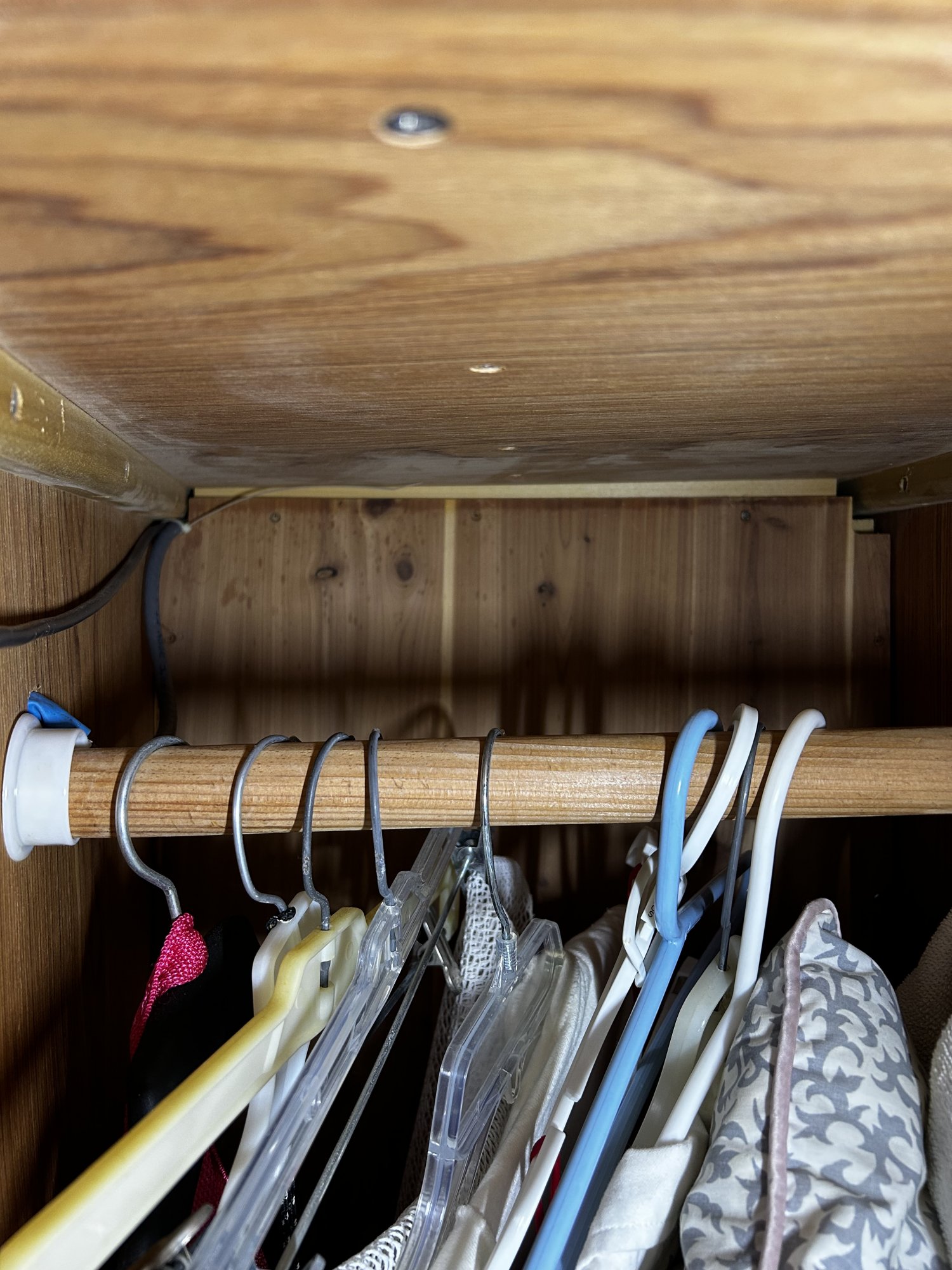

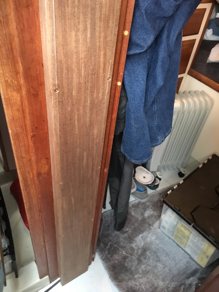

So for anyone who wants to attempt this job (at least on a Hunter 340) are a few photos.
What I’ll end up doing is entering behind this back wall of the hanging closet. Behind that wall is my galvanic isolator and AC and Bilge thru hulls.
IMG_1037.jpeg And follow along to the back wall of the navigation station.IMG_1043.jpeg
And mounting my VHF below the Battery Monitor and AC Control.
That‘s the plan, should work.
As far as mounting a Remote Mic at the pedestal. Behind the back wall of the hanging closet is a PVC Tube wire chase that runs to to starboard side rear access area. I’ve been it that a few times over the years and I know there is a messenger wire waiting for me. I left 2 in there years ago just in case.
I’ll run the wire through that and up into the pedestal.
