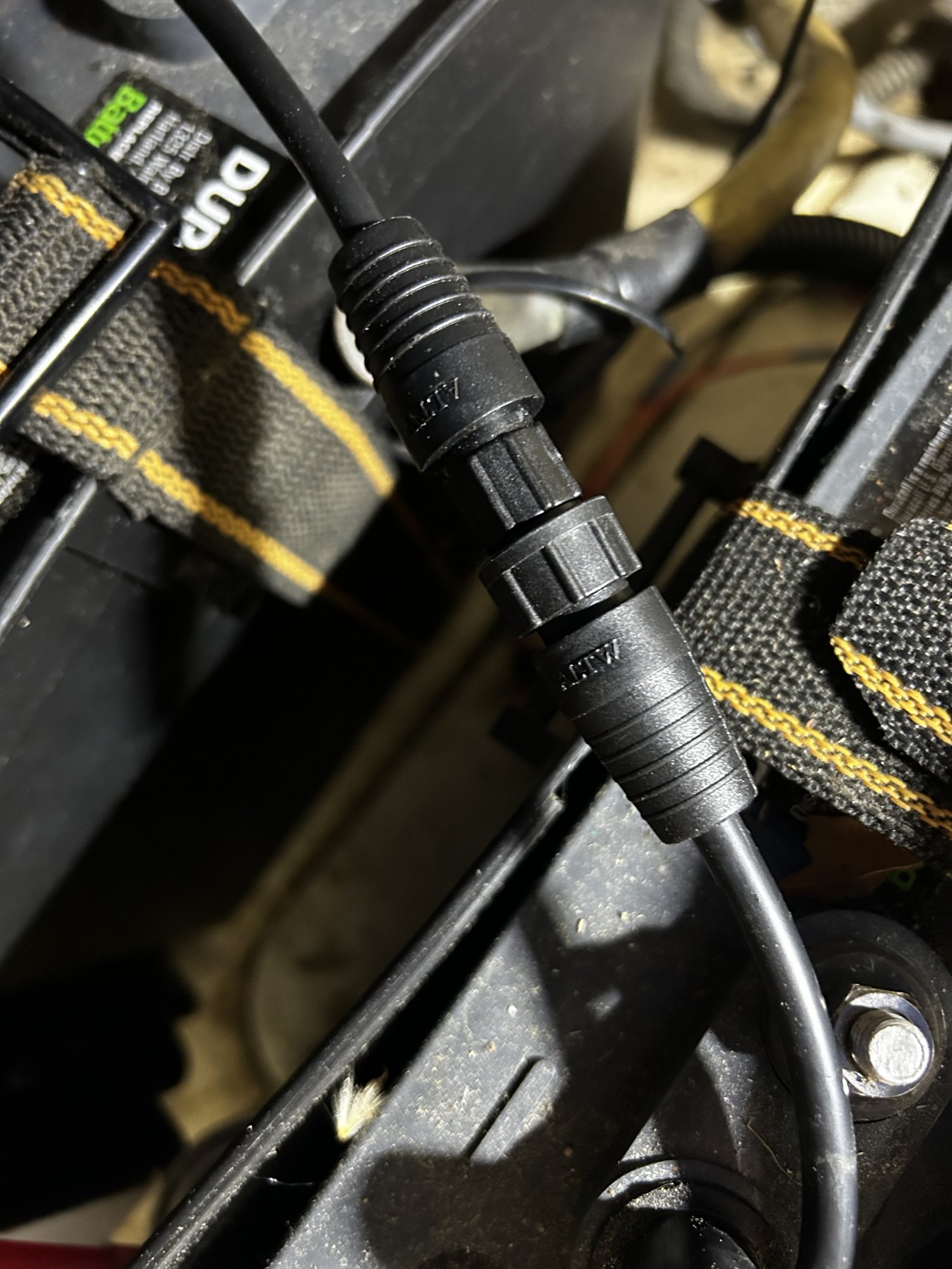

I’m installing a Standard Horizon GX2410 VHF. The remote Mic came with a 23 foot cable of its own, but its short by about 8 feet. So I had to get the extension cable, which leads me to my questions.
The connection between both cables is secure but should I heat shrink it just to be safe? It will be in the open in my battery compartment.

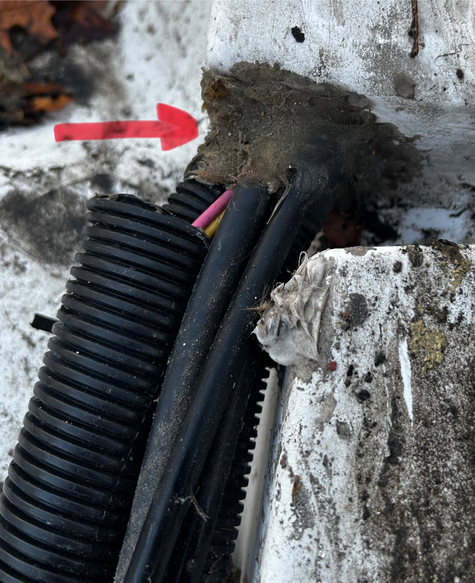

And what is this sealant? It seals the wiring harness to the fiberglass leading under my pedestal. It‘s pliable, I think I can pull out enough of it to get the remote cable through but I need to reseal it afterwards.
It is probably this stuff or something similar. Find it on the very bottom shelf in a Lowe's Electrical department along with electricians tools, zip ties, and that sort of stuff. I just bought some to seal up a hole for refrigerant lines. Electricians use it to seal the hole where service lines enter.

You don't need to heat shrink that connection, but it would be a belt and suspenders to do so. Or give it a wrap with some self-amalgamating tape or silicone tape.
At first glance I also thought that was duct seal or coax seal like @dlochner mentioned, but with a closer look, I think it is just silicone calk.

Heat seal the coax to the connector and in a salt water environment wrap the connecter with self-amalgamating tape.
I agree, its a silicone caulk, just discolored over the years. At first glance I thought it was duct seal also. It will break off and pull, with a pair of pliers. Not easily, but I think I can get enough out to be able to fish the cable through. Just need a good silicone to reseal the access afterwards.
I have the self-amalgamating tape as well. Just wanted to verify before sealing it up.
For sure treat the coax connectors like this. The specific connector he was asking about was the RAM mic extension cable (multiwire, not coax), which uses a waterproof o-ring sealed connector and is located in his battery compartment, which I'm guessing is pretty dry.
