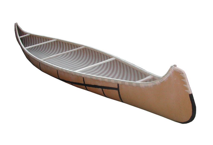

To all those saying the design is too new or modern looking, The reverse wave piercing bow is by no means a new design, In fact it is such a traditional and classic form, it was used by Native Americans building Birch Bark canoes.
The design has very real and legitimate advantages over the alternative overhanging bow, though the overhanging bow also has it's own advantages too, so it's really a question of what design element works best for a particular purpose.
Modern production version of a classic Birch Canoe, still carries the reverse bow design.
