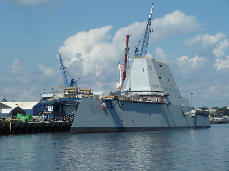

Here is a photo of DDG 1000 getting fitted out in Bath, Maine.
I think the idea is that the bow cuts through the waves rather than riding over them, making for a smoother but wetter ride. I am not convinced, if it was that good an idea, all boats would have this bow.
