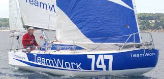

Yeah, well that particular little scow won a trans-atlantic race and left the competition in the mists. So the ocean scow design has proven function.

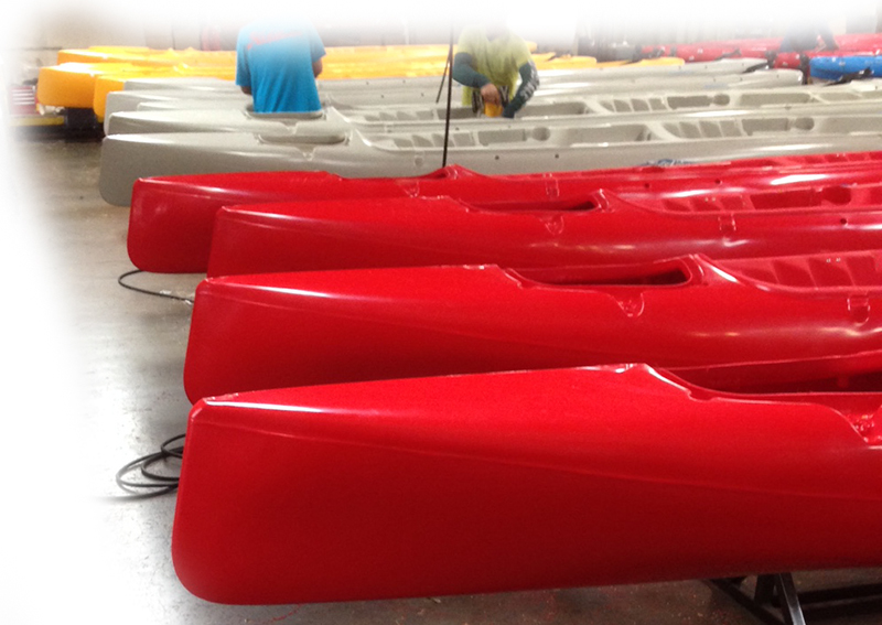

The new Hobie AI and TI's have a slight reverse bow. I have had the old AI since 2010 and the one benefit I can relate to is more volume/floatation forward. Longer water line... these already spend a lot of time exceeding the theoretical hull speed so how much does that really matter. No bow anchor to worry about on these..
Wet ride.. is that caused by a boat just hauling axxx or by the bow shape..
Photo is linked to from the Hobie web site. I have a 2015 TI on order..(and think the reverse bow is about 3/4 marketing.. but also think it looks cool so am OK with that)
