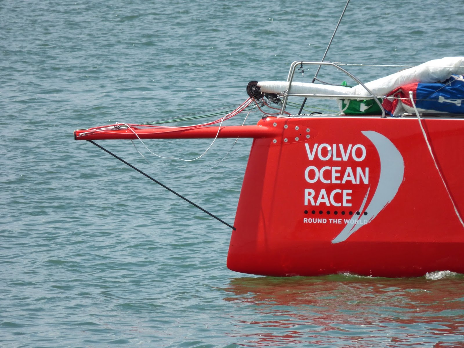

Unlike the very useful plumb bow that now widely seen on production boats, the reverse bow of the new Volvo 65 is a mostly cosmetic feature. Even so, many think it looks cool. Do you think it will appear on a production boat? If so who will do it first?

1.34 times the square root of the water line length.
Great idea, and simply follows what the commercial maritime designers have been doing for the past 40-50 years.
Will underwater parabolic shaped 'bulbs' at the bow be next?
The overhanging bows ( and sterns) on common boat designs are only 'rule beaters' following archaic 'racing rules'.

Buoyancy is a function of volume, not shape. Within limits, if the bow shape has sufficient bouyancy, the shape really doesnt matter.
The reverse plumb bow 'stretches' the waterline length - a speed advantage by creating longer period waves along the hull; hence, faster hull by increasing its 'hull speed'.

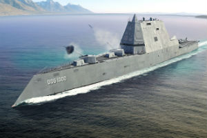

NJLarry mentions the USS Maine. Here is a painting showing her. And let's not forget that ship was built in the late 1800s ! The United States Navy is currently spending billions on new destroyers for its fleet. The Zumwait class ships look different from any other ship you may have seen. See pix attached. Finally, one the the most prestigious private craft in the world, the motoryacht A, built in 2008, 390 feet, reputedly worth $380M which I took a picture of while sailing off the coast of St.Marteen in February of 2013. While those lines come from the past, they are indeed modern and as RichH says, it increases the water line, while slicing better through the waves.

On modern powerboats and warships,this is called a ' wave piercing bow'. Handy.
On sailboats, there really is no function. Yes the waterline is longer, but then why not run the deck to the same length? Doing this allows the forestay to be farther forward, giving a bigger J measurement and more sail area.
The VOR65 was not designed to a rule, so there is no 'rule bending' going on. If Farr wanted the bow to be vertical, they could have drawn the deck 6 inches longer with no effect on the boat.
Under ORR or IRC, the ratings rule factors LOA (length over all), LOD (length on deck), LWL (load waterline length) and LOH (length of hull) to eliminate any rule bending. In the absence of being able to do this, all modern raceboats have vertical bowstems.
