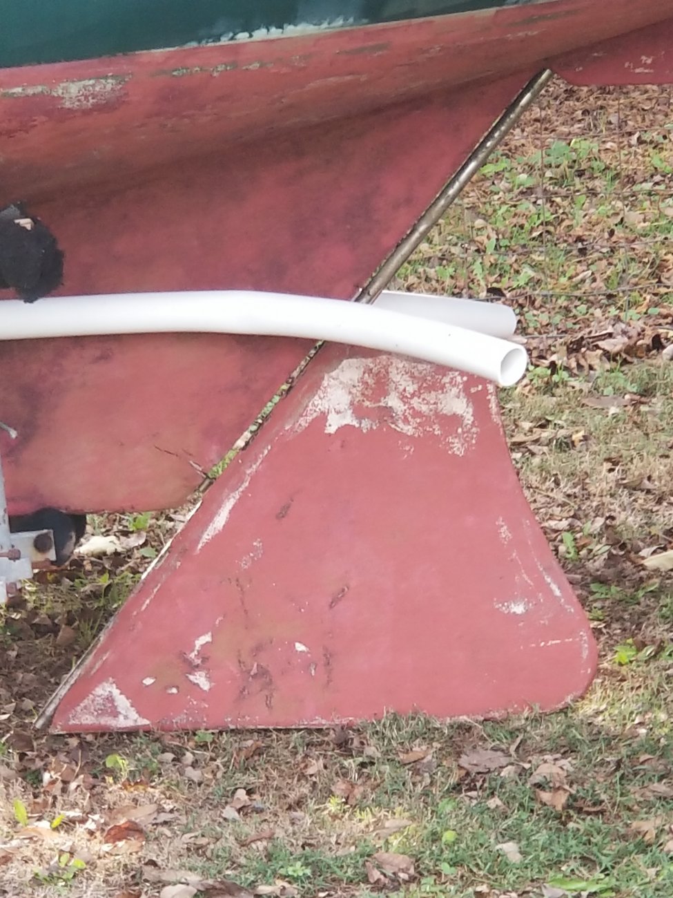

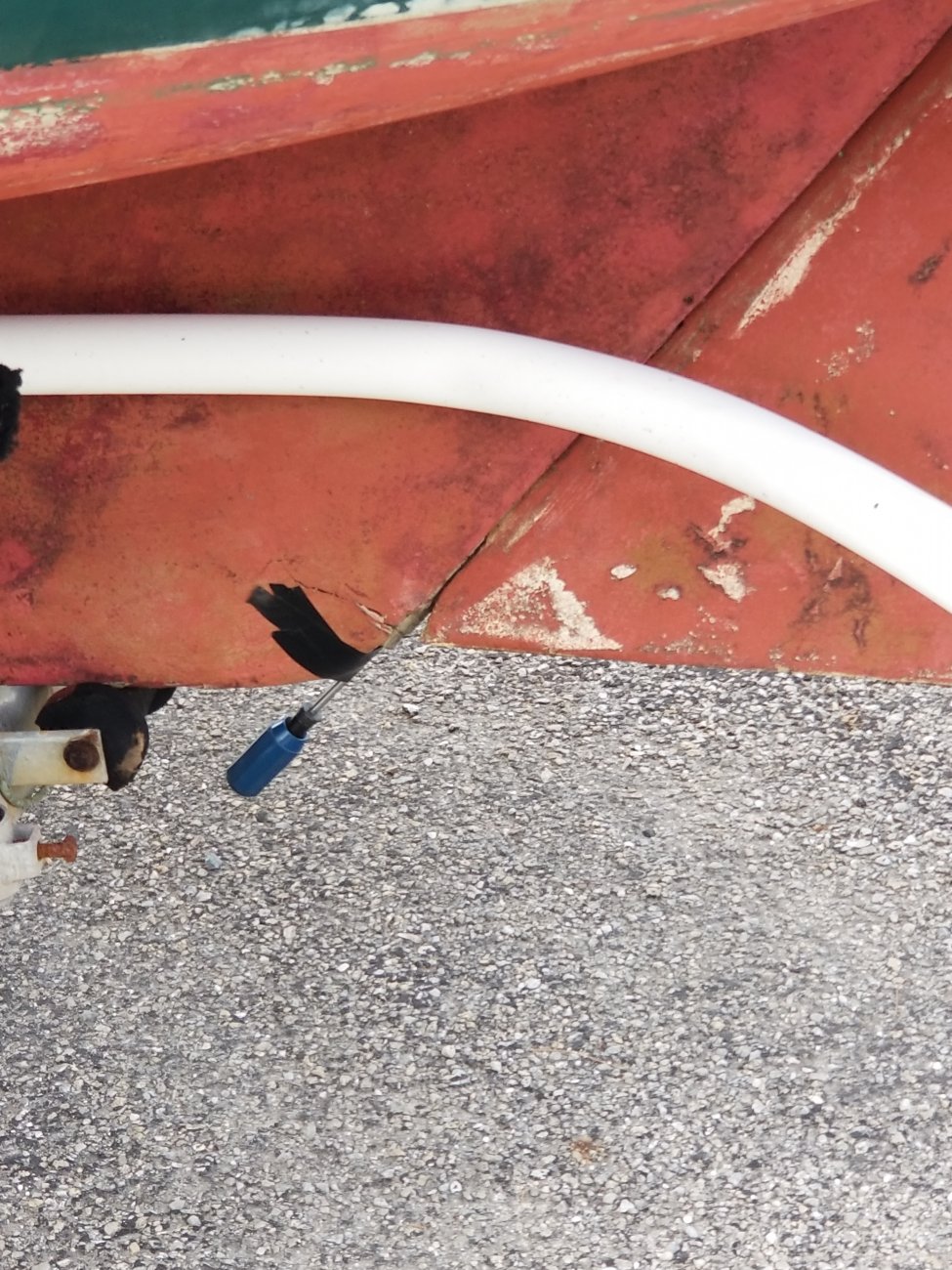

I just acquired a Victoria 18 1981. The bottom part of the rudder has come loose. Not sure what part is missing. Can you tell from your boat how the rudder is attached to the bottom gudgeon? I don't know how it connects. Just know that it isn't connected. Not sure if something is broken off or if the pintle is a separate piece and has come loose or if the pintle is threaded and screws up in the rod that runs along the leading edge of the rudder. The one picture shows where I have put a screwdriver and taped it to the keel so the rudder stays on top of the bottom gudgeion.

That rod on the leading edge is connected to the tiller and is what moves the rudder itself. There should be pins or small bolts that attach the rod to the rudder so that when ya move the tiller, the rudder moves. The attachment is probably at the bottom of the rudder so that it can be accessed for rudder removal.. Not familiar with that boat but that is what I see..

I see the keel is a different color. Black? Did you need to do any work on that area?
