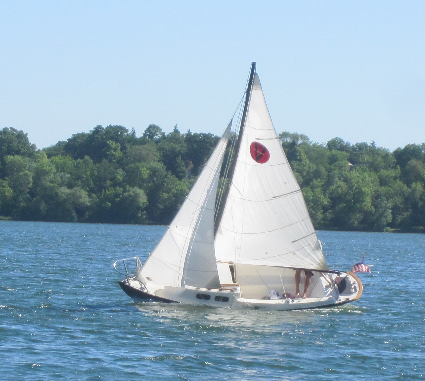

The Vic18 is a great little boat. VERY easy to solo sail. There is like 10 of them on Lake Harriet in Minneapolis. I used to keep a First 235 there, and when I was out my V18 friends would try and catch me. Come to think of it, I should have let Nancy (in the sailor cap) succeed!

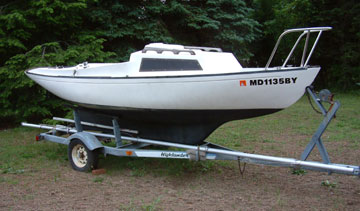

They are a pretty little boat. at least in the photos. We'll be headed out (3 hr drive) in the AM to take a look at her in person. this is the actual boat/trailer we'll be looking at:

I reck'n you need to sail her right up on the trailer? I don't see a motor ;)

I was bored and began reading up on information available online for the V18, when I came across an article that I found interesting in regards to speed. the boat is 18.5' long, but only 12.83 at the water line, apparently accounting for periodic complaints of being slow. The author points out that due to the design of the hull, LWL increases greatly when healed over, yet many new owners/sailors feel uncomfortable allowing the boat to heal over enough when looking for speed. The factory literature even states that best performance is gained when sailed at 18* of heel, as the boat then shows 17' of waterline. The factory also states that in higher winds you can let it go as far as "25* angle of heel and sails tremendously at that point". ;) . 46% of the hull weight is keel (550 lb), so there should be little fear of capsizing.
I understand the hype with sales literature, but nevertheless, I can see a grain of truth in all of this. What say ye @Jackdaw ?

For sure you can sail a Vic18 with a HUGE amount of heel. And yes it does increase the waterline and allows a faster hull speed. This is true for most boats... the waterline length is usually the length of the waterline on the heeled side.
Here is my buddy Glen making his way to windward... with a HUGE amount of weather helm.

Don't know if it's just an optical illusion, but doesn't that mast seem to have a lot of aft rake?

Optical Illusion. On fractional rigs a reverse bend (inversion) will immediately collapse the mast.

That's what I figured, it must have been a lens aberration. I knew inversions were bad, but I didn't realize they would collapse the mast. I don't care for inversions :D
