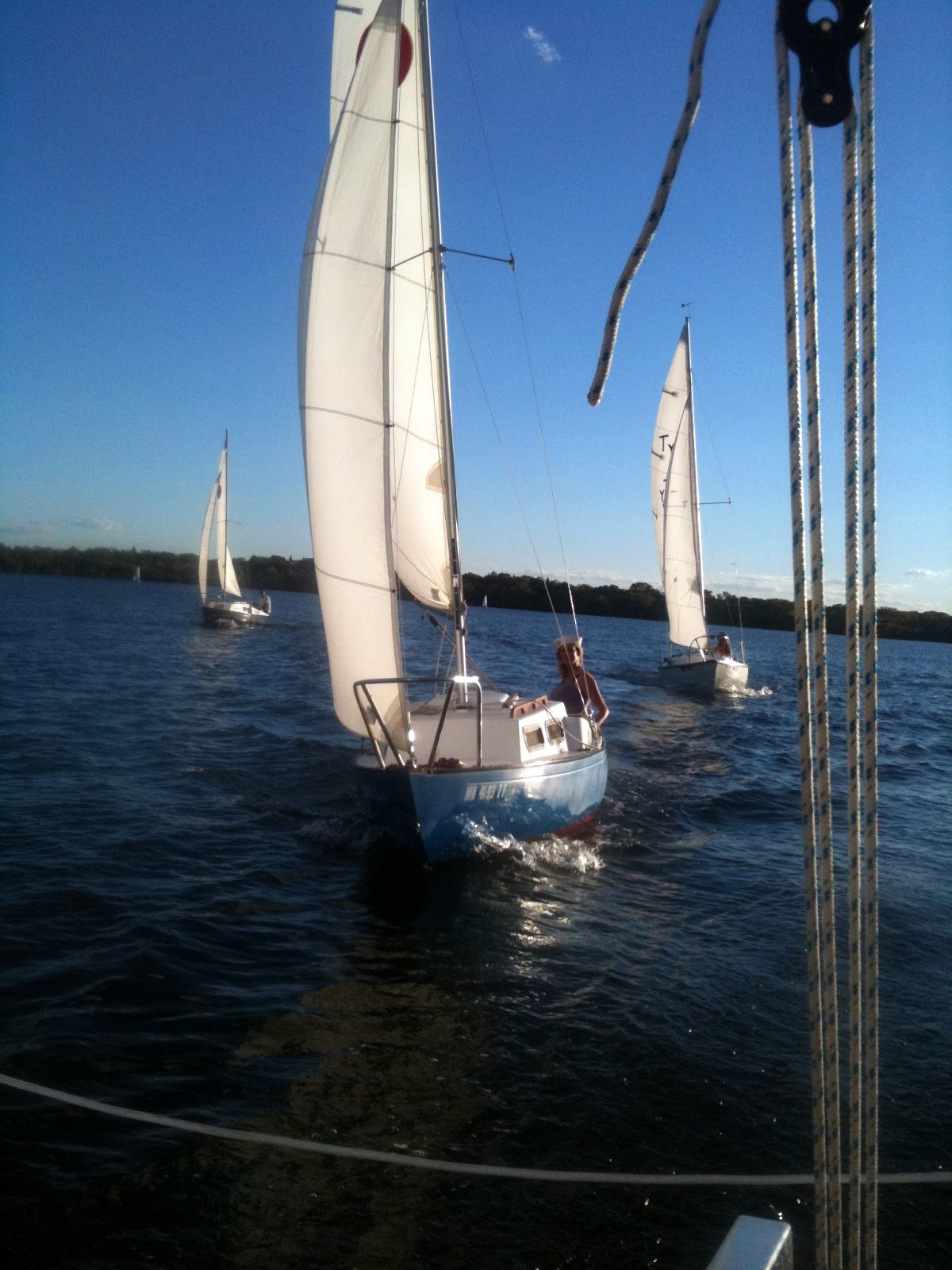

when I was out my V18 friends would try and catch me. Come to think of it, I should have let Nancy (in the sailor cap) succeed!
I can't decide if that cap was made for her or if she was made for the cap. But you made a HUGE error in not letting her catch you!
Kermit
Jul 31, 2010
5,722
I was trying to keep her close! ;^)
Nancy is a good friend and a local artist here in town. I go to her exhibitions regularly.
Maybe you should take lessons from John Travolta in "Phenomenon" and buy all of her paintings.
