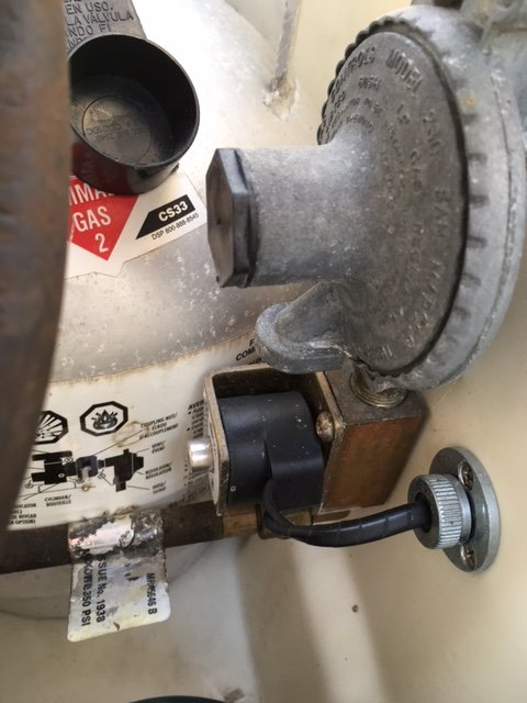

It may not be on the panel.
I would first check the locker(s) for the solenoid hardware. If you find it, maybe you can trace the wires to a switch.
If you don’t find it, then maybe it doesn’t have one (but again, hard to believe unless the boat was set up for CNG or alcohol originally).

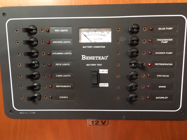

Sunlover,
Your boat is a mystery.
If it was not French built and was built in US, the first letters of the hull ID number should began with "BEYN".
I am wondering if the boat could have been built in the US per specs of a Caribbean charter company. Your DC breaker panel is suspect.
I have attached a photo of the USA built 343 panel on my boat and is same that I have seen on several 343's when searching to purchase.
As you can see in the photo, there is a dedicated breaker for the gas valve / solenoid. After reading some of the posts, had me guessing the whereabouts of my solenoid. On my 2006 model, it is located in the propane locker. Very easy to access if it needs replacement. The
only gas shutoff valve that I have is on the propane tank (other than the DC actuated solenoid valve). When I finish using my stove or
oven, I turn off gas valve breaker & allow to flame to self extinguish, then immediately place the knobs on the stove to off. If I am staying
overnite, on the boat, I also turn off the valve on the tank as an added precaution.

Sunlover,
definitely nothing like your photo. no solenoid in the LP locker. I'm actually very paranoid after my attempts to disconnect the LP regulator that I've created a leak, so I'll definitely keep the tank valve turned off.

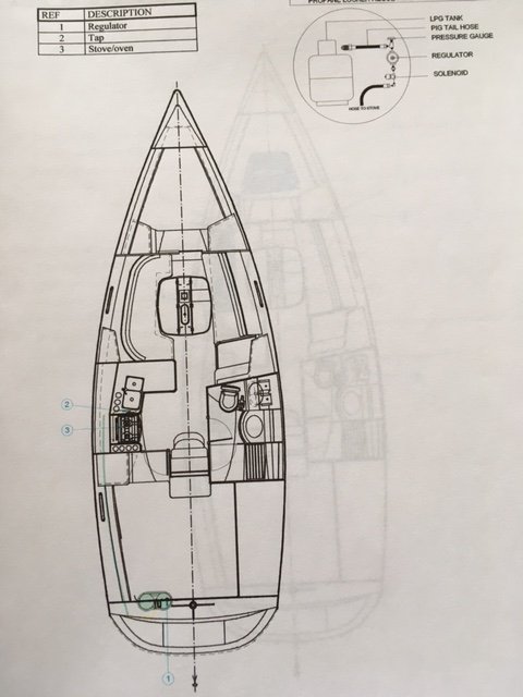

I know that you are eager to splash the boat & start sailing. If you are over-nighting on the hook or in a slip and want to have a means on board for preparing a hot meal, one idea is to simply install a propane grill on the stern rail. You can cook quite a few things on the grill, especially if it has a hot plate / griddle. A grill is nice to have, especially in summer months in Florida, because using the interior stove heats up the cabin very quickly. Can always rebuild your galley stove/oven later, when you have time. The components needed to bring your system up to date are readily available from Beneteau or major chandlery without breaking the bank. See pages 69-70 in your owner's manual.
