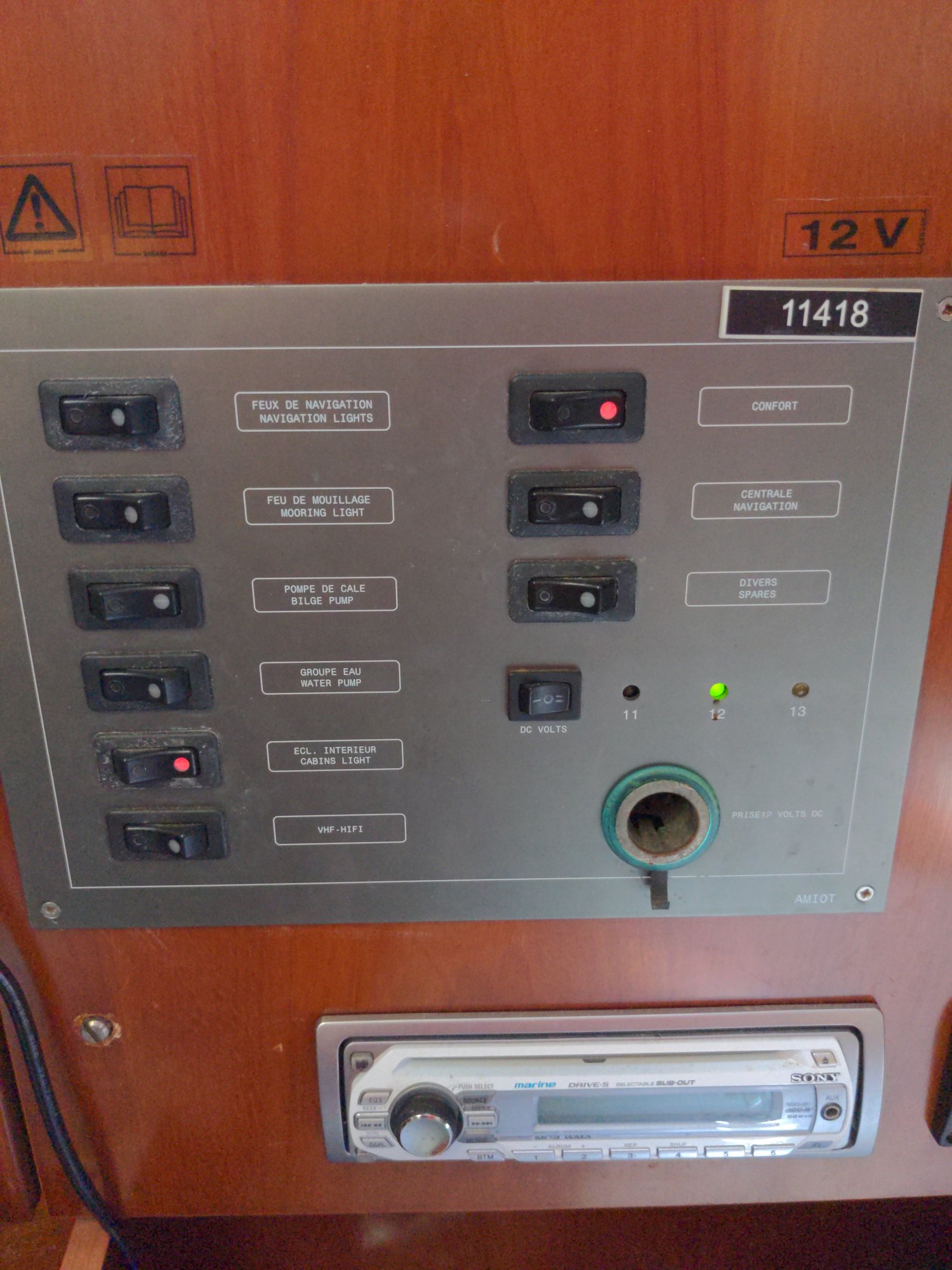

here's my panel. Let me know if you see it.

Totally different Panel. Must be a French built 343, and requirements were different

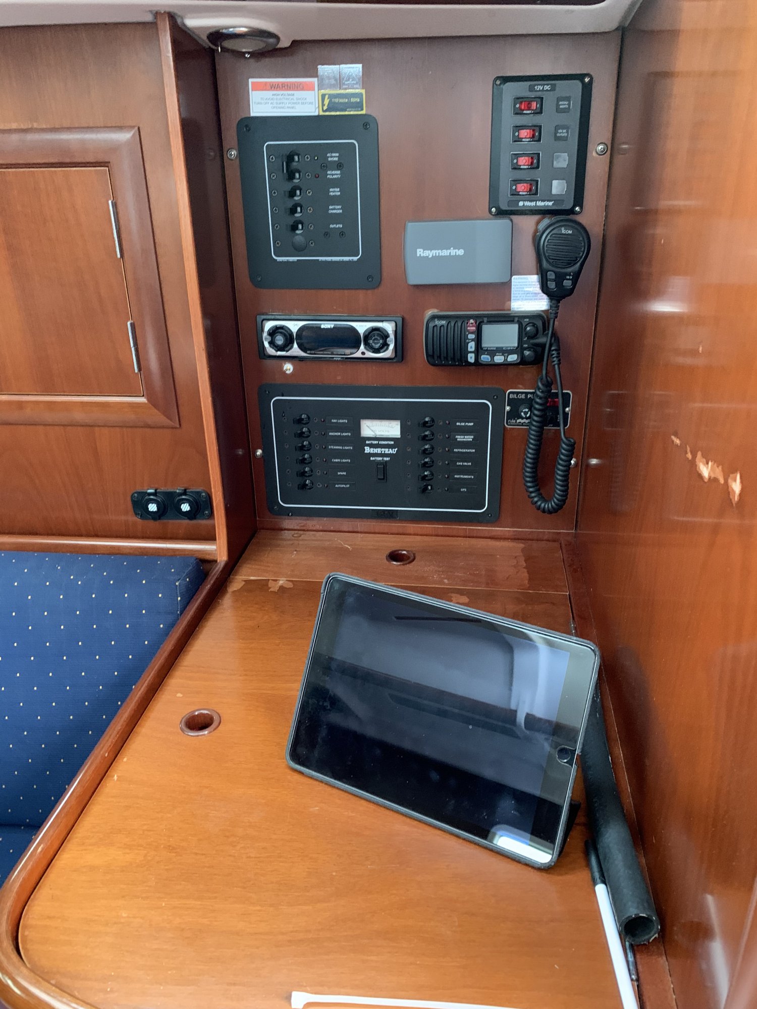

2A4B3051-7809-404B-B7E2-8E8C58C412BD.jpeg Beneteau panel (bottom) switch labelled ”gas valve” is in the right bank

This a French panel, they have butane gas & ususually no gas shut-off. If it isn’t the « spares », then look close to the stove itself.

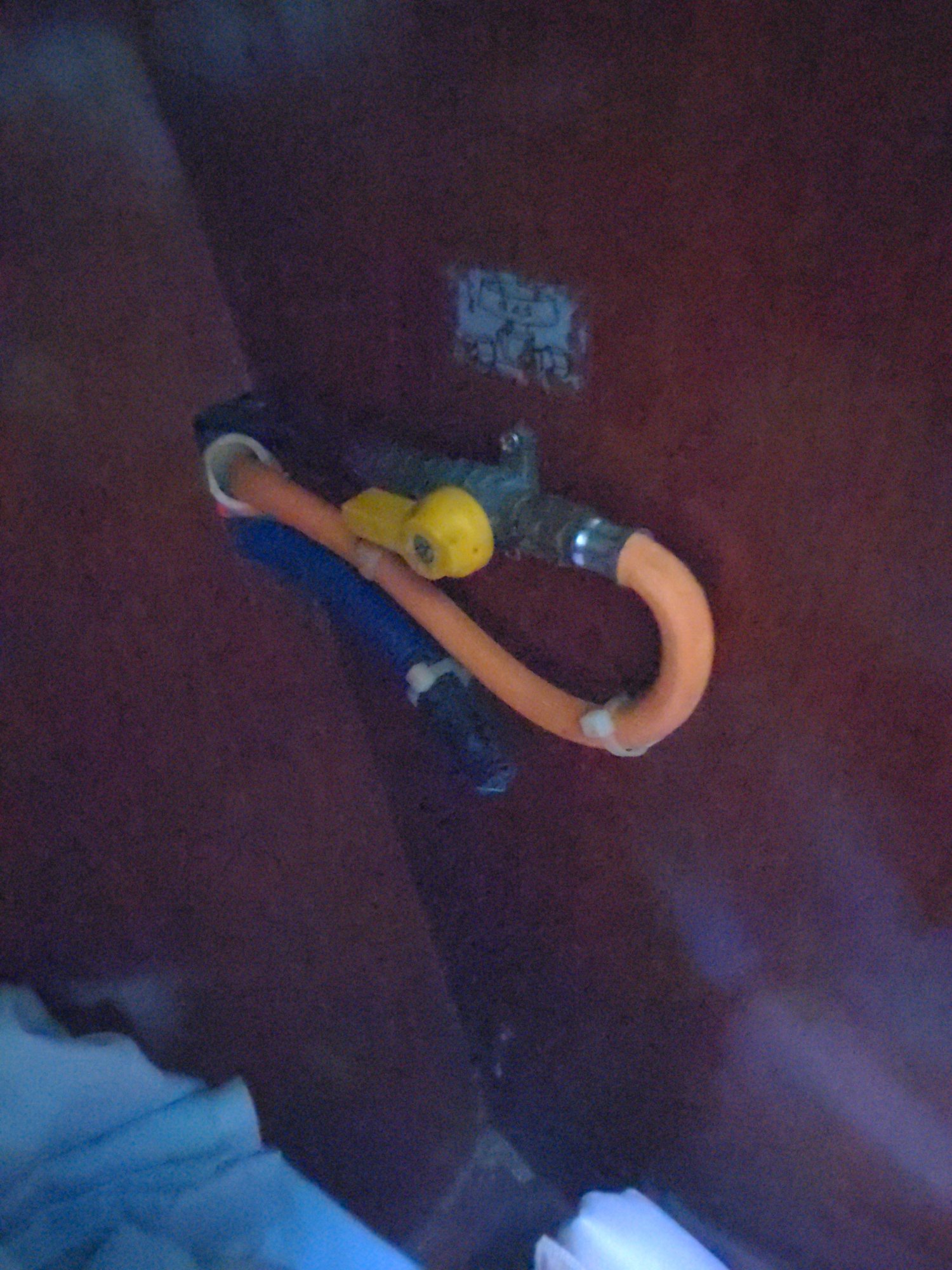

The valve in your picture is just a shut-off valve not a solenoid. If your electrical panel does not have a switch and Label "Gas Valve" then you probably don't have a solenoid. Previous posts may be correct regarding French manufactured 343. Mine is a US built 343 and has a switch on the electrical panel "Gas Valve" and a solenoid powered by that switch and it is located under the LP tank locker. You may want to research the difference in LP and Butane since your system may be designed for butane.

Let me know if you see it. Bonus points if you know what diver spares is.
Jan 18, 2016
782
Catalina 387 Dana Point
"divers" is French for miscellaneous. i.e. "Spares"
From the pics, it looks like you have a manual valve and not a solenoid. The solenoid should be outside in your propane locker, but boats are all a bit different. Where the gas valve is, looks like inside the boat, is not an improvement in safety.
