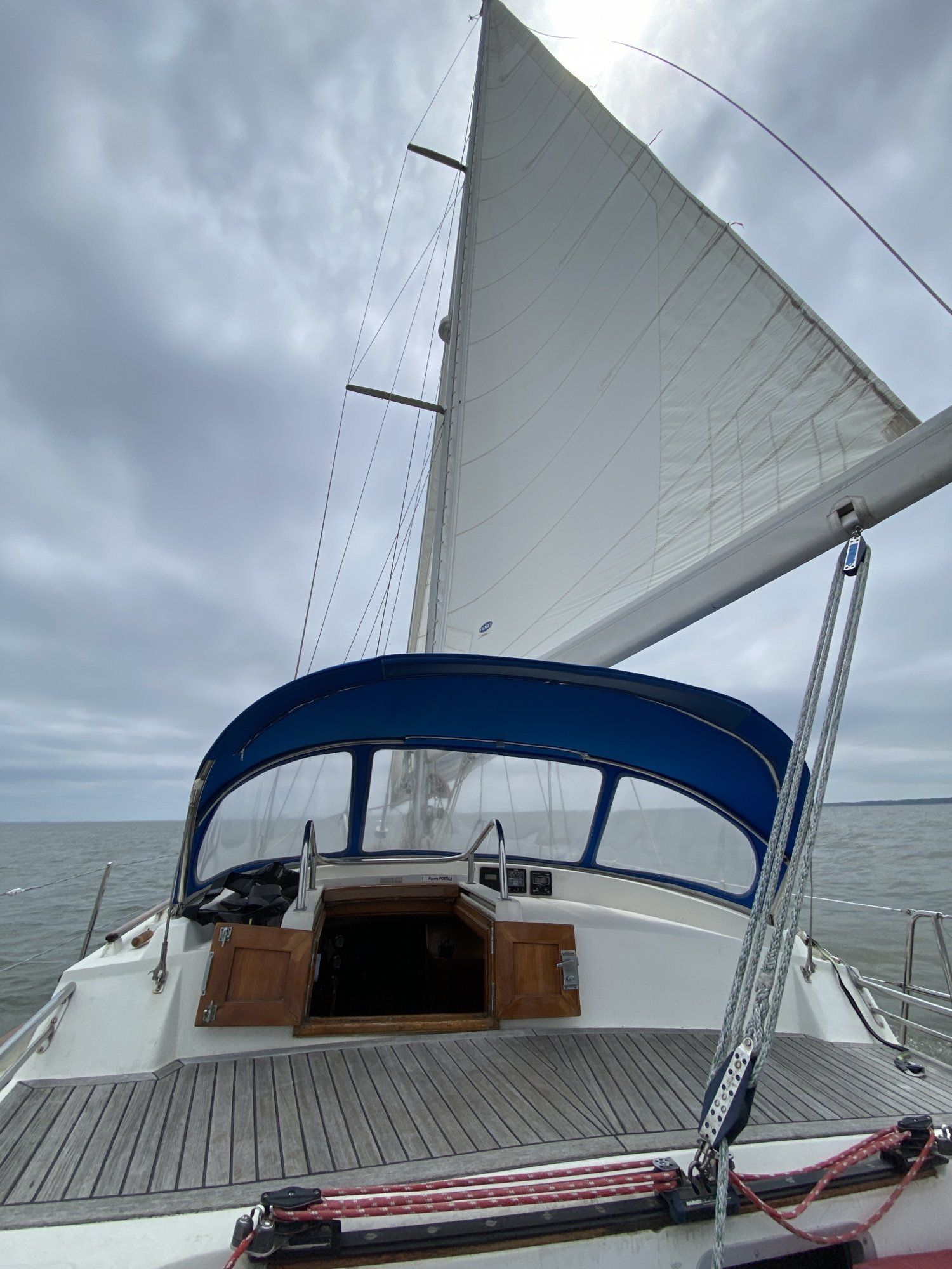

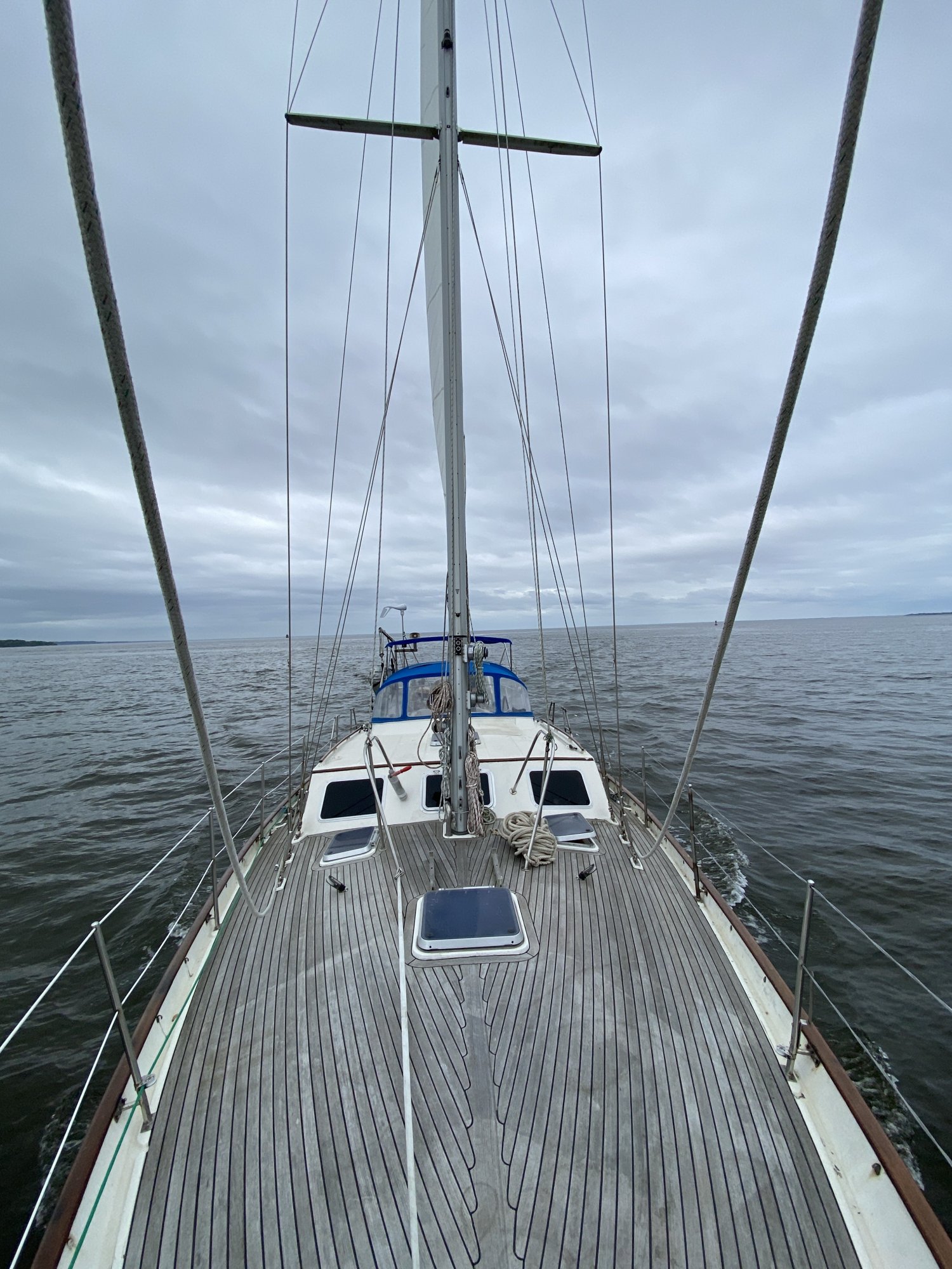

Dave can John post a picture of your mast and rigging here?
Jim...
PS: John gave me a copy too

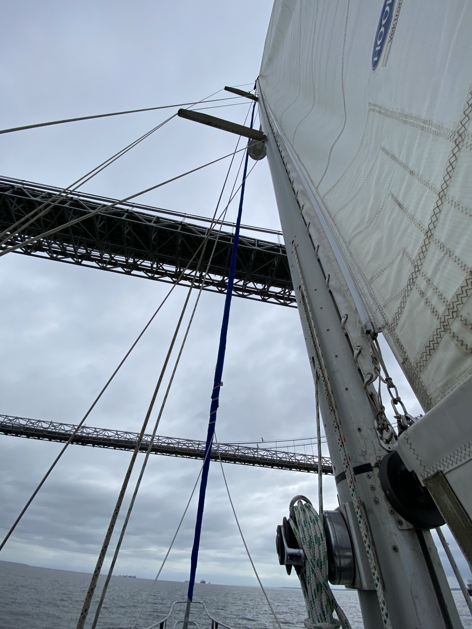

dj
Any chance you have any pics of that spreader end fitting?
No. Not at this point. When I get to Horta I can. Too bad I didn't think of this when we were working on getting it back in place. Might of been able to get and end shot.... With everything up, I don't see how I can get a pic now of the end fitting.
dj
24,828
David’s boat mast images.

Thanks. Maybe I can enhance the images.

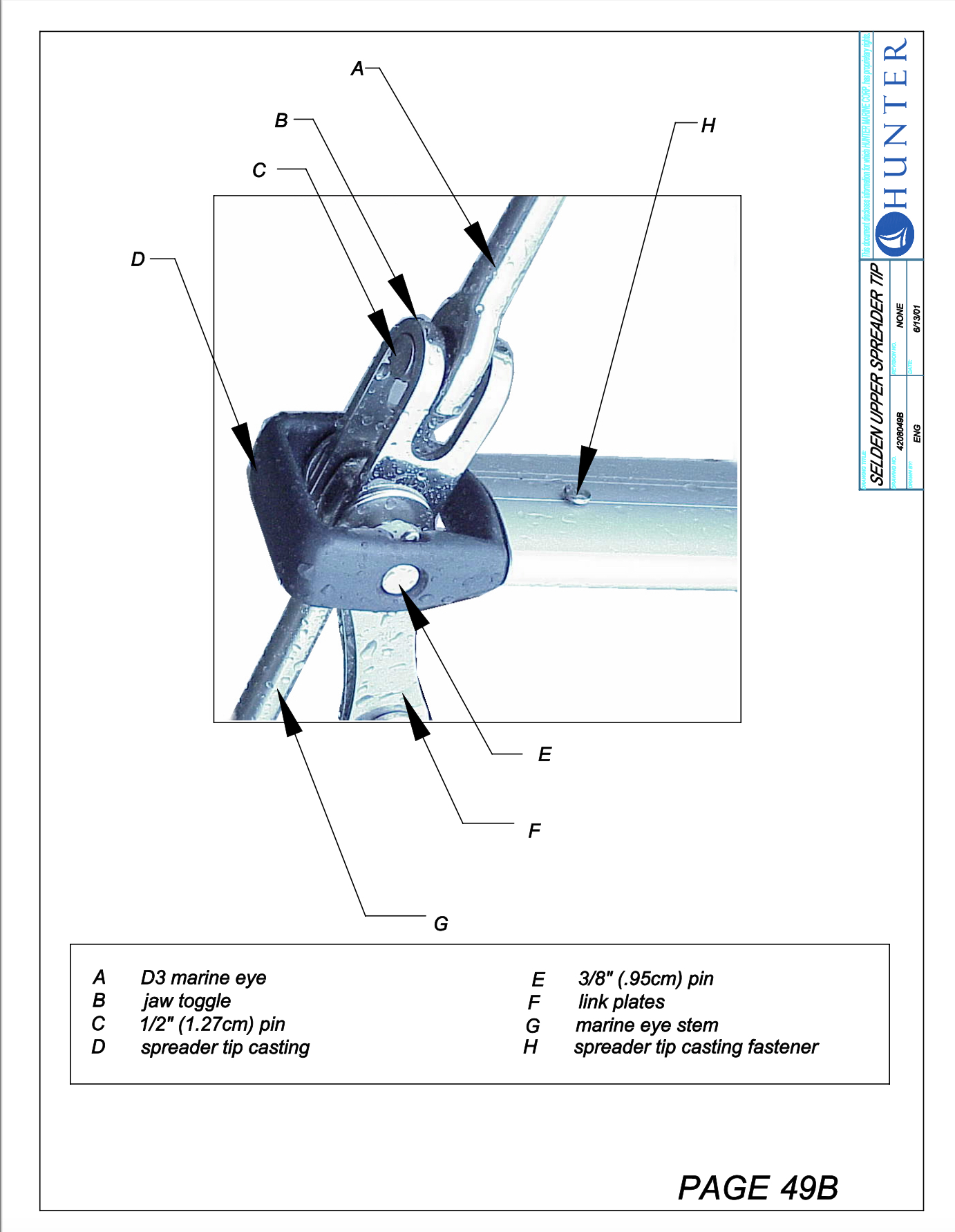

@dLj , can you describe the broken fitting, or perhaps draw a little sketch from memory?
If you can find an exploded view of some Seldon end caps, you can post them to him to see if they look close.

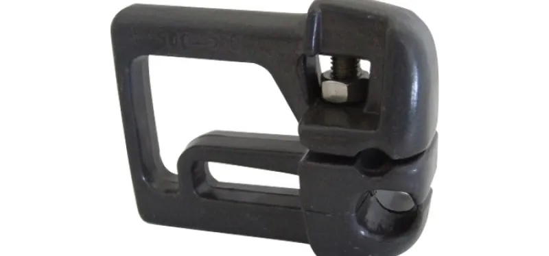

This from the Hunter 420 manual which is the same size boat as Daves.
Selden mast too.
Jim...
JamesG161
Feb 14, 2014
8,106
Hunter 430 Waveland, MS
The Spreader Tip casting "D" , my post #211, is what is missing.
But once in Berth in Azores, Dave will fix it.
Jim...
But once in Berth in Azores, Dave will fix ti.
Jim...
Ah, gotcha, I didn't know when you posted that, that you knew for sure.

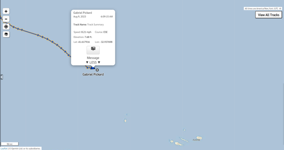

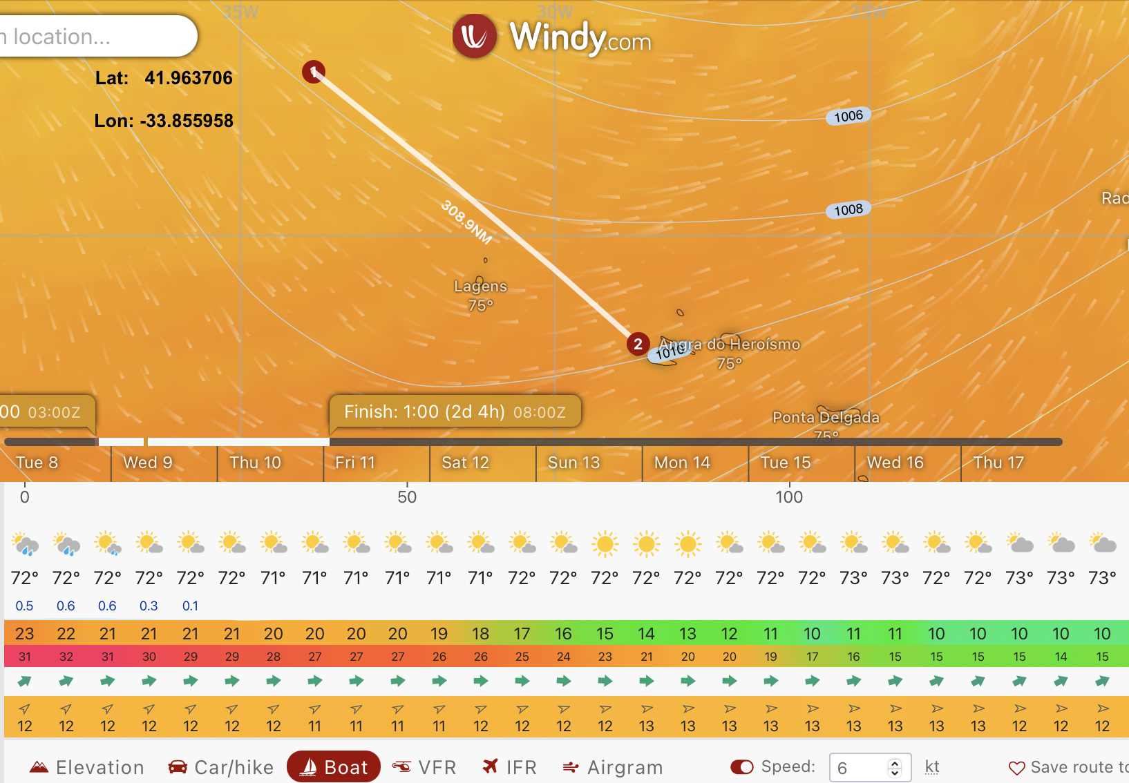

Having survived the Atlantic Storm, They are sailing oin much nicer weather.
Projected arrival in the Azores would be Friday.
Last position report.:
Gabriel Pickard
Aug 8, 20237:09:15 PM
Track Name: Track Summary
Speed: 5.00 mphCourse: E
Elevation: 7.68 ft.
Lat: 41.963706Lon: -33.855958

The last couple of days should be really nice. Do you run a asymmetric or something else for downwind work.
Describe perhaps yes, draw right now no. None of the pictures of tips above look like mine.
There is an insert in the end of the spreader with a single notch. That piece is still in the spreader and being used, thank goodness, without that I doubt we could be where we are with our current Rube Goldberg.
On the end of that piece there is a plate within believe two screws that go straight into that notched spreader tip clamping the two stays into the tip. It quite low profile, I can hardly seen the one on the other side from deck.
