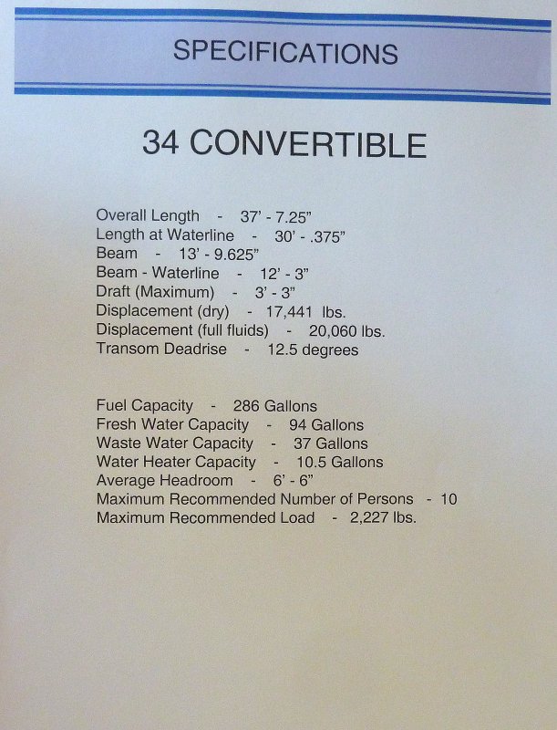

For those who missed it this is PAGE #1 of the Silverton 34C owners manual. These specs, with SAFE LOADING, are not buried deep in the manual. It is easy to find, took me all of about 30 seconds, and though for the later, but larger & heavier 34C, it shows a very good guideline for safe vessel loading of a boat of that type.
I have spent countless hour on vessels of this type and even 15 would be obnoxiously over loaded on an 80's Silverton 34.
I spent an entire 14 hour day tuna fishing on a 52' Buddy Davis with 13 total people, 3 crew & 10 guests, and even on that massive vessel 13 was completely and utterly uncomfortable and in rough seas not everyone had a place to sit comfortably even on a 52 footer. The captain made the comment he would never do that again and decided that day that 10 total was the max limit for that boat despite the technical "safe loading" being much higher..
Silverton 34C Owners Manual Page #1

Right ... so if the capacity was required to be plainly posted on a capacity plate, a cautious adult may have turned away and saved their child from drowing in this incident. I really don't understand why capacity has to be kept secret from people boarding the boat. What is the counter-argument for requiring capacity plates on recreational boats in this catagory, the same as required for boats under 20'?
The key words there is "cautious adults". There were NO cautious adults on that boat.....:cussing:
You have every right as a US citizen to petition the USCG, NMMA and the ABYC to get this changed. Start with your own US Representatives and Senators. I am already discussing this on our private ABYC forum. Have you done this? Did you do this after the Heart of Sailing deaths in which you chose to also blame the boat builder rather than the skipper? I opened the channels of communication with the ABYC after that event and continue pushing for that today.
I am in complete agreement that some US citizens have become SOOOOOOOO DUMB that we now need to have placards in an "attempt" to stop people from being idiots and piling nearly 3X the safe number of passengers on a boat.. Sadly it won't work and will only add to the cost of boats, FOR EVERYONE, as the stability testing is not cheap. Once again we need to charge the 99.9% of boaters who have a clue for the 0.1% who are complete nincompoops.
People still overload boats with placards, every day... Passed a 12' Sea Nymph aluminum runabout with 6 people and 1 child this weekend. I hailed the USCG on 22A and let them know about it...

Ross, yes that would be the point of the plate ...
Perhaps, people would have stayed off the boat. The point is to provide the capacity (in persons and weight) so they can make an informed decision. Same goes for your weight scenerio. I agree that you can't stop people from making poor decisions or behaving badly, but that really isn't what I'm concerned about with respect to the need to provide the plate.
Weinie, the regulations you posted don't apply to boats over 20' in length with respect to capacity markings. I have a 20'- 2" boat that doesn't have a capacity plate and isn't required to have one.
CaptGregg, the operator doesn't seem to have any legal obligation to follow this recommended capacity or even disclose it to the passengers. I agree, he's bound to be going through a lot of agony from his poor judgement, but beyond that, what do you mean?
