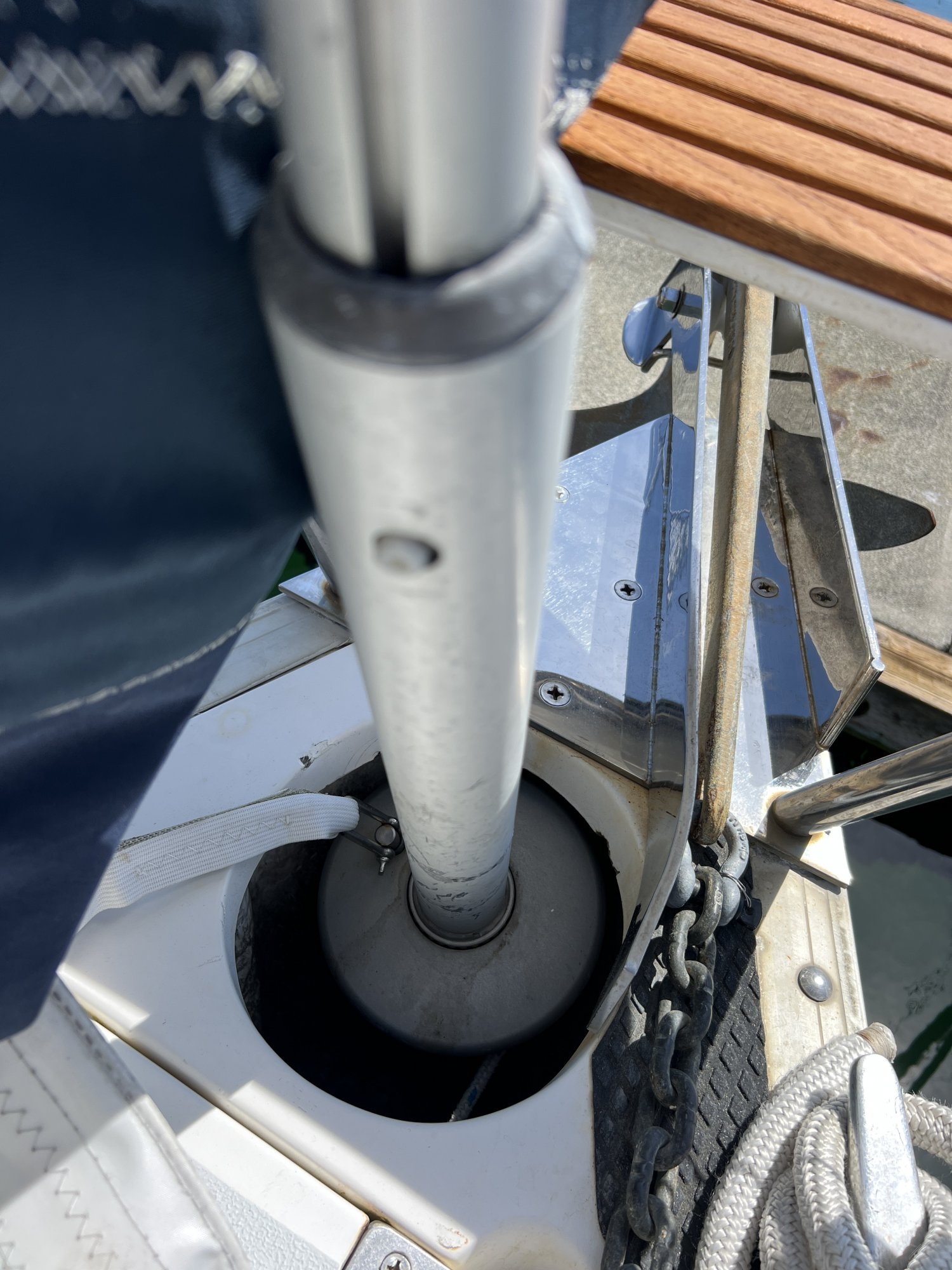

Is there anything I might want to do to give it a tuneup?
Do you have a Hood double line system? If so, the trouble could be the same as what we experienced with ours. See the article I wrote awhile ago that explained what I did to solve the problem.

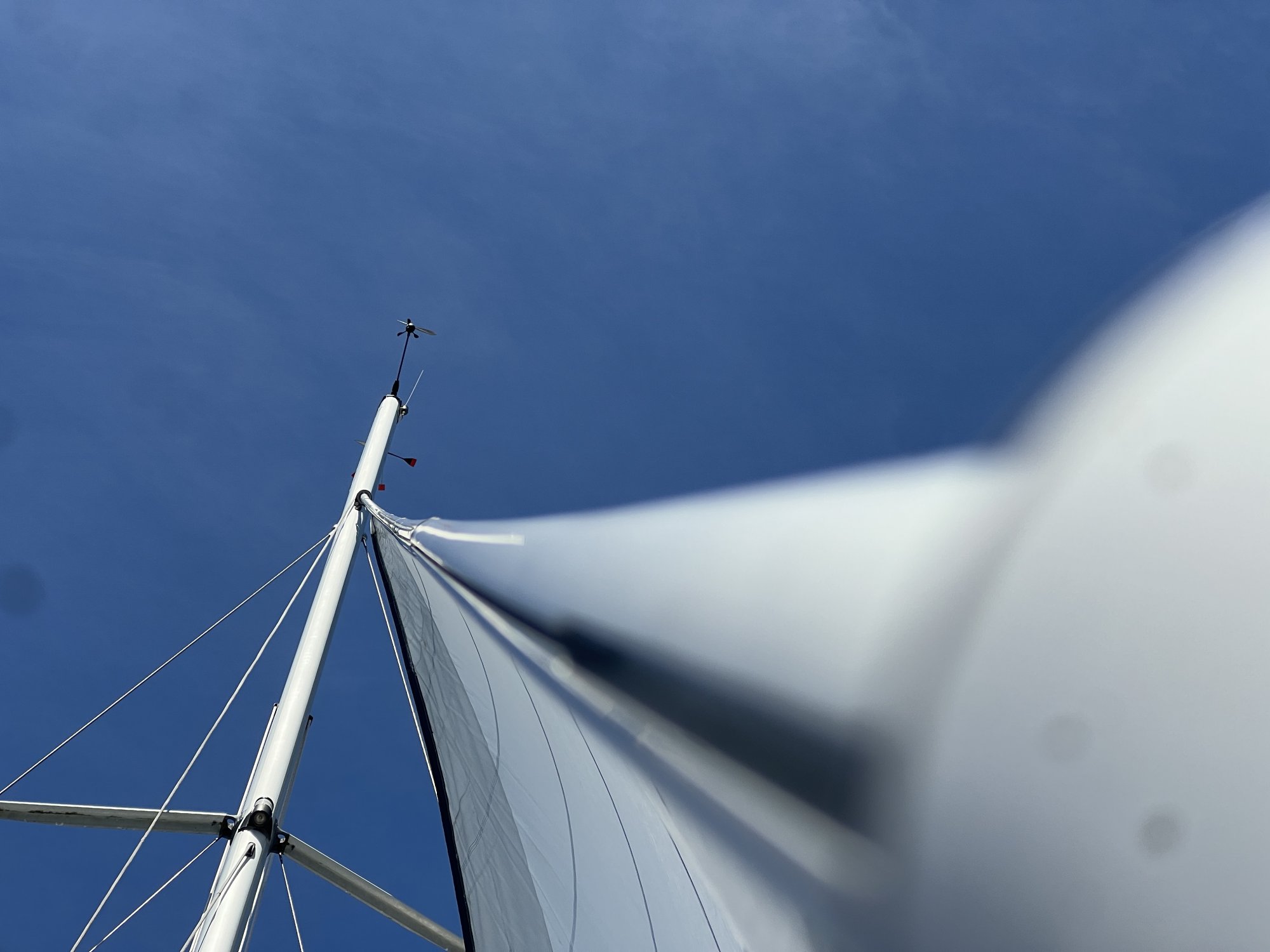

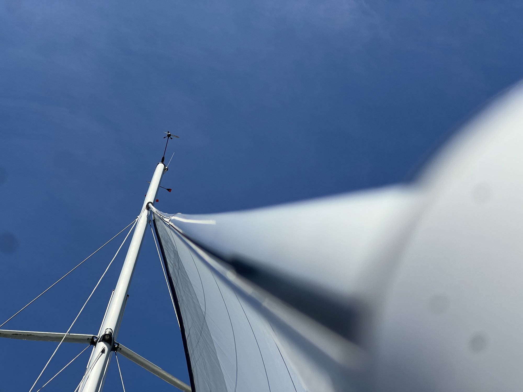

Top swivel is fine. Drum swivel feels kinky every revolution, and again 90° further (call it at 270° and 90°).

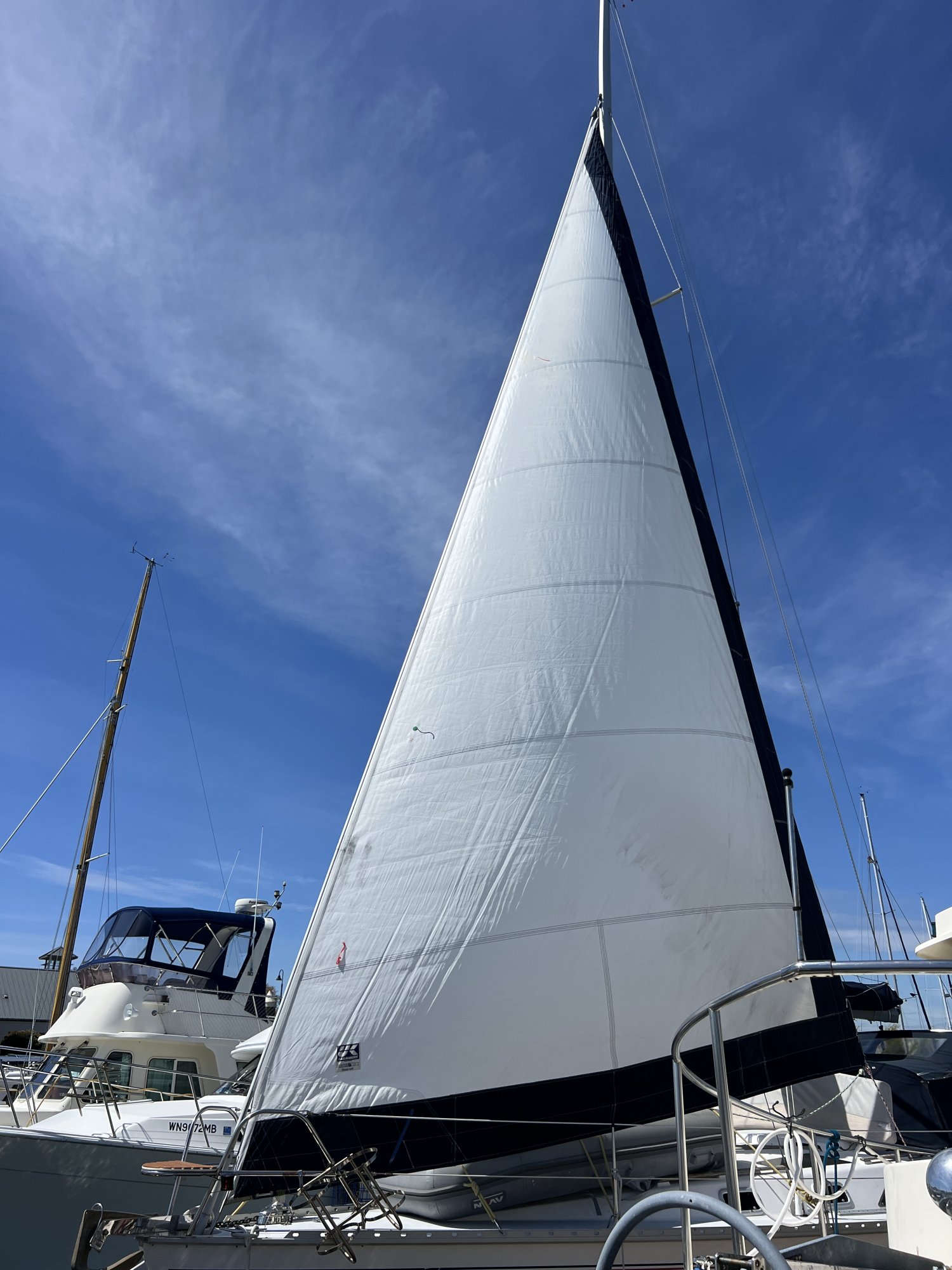

Forestay does seem slightly slack (see picture). I will adjust the tension of the backstay and shrouds per the rigging specs and test the furler again.

The bend or cantanary in the forestay doesn't look too bad, but hard to say from a photograph.
I am not sure but I think 7/8 rigs have a slightly slacker forestay.
Again some one with more knowledge should be along soon.

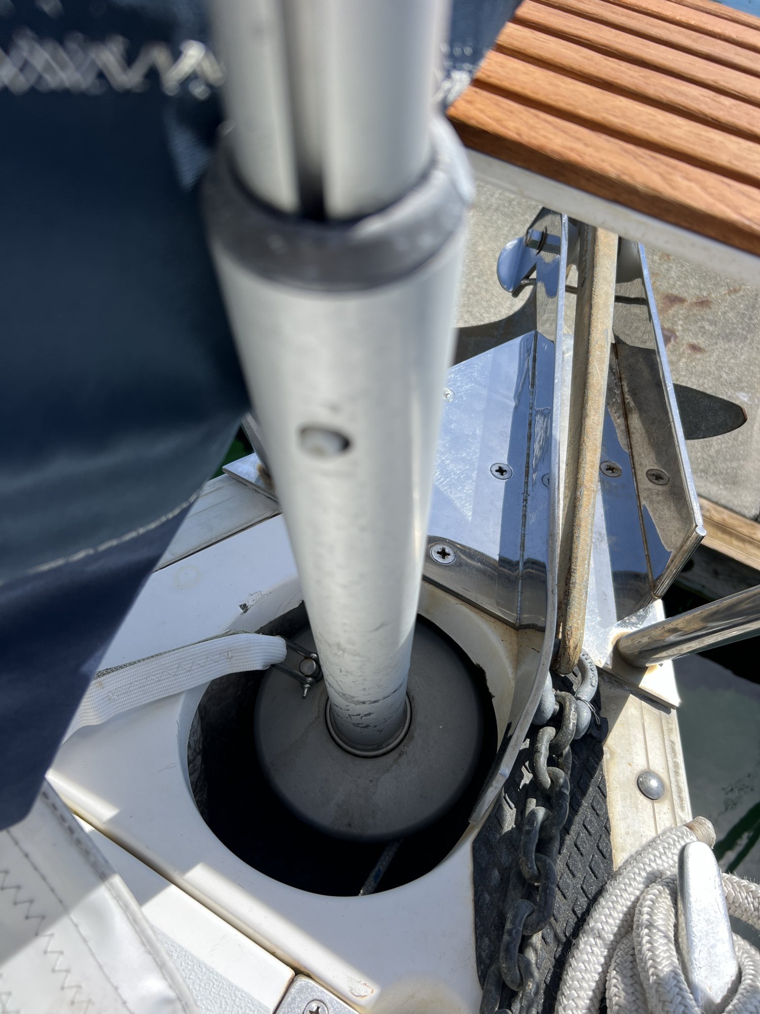

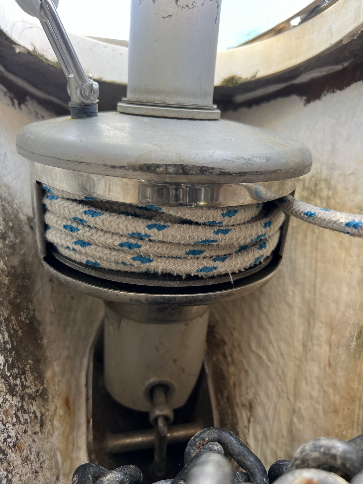

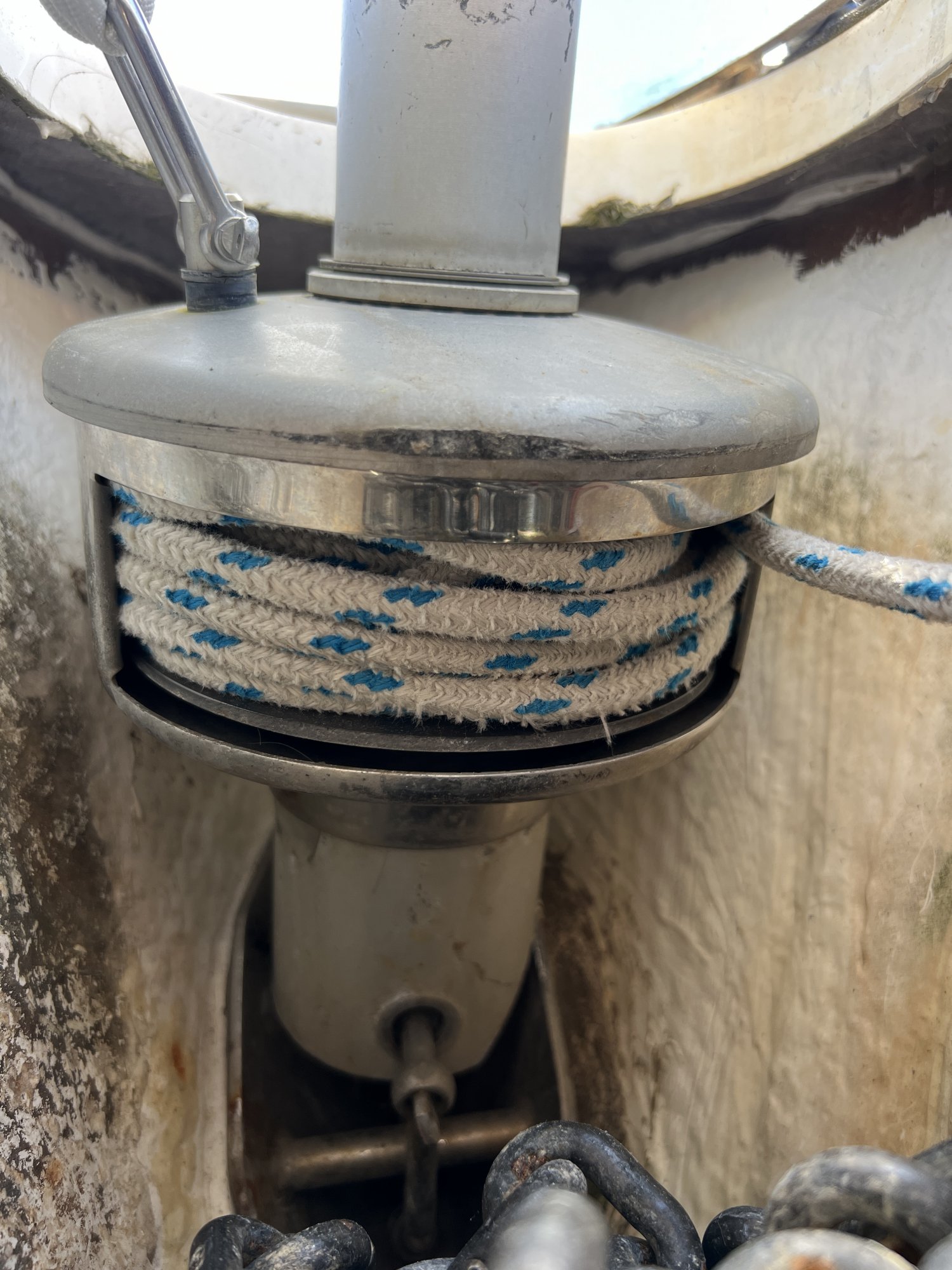

Here are some pix of the drum. I’m unable to find any Identifying markings on it. I believe it’s a Hood Seafurl. It is below deck (as were the Hunters of this vintage).

I think that part of your problem is a loose wrap of the furling line. When you let the sail out, you should hold tension on the furling line so that you get a tight wrap on the drum. If you let that line run free, it will wrap loosely like in your photo and then when you pull on the line, the last wrap slips down into the gap and then the other wraps tighten down on top of it. I have seen this problem completely lock a drum so that it could not be turned in or out even by rotating the foil by hand.
When I let the sail out, I keep at least a 90º hitch on a cleat to create some friction to hold the line in tension and then it wraps up as pretty as cable on a crane's winch drum.
Apr 5, 2009
3,211
Here is a short video of the “sticking” of the furler when turned by hand, sail removed.
If I am seeing this correctly, your torque tube is rotating inside of the drum and that should not happen. There should be either two or four set screws that attach to the drum and fit into holes in the torque tube that make the two turn as one. It would appear that they have broken or backed out.
