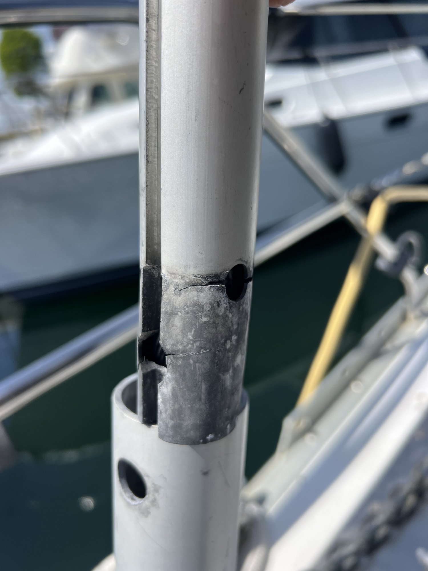

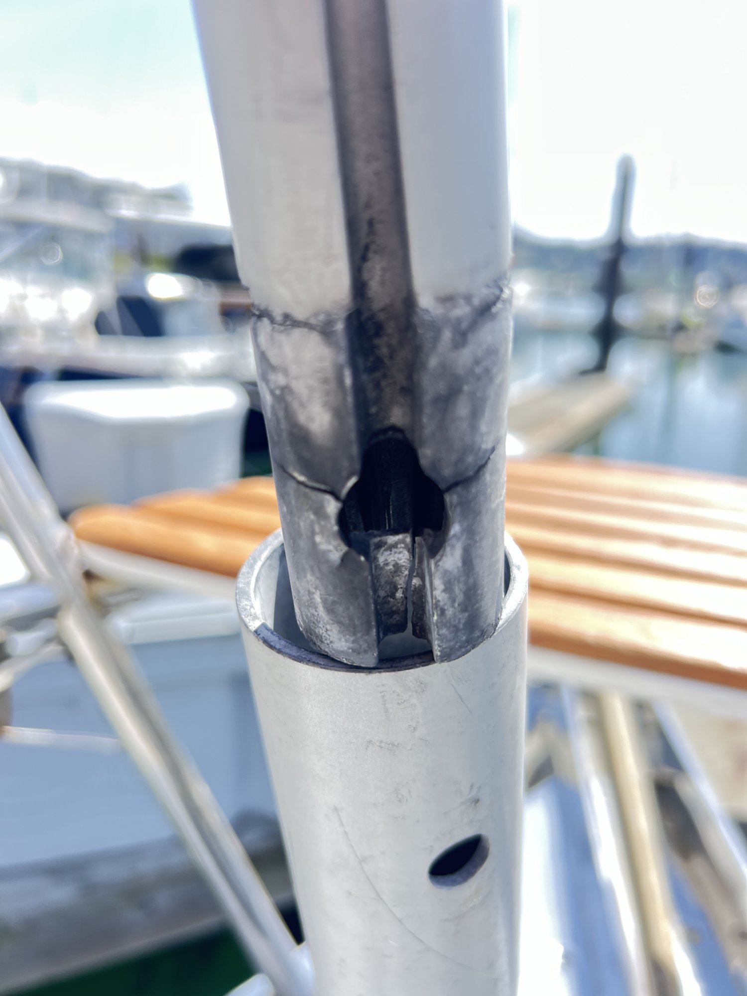

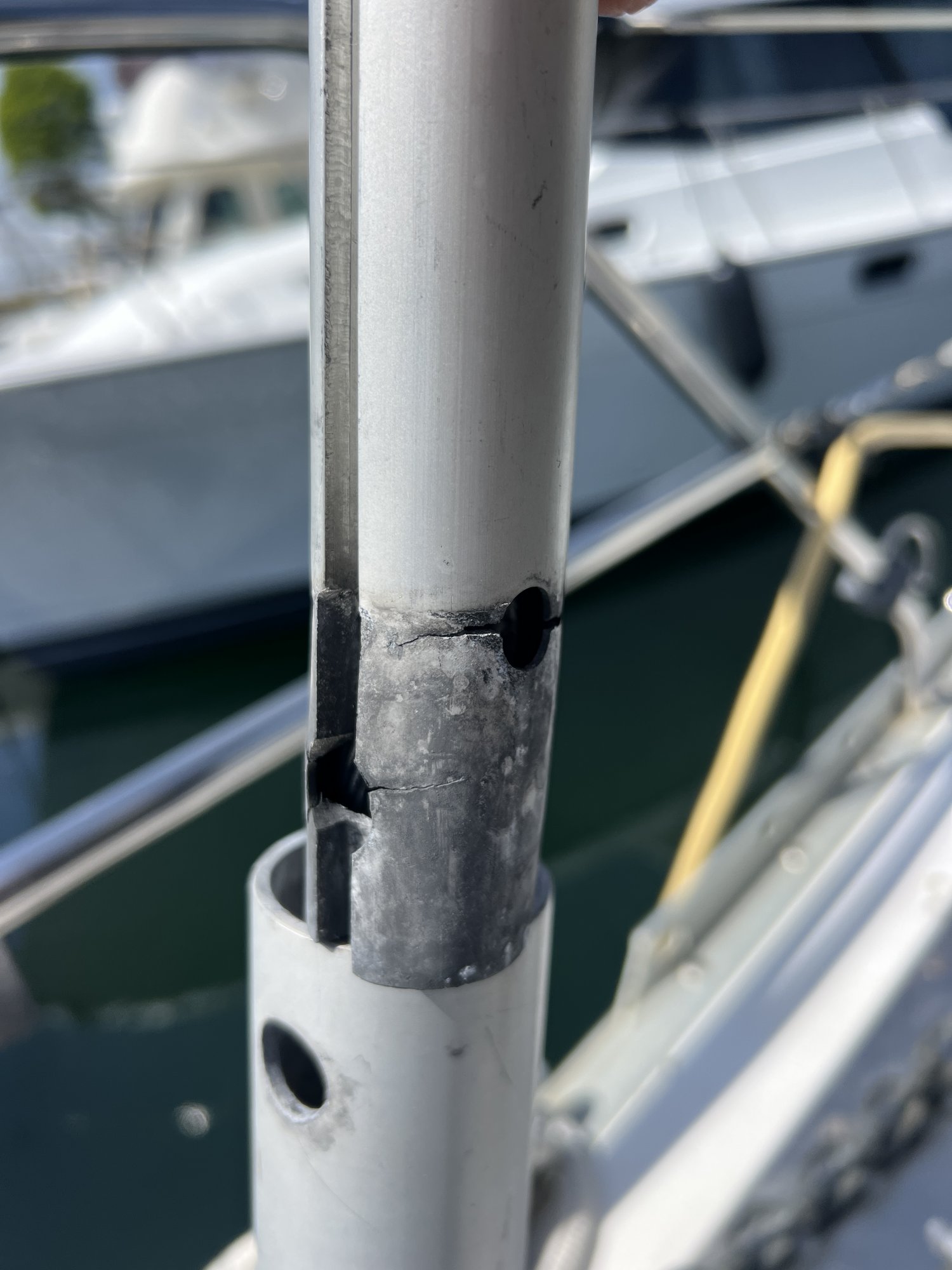

I managed to remove the vinyl screw and pull the tack sockets. The lowest extrusion is cracked where they sit. It does seem a weak point in the design of this system as the turnbuckle tube is centered at the bottom by the centering ring, and at the top it seems to rely on tha lowest extrusion, which is already structurally compromised by the holes drilled into it for the tack sockets and screw (where the crack is).
Regardless, it seems this is what needs fixing. Any input on where I can pick up a lower luff extrusion for a Seafurl 800?

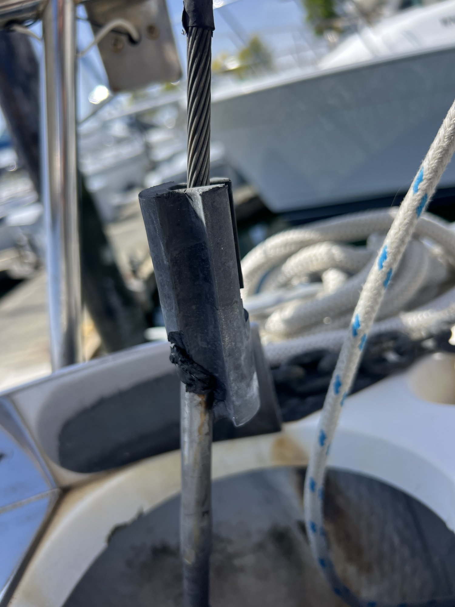

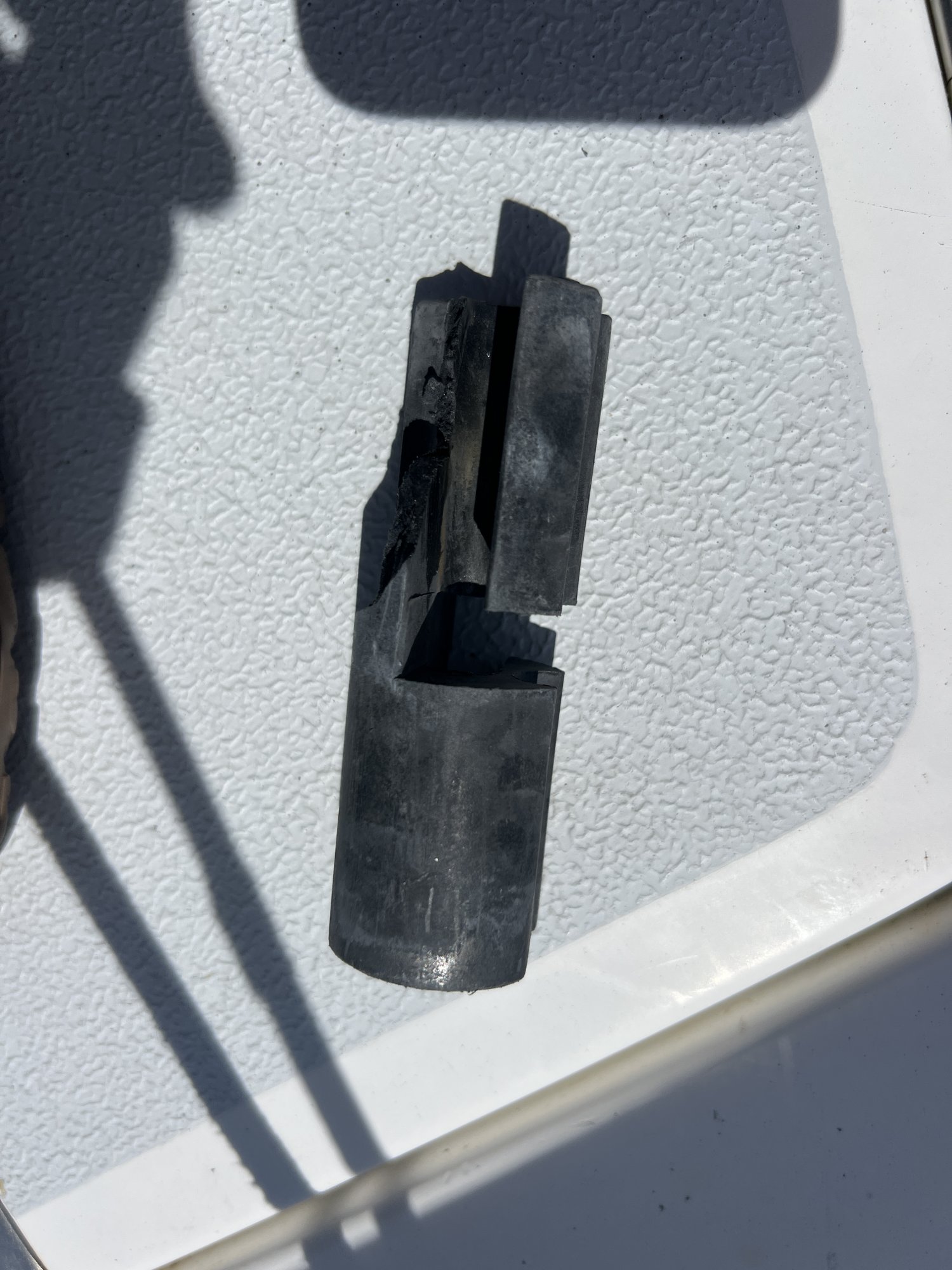

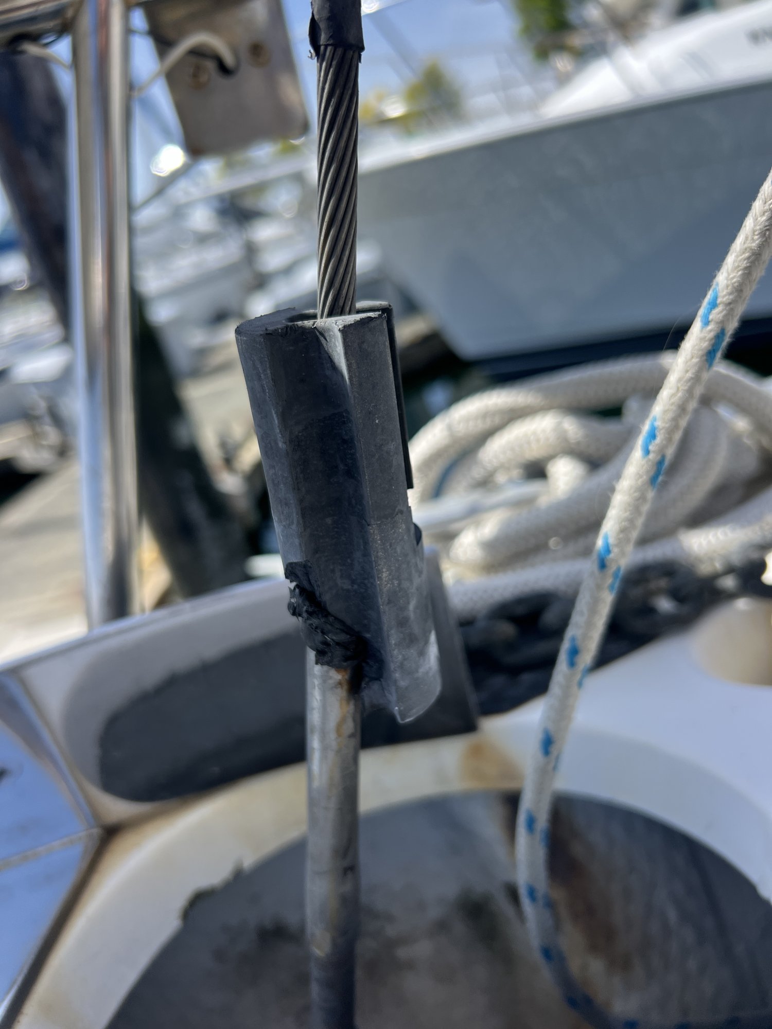

I also found this broken part at the top of the turnbuckle, which doesn’t seem to be in the parts chart.
Is this integral to the operation/safety of the furler?
I had the same type of cracking on my Hood 810. I took it to a welding shop and they tig welded it and I then used a file to clean it back down to flush with the original surface. That was about 20-years ago and that furler is still in use by a guy I sold it to down in Long Beach.
That is one of the luff bearings. There is one on top of each foil joint sitting on top of the splice pieces plus the one that sits on top of the drum assembly that you found. The keep the foil centered on the forestay.

Fits in there like a charm. Seems maybe it wasn’t installed properly and that may be why the whole thing was shifting. Now I’m wondering if there’s a way to get these fused decapitated nylon screws out of the drum gate so I can secure it properly to the drum and stop the chaff that’s happening.

Actually, now that I am reassembling, I’m noticing there is nothing actually securing that final luff bearing in the lowest extrusion. It probably just slipped out at some point and ended up in the turnbuckle tube, bucking the whole furler each revolution.

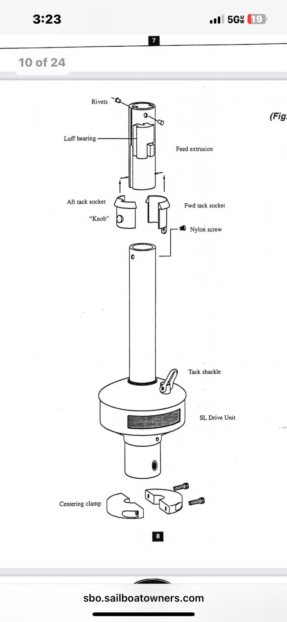

How do I make that luff bearing stay where its home is? I see what look like rivet holes, but how do those accomplish the task? Obviously I can’t put anything all the way through as the forestay is in the way.
The documentation (see pic) shows rivets going into the extrusion apparently ABOVE the luff bearing, which would do nothing to keep it from falling down into the turnbuckle tube as before.
Any thoughts?

There doesn’t seem to be any retaining mechanism. Should I just squeeze some 3M 4000UV in there?
When I pulled my current one apart I found that someone had put silicone on the extrusion connectors. It was a pain to get apart so if you do go this route, use a sealant with a weak adhesive property. Pompanette probably has a dwindling stock of these "bearings". It seems like it would be easy to 3D print these

Not the ball bearing race. It’s a plastic sleeve that fits in the extrusions and keep them centered on the forestay.
