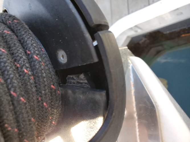

This probably does not adversely affect most furlers BUT, if you have a Harkin Mk IV, not having at least 6 extra turns will lead to a broken drum as I found out a couple of years ago. The Mk IV is unique in that it has a removable drum. The drum halves are held together with a couple of tiny screws into plastic tabs in the opposing part. They are not meant to hold any load and are mostly for alignment purposes. The drum is actually clamped into place buy the tension on the minimum 6-turns of line on the furler which tightly clamps the halves together and onto the big hex shape on the bearings.
I had mine setup so that I pulled the furling line until it was all off the drum and that gave me my desired 3-turns of sheets on the rolled sail. The failure almost cost me half of my two-week vacation. When that little tab broke, it jambed the drum to the cage and made it inpossible to turn the foil. I called Harkin to ask why the drum broke on my new Harkin Mk IV and to see about getting a replacement under warentee. The first thing they said was "You did not have a minimum of 6-wraps on the drum, did you." and was informed that this was a user error and not covered as clearly stated several places in the manual. Who reads those?!?! :facepalm:
I got lucky and a rigger in one of my ports of call, had that exact furler for is boat show demonstrating setup and sold it to me because he had time to get a replacement before the next boat show.

In Harkin's defence, they did have several warnings about the need for 6-wraps minimum. I just did not read the instructions. Once you look at it, this makes complete seinse. This is on their unique furler with a removable drum so that racers can convert it from a furler to a twin track foil on race days but have the drum on for cruising. The drum would need to be much heavier to be strong enough to do all the work needed for furling if that hooping force from the 6-wrap minimum was not there and that would defeat the purpose of the light racing setup.
To say that requiring 6-wraps minimum does not reflect well on Harkin is like saying that it does not reflect well on Honda to require me to keep clean 0-W20 motor oil in my engine. It is a design requirement, and it is well noted. It is not their fault that I did not read and heed the warnings.

One thing that often causes hard furling and unfurling is a bad wrap on the drum. Do you hold a bit of tension on the furling line as the sail is coming out? If there is a bit of tension and the first lead out from the drum is in the correct place, the line should roll onto the drum in smooth tight wraps that run back and forth across the full width of the drum like on a cranes winch drum. If you release the line with no tension, the line will be loose and sloppy on the drum. This makes the line take up a lot more space on the drum. It also causes loose gaps in the line so that when you go to pull the sail back in, the outermost wrap will slip down between the loose inner wraps and then get trapped in an over-ride. The line should lay flat and tight like on your fishing reel.
