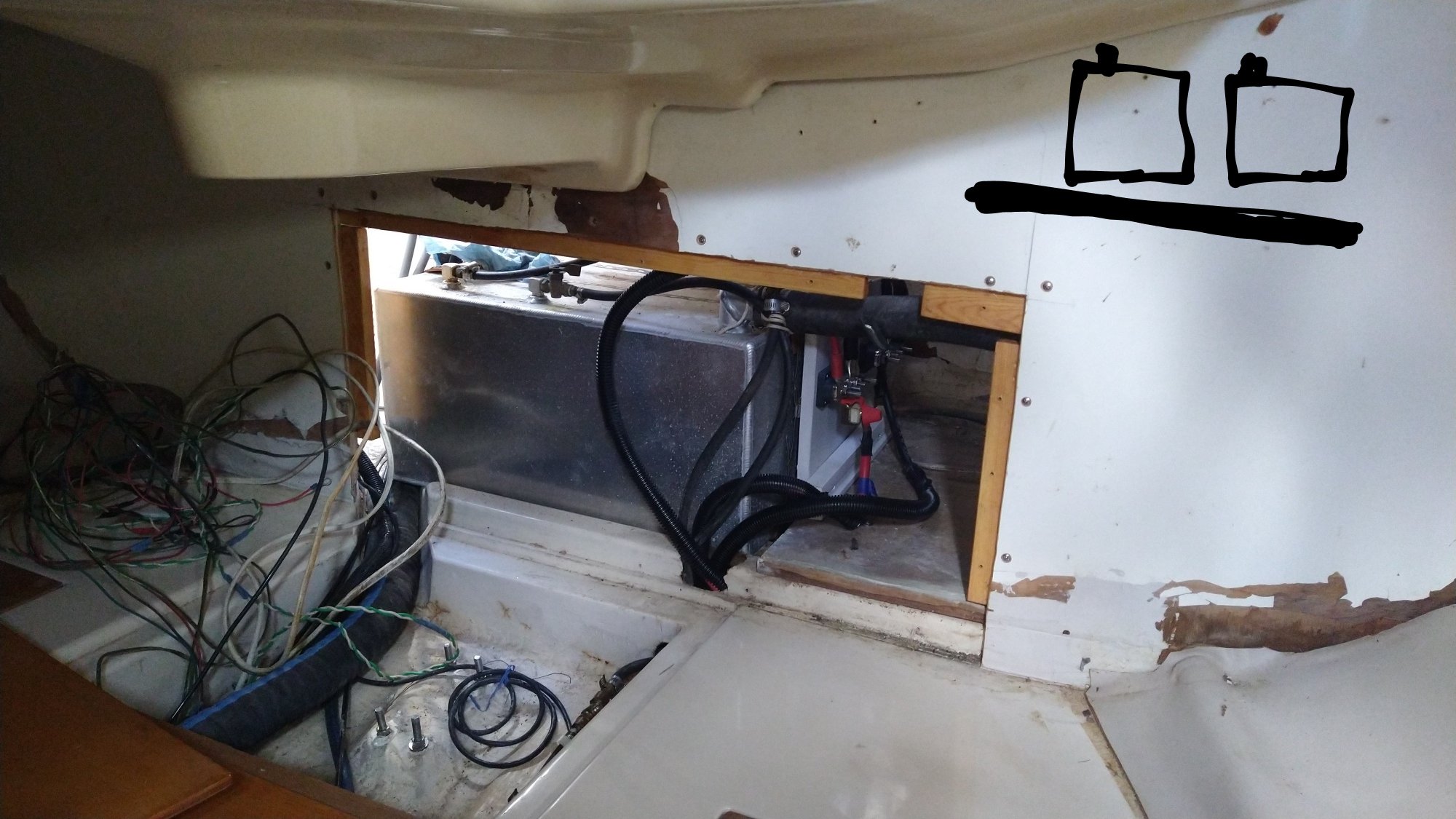

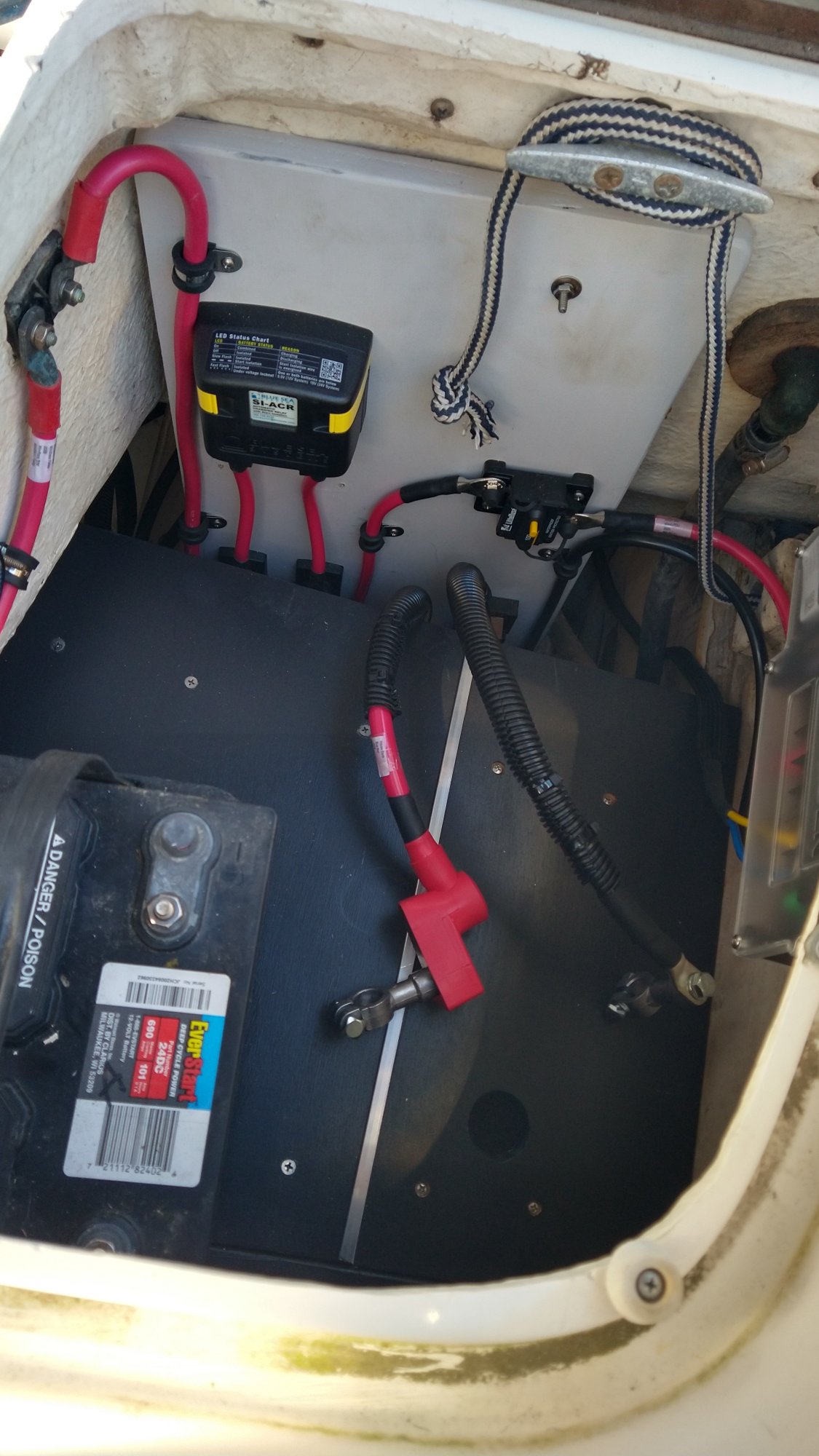

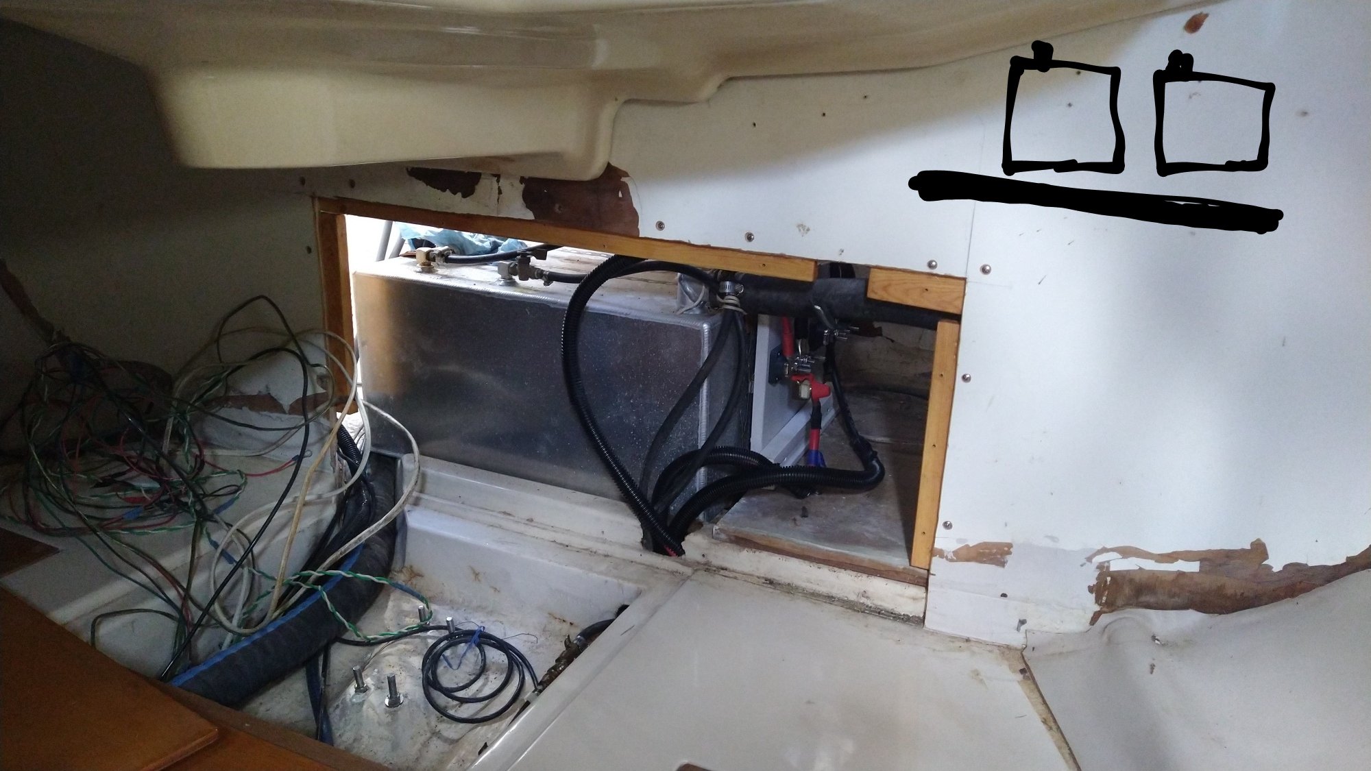

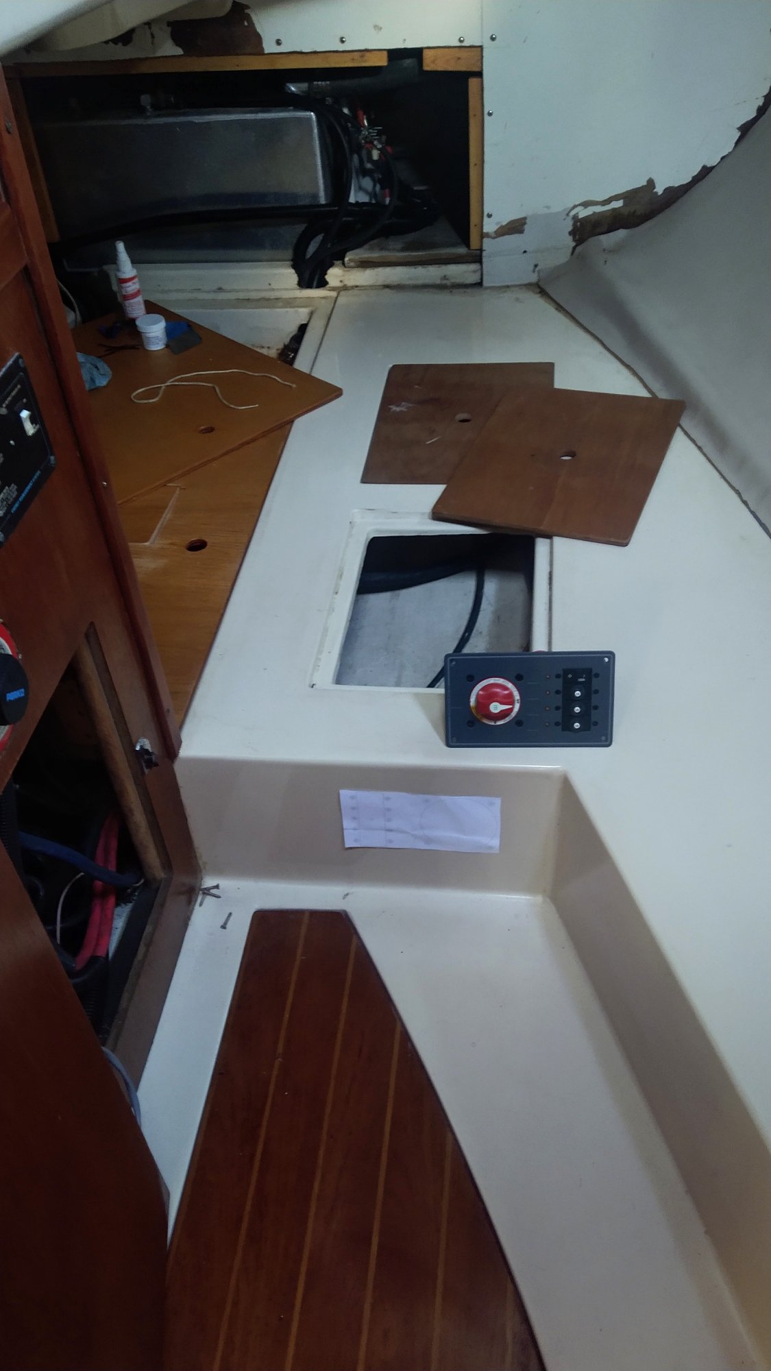

Hi. I'm in the midst of full electrical refit of my '89 Hunter. Am considering installing the new battery management in the place indicated by the paper template in the photo. You can see the original Perko A/B/Both switch on the left edge of the pic.
Moving it low will allow me to free some space in the engine compartment for better distro where I'm adding House bank bus and ground bus. Can anyone point out some reason I haven't considered for why this is a bad location?

I like to keep primary big wire battery systems out of the bilge. Things corrode faster and if you have a water ingress issue into the bilge, you could have problems…IMHO.

I agree Mark. But the factory wire path is already through those storage compartments and, though it's technically bilge-ish, there are no signs of there ever having been water in those compartments. Those compartments are a good 4" higher than the center-line bilge compartments. You can see the engine mount sleeper in the lower left (white under the A/B primary wires). That's a high and clear of the bilge water that's collected under the engine (which is a whole 'nother thing for me to figure out).
The wires in there are continuous with no terminals so no corrosion.
Where are the batteries now relative to your intended position for the battery switch ?
Nov 19, 2023
28
Hunter 32 Vision Watauga Lake, TN
ok, good point. I was weighing the relatively low risk of high water (above cabin sole) against benefit of cleaner installation for distro wiring. This boat may find its way back to sea again (currently on inland lake) so your point is well-taken. One bad day in salt water would be more corrosive than a bad day on the lake.

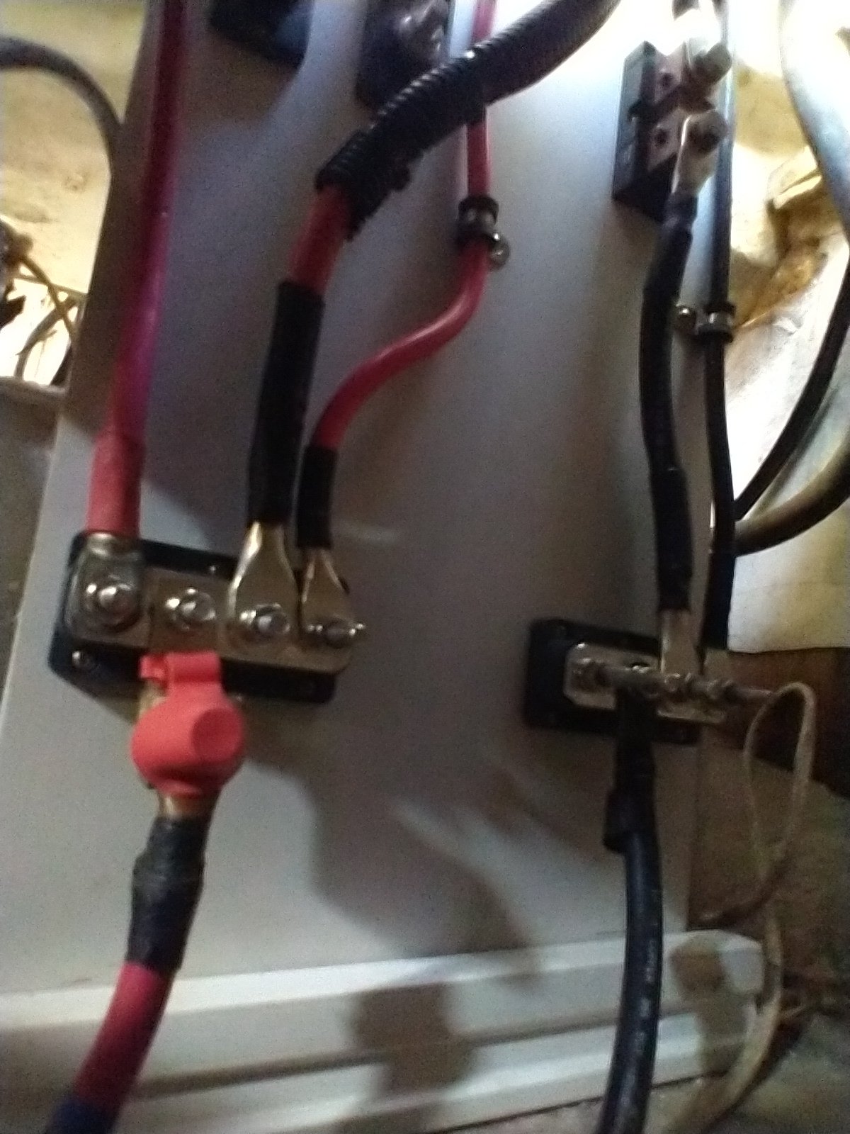

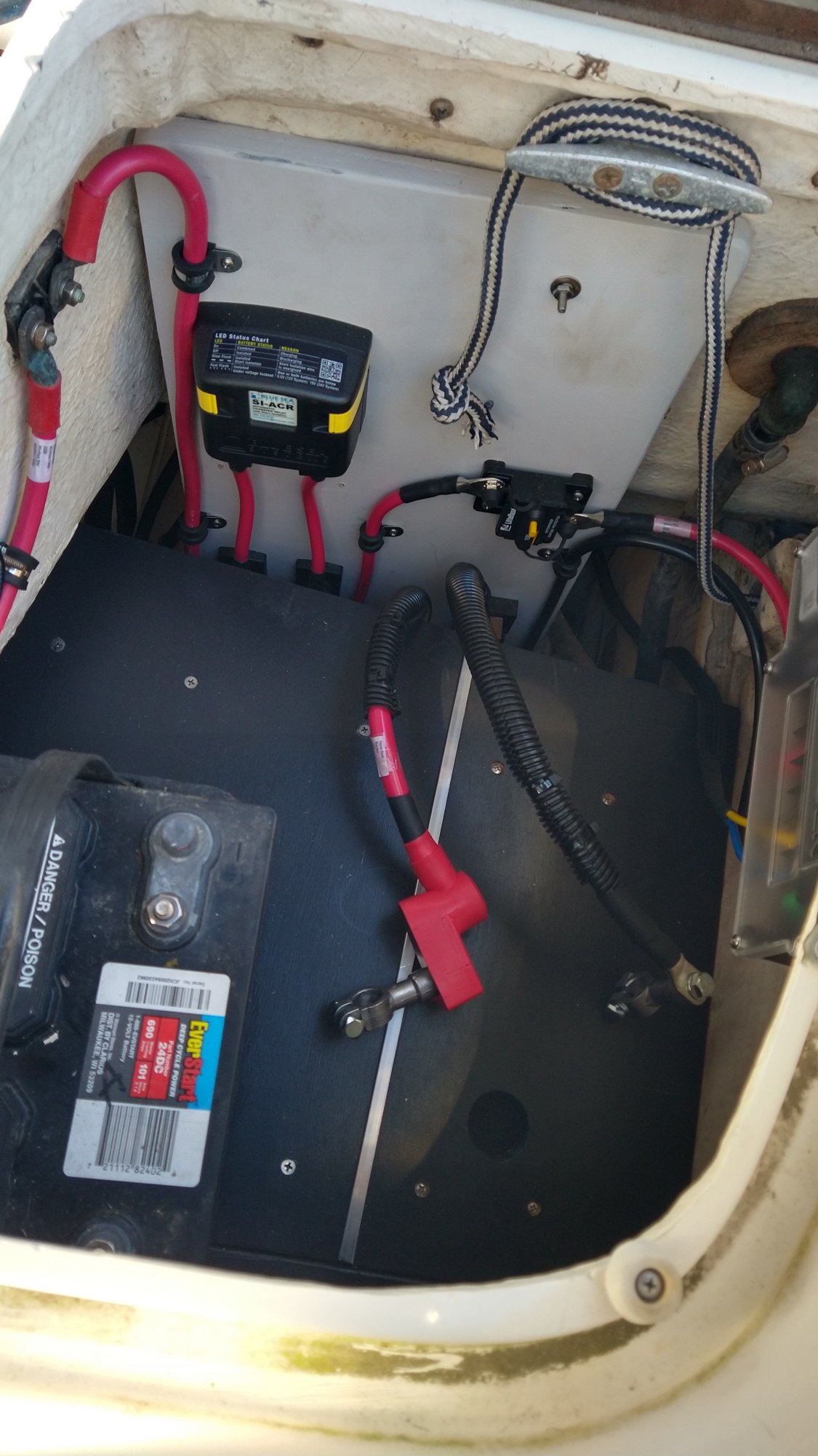

Batteries are behind the bulkhead visible at rear of original pic. Accessible from aft port lazarette.

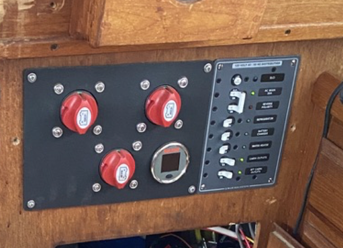

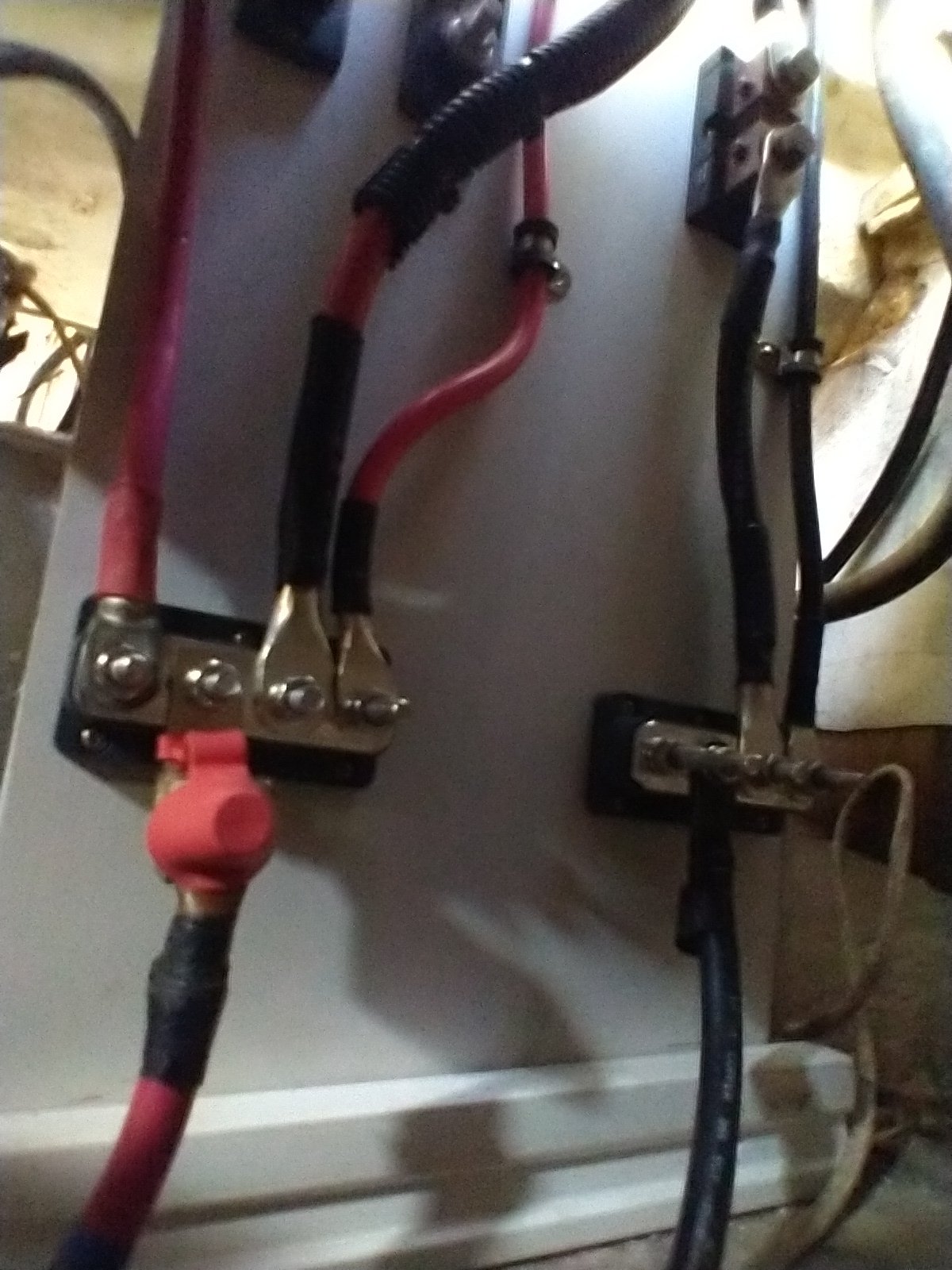

I built a board for primary distro to help manage the tight space. These pics show work in progress.
I'll be back on the boat tomorrow and will look for other/better options for the BMS and a four post distro in/near the engine compartment. A little voice in the back of my head warned me against the location I proposed. I'll take your point as a second and find another way. Thanks!

That location for the switch looks fine to me ... I wouldn't hesitate. Most batteries are located in a position just as low, so what's the difference when the battery terminals are just as low. I see that your batteries seem to be mounted higher in a lazerette but I see no reason why that makes a difference for the switch mounting. (What is the BMS in reference to?) It's good to have the switch mounted close to the batteries. My battery switch is mounted in an absurd location where the cables are stretched across the entire width of the boat. :huh:

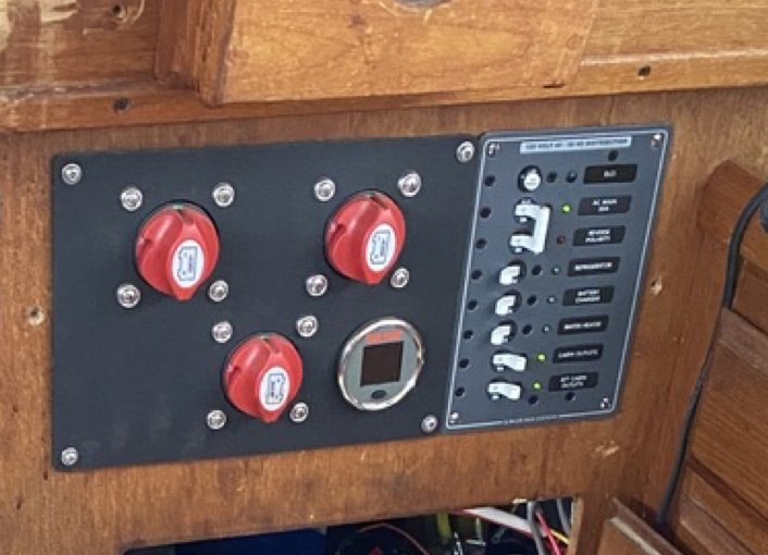

I rebuilt my Primary DC & AC panels with the help of a friend's CNC machine.
The AC panel is a Blue Sea ELCI GFCI Panel AC 5-Position #8101
The DC panel was cut out of a piece of ABS plastic.

BMS - Battery Management Switch; perhaps I landed on that term from my own drawings/documentation. Sorry for being cryptic.
I'm using Blue Sea's Dual Battery Bank Management Panel (8690) to keep Start and House banks completely isolated, with the option to gang them if needed.

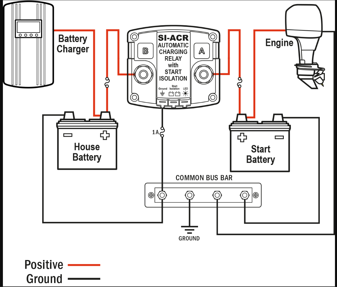

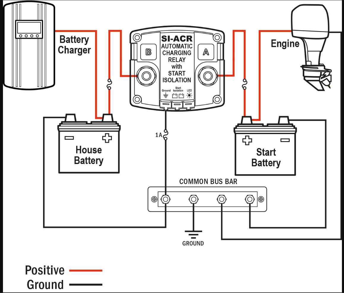

The ACR just uses voltage sensing to open and close relays (likely solid state relays, judging by the size of the device). So, as long as the battery banks are within operational range, the ACR directs current from House-to-Start or Start-to-House. Here's a drawing from Blue Sea that I based my design on:
[EDIT] Note that the ACR also senses whether you're charging or discharging and only combines them when charging. This keeps one bank from draining the other when there's no recharge current coming in.
Likes: LloydB
23,312
Wrong. It should go to the house bank which ALWAYS needs more amps than any start bank.
Plus that diagram doesn't show any switching...whazzup there?
If you'll read both the ACR installation manual and my previous post, you'll see that in fact the purpose of the device is to form a continuity bridge along otherwise isolated and parallel paths. Blue Sea calls them the A and B sides of this device. They are interchangeable. In my installation, the House is on A and Start is B.
So, in my case: If the charge current is coming from the alternator, it stays on the B side and goes to charge the Start battery, regardless of what A is doing. But if while in this state, it senses that the House (A) side is below 13.0v for more than 30 120 seconds, it will close the contact and direct incoming charge current to BOTH House and Start. The inverse is true when I'm in the slip and charging from my Xantrex.

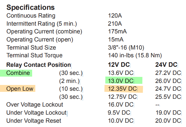

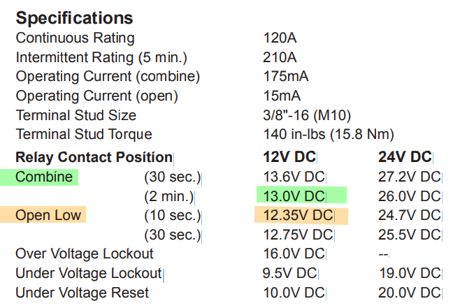

Here's a grab from the manual/datasheet showing the thresholds that apply for 12v and 24v systems. This is what @jssailem heard from Blue Sea.
[Edit] - as for the lack of a battery switch, the diagram is meant to be informational, not functional. That's what the manufacture provides to illustrate one potential use case.

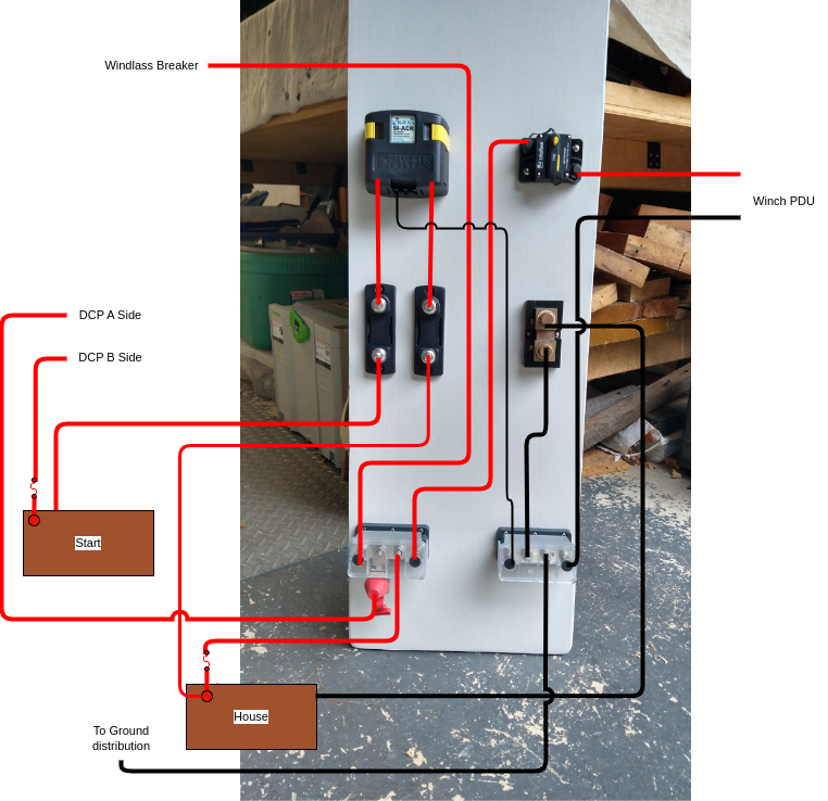

The difference between this new switch and the old one is that the Perko lets me choose either A or B to the single, common output, in addition to sending Both. With the DCP (Dual Circuit Plus) switch, that's not the case. I like your solution to put a disconnect switch for each bank, ahead of the DCP. I'll probably do that.
Until then, I'm happy pop off the positive cable on a bad bank, if it comes to that. One of my goals in this refit was to have clean battery installation with a single cable on each battery post. I'm handling all the primary bussing nearby on a panel I built for that purpose.

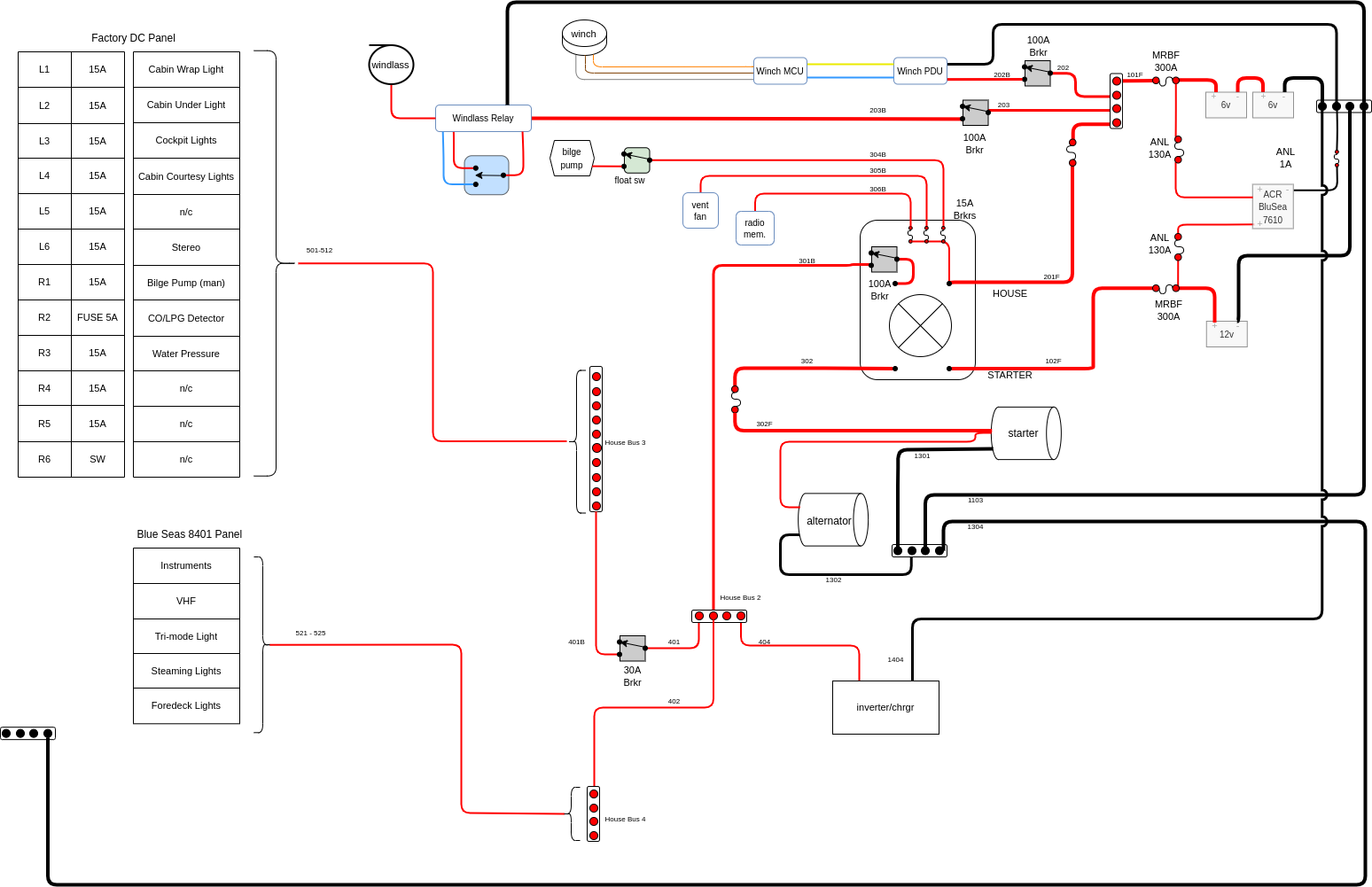

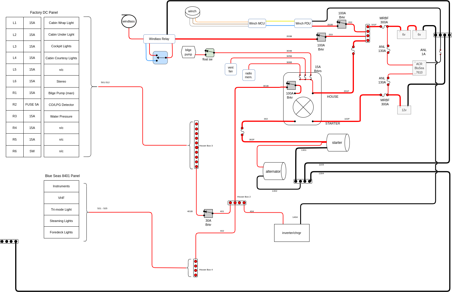

Forgive the slapdash overlay on this pic. I have a proper schematic but this was handy when cutting 1/0 and crimping lugs on the boat. In reality, it's much neater than this. Here's a draft of the overall installation.

If you read Maine Sail's writings, he advises directing the alternator current and all other charging sources to the house bank and relies on the ACR to distribute current to the start battery since the need for charging the start battery is typically very low.
I have based a lot of this design on Maine Sail's writing at Mareinhowto.com. But in this case, I elected to leave existing wiring harness intact - which means the Alternator charge current back feeds down the same path that energizes the starter. To preserve that requires that I keep the Alternator on the Start bank (single Group 24 battery).
My thinking was that the ACR should make the charging seamless for me. I leave the dock with both banks topped up. I will have about 700Ah (usable) in my house bank in the form of 2x 6v golf cart batts. If I'm over-nighting on the hook, and draw down the house, I can always run the engine to to charge it (while I make hot water too). At that point, the Start bank should be very near full, so the House will draw/sink most of the charge current via the ACR.
