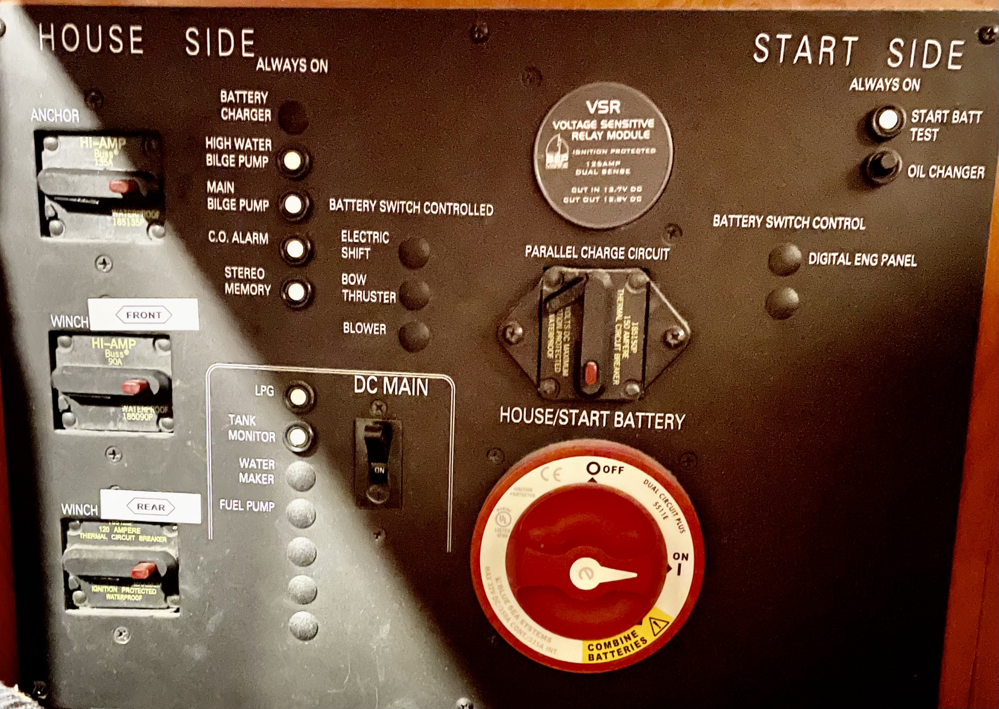

Hi !
Request The forum's advise concerning the operating of the "operating the House/Start battery selector between : "on" and combine batteries meaning: what should be it's position when : 1)on shore power (2 when starting engine. 3) when cruising on engine.4)when cruising on sails.5) when anchoring with no electricity.
Thanks for any help.
*Attached picture

I would trash that switch if, as the label implies, it allows only ‘on or combine’. If you ever depleted whatever is connected to the ‘on’ side, combining them would potentially serve no purpose particularly if it was the ‘start’ battery.
Replacing it would allow independent draw as well as a learning opportunity to figure out how all are wired.

I’m sorry, I completely missed the type of switch and assumed you meant a 1-2-B switch, not a DCP. @Scott T-Bird speaks highly of his DCP and could probably talk about how he uses it. In general I believe what you want is just “on” except you need to combine the banks for some reason, or you have separate shutoffs for each bank allowing the DCP to work as an emergency cross-over.

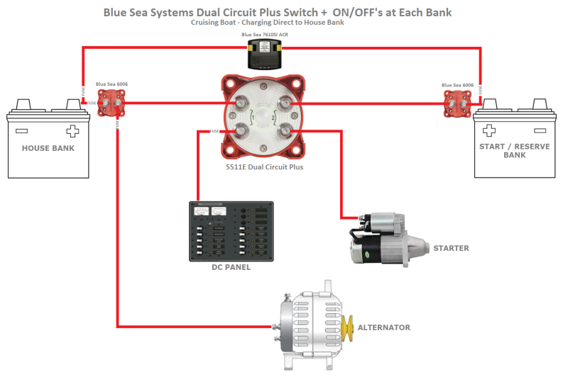

Here's the correct answer:
How to properly wire & switch a DCP switch - Maine Sail's "workaround" explained Replies #28 & 29

Thank you very much everybody. I understand that its better to replace the switch but at this time I can't do that so that's the reason I would like (and still don't understand) to understand the exact way to operate it.

The way to operate it depends on how it is wired. We can’t see that from pictures. For example, some previous owner may have rewired your boat to separate the ‘start’ battery‘ for only engine use independent of the switch which only combines house batteries.
absent more info, no one knows how you should use it.

The one thing you should do since you have a DCP switch is install 2 isolation switches between the batteries and the DCP switch. One isolation switch should be positioned between the House Batt bank and the House post on the DCP. The other isolation switch should be between the Start Batt and the Start post on the DCP. The isolation switches are simple On-Off switches (use Blue Sea just to be consistent). Both should always be "ON", even when you leave the boat. It is best to put them in a compartment out of view so nobody inadvertently turns one or both OFF. The only purpose of these switches is to isolate a battery bank that has a catastrophic failure (such as a short, or it's dead beyond redemption). With a dead battery (bank) in isolation (by turning the appropriate isolation switch OFF), only then do you use the "Combine" position on the DCP to provide juice to both the Start battery and the House Bank simultaneously using a single source live battery or battery bank.
The advantage of the DCP switch is that the Start and House banks are isolated and "ON" simultaneously under all normal circumstances. However, isolation of a failed battery and simultaneous use of House and Start loads is only possible by adding 2 On-Off isolation switches. But, by doing that, you get the best of both functions. You can do the same thing with (2) 1+2+B switches, btw. It's all in the wiring sequence.

You turn it to ON..If you have a dead bank you want to avoid the use of combine unless you have additional switches to isolate the bad bank as below....the additional on-off battery switches are best located In the battery compartment so they cannot be seen by guests. the only time these additionalon-off switches are used in emergency .
