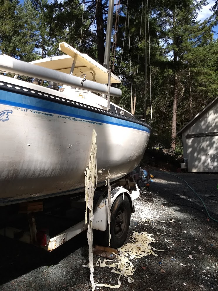

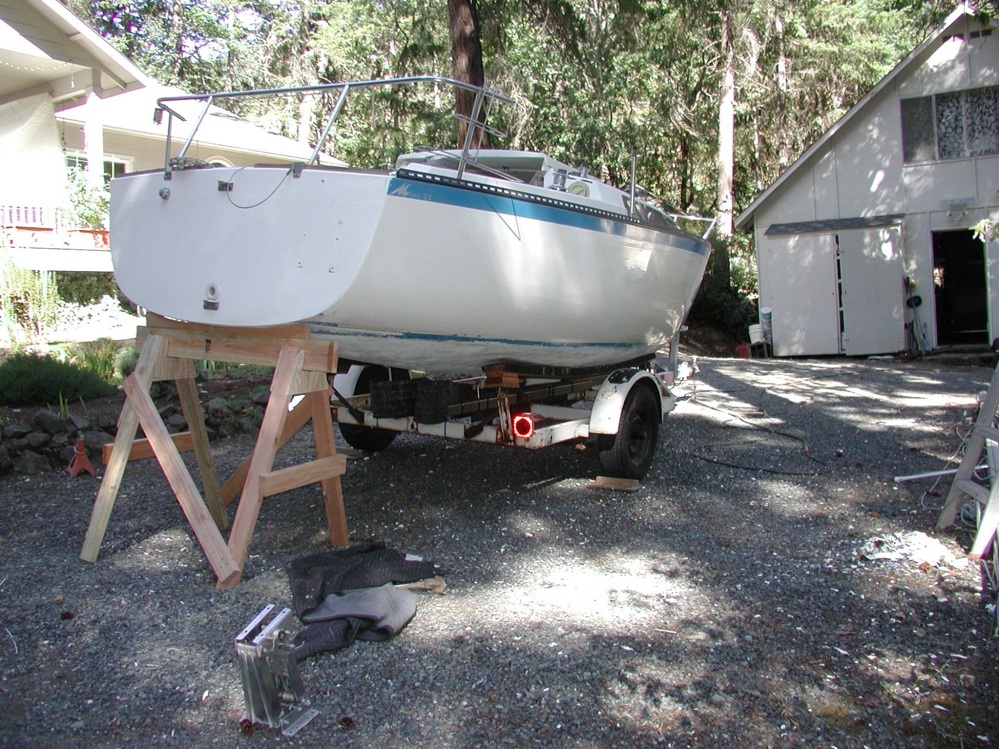

Well that was fun :(. this photo was taken early this morning. by evening the bulk of the paint was on the ground with just some minor sanding and polishing left to do on the hull above the water line. then it comes off the trailer to do below the water line. should be easier as I won't be so picky removing the crud, as that will get painted again anyway. I won't be wanting to do this again :what:

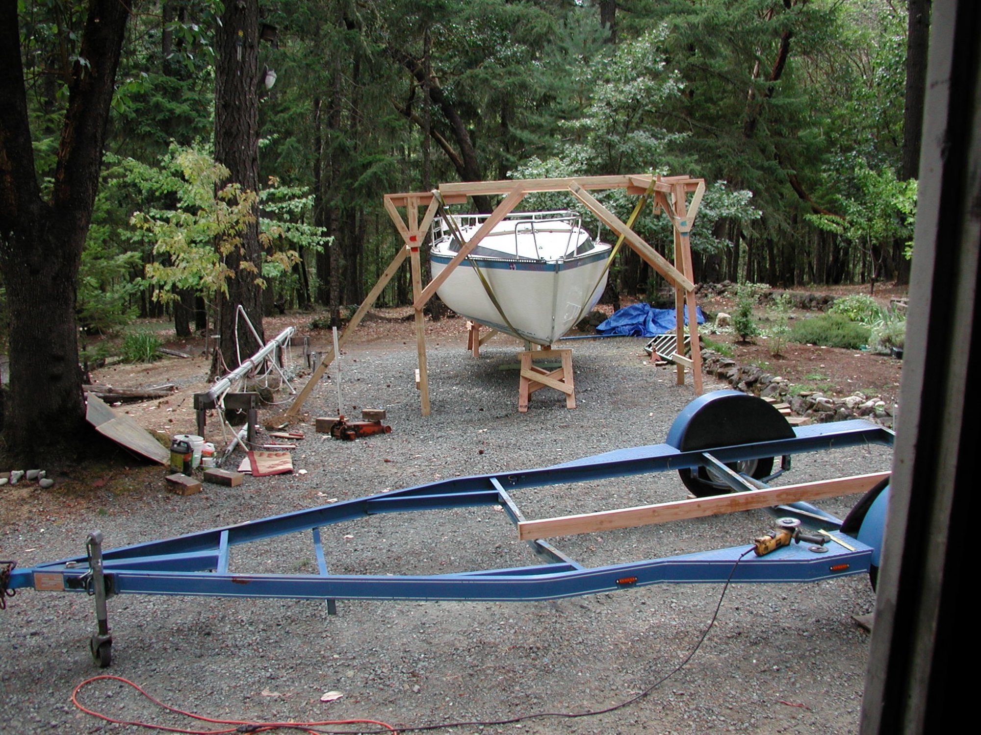

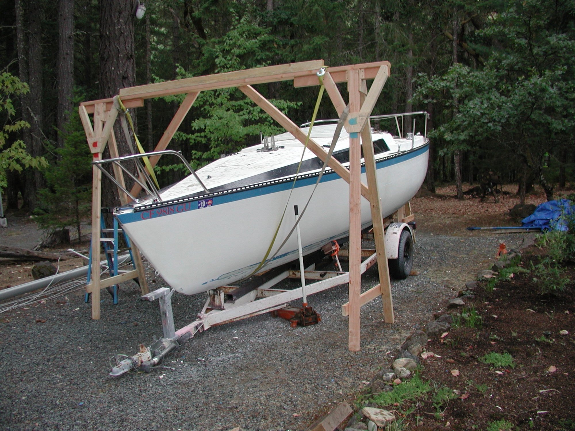

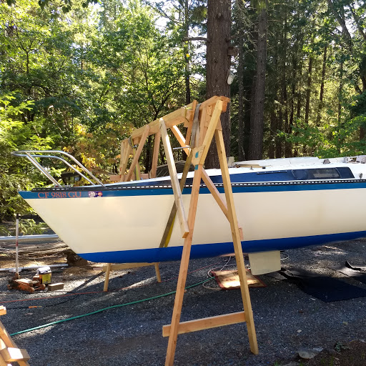

I spent the past couple days building these supports in preparation to lift the boat off the trailer. I'll be stripping off the remaining old bottom coat and repainting below the water line. after that I can begin setting up the replacement trailer. progress is slow, but progressing ;).
All that will have to wait a few days to begin however, as an urgent call has come in to go to the lake (in the Macgregor 25) for what appears it may be our final trip of the season. the lake is dropping 6-8" a day now, and the main ramp will be unusable for us in another week or 10 days :(. We'll be home early next week if the creek don't rise. cheers ! :beer:

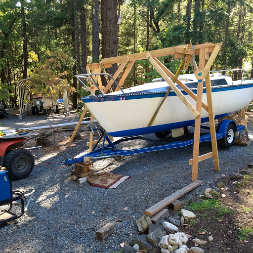

Back from three glorious days on our local lake. what a hoot Saturday sailing our M25 5 Kts on a reach under jib alone. 20-25Kt winds.
But now it's back to "work" on the Merit. got the old trailer out this morning and the replacement stripped down and ready to begin modifications. first time taking a boat off the trailer this way. ummmmmm. very exciting :yikes:,

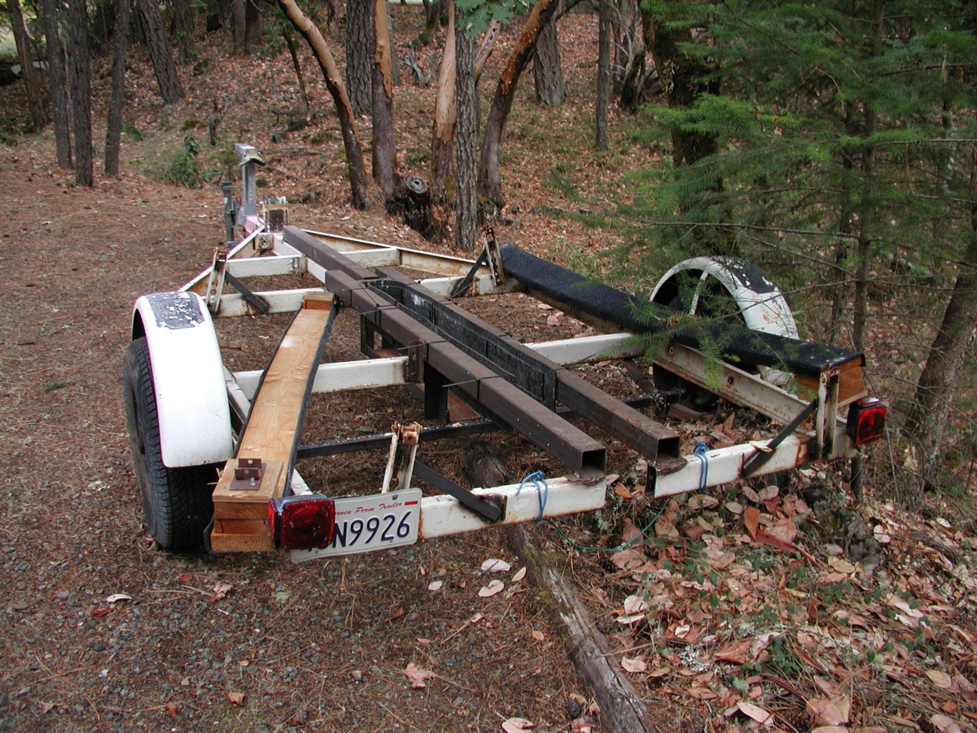

Removed this fine specimen.....
And preparing for it's repacement:
I'll be a lot happier when the bottom is painted and it's back on a solid trailer. :)
I don’t blame you, why not set up some cribbing that you can remove to paint, you may sleep better at night.

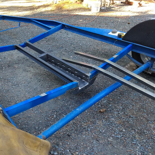

I've gotten the bottom painted at last. sprayed waterborne acrylic pool paint with my airless sprayer. it took way longer to mask it than it did to actually spray, and the finish is nice and even. worked well. for $48.00 a gallon (more than enough material for this boat) I figure it's worth the test :). vinyl 3/4" stripe to be installed over the lower part line at a later date.
Also got a good start on the trailer mods by fabricating and installing the keel support pan. the guide rails will be installed after some measurements with the trailer under the boat.

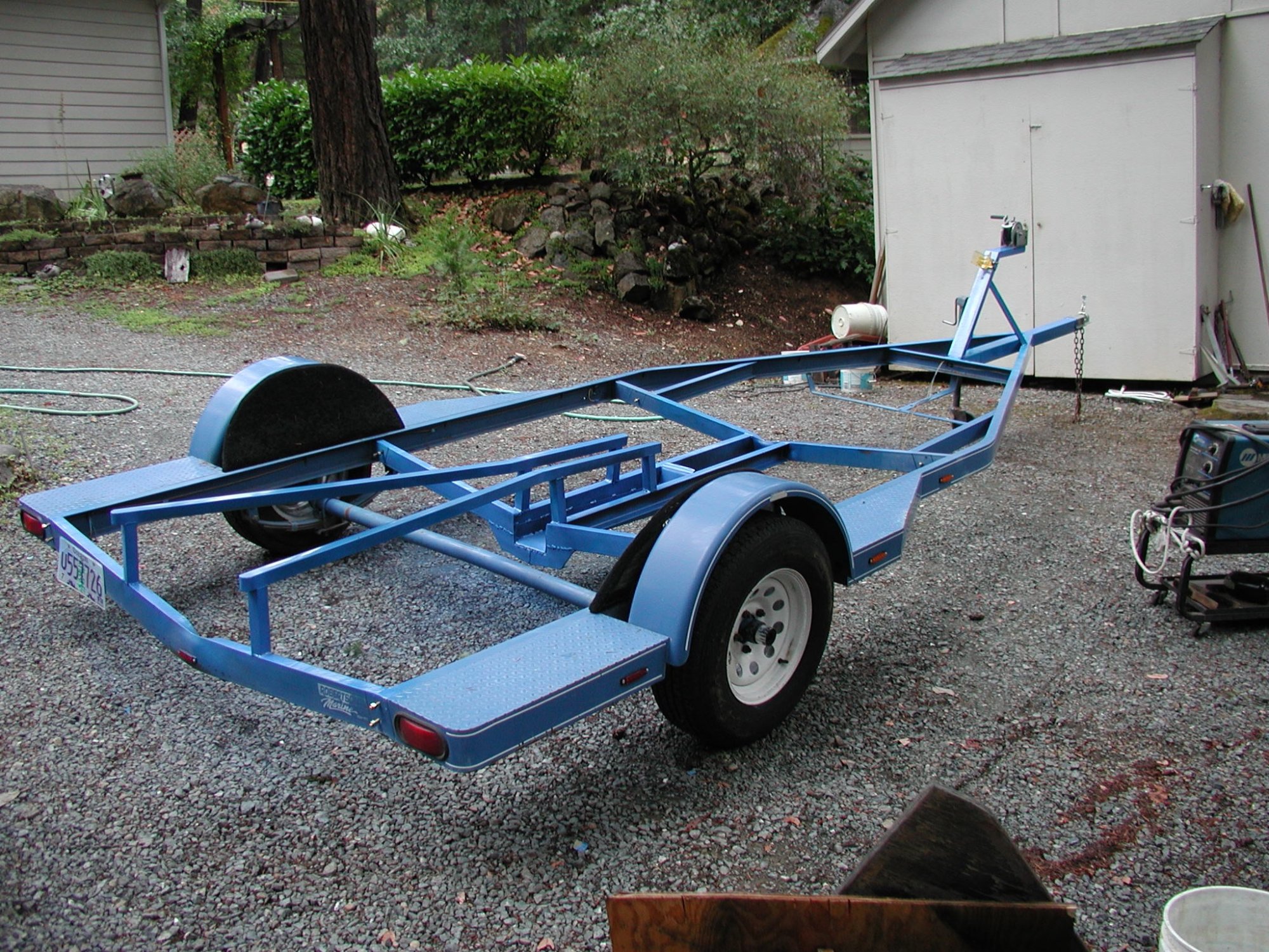

Merit 22- Oregon lakes
We've been having rain showers off and on for a few days so progress has slowed somewhat but still managed to get the trailer reconfigured and painted today. As long as I was at it I also added 18" to the trailer tongue, although it may or may not really need it. when the paint is a bit dryer tomorrow it will go back under the boat and the (already fabricated and ready to install) bunk stands and 10' bunks installed and the boat placed on the finished trailer. Yaaay:).
