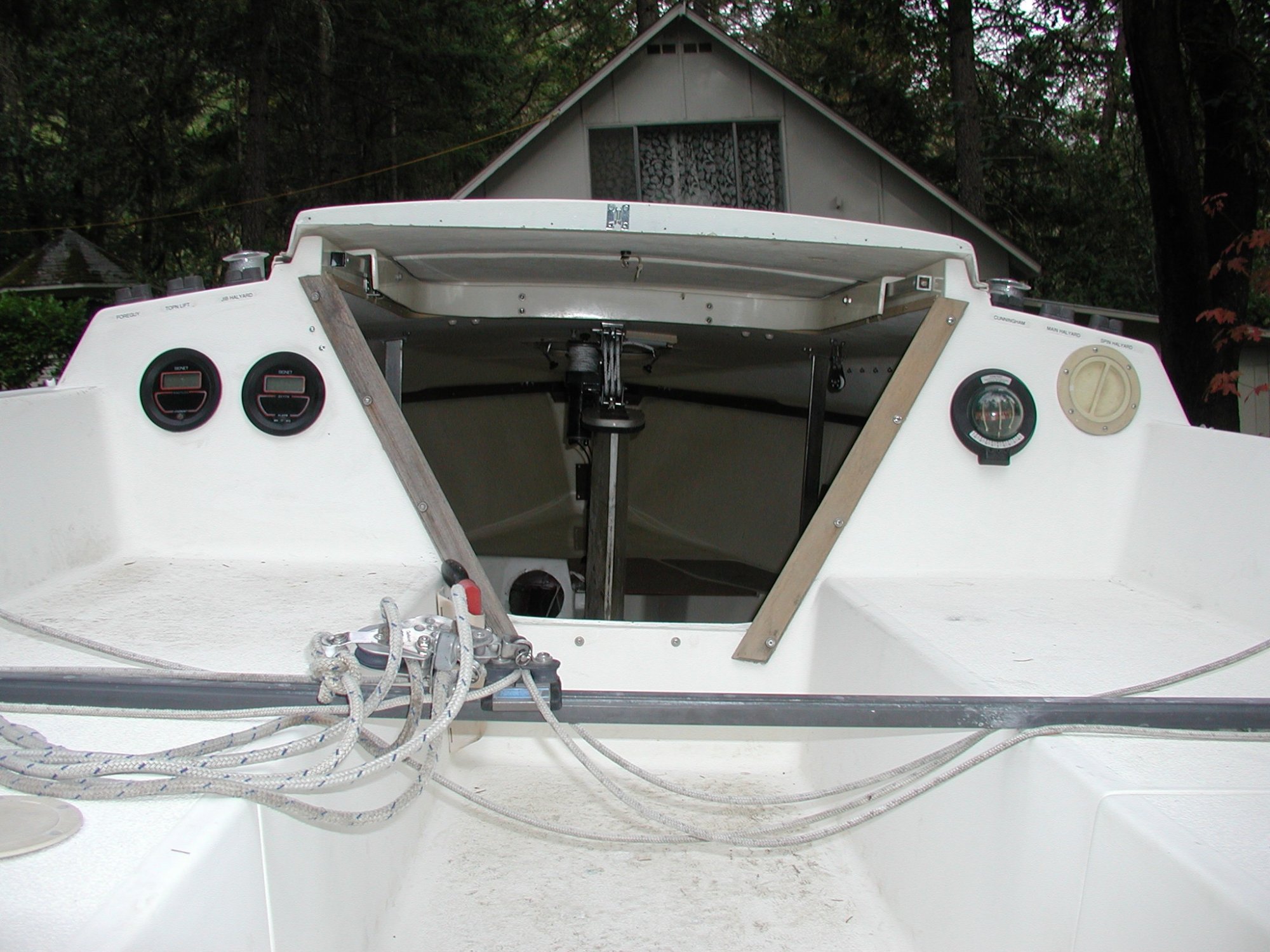

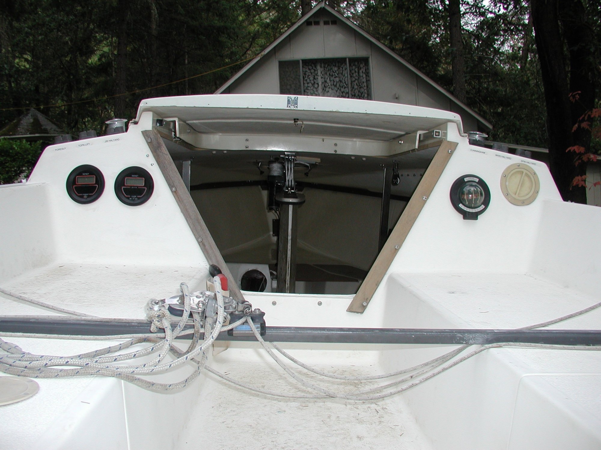

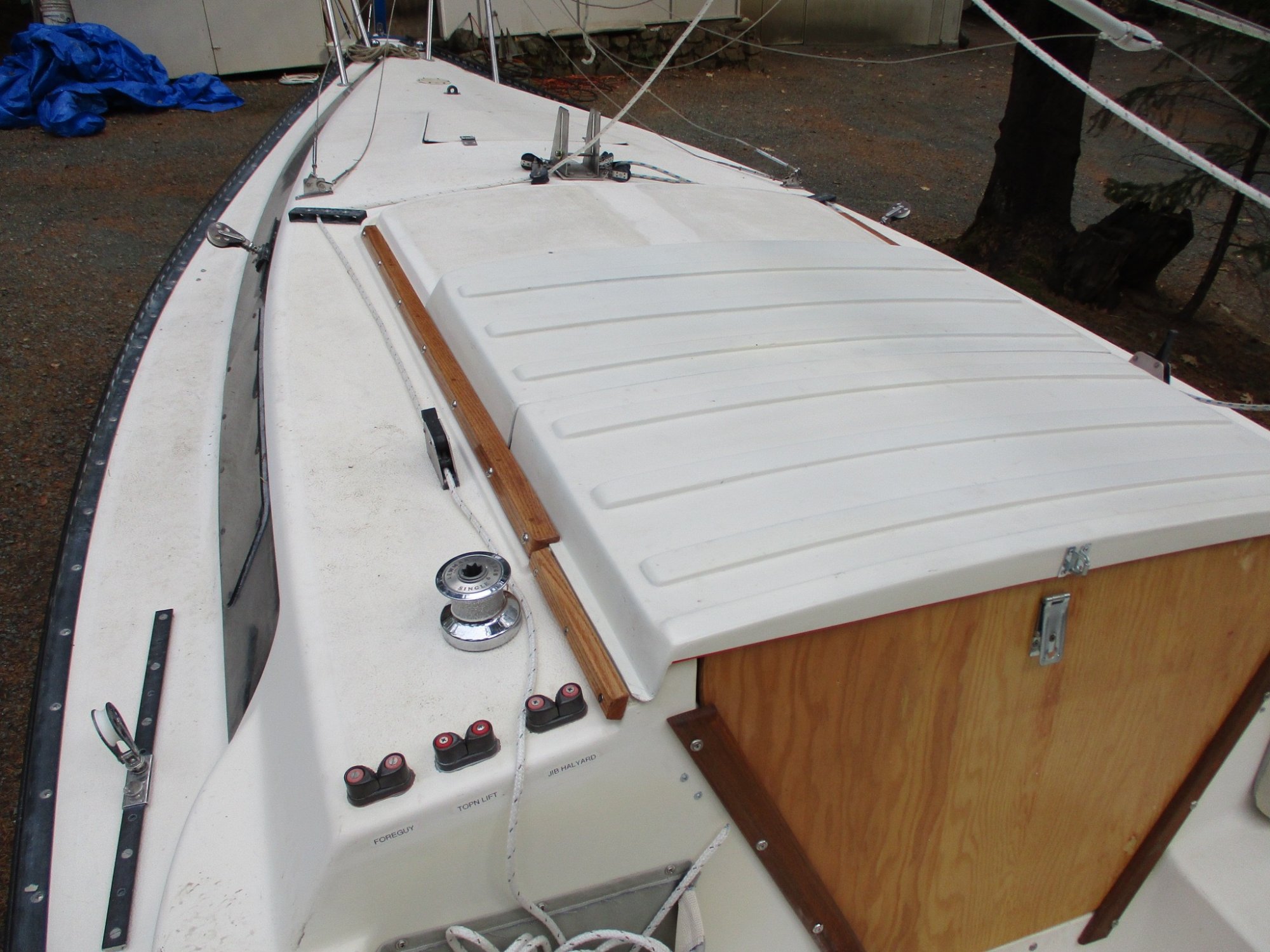

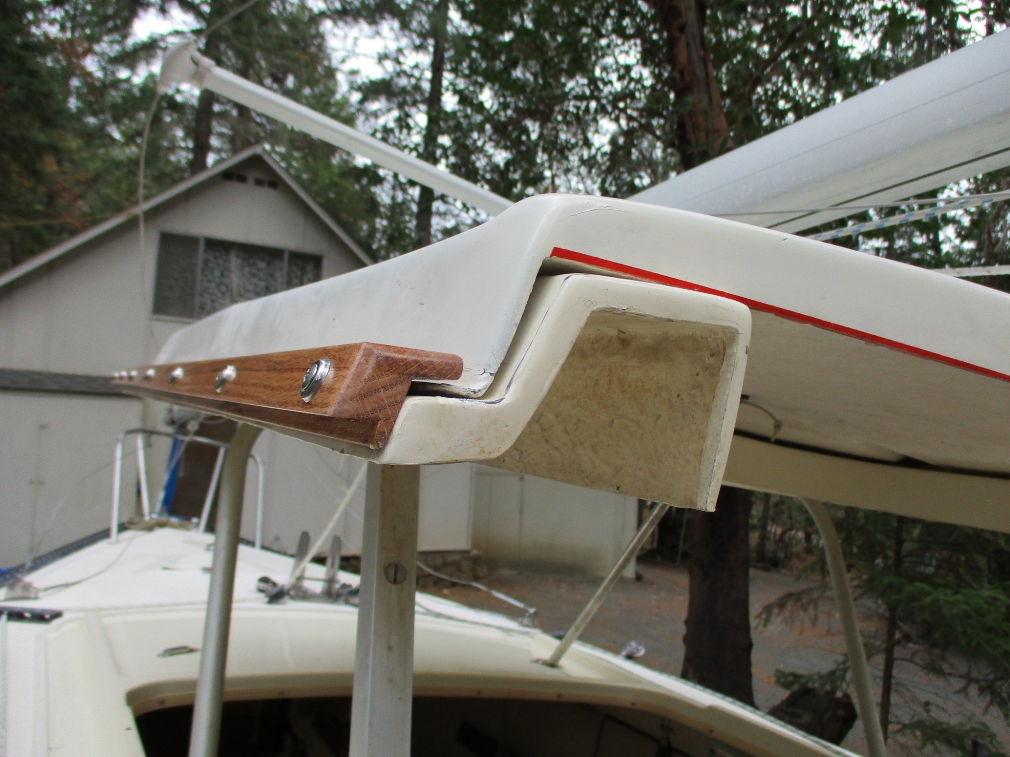

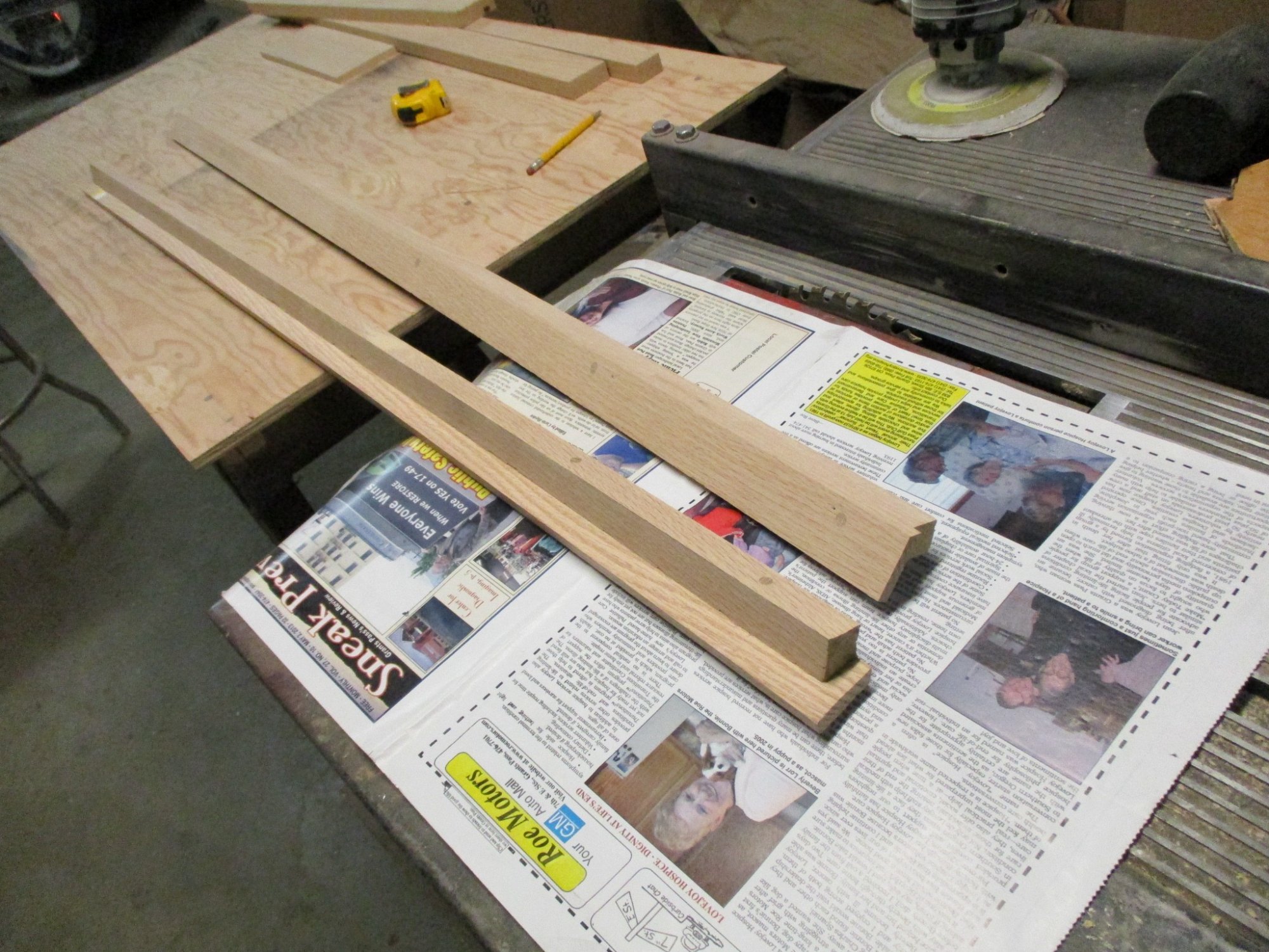

Due to the flimsy plastic hatch runners, IMG_0065.jpg almost every time I raised the pop top the sliding hatch would jump out of it's track :mad:.
Time for a better solution. It was a little tricky working around the various drainage lips etc, but the results have certainly been worth it. new hatch tracks were cut from oak, stained and sprayed with Polyurethane.
The hatch doesn't jump it's track when the pop top is raised now, but it also didn't make the assembly any lighter weight either :doh:. I calculate 48 pounds >< so the next project will involve installing gas struts. I did that on our Macgregor and my bad back loves that one. even Jennifer can easily raise the Mac hatch with her 98 pounds of pure muscle ;). The Merit looks to be a bit harder challenge to fit them in there, but the effort would be worth it, if successful. stay tuned...

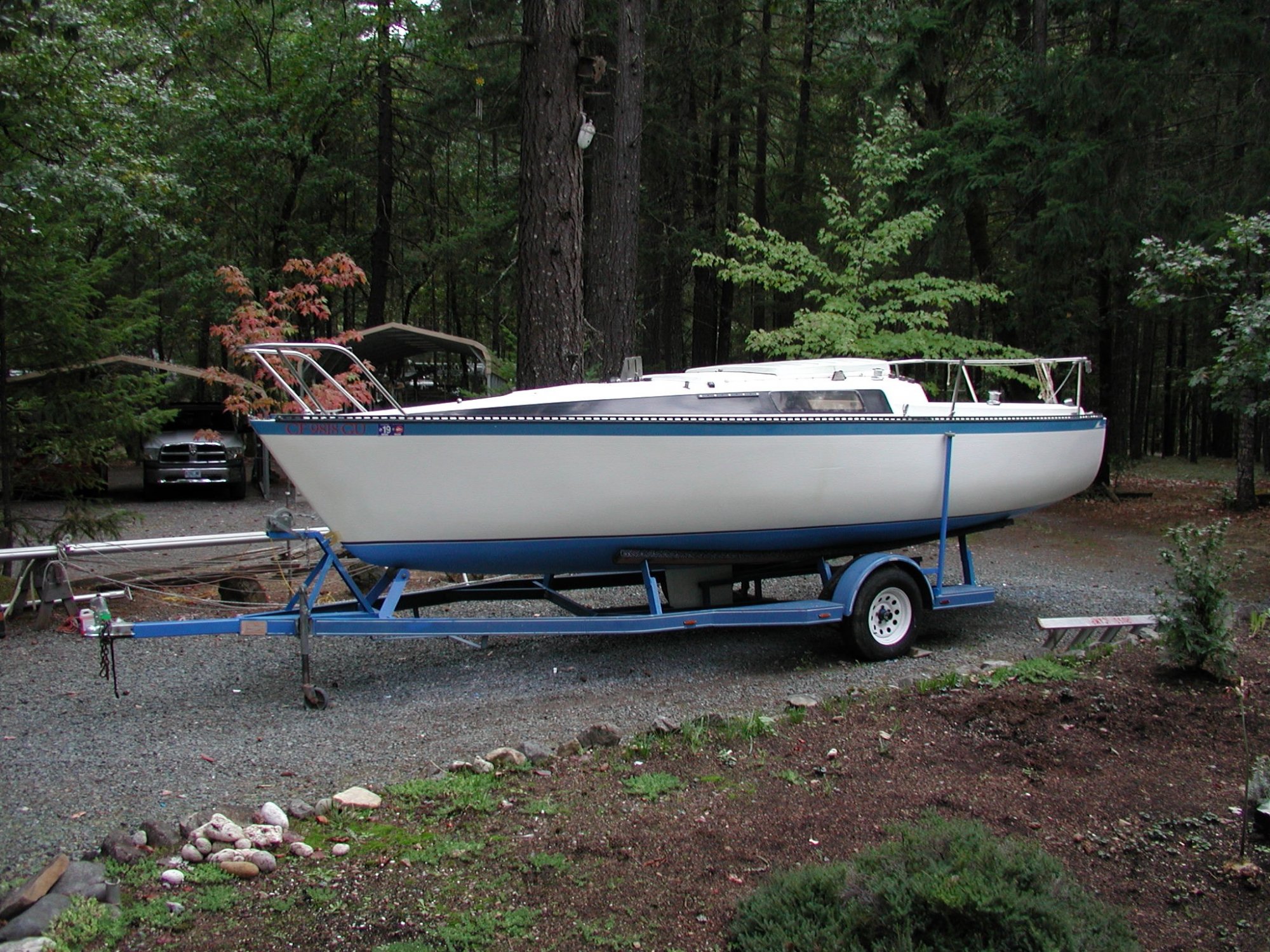

Hull paint, stripe, new logo, that part is ready to go now.

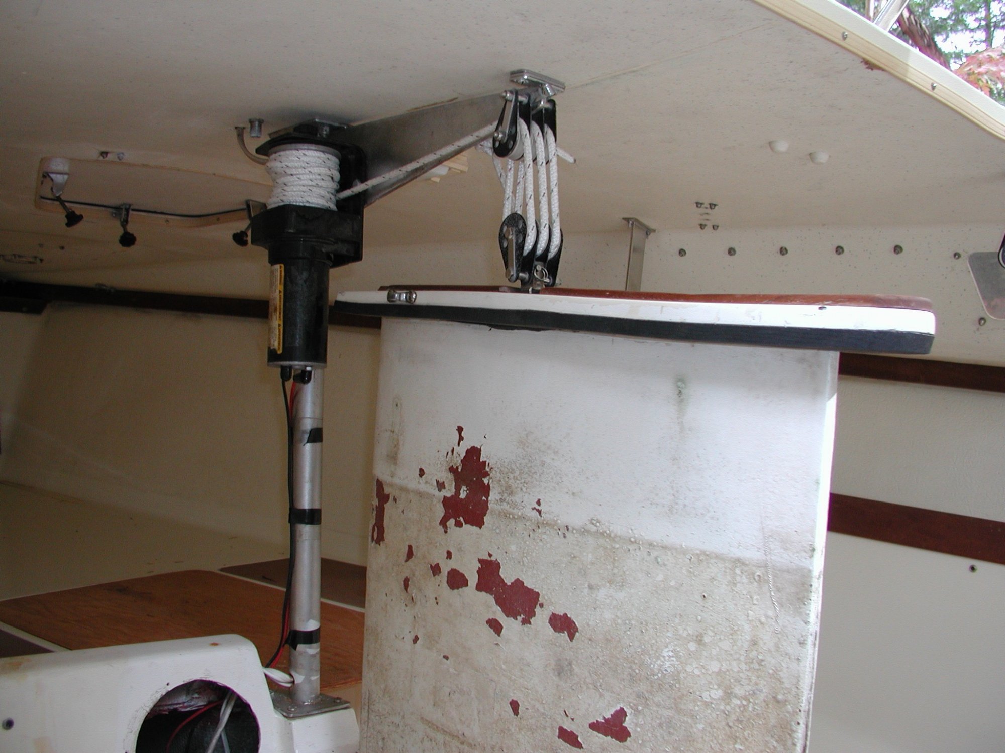

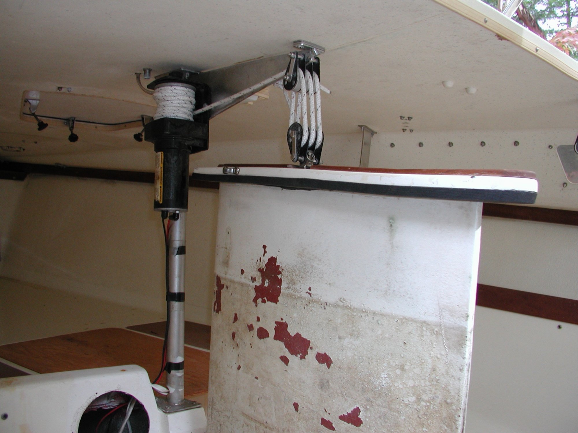

I did the common upgrade on the keel winch by installing an ATV winch to replace the use of the starboard lewmar to raise and lower the keel. new neoprene keel trunk seal fabricated. all 8 cam cleats have been cleaned and rebuilt, along with the 4 winches. The OEM Signet depth gauge and speedo faces have been buffed out so you can see the displays again, along with the compass globe.
Weather is getting iffy here now, but still hopeful to get it in the water at least once before the snow flys. fingers crossed :cool:

Do you have any specs on the electric winch you installed for raising the keel? Is there any trial and error involved with the placement of the installation of the electric winch so the keel isn't accidentally raised in such a way where it is out of alignment with the keel trunk? Did you make any measurements or come up with any calculations prior, or did you just eyeball it and install it?
