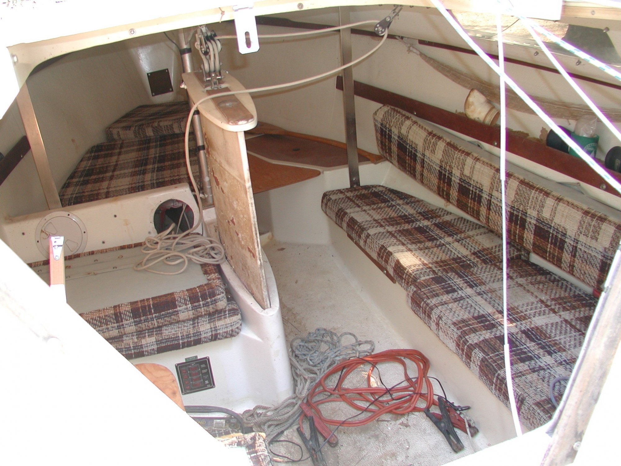

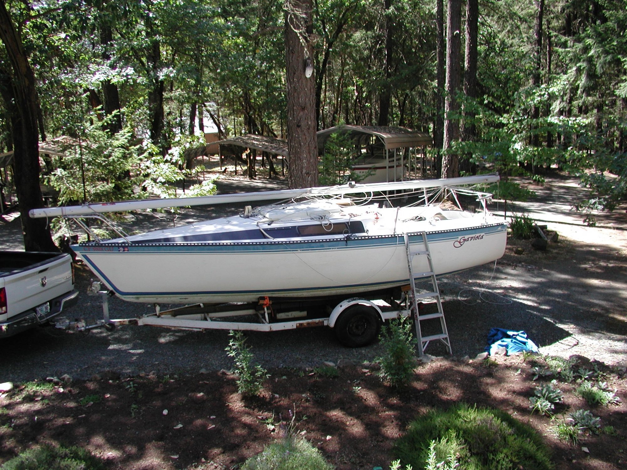

I've had my eye out for a Merit 22 for a couple years now, but when this one first came up on CL 2-3 months ago, and I drove the 3 1/5 hours to inspect, I turned around and came home without it. too much money for the amount of work it needed. time passed and the price dropped. but still not by enough to interest me. I had to take a stab at it, so I offered him what I thought it was worth ($800.00) and waited for a nasty reply for such a "low-ball" offer.... but low and behold he said "OK", and the next day it was in my yard. Even at the price, I was apprehensive if I had let my desire for a Merit 22 cloud my sanity, but now that I've emptied out the piles of "extras" and done an inventory, I'm feeling a lot better that I actually got a pretty good deal. 5 very serviceable sails, spin pole, boom vang, etc, along with all the little extra upgrades that you usually don't get with a boat. apparently the po before the guy I bought it from was an active racer and set the boat up accordingly. mid boom traveler, controls led aft, etc.. needs some old running rigging replaced and some of the hardware needs serious servicing, but it's there, and it works. The rig (amazingly) trailered fine for the 200 miles back home, but one of the first major things to tackle is still to get rid of that cobbled together trailer and get the boat properly supported. I already have a nice trailer ready to set up for it. after that it's pretty much the usual cleaning and replacing old and tired rigging etc.
so what do you think? does it have Merit? ;)

The trailer is worth $800.
Oh trust me.... the trailer is not worth $800. ;). it was cobbled together out of an old tilt type power boat trailer. the bunks are re-positioned wrong for this boat and it's deforming the hull at the bunk ends. it's likely going in my metal scrap pile after I get the new one set up.

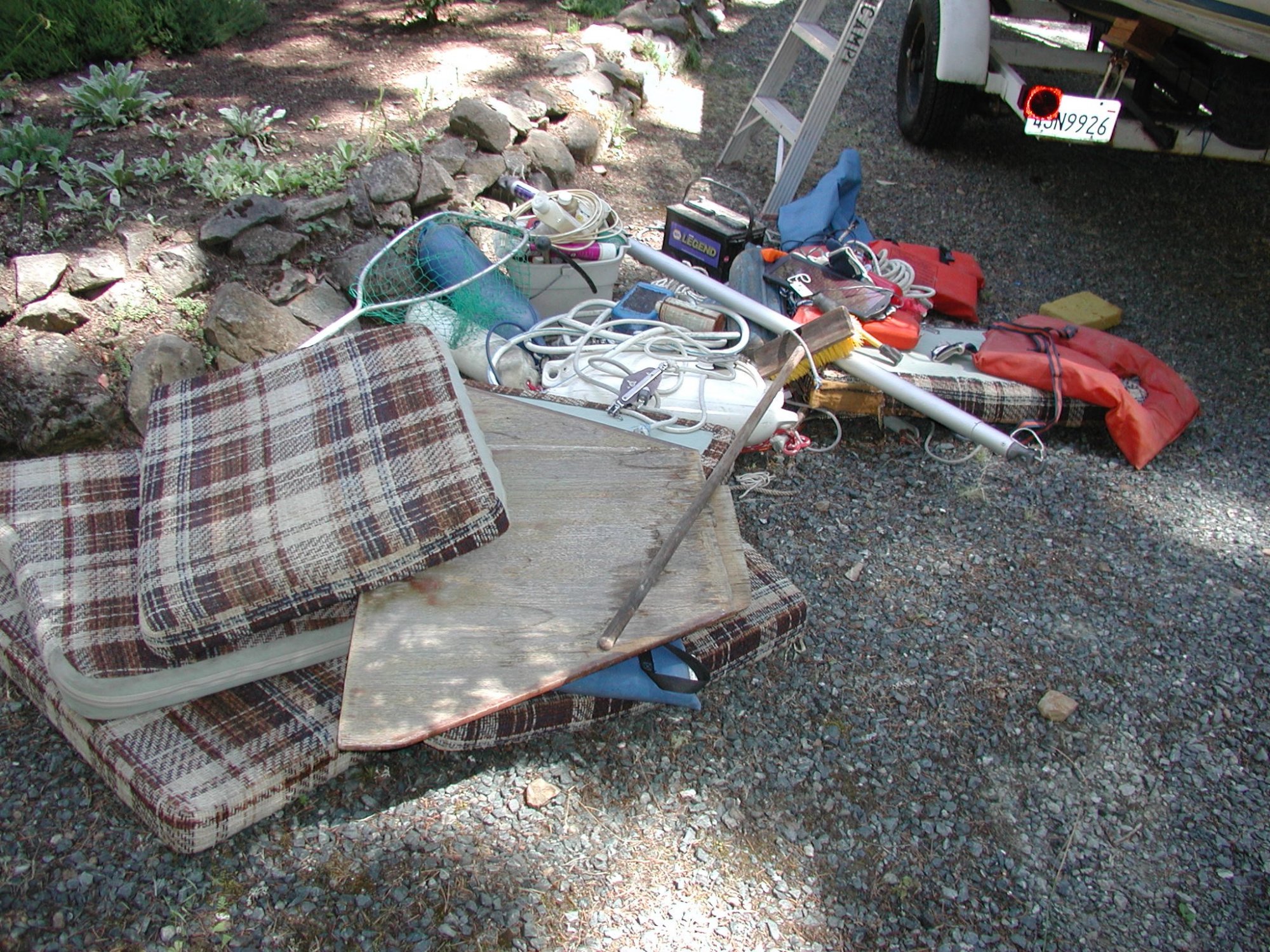

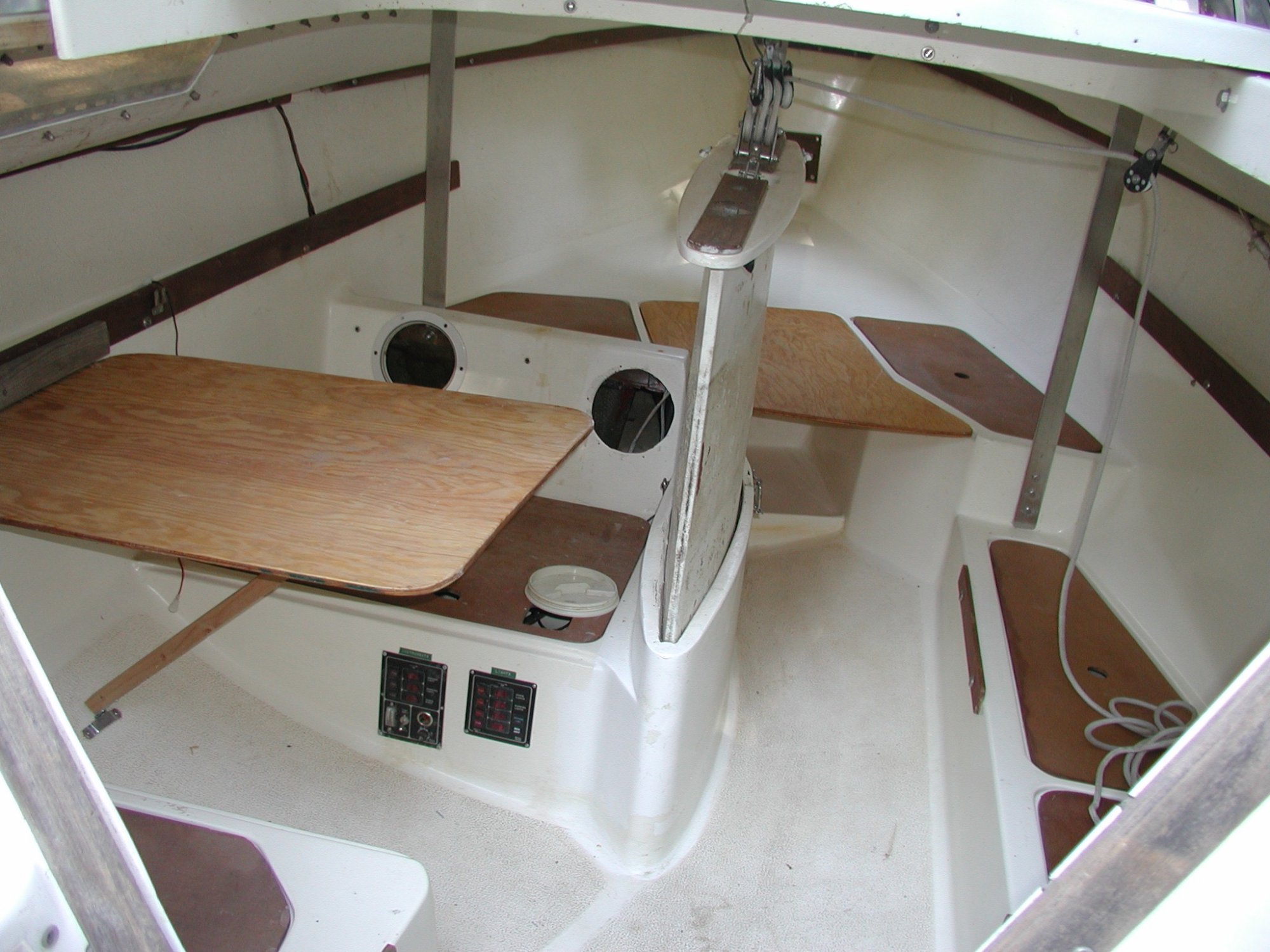

I spent today cleaning and sorting through the "extras" that came with the boat. threw away enough to fill a 40 gallon trash can :what:. I'm really impressed at how well this boat is made. maybe I'm just comparing it to my Mac 25 :waycool:, but the Merit inner liner is VERY well thought out in particular. I've always felt that way too much space is wasted in most sailboats, but this thing has massive amounts of well designed, and dry, storage spaces formed by the inner liner:clap:.

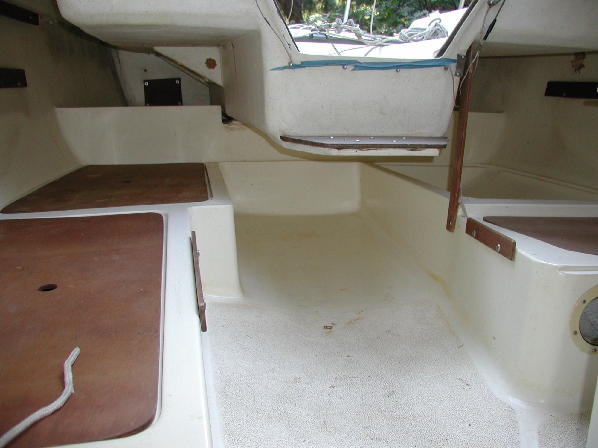

spent most of the day cleaning house today. changed the bucket of water 3 times after it turned to mud. check out the amount of storage space in this critter! I love it!! and inside every one of those huge covered cubby holes is a fully enclosed tub formed in the inner liner. water tight and clean!! in the cockpit
there's a laz on BOTH sides. each 75% tubbed (half open at forward wall as seen in pic). lots of work left to do, but I'm getting excited to get it wet now :cool:.

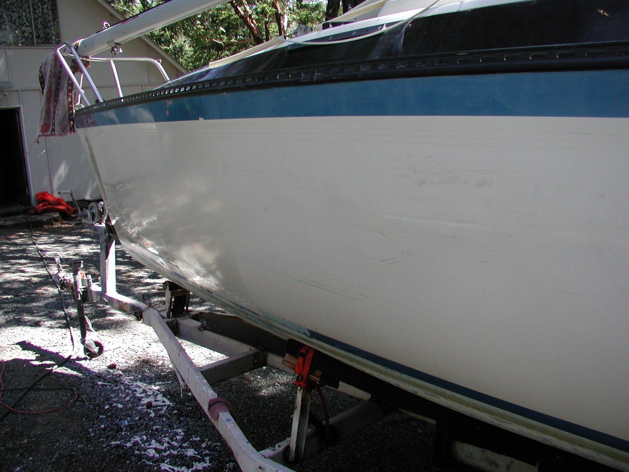

Why why why do people paint hulls above the water line? perhaps there's a smallish boo boo so the whole boat gets painted? maybe it's some trick paint that guarantees 1/2 Kt extra speed? I don't know what this stuff is, but it reminds me of grandpas picket fence after a "whitewash". appears to have been rolled on with a close nap roller (done reasonably well) but it has a very flat finish. almost like severely oxidized jell coat. I'm spraying with Citrus Strip, soaking, then scrape off the glop with a razor blade. works well, if a bit time consuming. what I've exposed so far should wax up like a new penny, so maybe it was painted to protect the jell coat :laugh:
As a general rule I'll walk away from a potential purchase simply due to having been painted, but I did make an exception on this one because the Merit 22 is quite hard to find. oh well...... it's all good.. I have about 1/2 of one side stripped so far (note where gloss ends just ahead of the trailer bunk) and have found no reason for the paint, but perhaps something will show up eventually.
rant over :)
