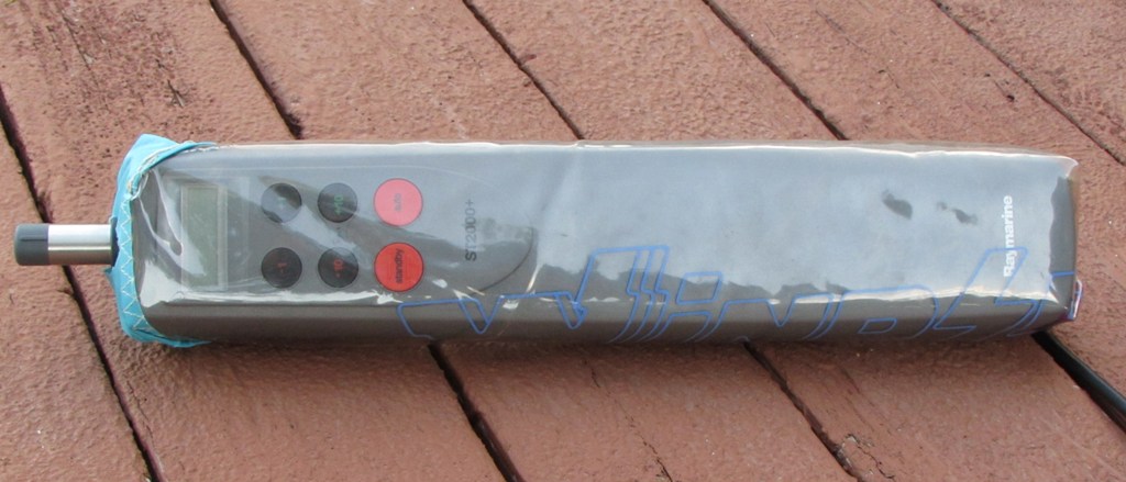

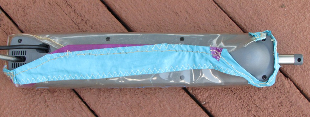

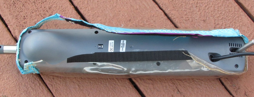

I bought an auto pilot (Raymarine ST2000) for an upcoming trip to Catalina Island (first time in the ocean with anything other than a windsurfer.. If things work out, I will install it next week. I have an old windsurfing sail with a vinyl window and used this to throw together frankencover. Not pretty but it goes on off fast and seems sturdy.. I used a speedy stitcher for the sewing.

Good choice on the ST2000 Walt. You will really like it.

Those are water proof aren't they if not I'll need to do something too I have the same one

I think they are "waterproof"
But if you do a google search on something like "is raymarine st2000 waterproof?" some owners experience come up with maybe not waterproof enough. Likely failures from corrosion are rare and it takes years of abuse so I am probably being too cautious.. Since it seems difficult to purchase a cover, maybe there isnt really much of an issue.

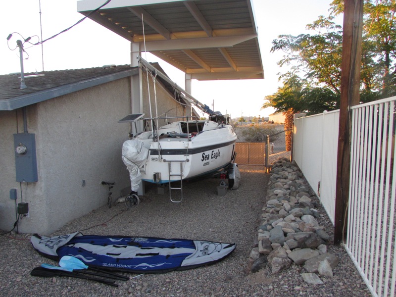

Tiller Pilot installed, now I have to cram the inflatable kayak plus paddles up into the Vberth area.. Kayak is around 30 pounds and should fit just fine.

Awesome!!
The inflatable kayak will make a great tender in Two Harbors. That's what we used our first trip. It will also double as a fender between your boat and the one next to you. Have a GREAT time. I wish we could make it this year.
