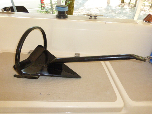

I was really frustrated and tired of dragging our two 20# iron "Navy anchors" all around the dang lake. those things are totally worthless:cuss:. I'm also the consummate tightwad, so I spent a couple hours and built myself the best Ronca clone I could, by just looking at a few on-line photos. After spending the past two days at the lake I can now say with authority that it's the best couple hours of my time, and $8.00 out of pocket, I ever spent :waycool:. 1/8" steel body with additional 1/4" plates welded top and bottom on the nose for additional weight. It only weighs 11lb, but dug into the mud/sand bottom almost instantly and never budged an inch. As usual, we dropped anchor ~150' out and nosed the bow up to the beach, where it was tied off to a stump, and then we backed out 50' or so and tied off for the night. 15+ MPH winds were on our beam for several hours that evening. The rollbar makes it virtually impossible to lay anyway but right-side-up on the bottom and ready to set, which it does with authority. I'll be making another one for the bow now ;) .

That looks real nice.
Mistress came with a homemade claw-type anchor and an 8# Danforth type anchor. I initially tossed the homemade anchor out and bought a second Danforth (20#, I think). After dragging on the hard mud at my local lake, I put the homemade monstrosity back aboard with 10ft of 3/8 chain and the 8# danforth at the end where I warped the anchor line to the chain. No more dragging, but its a bear to get back o board. The 20# danforth is now my lunch hook.
I've been considering a plow-type anchor but they are too expensive.
Wish I could weld.......

It is pretty amazing how much they get for such a simple thing to make. Certainly nothing precision about them.
You could be welding in 20 minutes if you had a decent (even used) mig welder. very easy to learn to do this kind of project. heck bring over some steel and I'll weld it up for you.

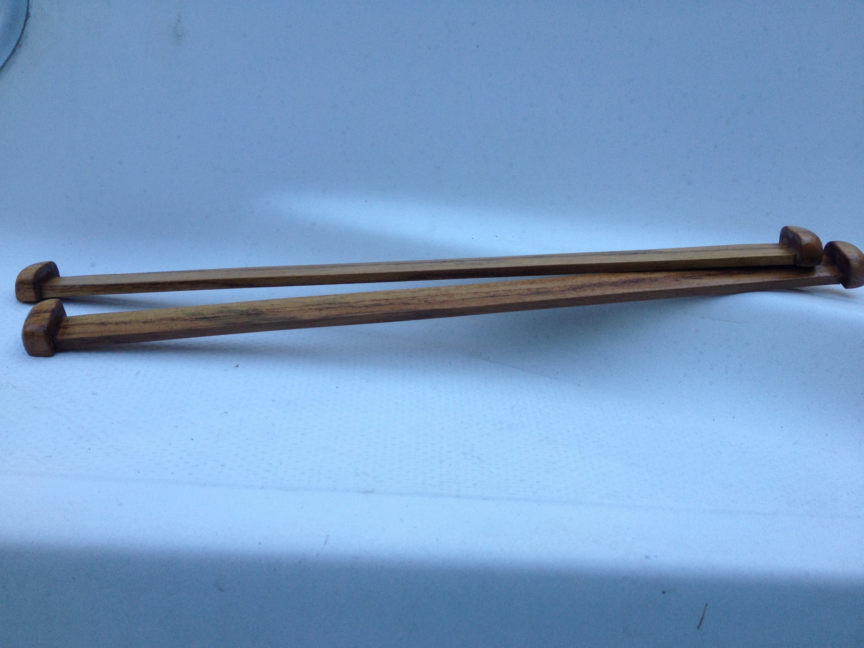

It's time to pull the genoa car tracks and the plastic spacers and stops are in need of replacing....
I have some teak, and sand paper, some varnish
So I made these

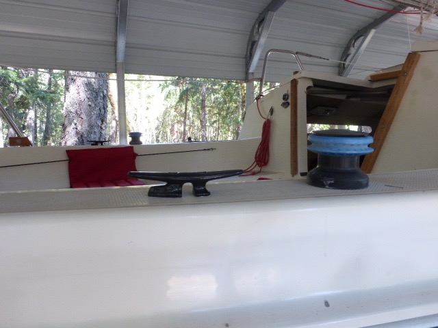

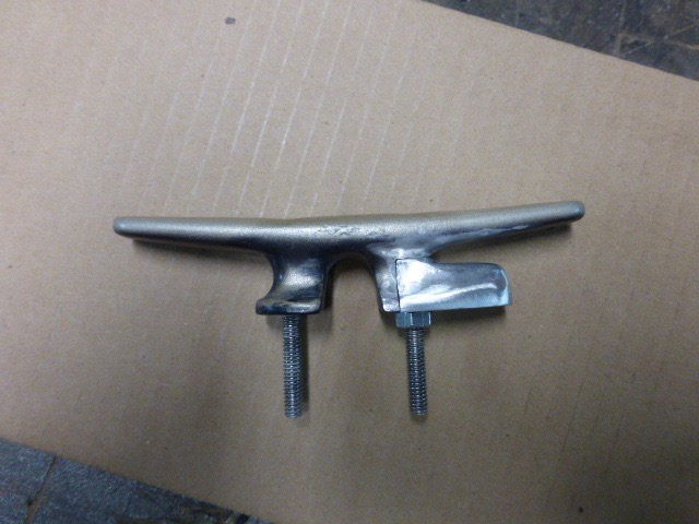

The first time I sailed Tweety (our recently purchased Victoria 18) I discovered how much I love self jamming horn cleats, for use on the jib sheets, and just had to have some on the Mac........ until I looked at what they sell for. Are they out of their friggin minds?? :yikes: I'll just modify my own, thank you very much :ass: . Wile not a "simple" modification, it was mostly just a matter of patience to carve the needed additional wedge out of a chunk of aluminum I had laying around. took a few hours for each one, but was a good way to pass the time on a 107* summer afternoon at home. Out of pocket expense = $0.00 .
I think the photos show the modification process pretty well without further explanation. now I'll ditch those Winchers that have been on the winches since I bought the boat (but almost never used anyway).

Nice!
