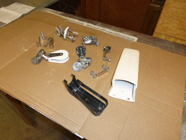

Lately I've been removing clutter from the deck. mostly lots of mixed oddball blocks and fittings surrounding the mast base that I'm not using anyway so I wanted them out of my way when walking up topside. Once the clutter was removed, the holes were filled with resin, sanded down flush, and touch-up painted to match. it came out nice and "clean". I like it!

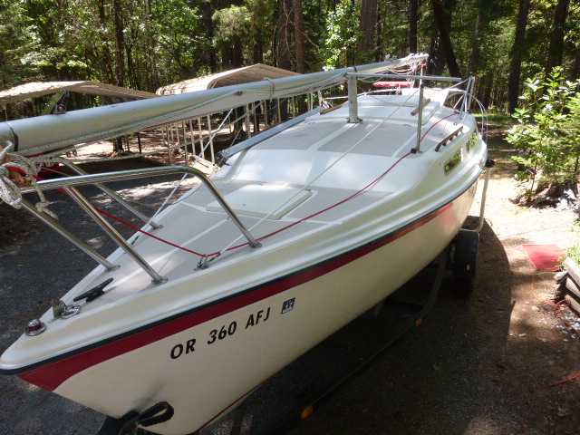

I had the mast off the boat for the past few days in order to more easily remove the junk, and build the mast gate (ck it out in another thread here under "mast gate for an M25"). so wile I was at it I closed the mast slot down to a consistent 3/16" as I've discovered on my C14.2 that this will make raising and lowering a sail with mast slugs about a thousand times smoother.
I've also given up on trying to utilize the boom roller furler system (ya ya… I know ;) ). I gave it a real effort, but I'm tired of fighting it, so I'm setting up a more traditional slab reefing system. that's actually done now also, except for waiting on two cheek blocks.
I think it's about the way I want it now :)

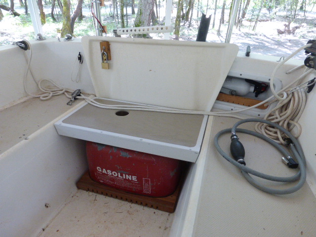

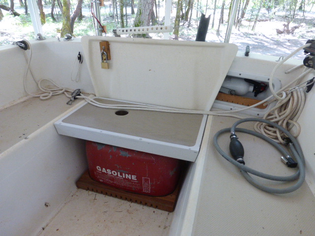

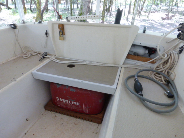

I haven't looked that close at the 26s door, but on my 25 I found that the bloody thing sits fairly well right behind the fuel tank. it does stick up enough that the tiller drags on it just a tad however. I never use it anyway, so I'm always tempted to just leave the dang thing home ;) .

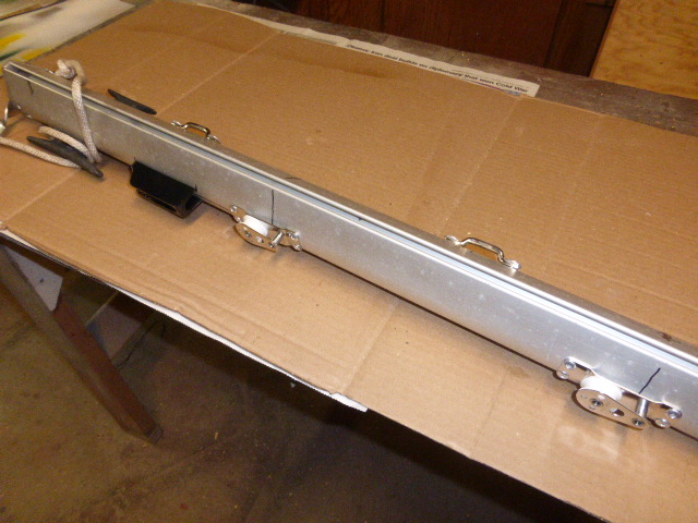

Got the cheek blocks today and finished up my slab reefing setup.

If the reefing line is anchored correctly in the boom, rearward of the reefing cringle, this acts as the outhaul. the anchored end provides outhaul wile the cheek-block side, which is straight down from the reef cringle, provides the downward motion.
