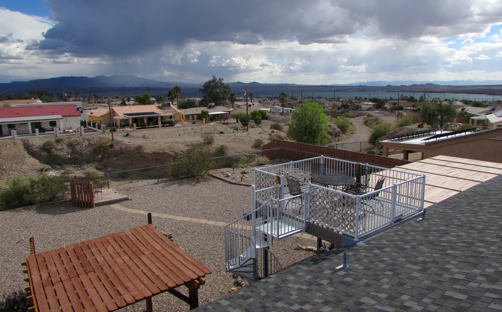

If I have to come out there...:biggrin:
Then we would have to drink a beer on top of the canopy. This picture standing on the top is from yesterday..

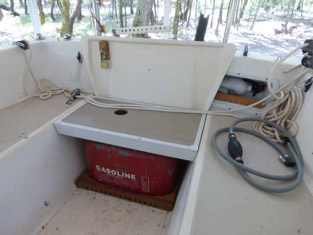

Today I made a little bench to tidy up the fuel tank area and give a bit more useful storage space. I think I'll paint it to match the surrounding fiberglass also.
Done: P1030515.JPG
Tues/Wed we sail. :)

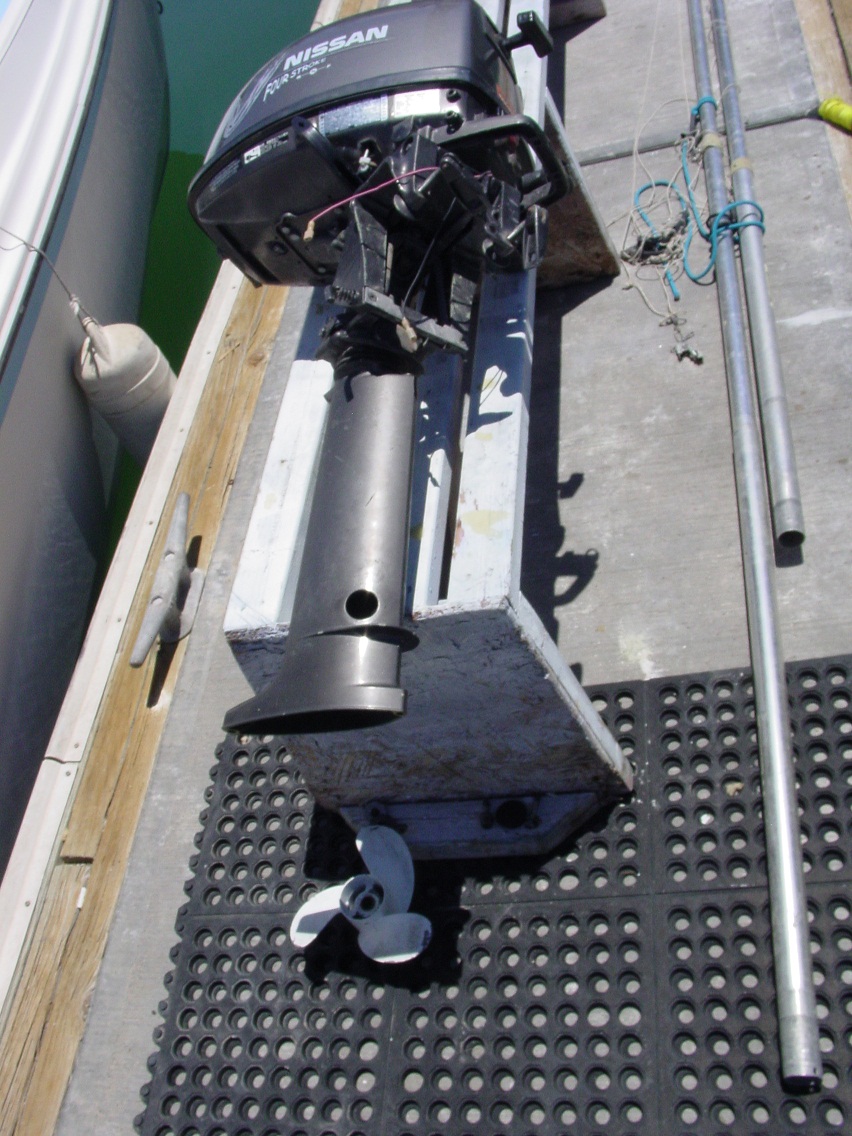

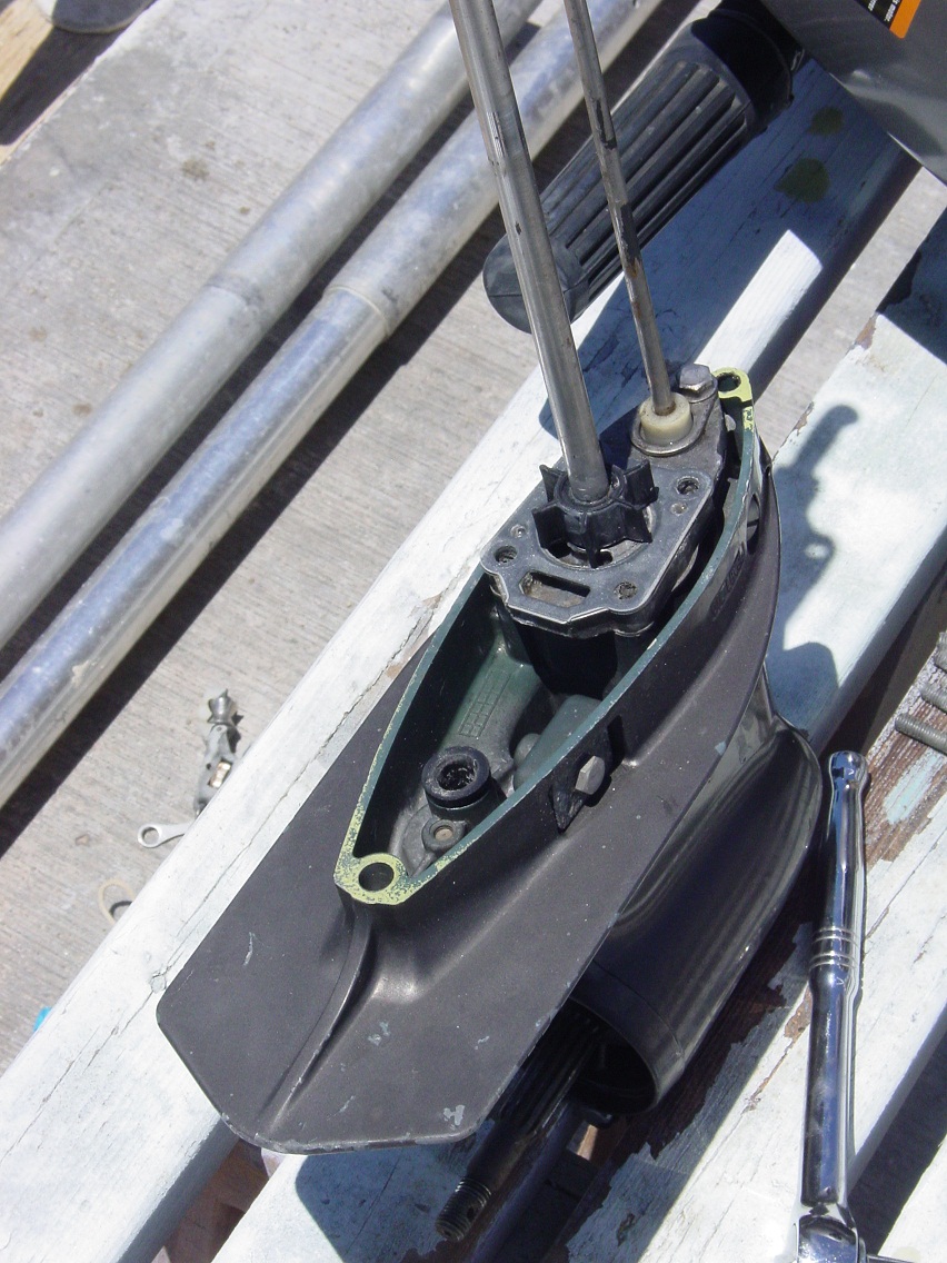

Yesterday I motored out onto the Sea of Cortez, hauled yards, got scared, so then pretty much immediately struck them down.
Motor seemed to be weakly peeing seawater, so when I got back into port I tore into the lower unit to check the impeller.
Darned thing was fine, so I guess there's some salt blockage in the cooling system, but not enough to worry about yet. When I haul out in a day or two I'll give it a freshwater flush.

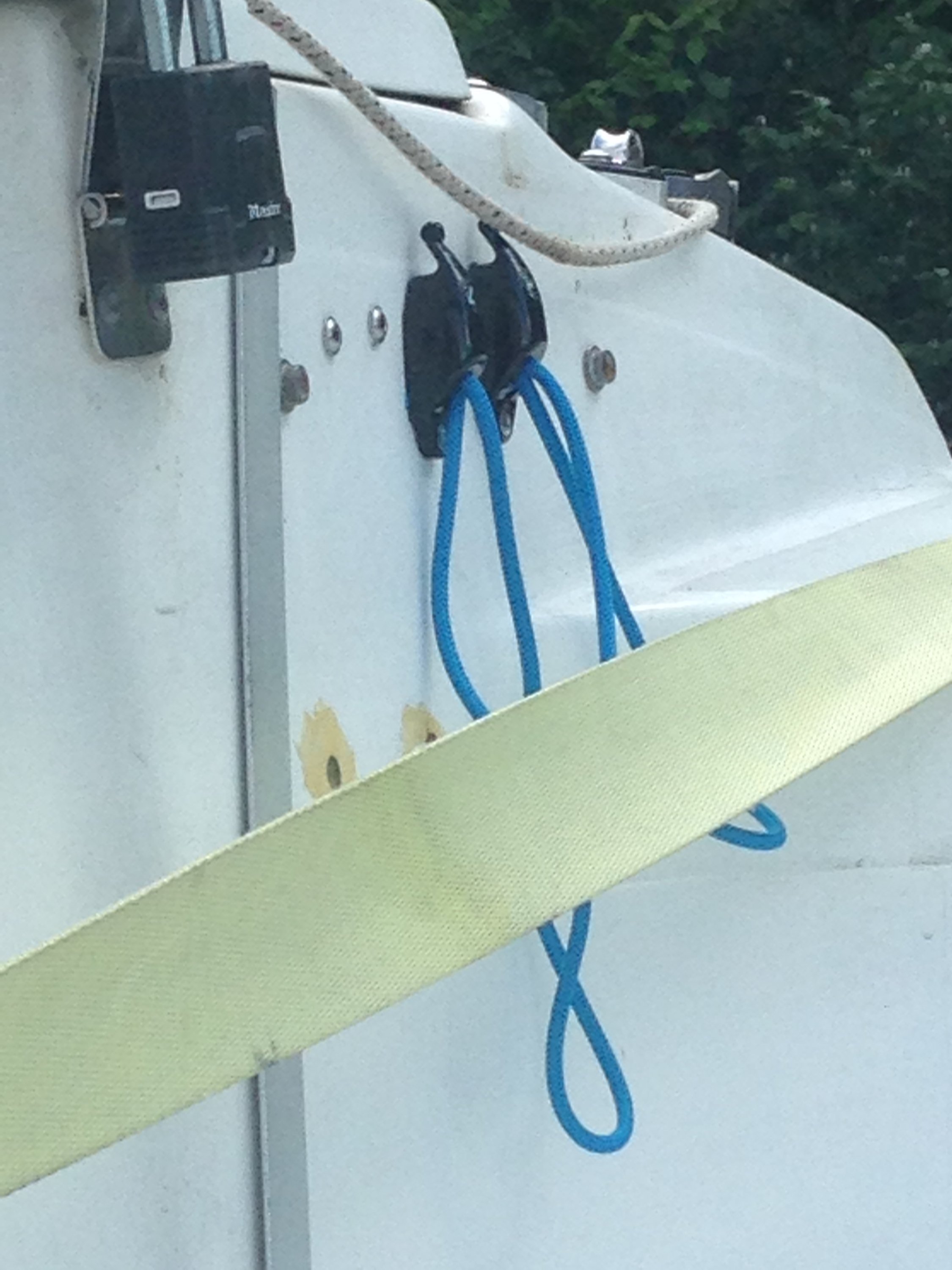

Ok, Willsnow is making me look bad, but I did get a little project done. You can see the line wranglers I added (ignore the hastily applied, just seal the d*mn hole epoxy job next to it). One for the furling line and one for the dagger board line. Regrets on the absence of true nautical terms.
