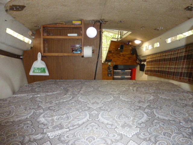

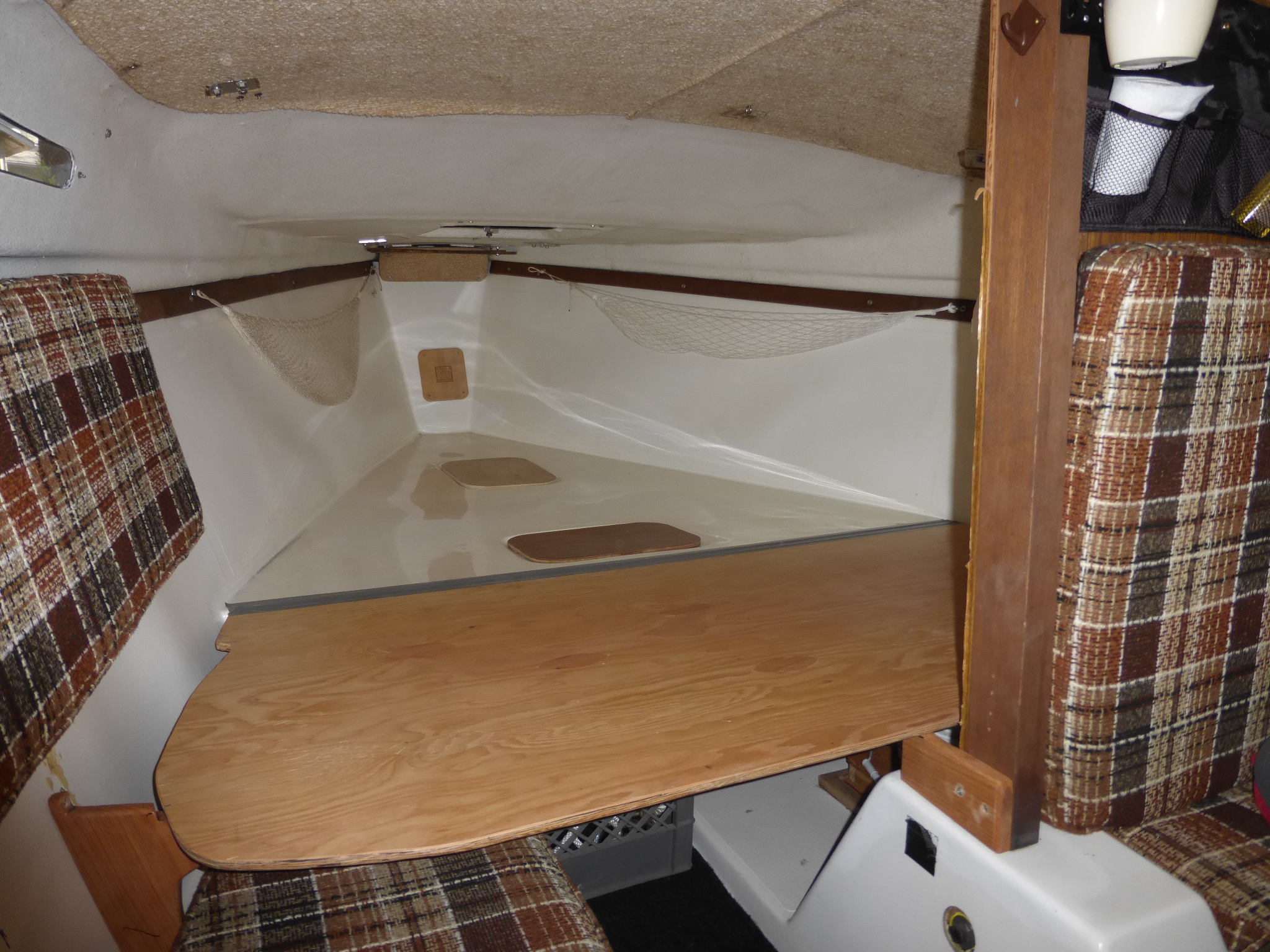

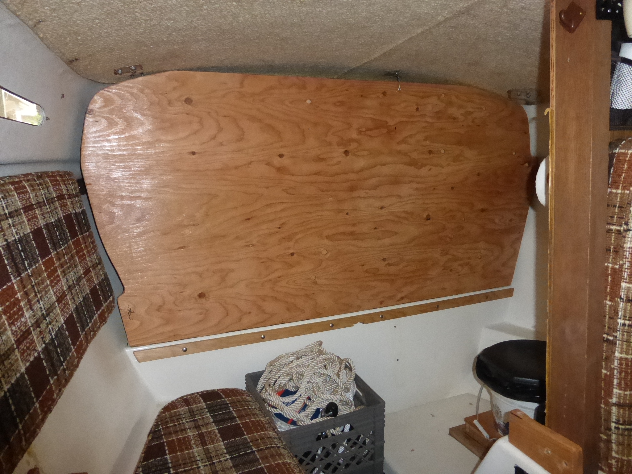

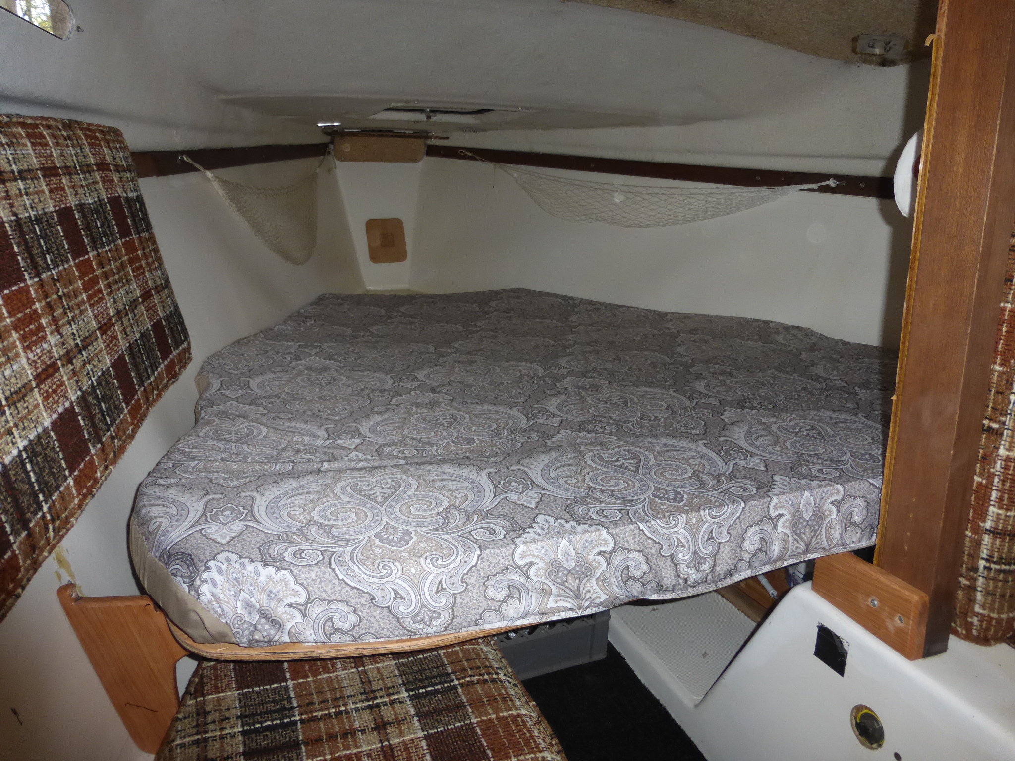

After our overnighter a couple weeks ago I decided to try something different on the sleeping arrangements that didn't require taking down the table, adding the various boards, filling the air mattress, making the bed, etc. The V berth was just too confining the way it was, but I saw a light at the end of the tunnel..., and then it hit me.
by removing the v berth/head wall and creating a full width one out of 1/2" plywood, plus a couple support braces to support the aft end, about 32" can be added to the V berth area.
I attached it to the fiberglass with a piano hinge so it can be raised and latched to access the head (very rarely used onboard) and storage etc.
Jennifer picked up a new looking duvet cover for $4.00 at goodwill (her favorite store) and sewed up a nice slip cover for the new one piece 3" foam pad out of it.
The existing shelve units were modified and shuffled around, and walla… a bedroom with an "almost queen" size bed that doesn't require assembly every time you want to use it.
